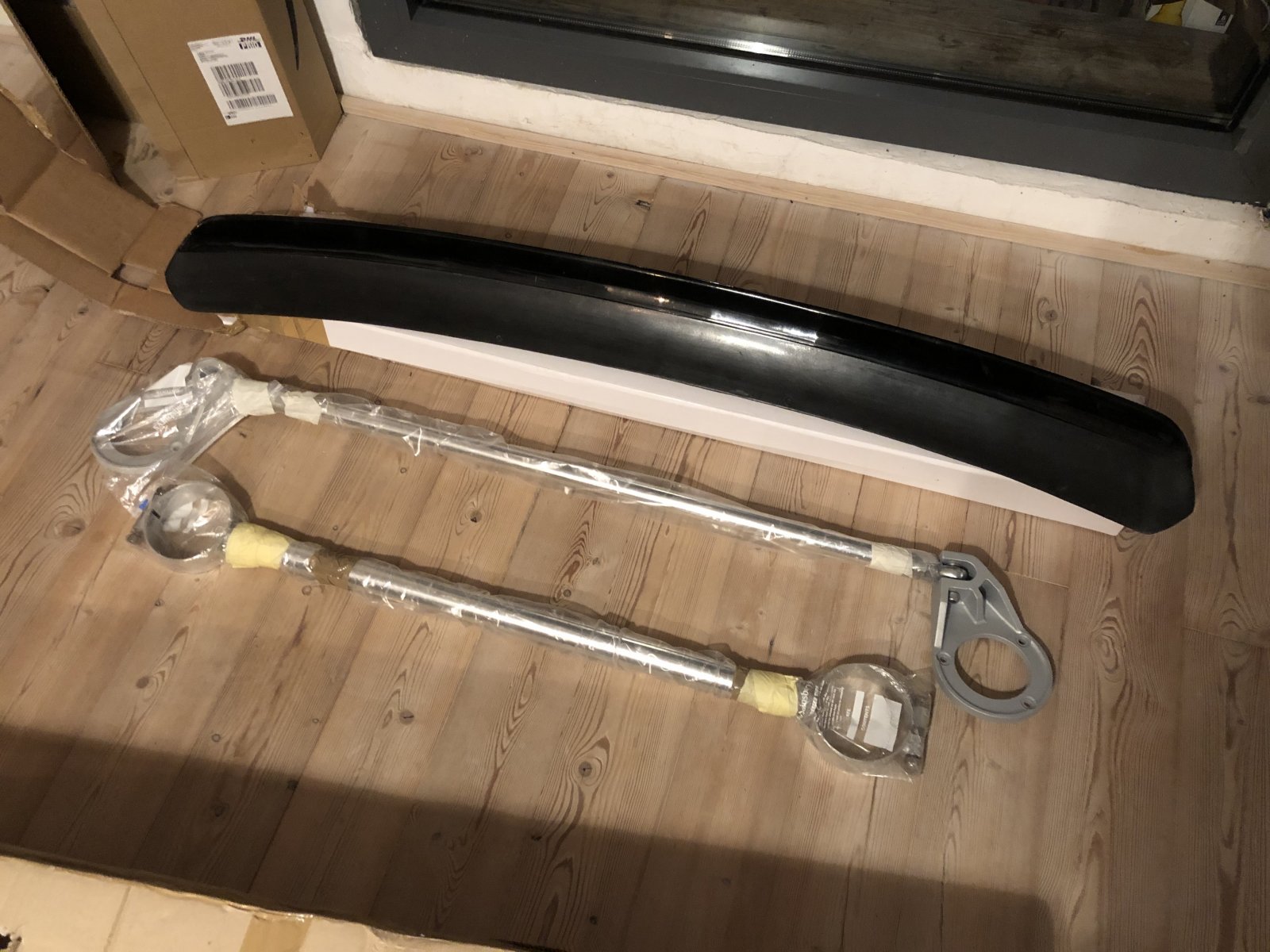

One thing I notice when driving the car hard on tight twisted roads is that the chassis flexes. As I’m about to get my car repainted I was wondering what people have found to be the most useful for chassis strengthening. I know Coupeking is doing that almost as standard procedure. A lot of the work seems to be around adding welds to things like the rear wheel well to the bulkhead behind the rear seats. I’ve also seen a triangle shape being added in the engine bay between the frame rail and the firewall.
Does anyone have any experience to share in that area?
image from VSR1 website

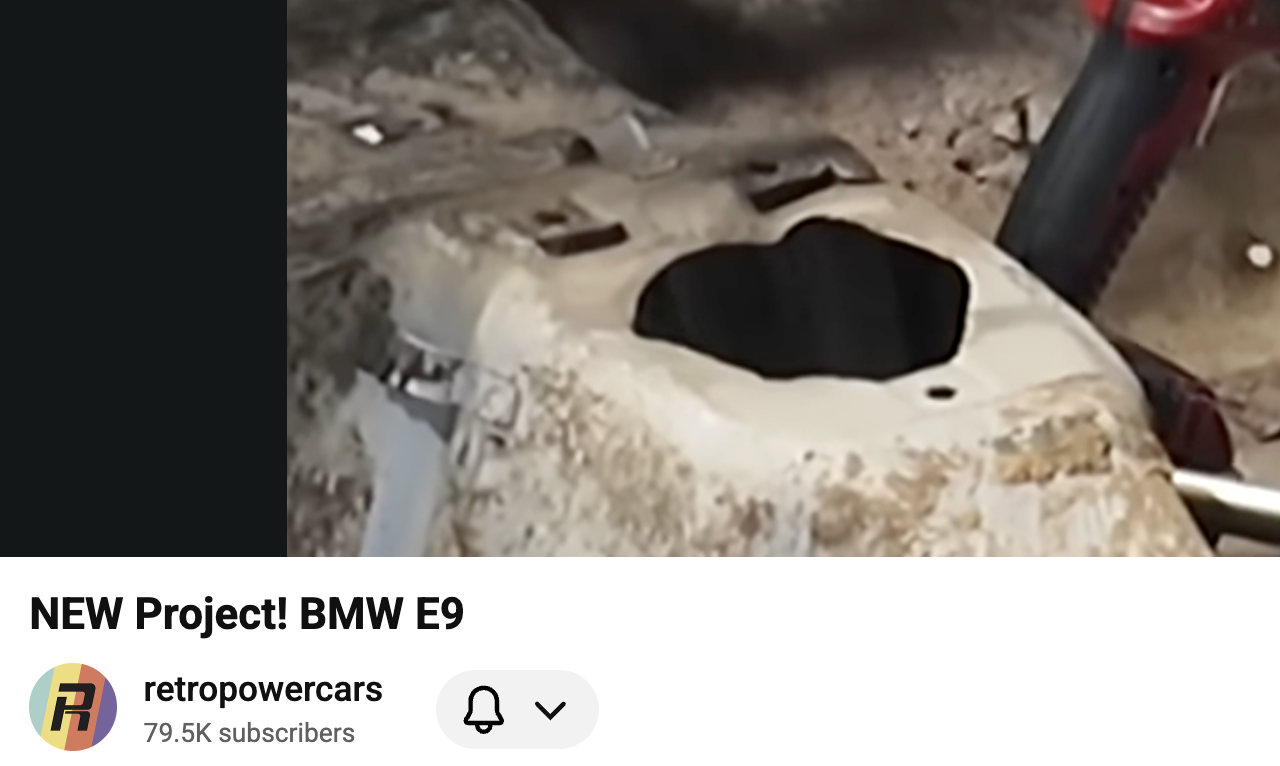

The Sevior brothers at Retropower in the UK have finally gotten their hands on an e9 and, most importantly, with an owner with deep enough pockets to do a proper restomod build of a coupe.
As always with them, this is neither a restoration to original specs nor a boy racer hotrod. They specialize in engineering a highly drivable top quality vintage gt car, keeping what is great, updating what is not by modern standards. (If you have not seen their previous work, they were commissioned by none other than Gordon Murray to build him the ultimate Mark I Escort a few years ago). I have talked to Cal (who is a big e9 fan) a few times and they are going to do some very interesting things in terms of chassis and suspension upgrades.
As usual this shell is is in pretty horrible shape but they are going to rebuild it from scratch anyway. Their builds usually take a couple of years and they publish a very informal youtube video of what they worked on the previous week each Sunday night.
This is the first episode from March 2.

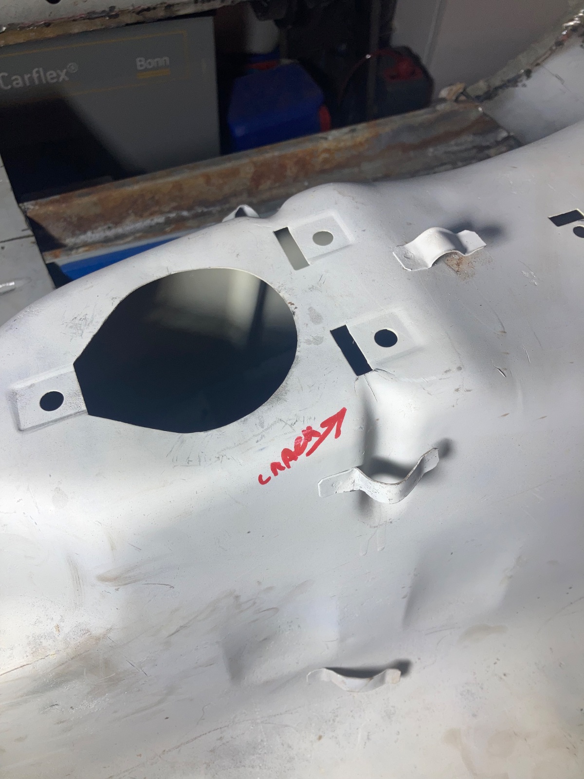

Just some images showing that e9's do flex & some reinforcements that i made / saw in other resto threads:

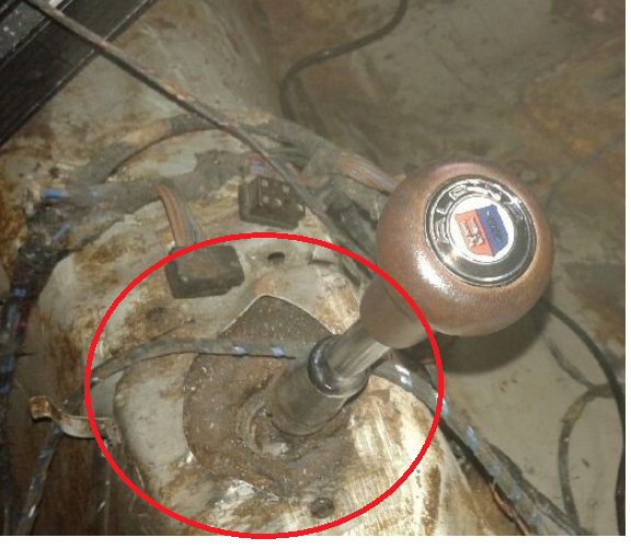

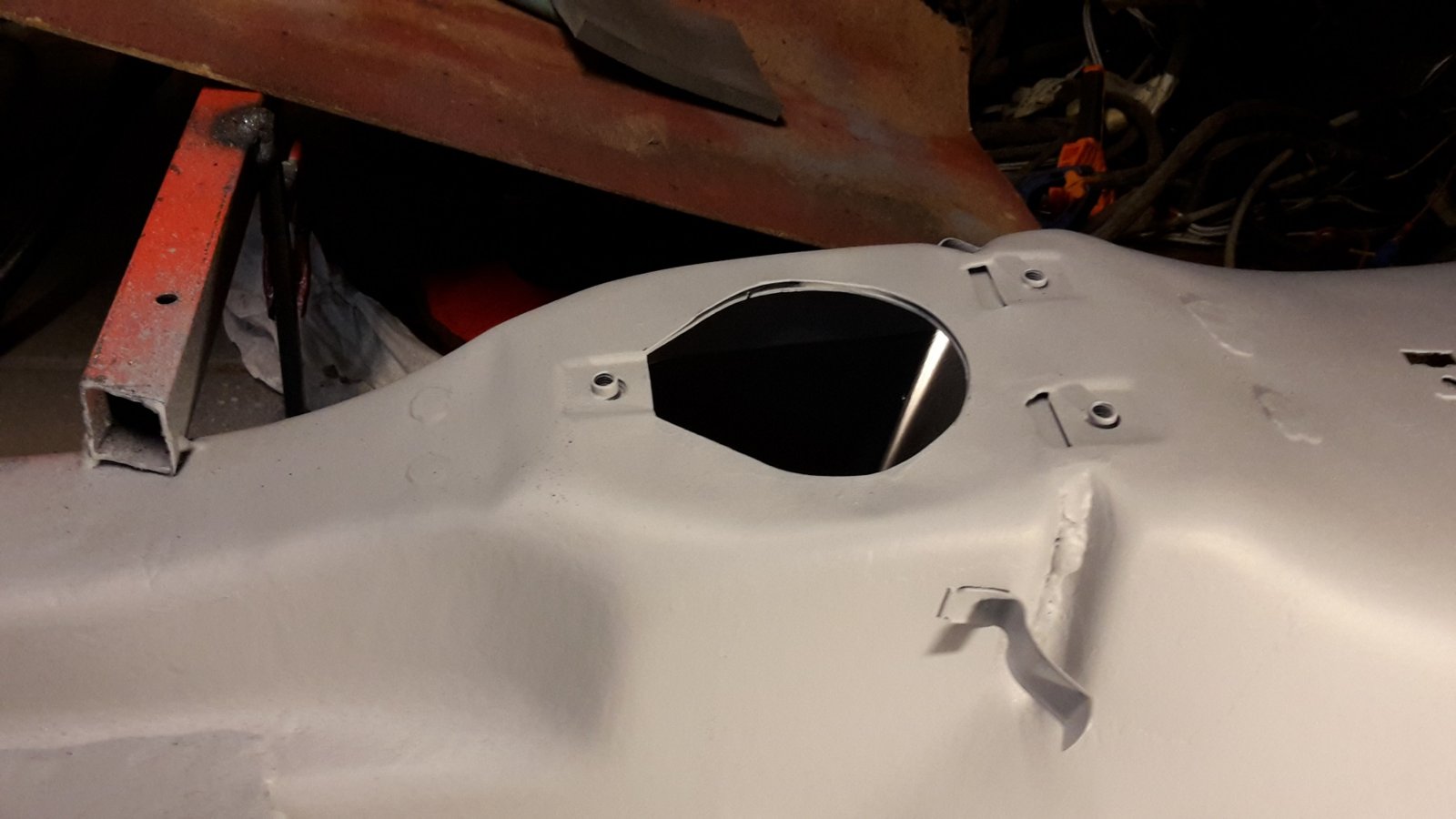

From a members car; the opening in the tunnel should be a flat round shape. It isn't anymore.

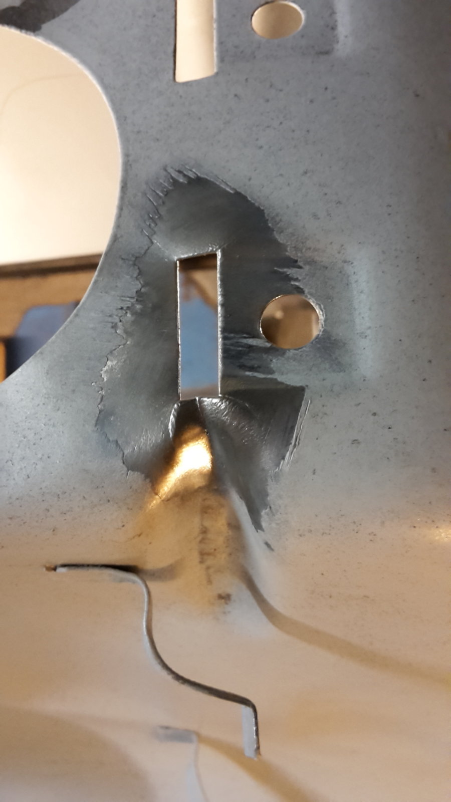

From my own car:
In red you can just make out the hairline crack. In green a weld already made by the PO... this is at the top of the tunnel, where a depression runs down both sides for the wiring harness to fall into.
and another detail of the cracks; when you look closely you can see that there are actually 3 hairline cracks coming from the speed clip opening running down the tunnel.

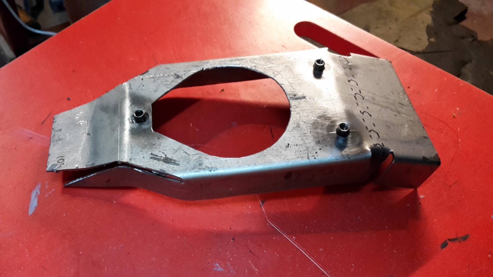

here's what i made to improve it. It now has 3 threaded bushes to accept the shifter console. It's inserted from under the body and then plug welded it into place:
View attachment 113624View attachment 113625
I will not know if it is strong enough to prevent it from buckling again, untill I drive it. that'll be another 2-3 years at my speed.

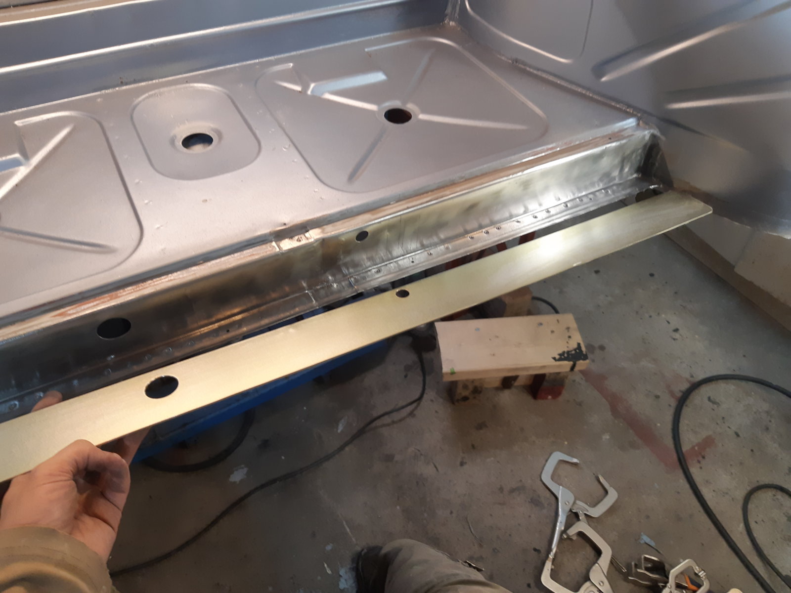

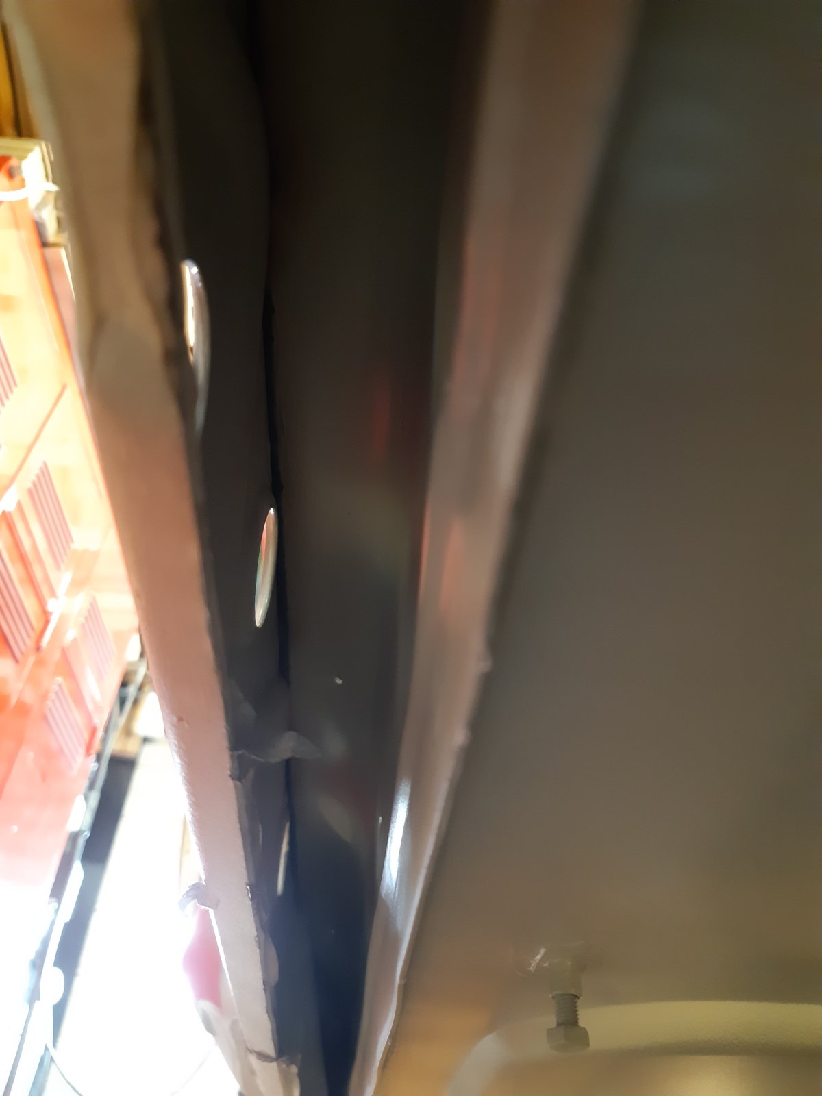

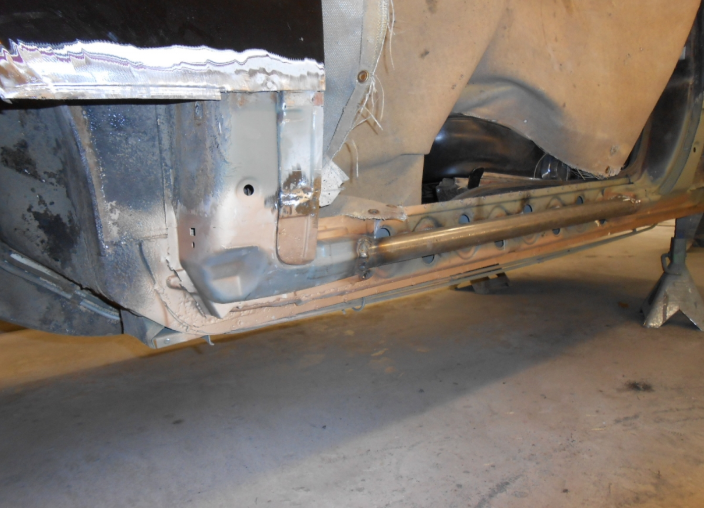

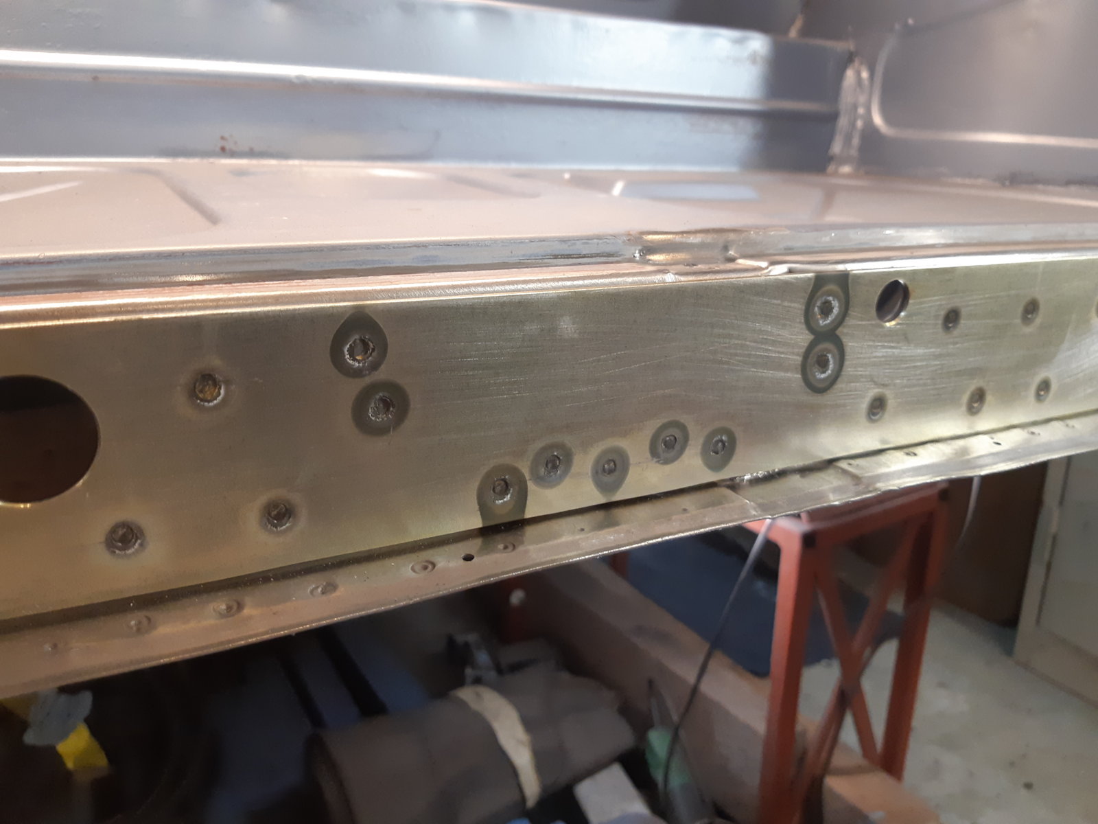

Another modification is this one (i've seen it on more restorations): the sills have a middle layer that is connected only to the outer layer (just 0,8 mm thick) by spotwelds. As such it does form s closed section, but only to thin sheet. It could benefit from connecting it directly to the inner sill which is 1,5 mm thickness).
Here you see the 'open' channel, before the outer sill is placed. (Left sill, looing towards front wheel. Inner sill 1,5 mm on right, middle sill 'floating' on the left. Closing this channel with some tabs will increase it's bending stiffness immensely.
These connections are best made at the lower b-pillar and lower C-pillar. Here's the pic of the lower C-pillar where the jack pick up point is now welded to the inner sill. and on the right pic you can see the b-pillar where i could have (should have ...) made the connection as well:
View attachment 113627 View attachment 113628

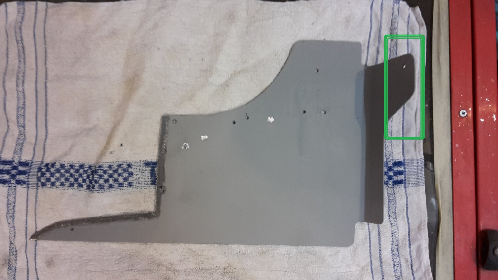

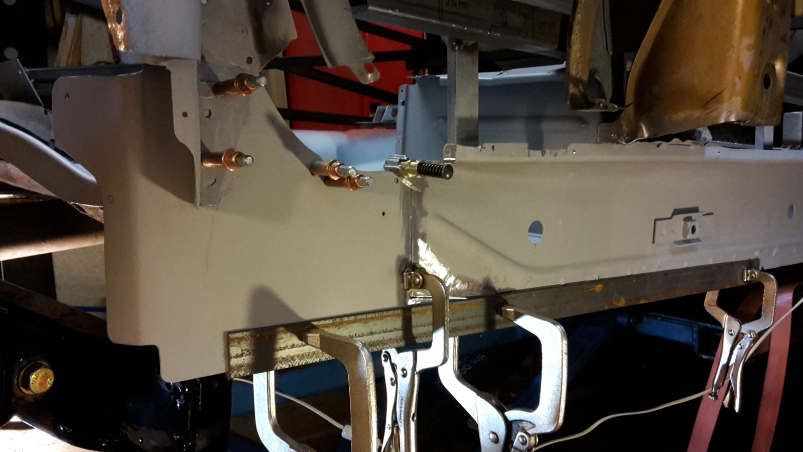

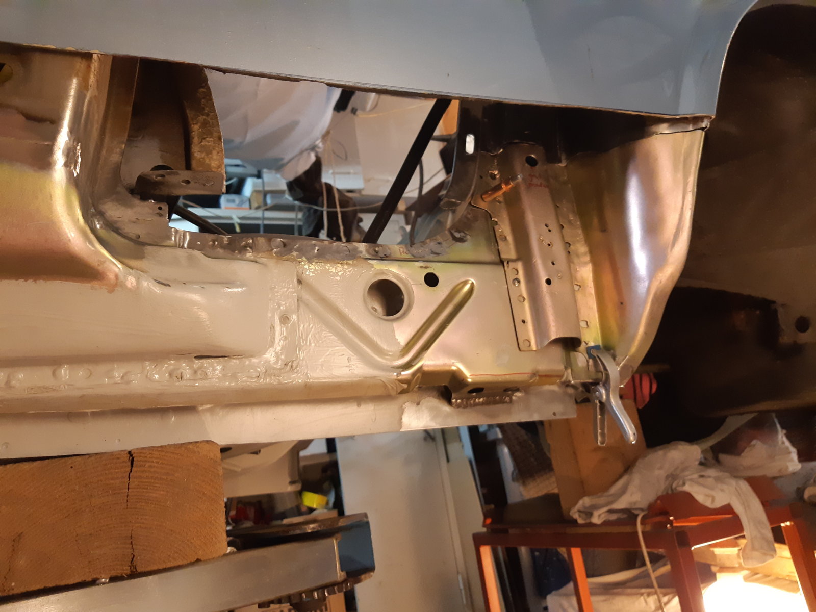

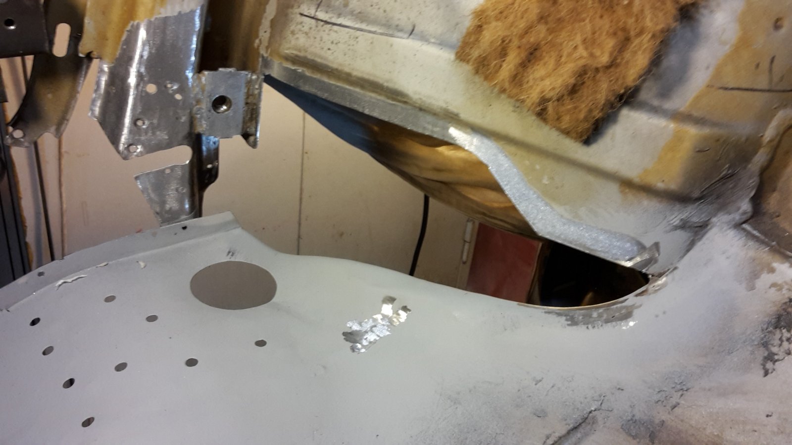

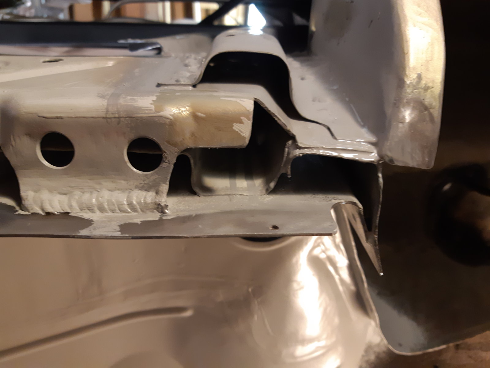

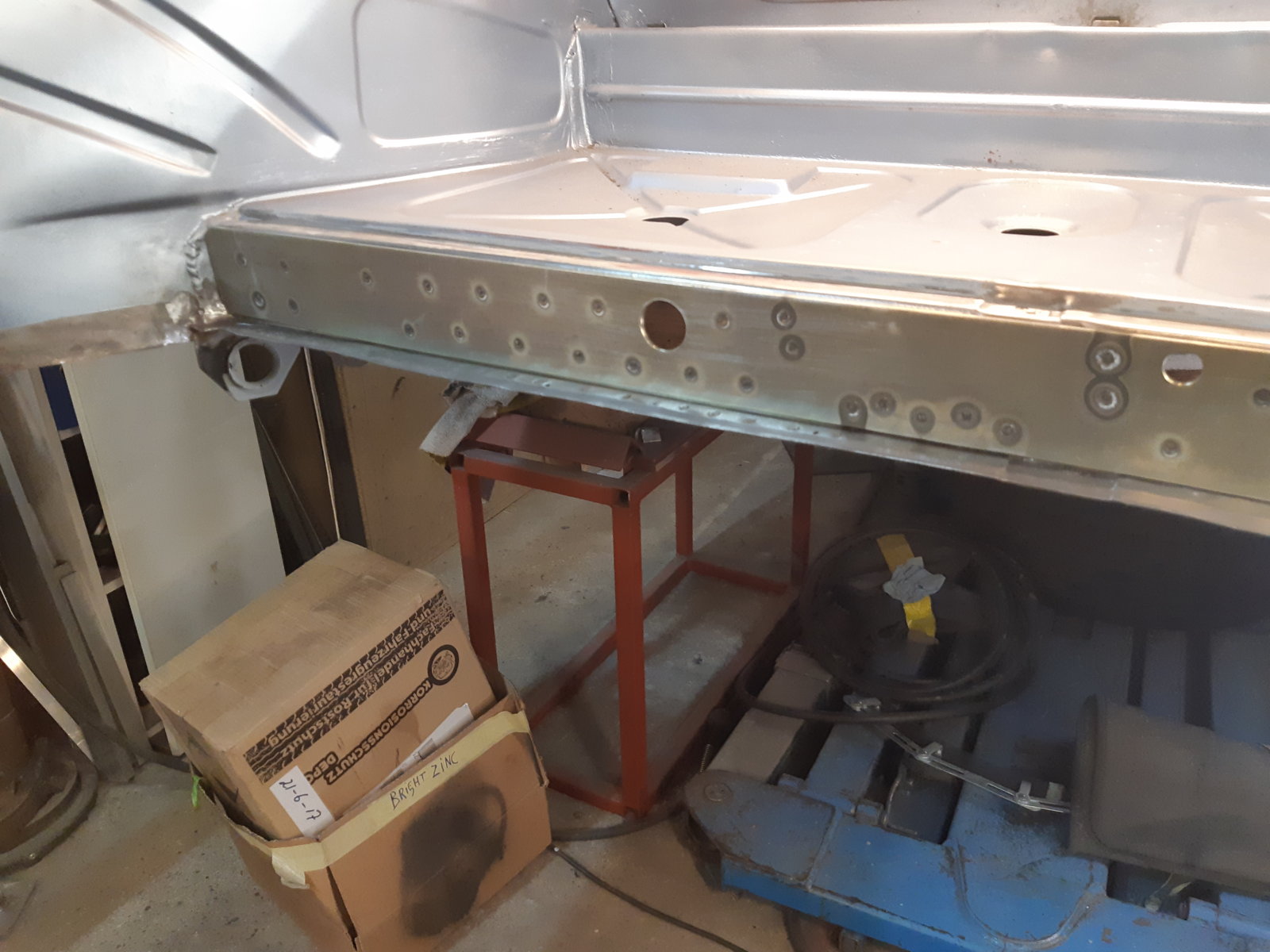

Another modification i did was under the rear seats, where the reinforcement plate sits that holds the big pin for the rear subframe. This reinforcement plate is only rigidly connected on one side to the inner sill with seams welds. the other side just is spotwelded to the 0.8 mm floor. In an ideal world, it should all be constructed in triangles. that is not the case here: the reinforcement just hangs on the wall of the inner sill, and the floor is not really strong. SO i opted to create another strong point for the reinforcement to be welded to.
In my car the floor under the the rear trailing arm pick-up points were rusted out, including the ends of the inner sill. So i needed to replace those sections anyway.

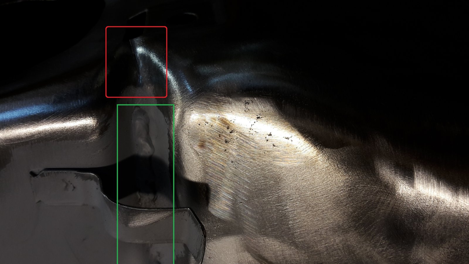

I made a new end section to the inner sill, with a larger flange that folds around the corner into the wheel well, just behind the reinforcement plate. It now connects directly to the reinforcement piece that sits under the rear seat, completing the 'triangle' to.
Gaping hole under rear right seat & New inner sill end section made (The flange in the green rectangle was my addition):
View attachment 113630 View attachment 113632
and lined up for welding:
and here you now see how it supports the reinforcement plate. IIt was plug welded together later on from this side, so not noticeable anymore afterwards. The section left of the red line was added, in comparision to OEM shape.

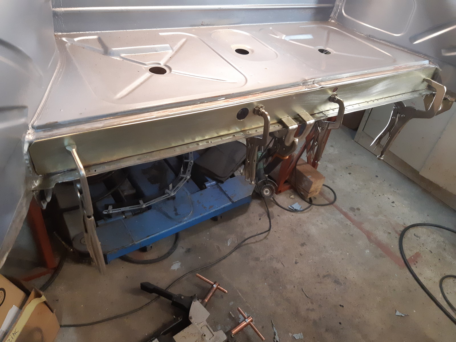

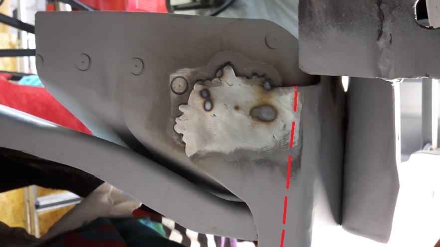

In the rear, i've reinforced the differential mount. As my trunk is quite airy at the moment; this was easy to do:
I doubled the vertical flange where the diff support is welded to:
View attachment 113635View attachment 113636
then spotwelded the whole thing. The thicker welds are where it connects to the rear diff mount.
View attachment 113637View attachment 113638

Referencing an earlier post in this thread about the aperture for the shifter no longer being flat, in the video from Retropower, you can see that the location for the shifter is quite bent up. It seems that along with the differential mount stiffener, an additional stiffening plate should be on the list to consider for full restorations, especially if you are boosting the engine power.

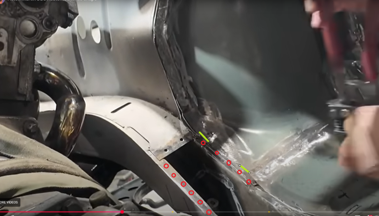

In their video this corner happens to be very visible, as they chopped out the entire tunnel, offering an unprecedented view of a corner normally not visible (see pic below, left side of the pic shows the right chassis leg of the car, looking towards the engine bay from the interior side. On the right is the right A-pillar, bottom is the frame rails)
In my car there are spotwelds along that seam (as indicated in red in below's screenprint from their video), and there is an additional strip weld on the underside (green - on the underside).

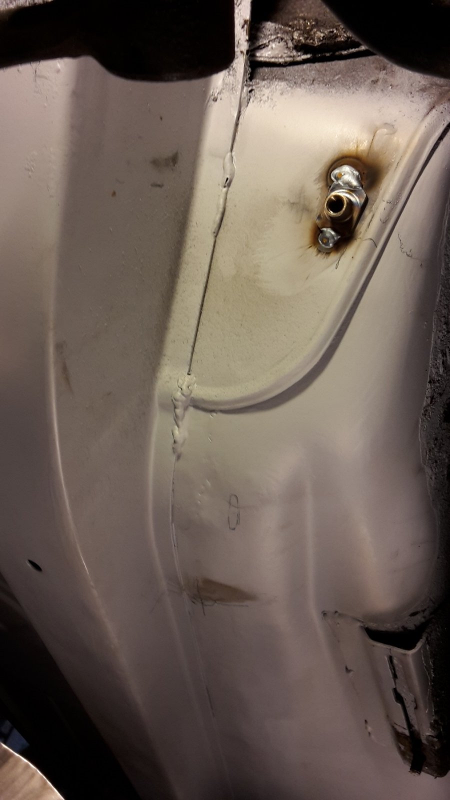

My car, after replacing the floor sections, as seen from below, shows those strip welds. The thin continuous strip weld in the middle of the picture is an original one. The blobby one is mine, replacing hte priginal one that was cut up to remove the rusty floor section. The fresh exposed weld is my addition, it holds the threaded bush for an additional heat shield:
