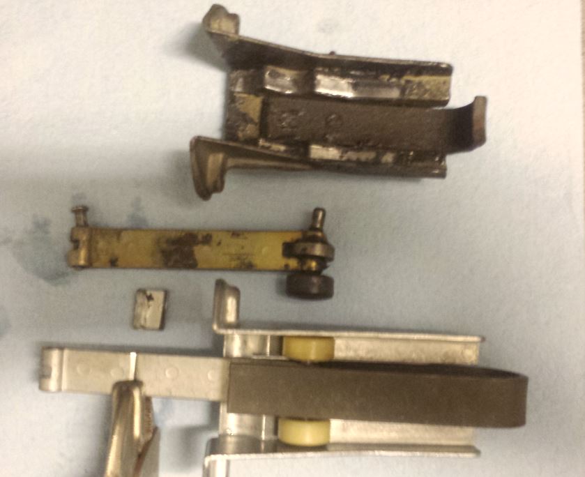

Hmm...interesting Chris! Maybe the curved arm has a drastic effect on how far the door opens. So the top brake on the pic you had posted is for the 320i?
Chamonix_E9, would you mind posting a pic of the E9? in question brake you'd bought? Just want to see how all these door brakes compare. Thanks!
Bert, yes, but the bend is pretty minor. Bought it on eBay and advertised as for a 73 but the end had been ground to the 18mm thickness.
Drew, don't know about the e3, the MB door stops (search using that term) are pretty cheap on eBay and worth a try.
Sure no problem, here is a picture. By the way, the BMW parts department is still saying I/we am/are wrong, while the dealer did the courtesy of ordering a second set which turned out to be identical again (so still wrong). As a result, BMW parts department are now going to investigate it using my chassisnumber (even though as far as my knowledge goes, this part was completely unchanged for the whole modelrange from 1968 till 1975...). Will keep you updated.

And here is the pic with part no.
Compare the difference with Bert's picture.

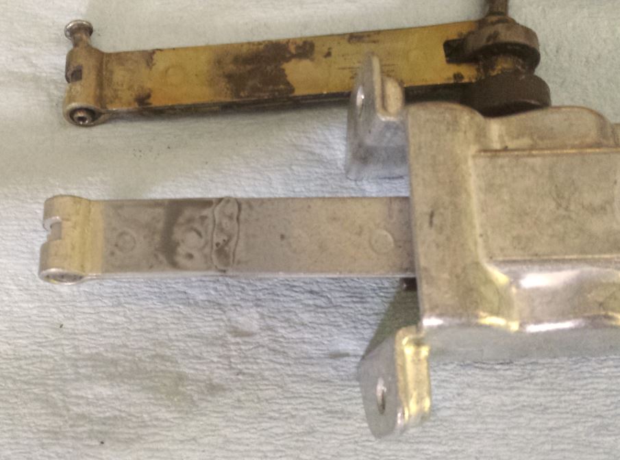

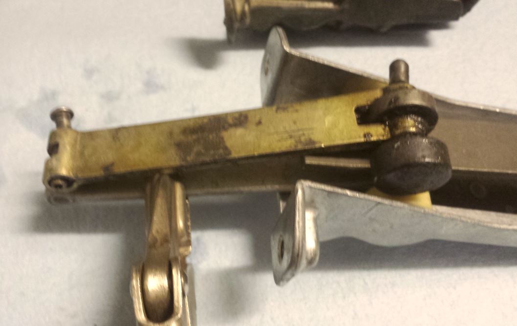

This thread has been helpful, but there is a lot of "it should fit", and "I've bought it, but haven't fitted it yet".
So, I have done some research on my own, and happened to have doors from a Mercedes W123 wagon in the barn (1984 230TE).
The stoppers from that car fits the coupe like a glove, with only minor modifications.
The arm is 80mm long, and the coupe original is 85mm.
Can't imagine the door opening more than it does now.
They're perfect, and look stock too.
I ordered a set of new ones for $37 on eBay, and the part numbers are:
Mercedes: 123 720 05 16
Meyle: 014 072 0034
I had some plastic vacuum tubing that fit the new stoppers, and made new bushings by fitting it and drilling a 5mm hole to open it up.
Since I don't have the pins, I used M5 allen bolts and lock nuts.
I had to grind away some metal on the stoppers to get the correct angle on the arm, but other than that it was a great replacement. No grinding to the arm itself.
See attached pics.

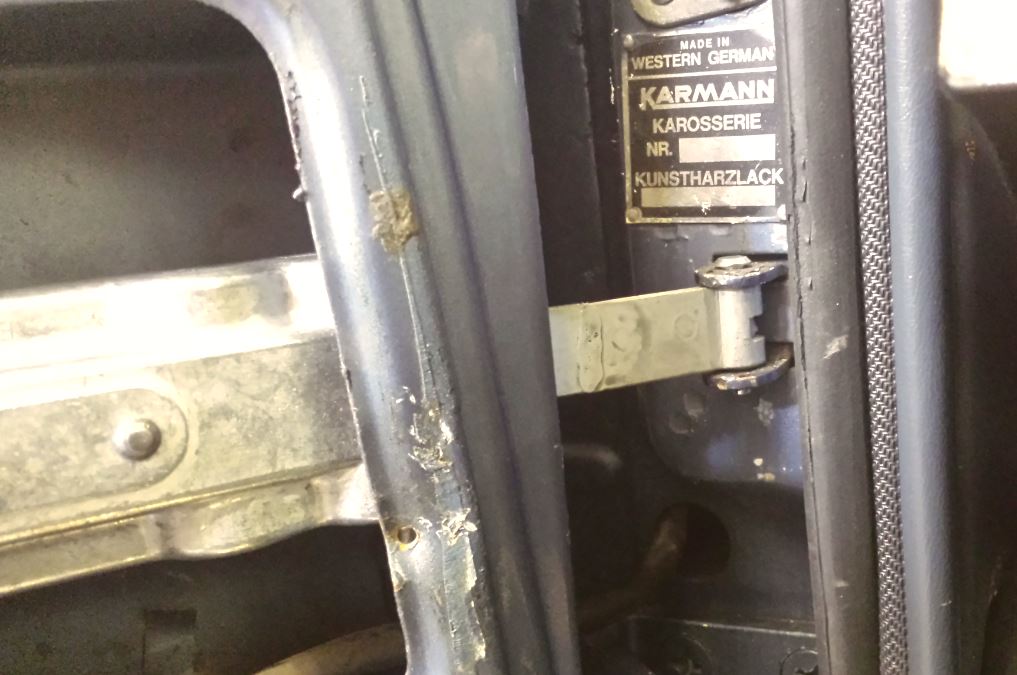

Just did this last month. From input in the Forum here, I ordered the MB unit, from Autohauz AZ, Meyle, p/n 126720016, $18.30. Fits perfectly in my driver door.
(Sven, I know you wanted to know when I would get to this, signage at judging to beware the uber-opening door was getting tedious) Mike
Too long but can be made to work
I got the newer BMW (E28 I think) brake from Jim at Mesa Performance (he knows the part number). It was not expensive. It is a bolt in replacement and comes with the nylon bushing and new pin. My original pin was bent and it seemed easier to buy the BMW part than trying to straighten the pin and source a bushing for the MB part. The only issue is that the arm is too long. A quick cut, weld, and cold galvanizing primer fixes that in a few minutes. I found it to be an easy swap.

I installed a pair of the MB door brakes over a year ago. They fit and work perfectly for me. much more robust design than the original e9 brakes.
Gary
Following Gary's lead, I too installed a set of MB door brakes. As noted, you need to toss the plastic sleeves that come with them, and make up some sort of a sleeve for the door pin, but other than that it was easy.
