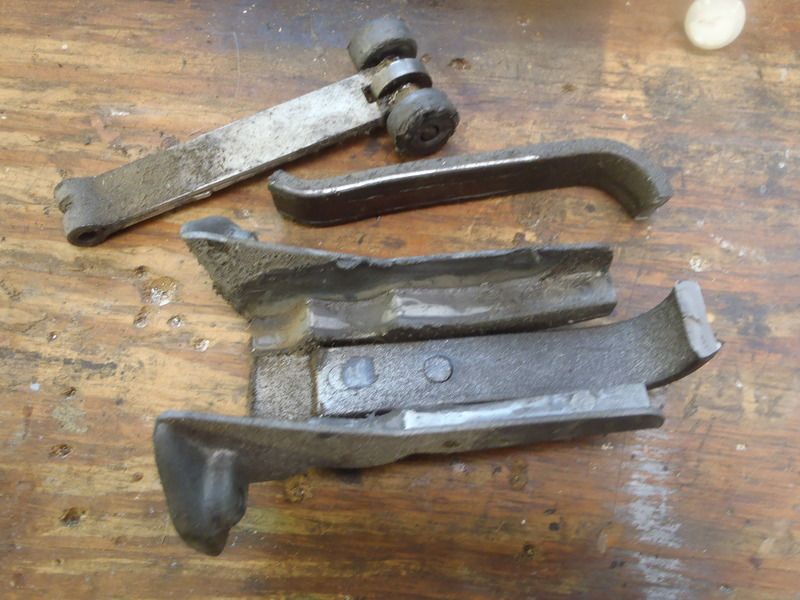

An update here. I just bought the MB (shudder...:p ) door brake and installed it. Worked a charm. I got the spacer for ACE Hardware (the restorer's go to) and drilled it out like described above. Mounted the DB with the open slot towards the interior. Job done!
The OEM BMW brake is truly a POS break. Just check out the little wheels that the lever is attached to. The spring broke at the curve. I first thought is was high cycle fatigue but then I remembered it is from a passenger side door! Huh? Anyway, I expect many years to come with the MB unit.

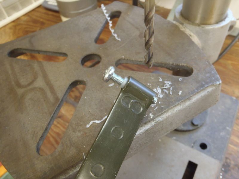

Drilling out the spacer. 1/4" OD, #5 wire drill for the hole.
Door break
Nice, I used an e24 door break because my "new" BMW one broke with very little use on it. I had to drill a hole in the arm and put a bolt in there to stop it from opening too far but it works much better than the original and it's all behind the door panel so no one will know... except anyone who reads this :-)
