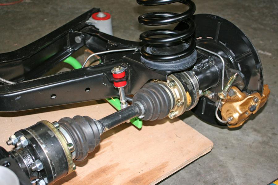

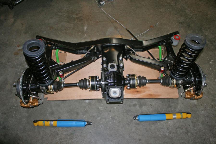

Some inspiration
Steve - Here are some positive reinforcement images to keep you going in your time of need...
