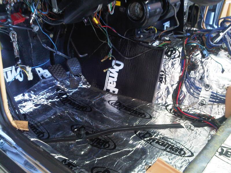

Dynamat question

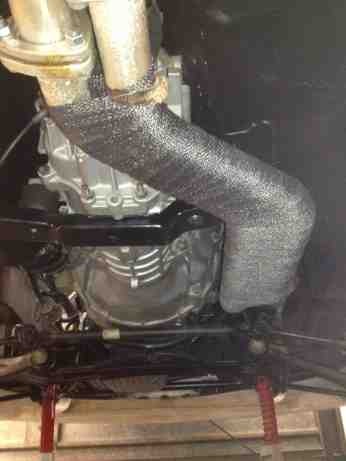

I use a thermal wrap on the exhaust from the manifold down to the 2-1 collector, works a treat, but still some heat gets through, at a guess I would say it halves the heat from the exhaust at minimum
I’m not saying your right or wrong but I’m most curious why you opted to wrap the pipes as a pair rather than individually ? Also did you wrap the front mufflers while you were at it ? My thinking is anything that can keep that heat from dumping into the transmission / driveshaft tunnel can only be a good thing, especially if you get stuck in traffic where you’re not moving much. Even at a 800 RPM idle there’s 2400 explosions every minute and a lot of that explosion heat has to pass right thru the center of the car…… keep it going as much as possible till it hits the tailpipe tip, at least that’s the way I see it. ~ John Buchtenkirch
Was a while ago i did this,wrapped both because it was the easiest and used less wrap I suspect? Can't really remember??
And no, muffler not wrapped because I don't have one, twin down pipes feed into 2 1/2 inch dia pipe, and then into single rear muffler
Sounds real nice without bing too noisy

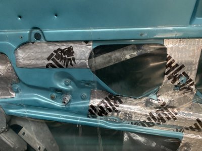

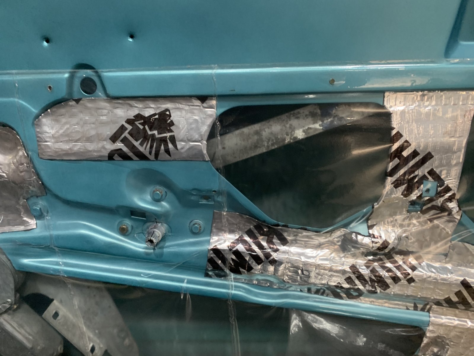

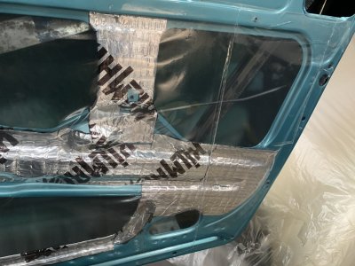

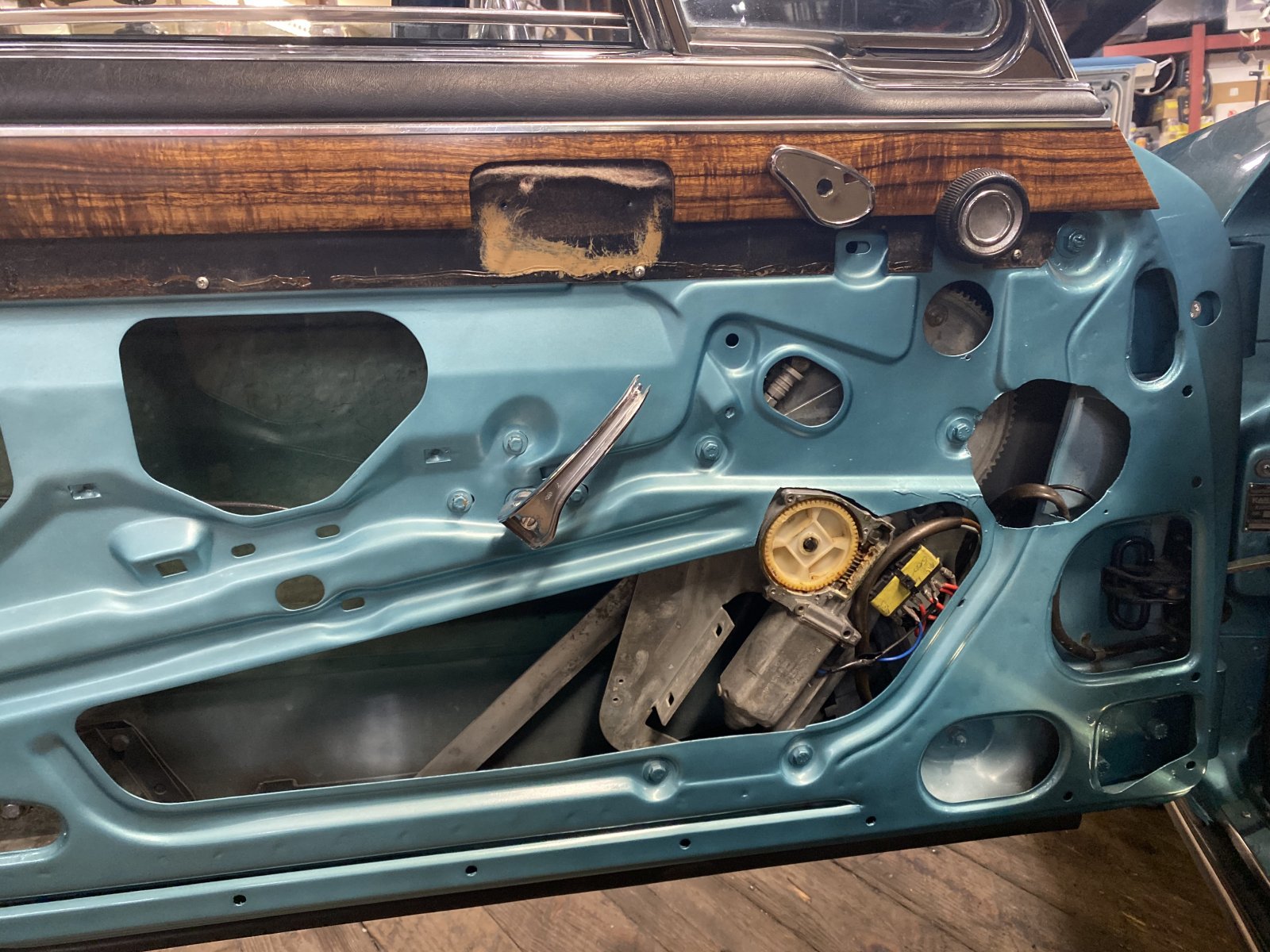

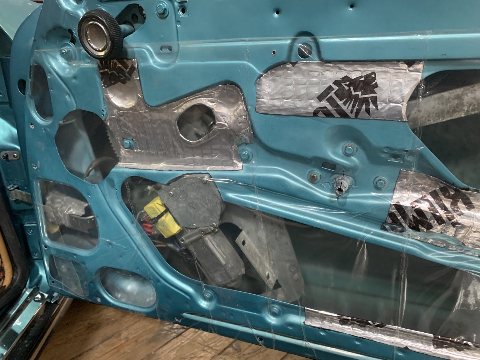

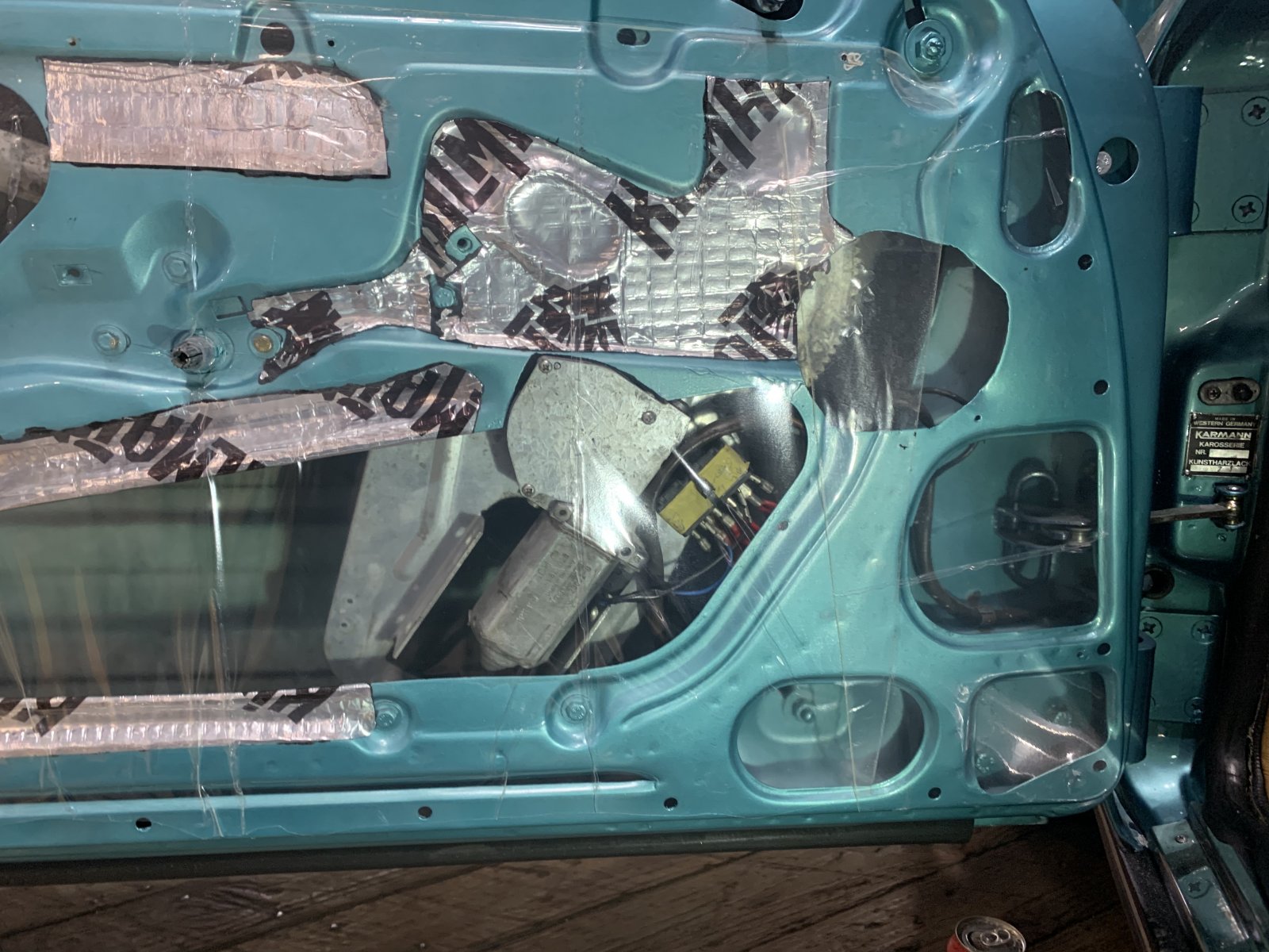

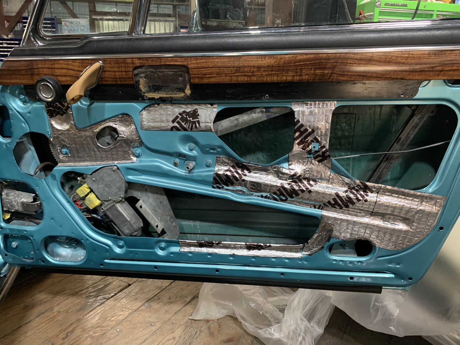

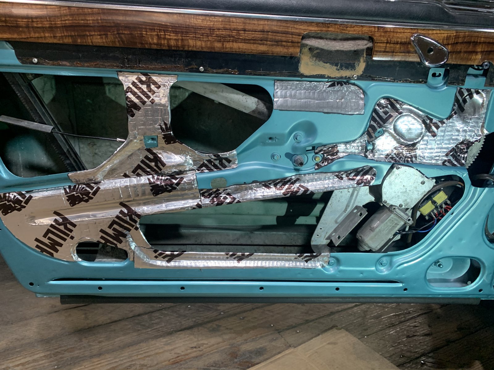

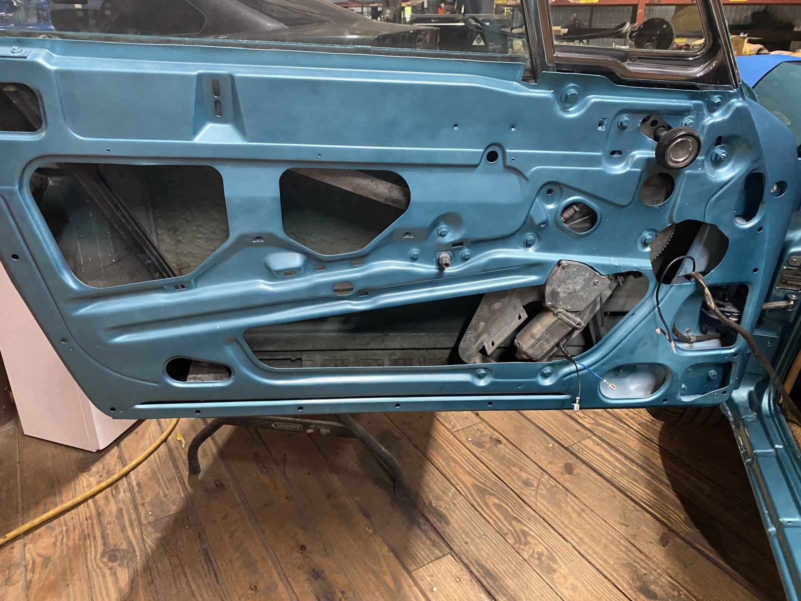

Has anyone put sound damping inside the door pannel. I just got the door liner from Alvaro but was think of putting some sort of dampaner on the inside of the door areas I can reach in
Yes...I put a 12x12 or so section on the door skin after reskinning my one door.
Then sit inside and slam the door with the door panel off and watch for what vibrates on the inner steel section.
A few strategically placed small pieces really dampens the vibration.
I believe the E9 came with sound deadening material in the door. My 72 bavaria did also. Some form of butyl liner but with age, it actually slid off, found it in the bottom of the door looking like a Dead Sea scroll. My E3 and E9 have updated sound deadening material in the doors, did so with my 67 Mustang too. Love the thud when closing.
Do it!

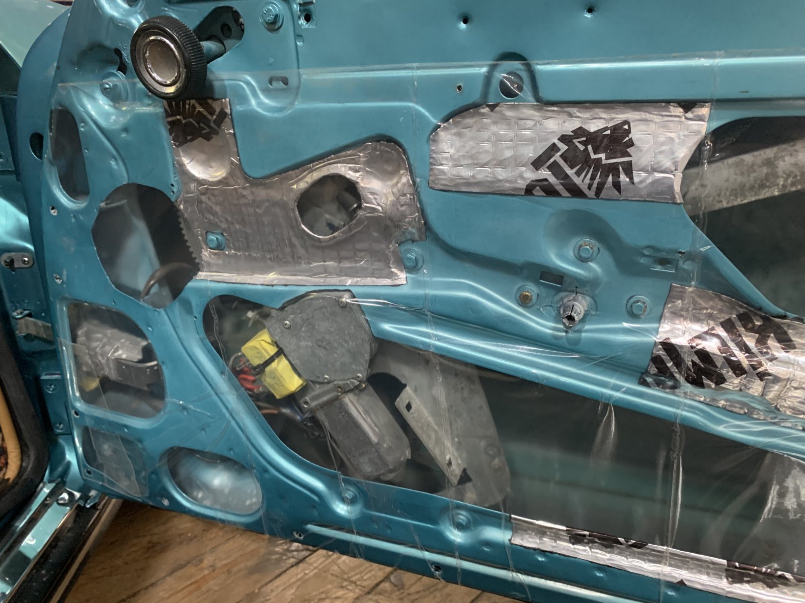

I added some "damplifier pro" to the inside of the door skins and "overkill" to the space between the door card/panel and the vapor barrier. There is no magic bullet to reduce noise, but...as long as you are in there...
I have not, but it is a good idea. For low frequencies, you don't need to go all the way to the edges. You can accomplish a lot with a piece (say 12 x 12 perhaps) in the middle of the door skin.
I put the matt pieces in my doors also. Please be careful that they do not interfere with the window mechanism should they start to peel off in the future.

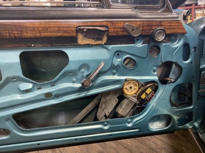

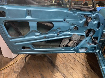

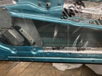

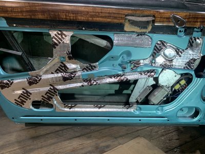

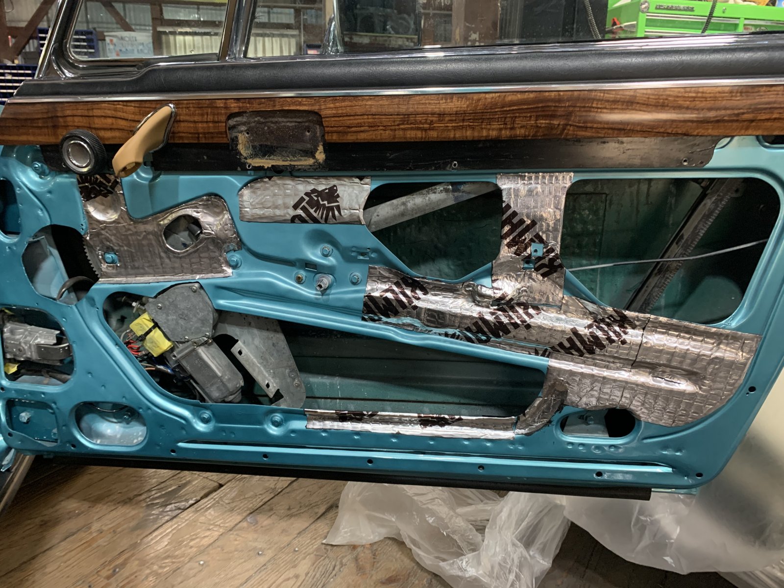

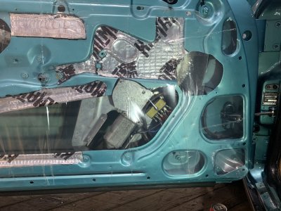

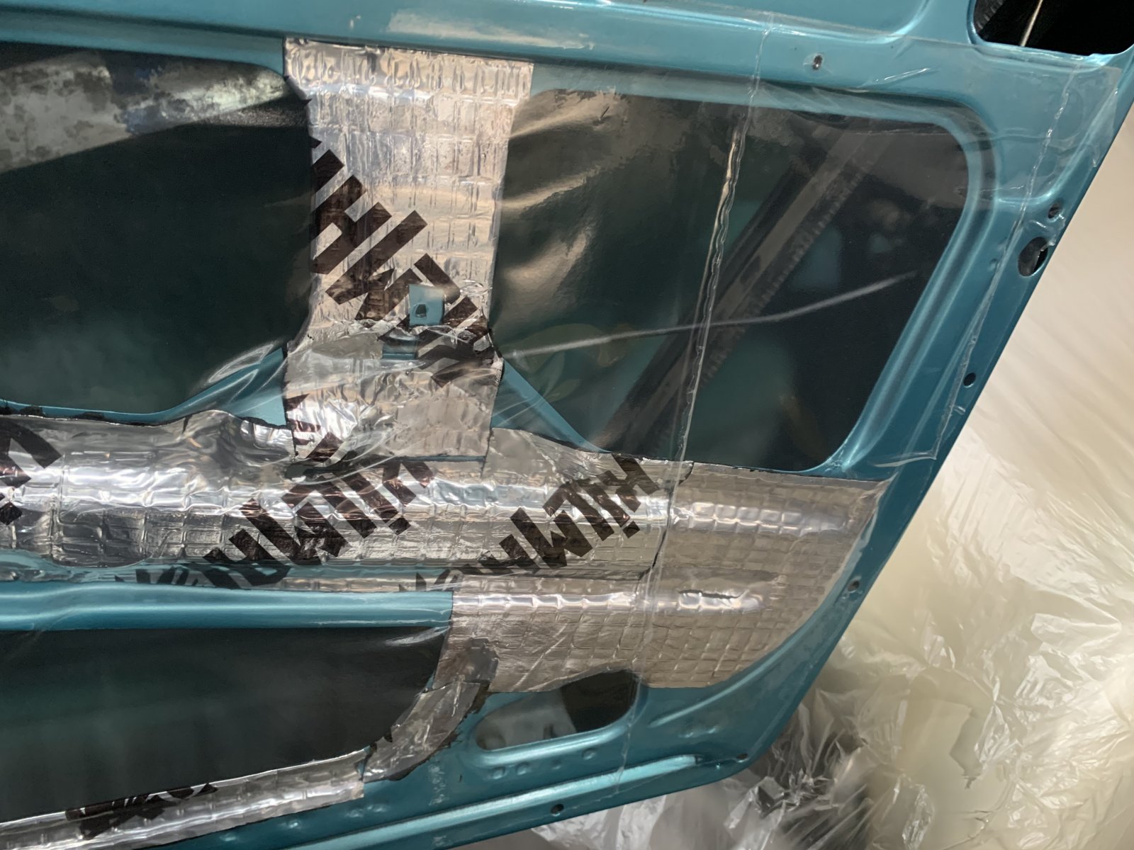

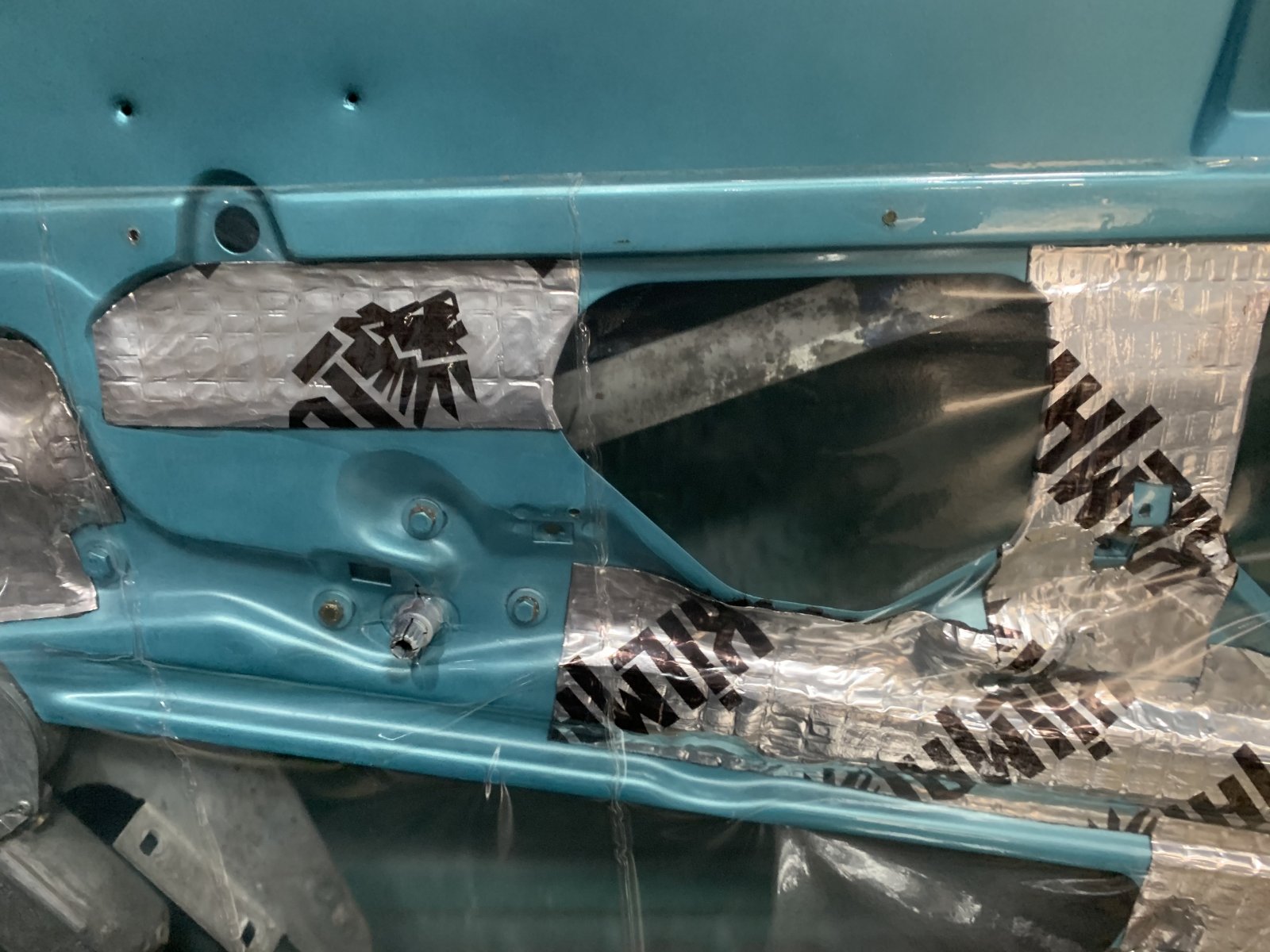

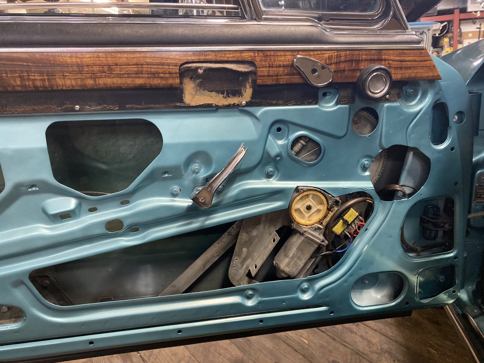

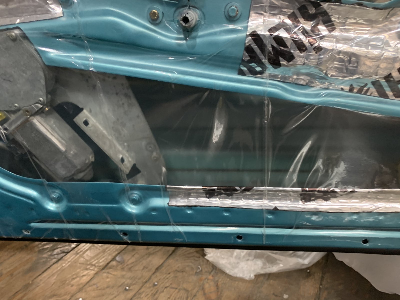

These pics also show how the door structure is cut to accept the E28 rear door window motors. You can also see the required vapor barrier applied around the outer edge of the frame.

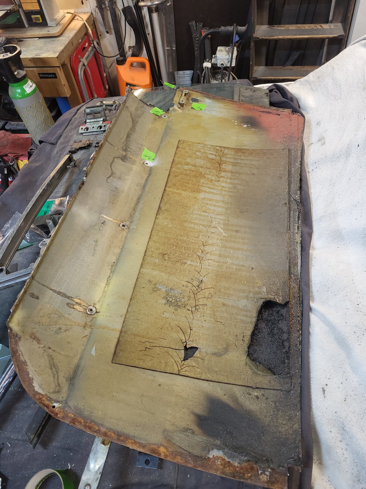

The outer skin is prone to vibrations, being a weak floppy panel. It has, from factory, a heavy bitumen sheet attached to it. It's 33 by 70 cm.
The inner door frame has more internal strength due to it's shape with various depressions hence it is less prone to resonate. Modern (luxury) cars do have some sort of sound isolation there but mostly they are of the soft foam sheet from, doubling as moisture barrier.

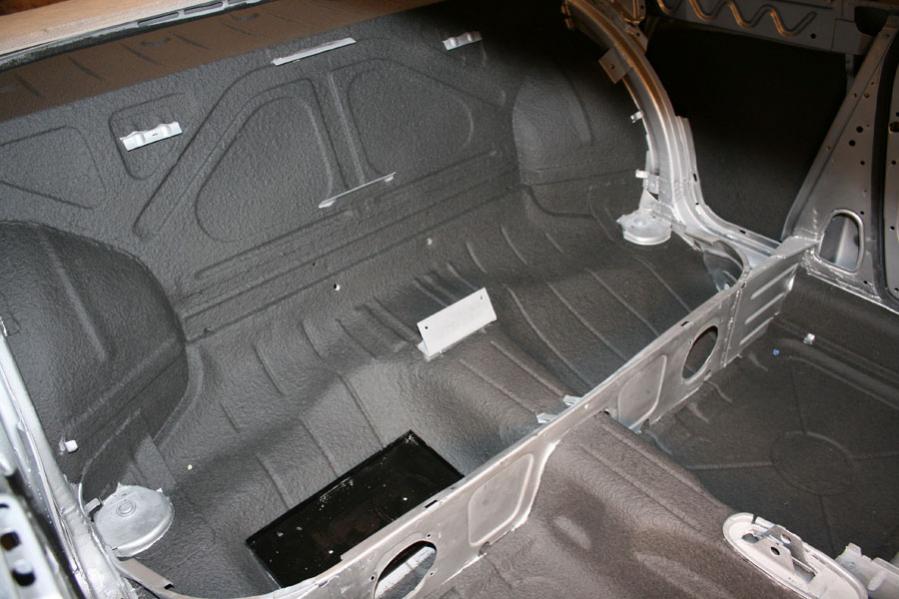

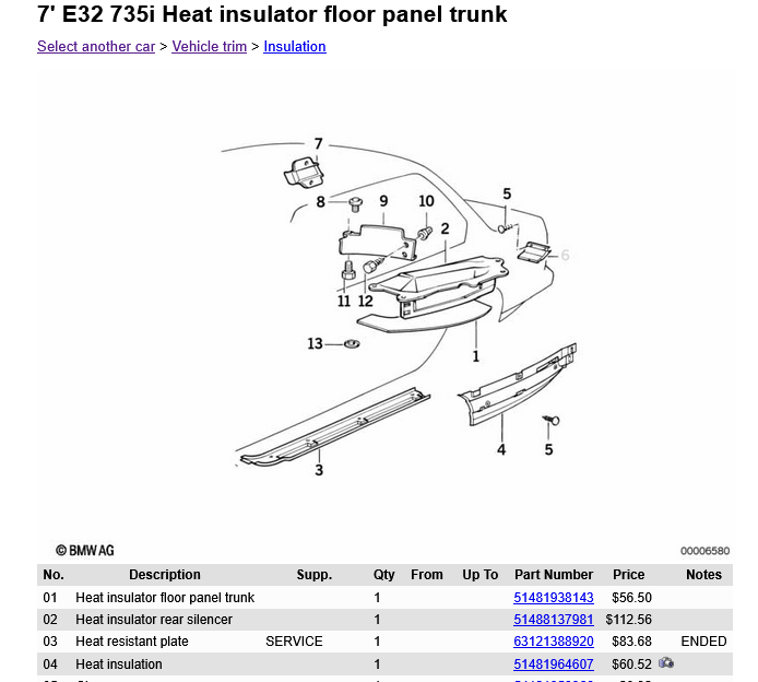

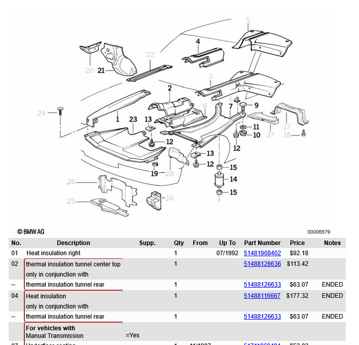

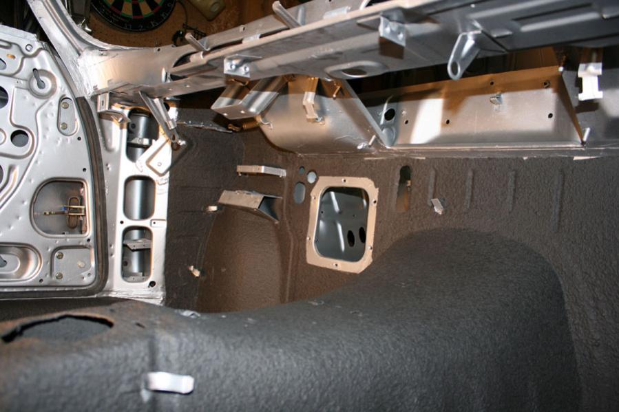

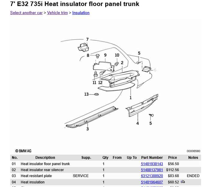

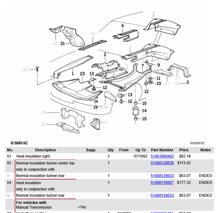

VB1X 1G vibration dampening compound sprayed throughout the interior with ceramic coated manifolds and an acoustically insulated heat shield off an e32 mounted above the center muffler.
@sfdon, trying to find the heat shield you mentioned for the e32 - is this it? (#2)
or is it one of the ones from up front?

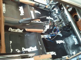

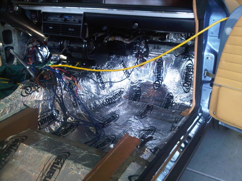

i also have the vapor barrier from @alprada70 ... i have been wondering if placing dynamat under the door panel (attached to the door) might not reduce noise / vibration. you have to remember that there is a lot of space / volume inside the door for vibration to create noise
Scott - I modified a Z4 heat shield very similiar to the one in your picture for my car.
We paint the inside of the door with VB 1X or similar
