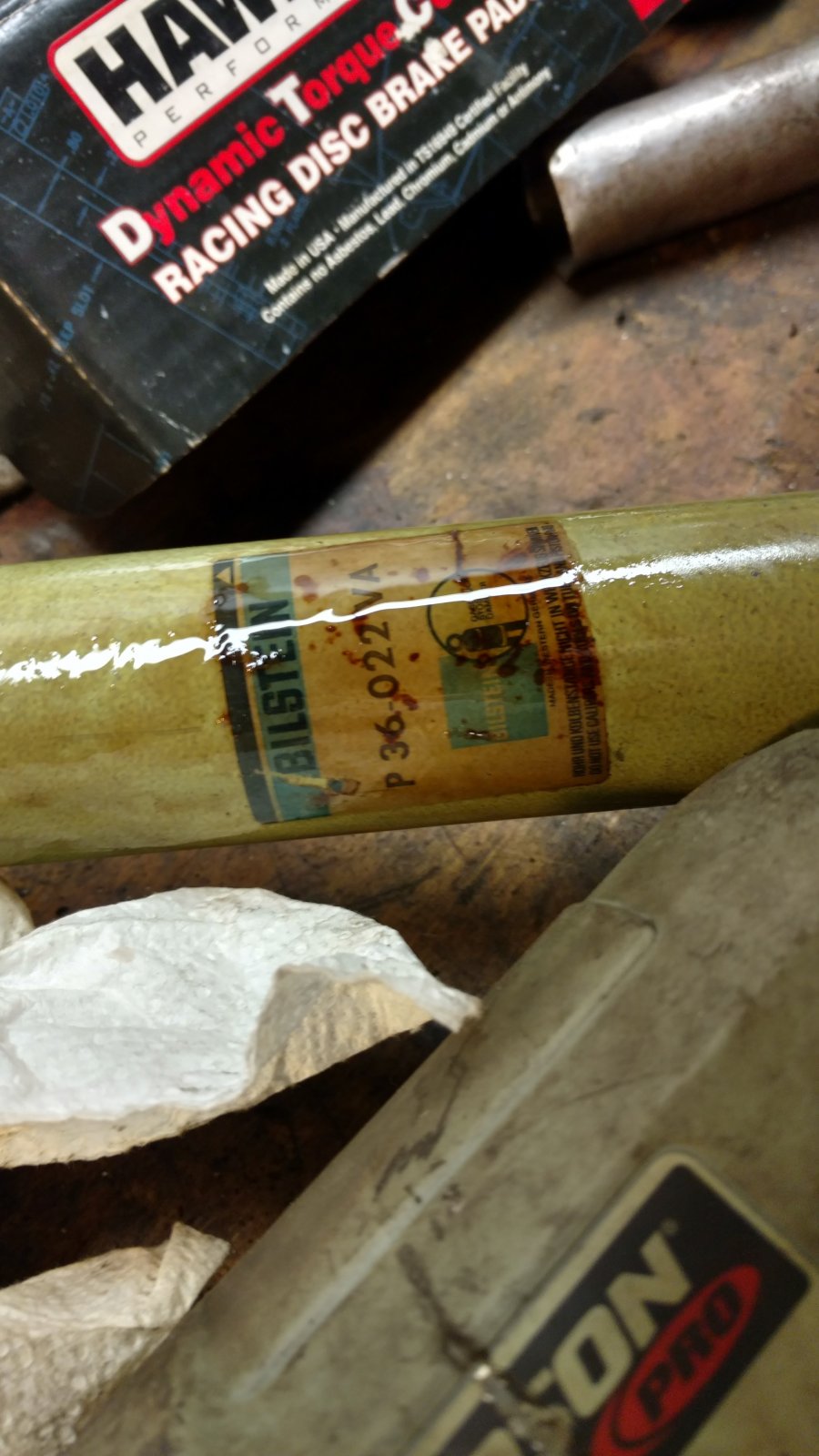

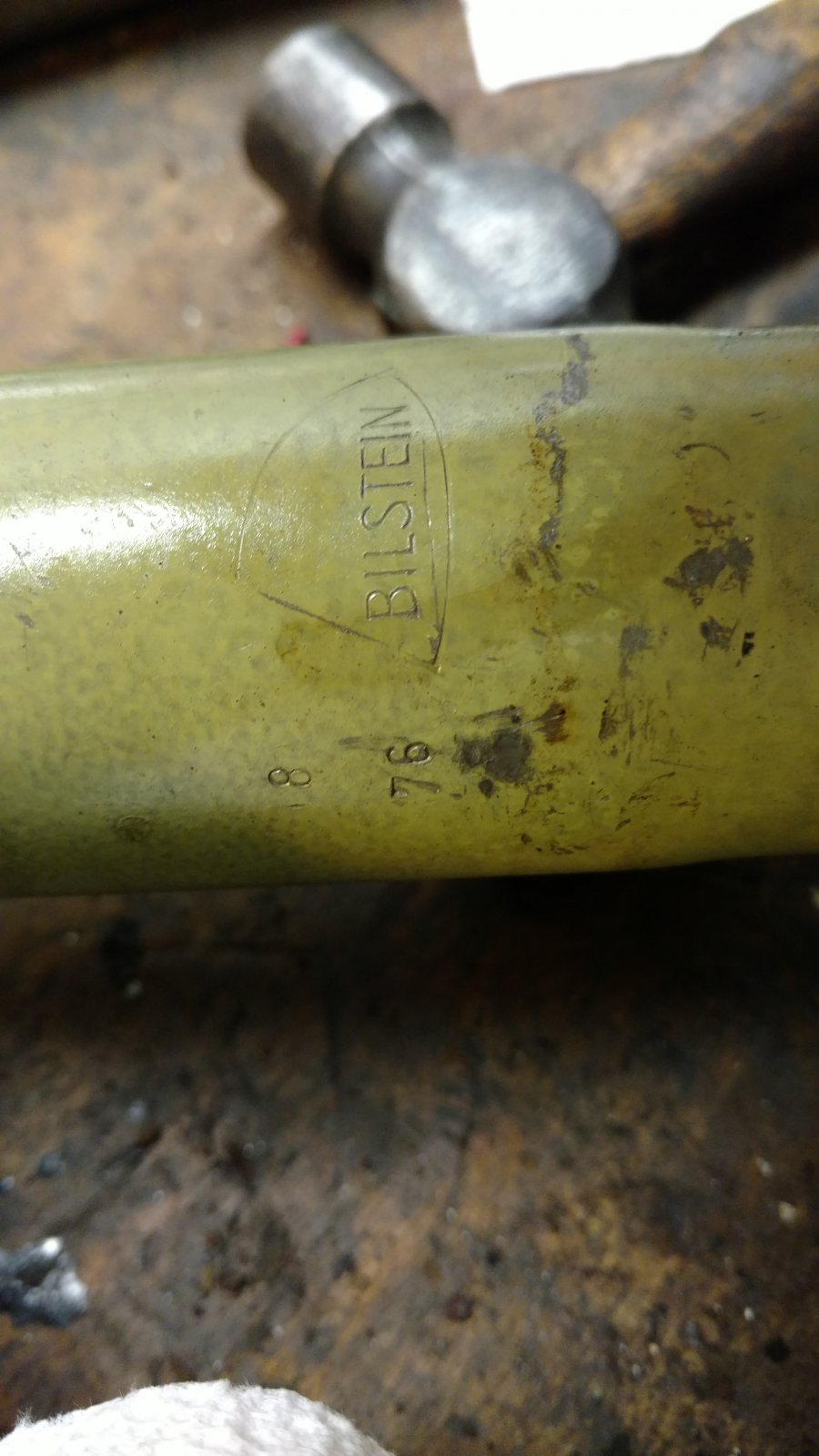

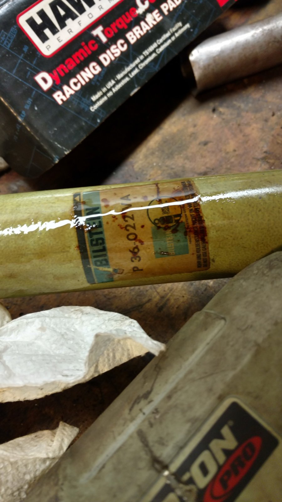

FWIW I found these in my 1/72 Bav...
They appear to have a 1976 date code.
Is there a potential problem in using one for an M-series car which would be heavier up front and also by default, have a firmer ride?

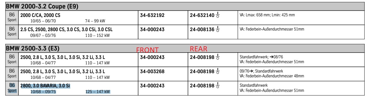

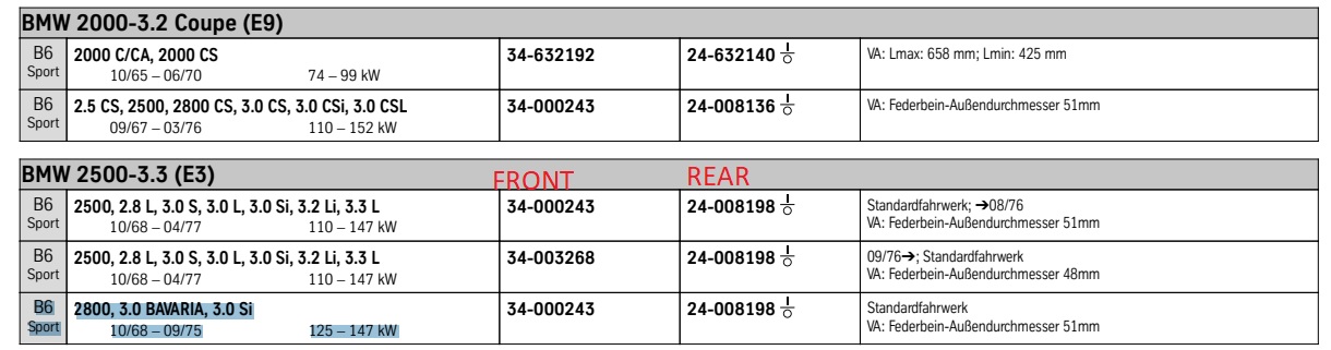

So, a quick update. We established that my car has E12 type front strut tubes with the 48mm gland nut. Great, so this means that an E12 Bilstein will fit.
What's not so great is that nobody has any. Those suppliers who say they have them on their websites etc then confirm that they have no stock when I call them.
