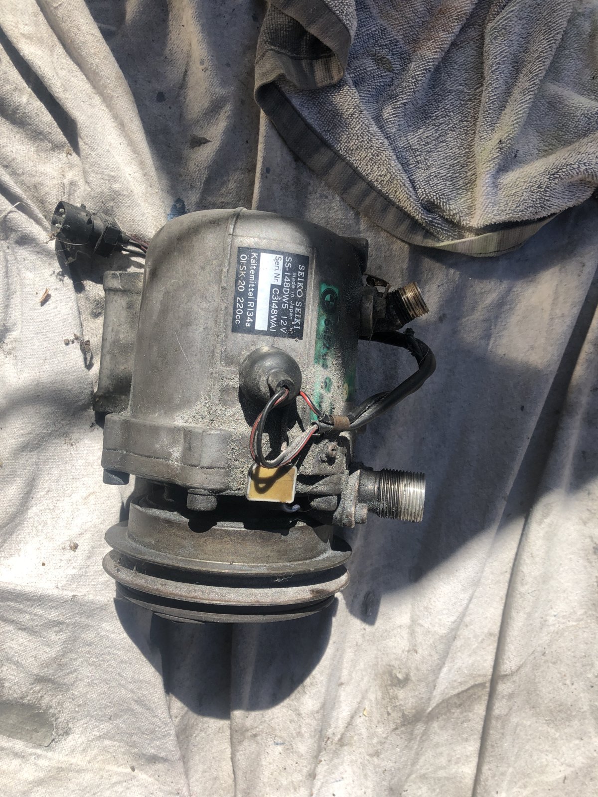

Anyone know if one of these seiko pumps with the associated bracket would work? My car has a b35 and came with one of these originally when in a 735
Ohmess
I wanna DRIVE!
4,887
2,706
Aiken, SC
Those Seikos were pretty robust, and probably can be made to work. The issue is going to be how efficient it may be, which probably depends on how old it may be. I would check the age of that thing and go from there. More than ten years old, just get a new one.
The Sandens can be made to work with either R12 or R134.

I bought a reconditioned Seiko from Mesa, still going strong after 7 years. If it ever fails I would buy a real Sanden.
