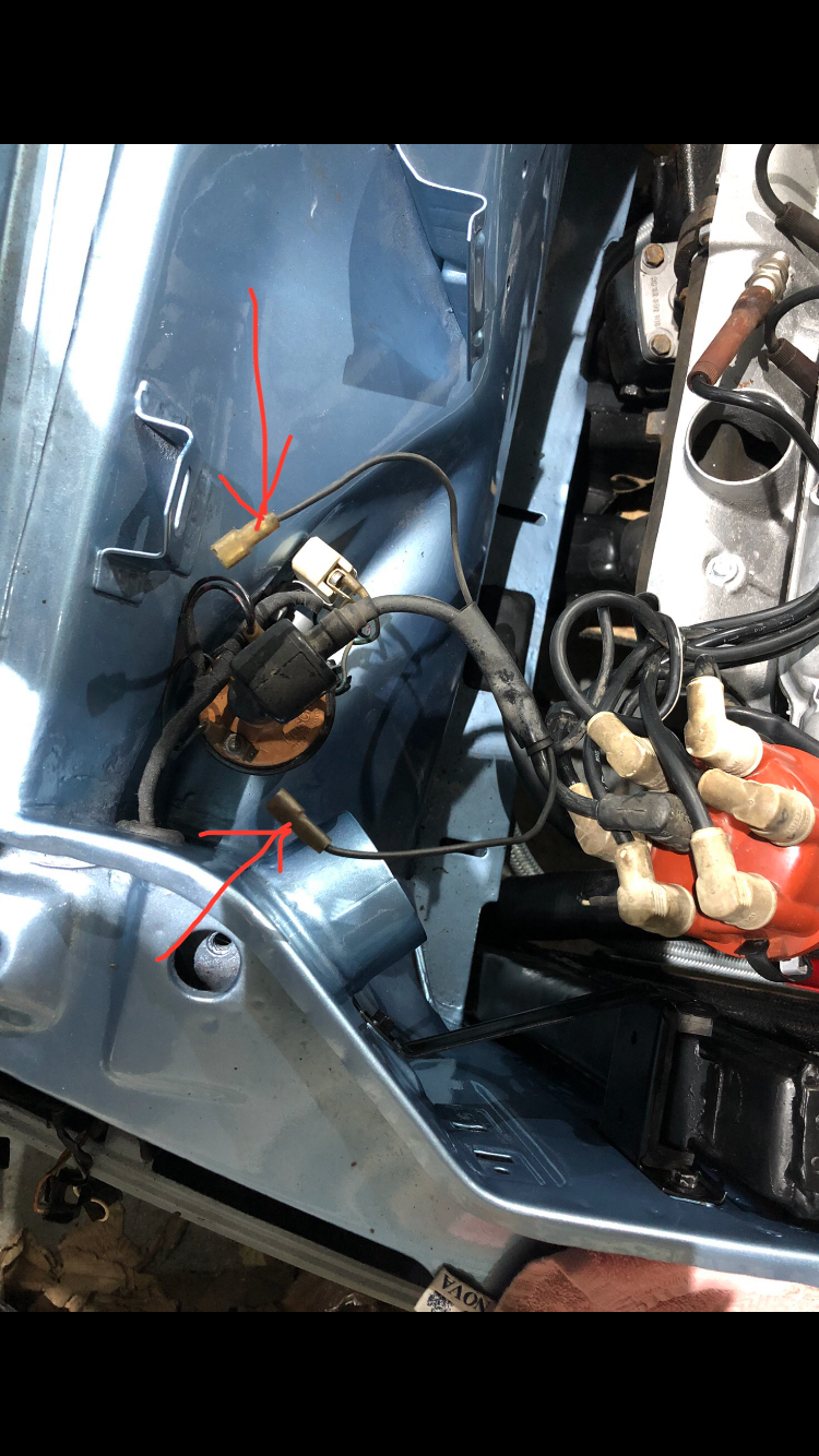

Hi guys,
I am having problems with fuel relay. Or at least I thought so since it fixed my problem once I replaced it with new one but same problem came back. Now it does same with new and old one. They both work ...if one works and i swap it with another one that one also works and the same when both dont work.
When car does not start (fuel pump does not turn on) fuel relay gets no power and after I jump it fuel pump engages and car starts and works. Often after that fuel relay is working for a while but than same problem occurs.
When relay is dead there is no voltage relay ignition + terminal (86).
Now I wonder do I have bad igniton switch or power suply comes also from somewhere else?
