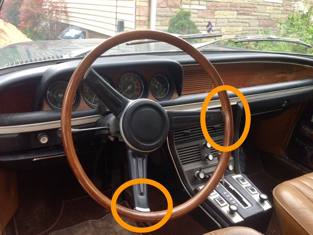

This is my set up now. Does anybody here have those aluminum trim on the steering wheel? I might just keep them if I can spruce her a bit
There was a guy in Europe who had them for sale on eBay earlier this year. Do a search here, I think it will show up. I purchased some from him - they are beautiful.
