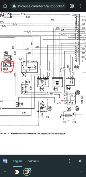

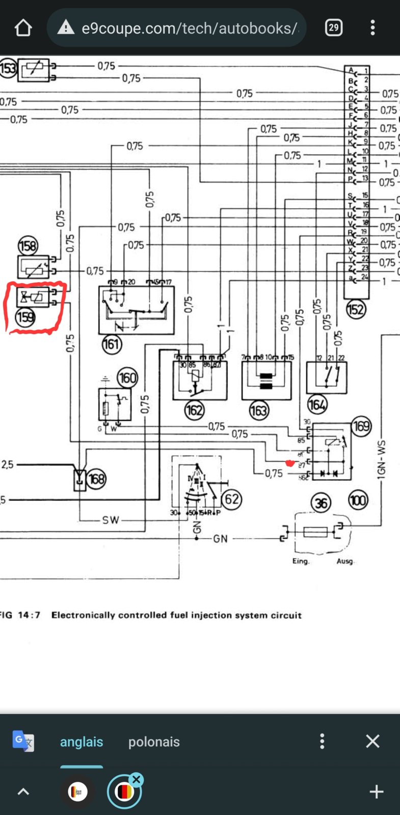

You know what is looks like the part 159 this one it takes pin 87 have you got a photo and emplacment ?
In my memory we checked this one it was good but I think the problem is the oxydation on the 2nd relay connexion with big oxydation on the connectics and in the relay connectics.
So what I call 1st relay with red wire from starter the "main relay" is functional and operate the 1,3,5 cylinder
We try with both the car is running on half cylinder
Then we disconnected the main relay the car stops.
So we opened the 2nd relay 169 cold starting relay which is next to the main relay
We stick the contact of relay manually and the car was running on all cylinders
So our conclusion is that he operate the 2,4,6 cylinder.
I will try tomorrow to take out all connections from the plastic where wire are plugged and try to clean the relay connectics also.
I don't know if by brushing it and contact cleaner it I will bring it back to live but I will try to do that in a proper way.

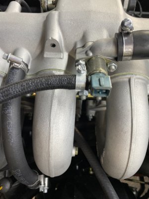

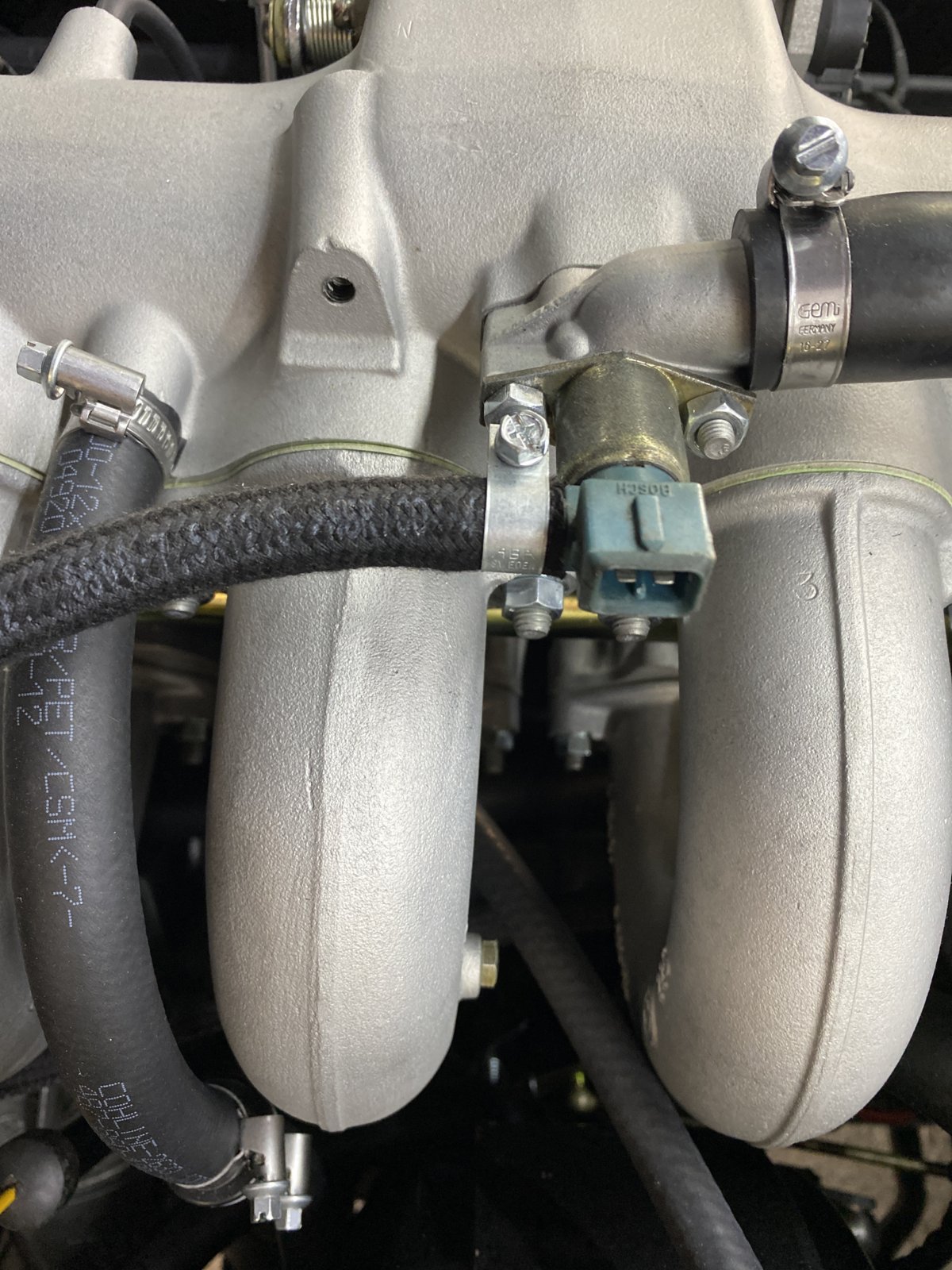

Sorry- that is a wrong conclusion.
You are now running on all 6 cylinders because your cold start injector is running continuously.
You are flooding cylinders 1, 3, 5.
I sent you a picture of the cold start injector - disconnect the plug and you will run on 3 cylinders once again.

Do not keep the cold start injector running- it will eventually fill the cylinders with gas and ruin the oil.

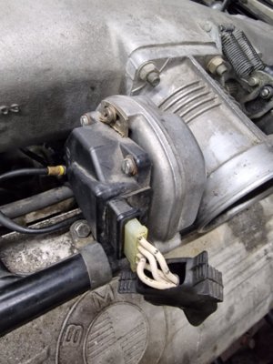

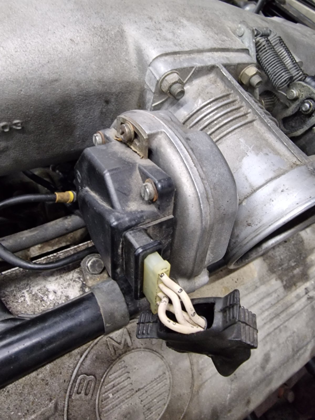

Hello the problem could come from the throttle cobtroler ? If it's possible how we can control it thank you by the way
The options for you….
buy NOS
Take apart and clean- you can do it.
Send to Netherlands for rebuild.
The TPS I believe is not the problem.
Disconnect computer and test all 6 wires on injectors 2,4,6.
3 wires should be “open” and 3 wires should be “ground”
