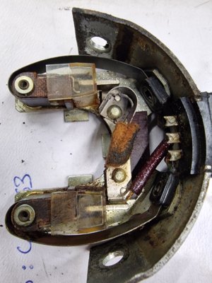

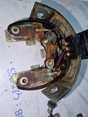

Hello again new week starded for me in garage and I get new things and probably the solution for the problem of that car I command a pulsator inferior part of distributor i dont know how you said it in english photo bellow he is oxydated and coals are used

Yeah thanks !
my colegue make me do a mistake by telling me the distributor was new yes he is new but only the top part of it not the inferior part i will do a new post when I get the part and put the new back in it hope it will turn right !
But it was a pleasure to work on that car and see the old techonolgie ;)
Originally these points didn`t have the plastic protectors on them and so often got contaminated with oil causing problems. Mainly caused by people putting too much oil into the top of the distributor shaft under the rotor.....
