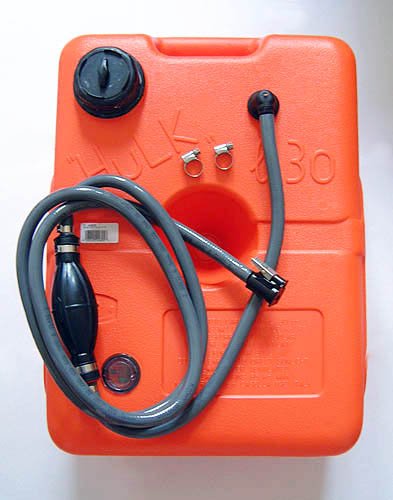

That's great idea. That's how I drove my car home from the seller. I didn't want to suck up old gas. It's not even rigging per se, and it is super easy. Just unplug your fuel line from the manual fuel pump. plug the line with an 8mm bolt. Plug your gas tank fuel line into the mechanical fuel pump. You want to use an outboard gas tank with a hand pump to prime the system, as seen below:
