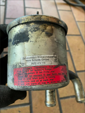

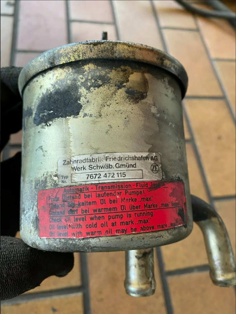

The power steering reservoir is the same for this Maserati:

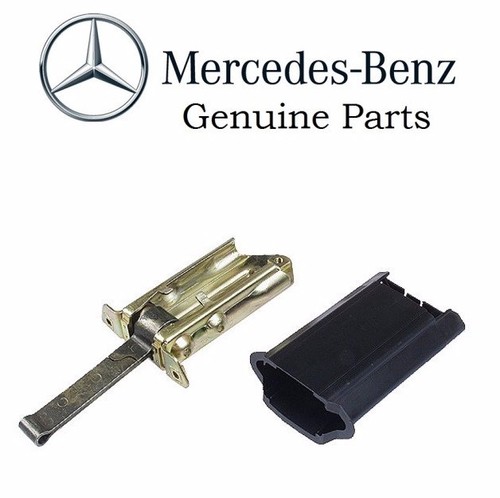

I hear a lot about Mercedes door stops for our E9's. @HB Chris discussed these in Sept 13 2012 in this thread:
@DougE pointed me to the part but I can't find his DM.
Here is the part:
Maybe wait to hear from more experienced members :)
