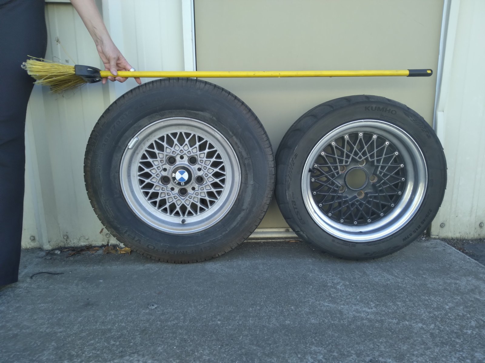

Thought I'd post a visual on the topic. Pictured are a 14" BBS with 70series tires next to a 15" wheels with 45series. For my street set up, I like the taller side walls for the period look, added clearance (speed bumps can wreak havoc on lower cars) and wheel protection from road hazards. For the track, well, there is a greater selection of performance rubber options for a 15" wheel.

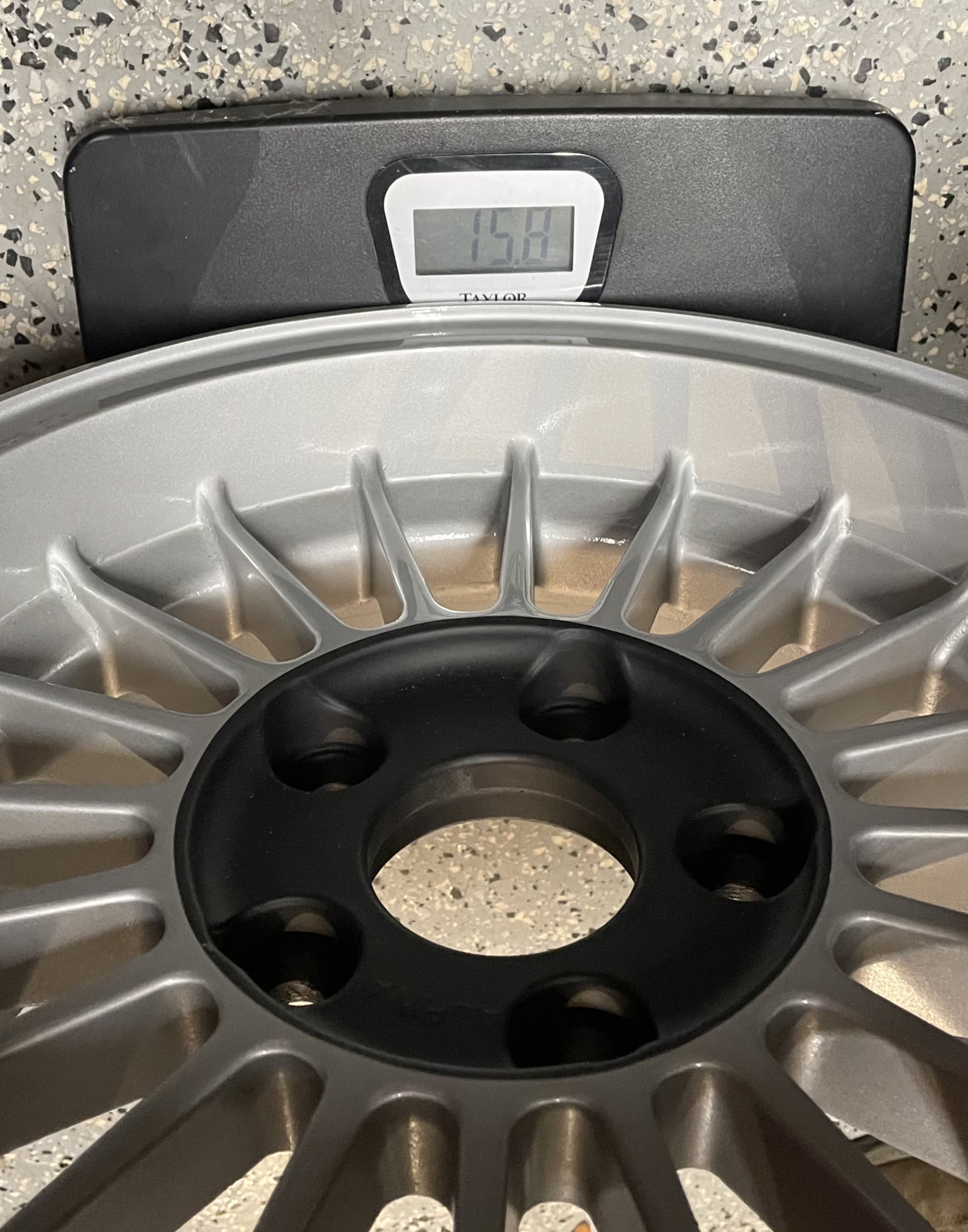

My 50yo 14x7’s weigh under 16lbs each. A 17” BBS RC090 weighs 21lbs, which honestly isn’t bad for a 17x8 wheel. That’s because BBS makes them. You can expect to find 25lb+ 17’s and 18’s. My RC090’s felt like cinder blocks with 235 rubber on them.
