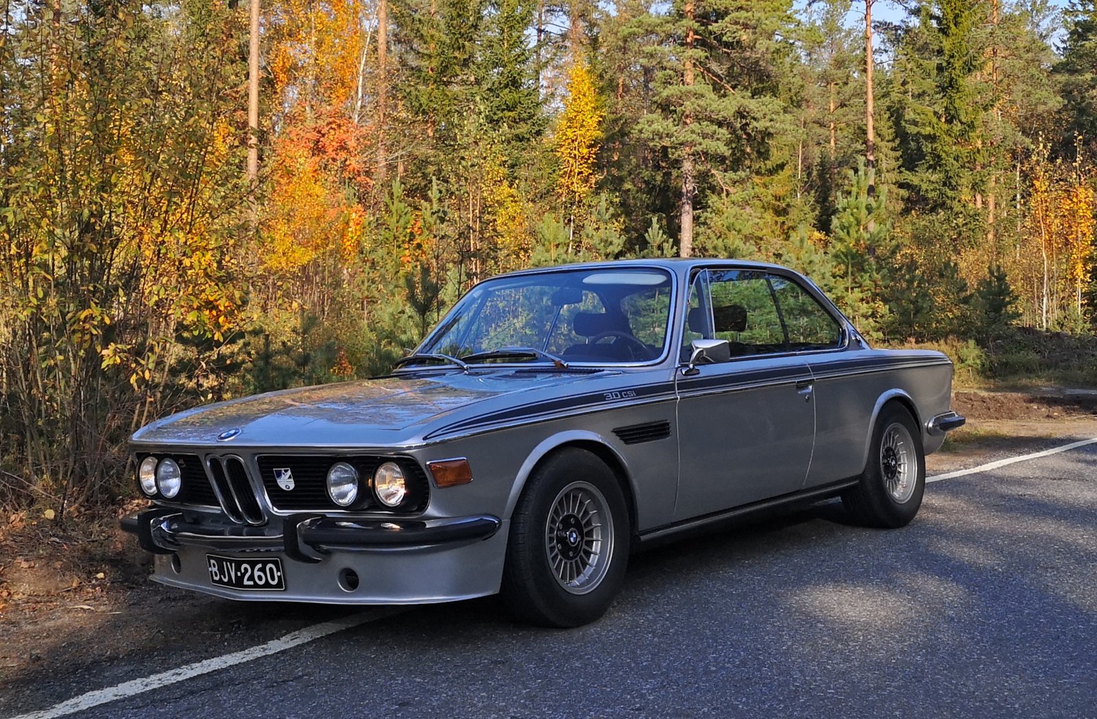

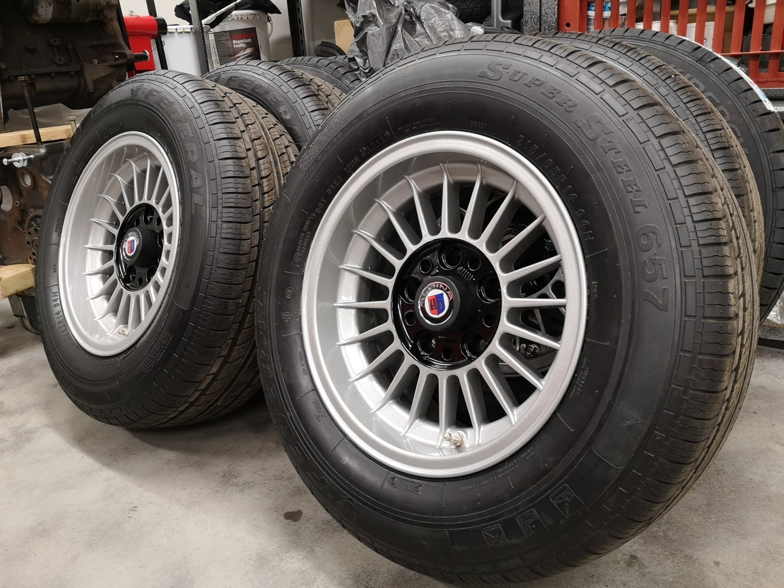

To me, there are at least 3 considerations that go into the overall “look” at the heart of the question you are asking about. My advice is to consider all 3 while deciding what you want. I believe those factors are a) how the rims look with b) the ride height/ stance, but not talked about as much (but to me nearly as important) is c) the look of the tire. I happen to really love the Pirelli CN36 look. The tread pattern screams VINTAGE! That, with a lower stance and Alpina 14’s was my choice. But I have to admit that 16s look amazing when set up properly. Good luck with your choice.

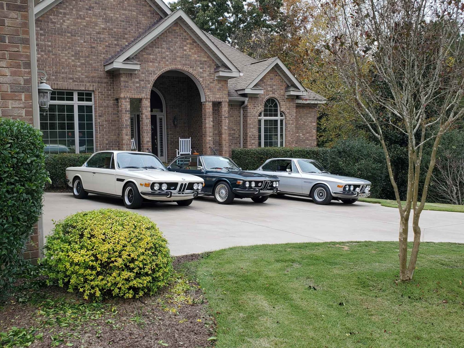

You've described Stevehose's setup. Here's a picture I took on the way to Hilton Head:
For comparison, here are three coupes with different sized rims. Steve's car is farthest away; 14" Alpina rims and Pirellis as noted. Tom's car in the middle has 16" BBS wheels and Dunlops. My car has 15" Weds with Toyos (which are not great looking tires). All three of these cars are lowered, so this gives a very good idea of how the different sidewalls change the look of the car.

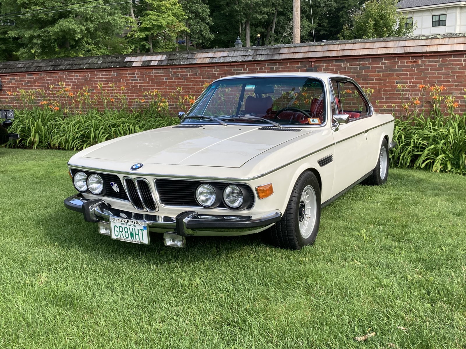

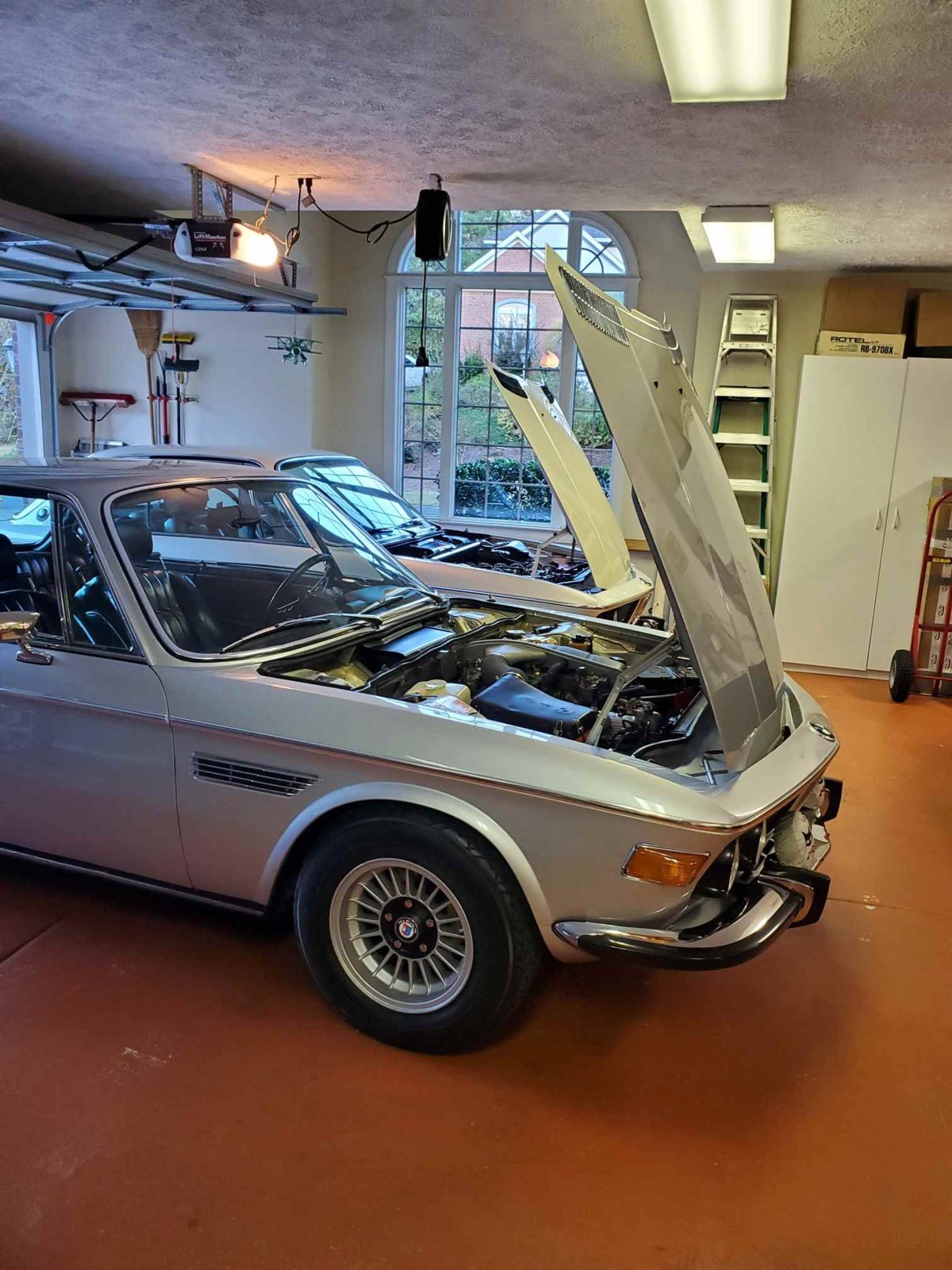

Are your's E9 fenders rolled?
No, I haven't done anything to the fenders myself.
The upper part of the front fender lip is pointed a little bit upwards and not quite parallel to the ground, but then again I don't know how they looked from factory.
The car is currently sitting on -40mm H&R springs and fixed negative camber plates.
It looks great. I'm about to install -30mm springs from Jaymic and Im currently on 14" Alpina from W&N with Pirelli CN36 205/70/14. Could you give me a link for a proper camber plates for my setup?

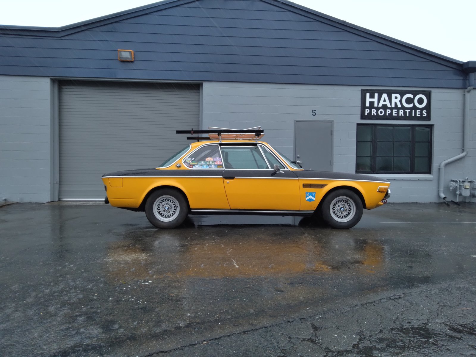

Hi, I did say 70s. These tires & wheels came on my E3. I put them on my E9 for giggles and speed bump clearance and have had no clearance issues. FYI- my fender lips were 'enhanced' by a PO many, many moons ago.
Nice, looks very old school rally. I appreciate the roof rack. My first E9 wore one on many an occasion. The old Yakima towers and round bars sit in the garage awaiting their maiden voyage on the new coupe.

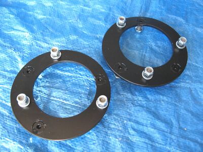

These are the ones I use on both e3 and e9:
There are adjustable plates on the market as well, but the fixed ones have worked great for me.
