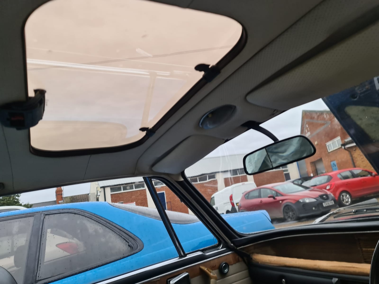

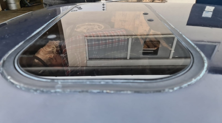

I know you all love this sunroof ;-). So start strip car tommorow to see what's lurking underneath. ....

Oh by the way, yes will be deleted as part of restore.
Good call , I think !
I would be interested in seeing how you delete it
Mine has a factory metal sunroof, but the roof skin is rusted badly around it .
So I will have to work some magic to bring her back .
I do want to keep the sunroof and I have a roof off of another E9 to use for repairs ( it too has a sunroof, but no rust ! )
I am wondering should I swap out the complete roof skin ( a massive job which might be beyond me personally)
Or should I replace only the section that is rusted out . ???
I am ignoring it at the moment , as I don’t want to get too overwhelmed by it in my head :)

Welding the patches on the roof surface is extremely difficult to keep the shape of the roof.
The frame (underneath the roof surface) condition should tell. It should have to be removed anyhow for proper work around.
Much easier for the body shop is to change the complete roof as this is also an opportunity to check A and C pillar inside and protect it after.
In general it is body shop decision based on what they will find in original and donor.
I would like to keep mine in but ... rust will tell o_O
I think you are probably correct, welding in a repair could easily cause heat distortion on the panel.
I will leave that as one of my last jobs on the body as it seems like a massive fix .
Some E9s has a real rust problem inside A-pillars, so worth to check inside using inspection camera. It might be a decision point related to roof repair.
I know E9 purists which were opening A-pillars anyhow.
It is a massive intrusion but on the other side due to lack of B-pillars it is wise to have A-ones well inspacted/protected as they will impact complete body strenght (e.g door closure stability and noises from the car's body while running on bumpy roads)
I'm really interested what will be there ... The roof in mine E9 makes me scare a little
