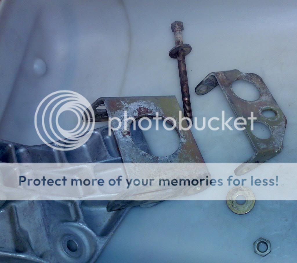

i mentioned before the matt chrome plating finish,
here you can see the aspect, the "before" is a slightly corroded steel parts while the aluminium is only dirty
after mattchrome platting of the two steel parts the finish is much better and the corrosion protection too:
