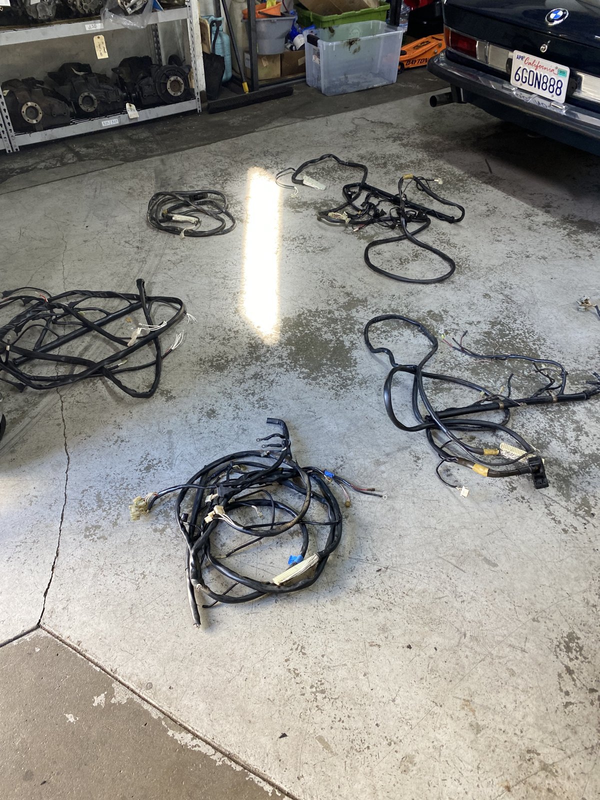

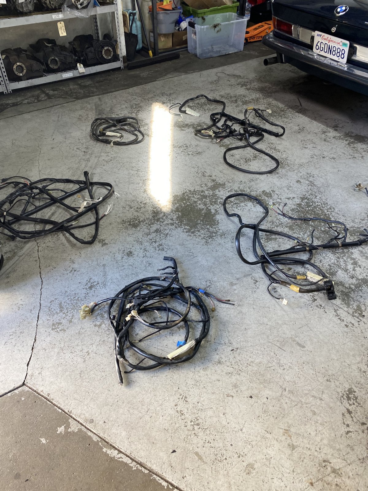

Interesting situation for you..... Both Autosparks and my local builder require a core harness to make a new harness for me. I send in used harnesses and get back new. The parts for the new harnesses only exist on original harnesses. You may be put in a position where you need a USED harness so that you can have a NEW harness. I assume your harness is toast. Post a pic?
I think I can sell you a new Autosparks engine only harness but I will no longer be able to have a core to send in- and that is a bad business model!
Or I can sell you a used harness. Not a great idea to install that..... Decisions.....
New Autosparks Engine Harness only-1500.00 plus shipping
Used good Core- 700.00 plus shipping
Intriguing, I assume they rely on the USED harness to match the lengths, cable gauge, and bundles, without actually reusing cables or connectors.
If that is the case, is it possible to order two NEW ones made to match one USED harness?
