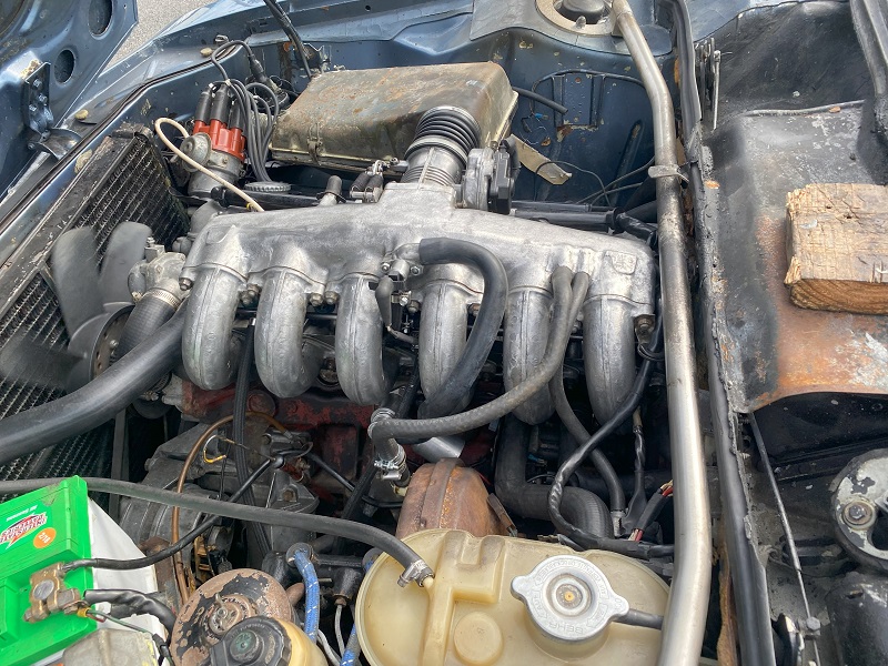

I have finally started the restoration process. My mechanic is not an expert in e9's but the shop works on many older imports. BTW I used this forum's suggestion any tried to get Sal from Rennsport to do the job but after 9 months of waiting, I decided to give my money to someone else.

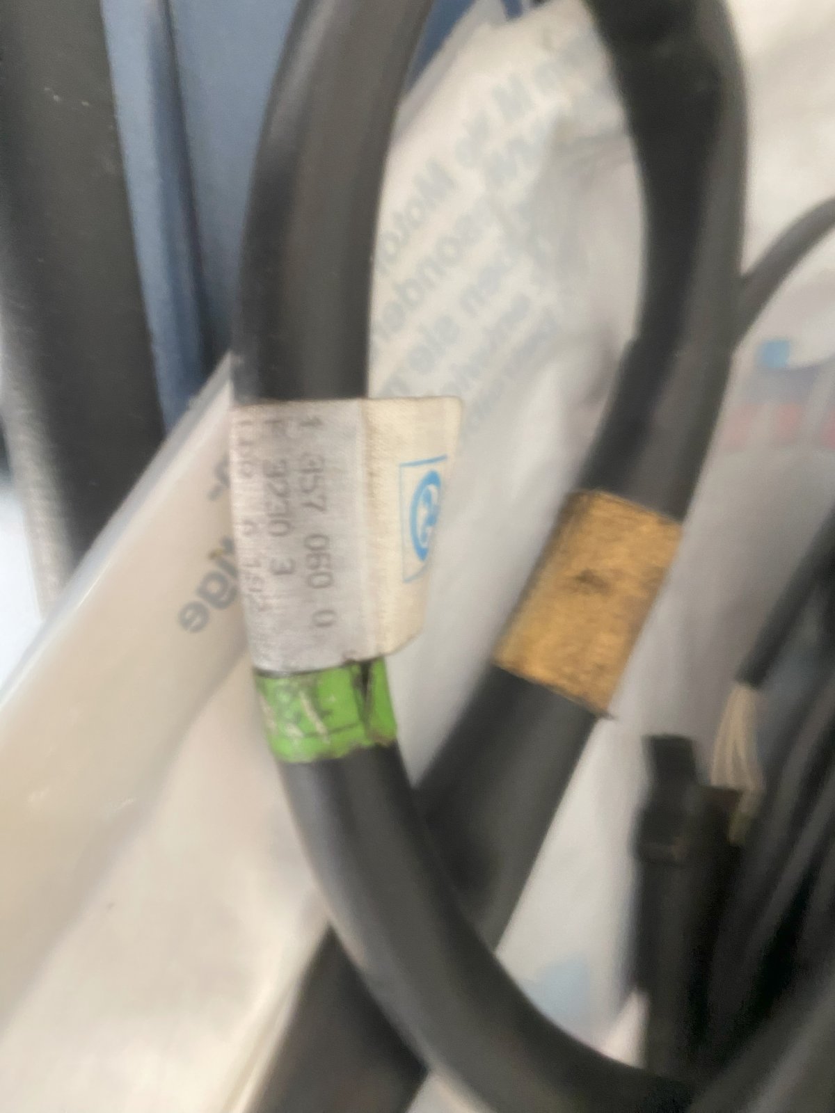

First question of many to come. I have a new one piece fuel injector wiring harness, but the car uses the two piece and they seem slightly different. the two piece has a wire that goes to the coil and it is missing from the new one. Any suggestions ??
Use your new harness- it is wired internally for that power wire.

Has anyone converted from the two piece fuel injection wiring harness to the one piece ? I need some information on any additional wiring needed. (Like power to the coil). Also, at this point, I’m not 100% sure this is a BMW harness. I did find a receipt with the correct part number but there is a difference with missing connections in the new harness.
I have both schematics and both harnesses in the the shop.

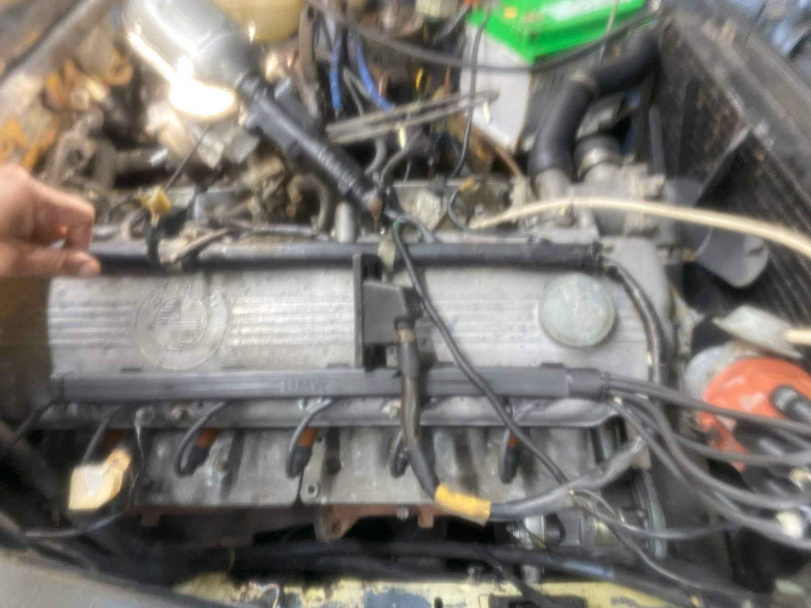

Ok an update...
Many thanks to @sfdon with the wiring harness.
The engine is now shinny :)

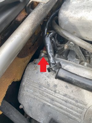

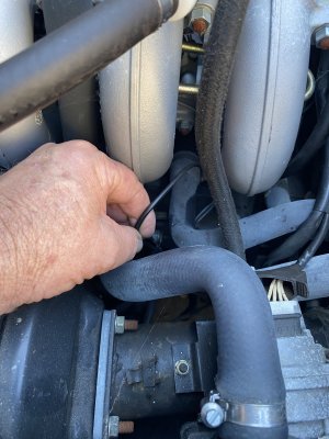

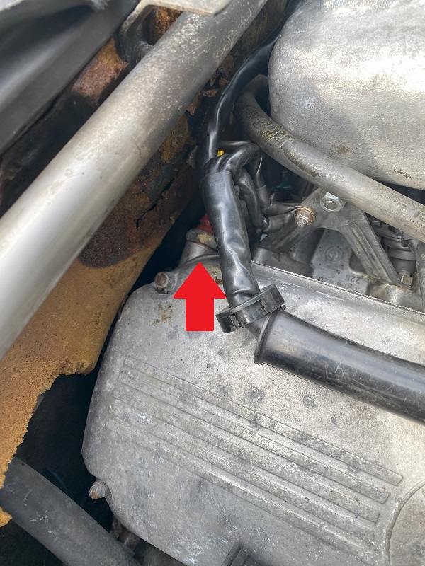

One question, my mechanic can not find the wire that goes to the sensor at the rear of the engine, See attached picture

That wire is not part of the Djet engine harness

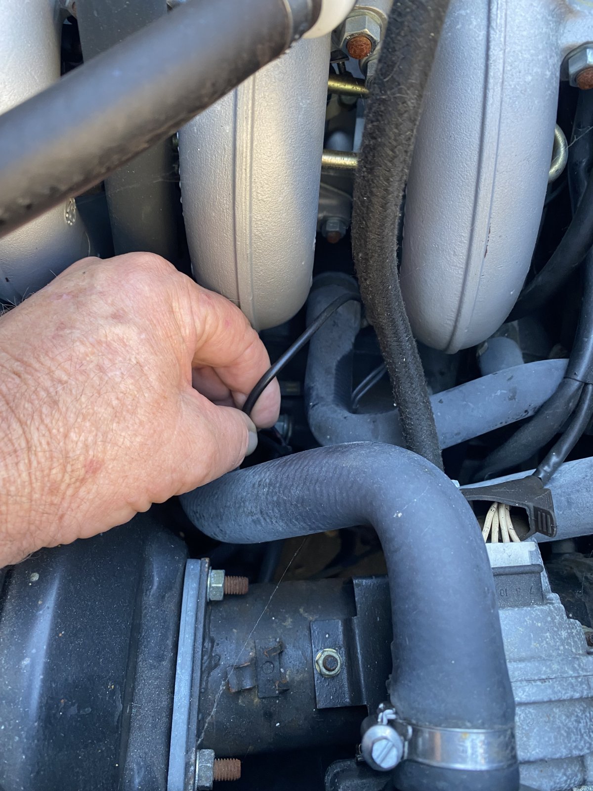

As Chris said, it is likely laying down by your starter. Two wires are together- one for your starter (black) and for your oil pressure sender (brown/green)
Look under your expansion tank- they come from the harness that runs along your fender from the firewall.
