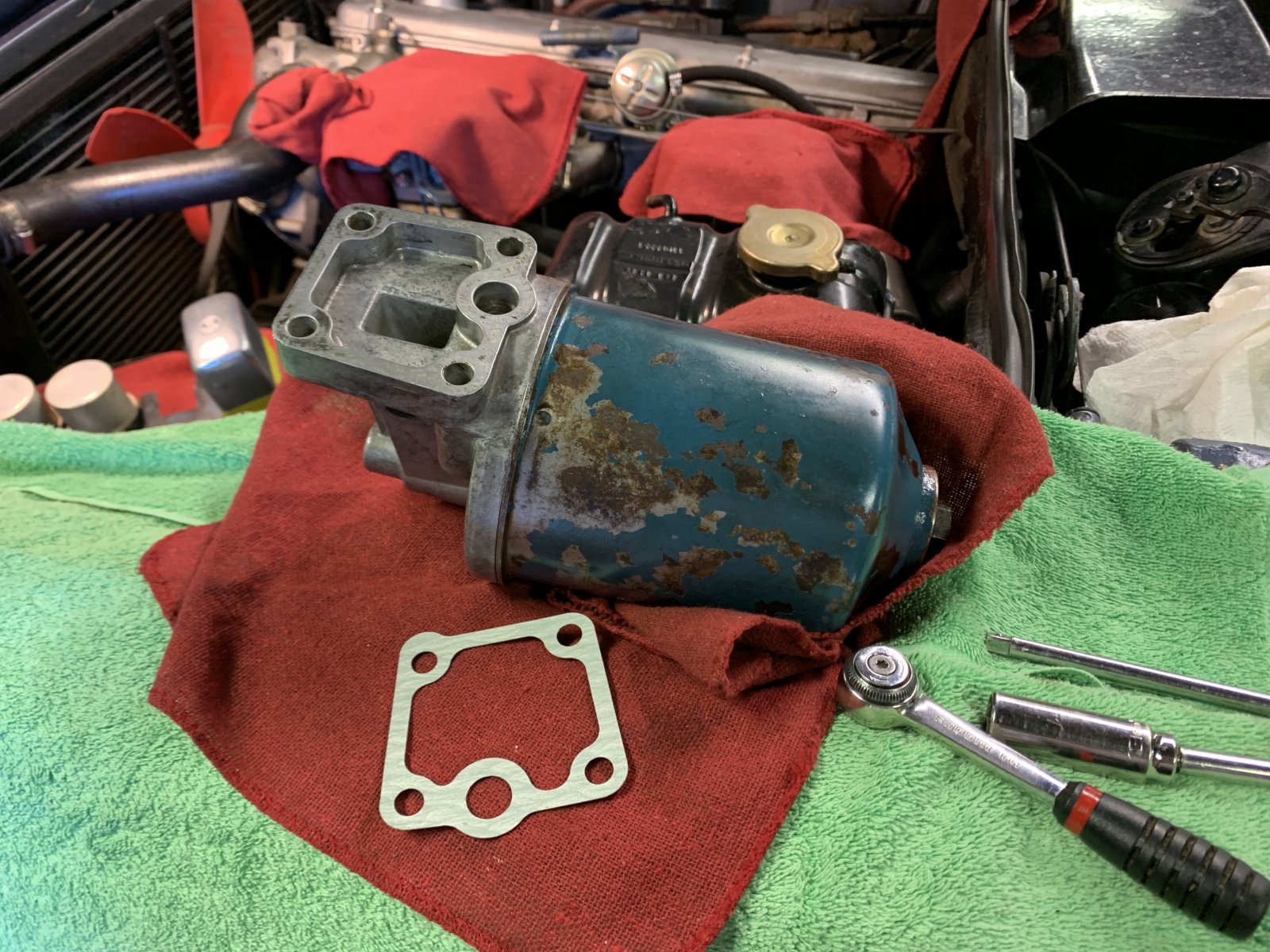

I've been searching through the archives for info on oil filter canister colors. Mine is Blue (photo attached). Top of dipstick is the same Blue. Anyone ever seen this before?
Thanks.
i have not seen it before, but in the scratched area it seems no other colour hidden
the fact that dipstick is painted in the same blue gives a bad sign though
dipsticks could be red or yellow according to blue manuals
same odd blue seems done on purpose, maybe to identify oil system
