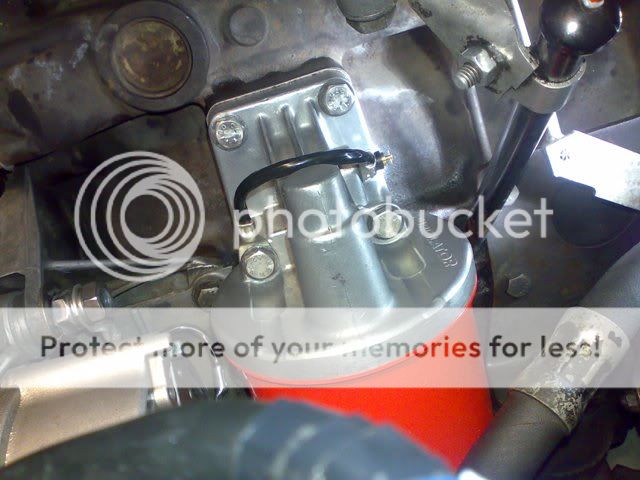

My car has the bolt-on oil filter cartridge housing; anything I should look out for? I have the oil drain plug torque spec from the blue books but can't find a spec for the four bolts that secure the housing. Anyone know? There's a bolt torque chart in the blue books but I'm not sure of the size...

if i understood well you have this type of filter:
if this is the case, to change the filter cartridge you do not need to dissasemble the aluminium support (the mentioned 4 screws)
you only need to remove the bottom screw and then the container will fall down,
then you will remove the filter cartridge, and replace it with a new one, a new gasket and fix the long screw again (you will need to push to fix it meanwhile screwing the screw)
only one important comprobation, check that the botom plate (red arrowed in the following picture) that press the cartridge (by means of the bottom spring) is not glued to the old cartridge,
otherwise you will lose it and the filtering operation of your filter will dissappear (ask me about it if you have questions)
Thanks. Yes, I have the same assembly shown in your first photo. I thought the housing had to be removed to change the gasket every time the filter was changed?
Some people take the entire 4 bolt housing off instead of the single bolt because as you will see when you remove the bolt, oil will come gushing out so put a plastic baggie around the housing to minimise the spillage. The 4 bolt method is less messy and easier to access but usually requires fitting of a new gasket.

Thanks, everyone. My mechanic usually pulls the housing when I have him change the oil filter; I want to start changing the oil/filter myself and will probably follow this procedure. One more thing—there's no need to loosen the alternator with the four-bolt method, right?
no, you do not need to touch it, but, probably you will need to make a little space for the whole assembly in its way up-out (battery, air filter, vacuum brake hose,...)
anyway there is very little space to unscrew and screw so you probably need to adapt your tools/hands to that task
