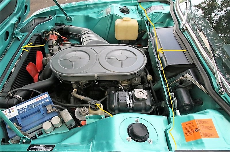

Congratulations! The exterior is beautiful and the upholstery looks almost too nice for human contact.
Couple of minor things to address. They are minor and mentioned only to the extent that the seller might have the parts - but somehow overlooked installing them. As indicated, you are missing rubber strip near the firewall /bulkhead. The forward arrow indicates that the rubber strip is in place. The brake fluid reservoir cap is missing a tiny vent cover.

I saw that the middle rubber strip was missing, but I think I have a resource for the part. Good eye for the vent cover. I have so much to learn. Any comments, criticisms and tips are certainly welcome.

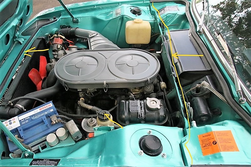

I bought a new brake reservoir for my car. The cap did not have a vent cover. Looks like the same one that's in my '72 2002. Is the vent necessary? Really nice color!
My comments were observations rather than criticisms and not intended to offend. The missing rubber strip serves to isolate/seal the engine bay from the heater intake assembly, thus minimizing engine bay fumes entering the cabin. Possibly more important, the strip also prevents possible metal to metal contact which would be a shame for nice new paint.
As to the other observation, it was a guess that there is a missing vent cover. It appears to be PN34321103064. I could be wrong and it may be some other style cap, since I'm not sure I see metal contacts. On my cars, that thin five cent piece-sized piece of plastic keeps a floating metal contact in place. The contact is integral to the reservoir fluid level sensor and the related dash warning light. The vent cover also serves to prevent debris and moisture from entering the reservoir. Per the photo, there is a pin hole vent. Its effectiveness at keeping things water tight is questionable, but I would rather have one than not, especially because I am apt to be clumsy with a hose. Newer replacement caps have a flexible membrane that provides the same function as the vent cover. I have seen other style caps that do not incorporate the sensor as well as original caps that have been modified with epoxy or RTV. In the end I don't think the vent cap is critical, but if it is like the one depicted below, it may trap water, etc.
