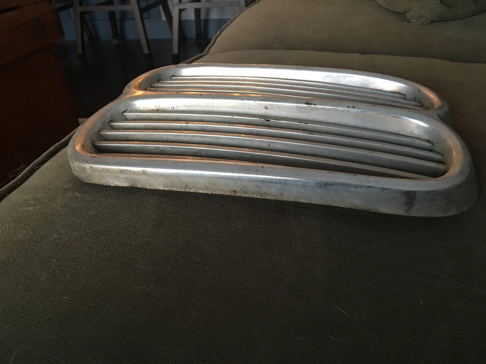

Five bar kidney grills

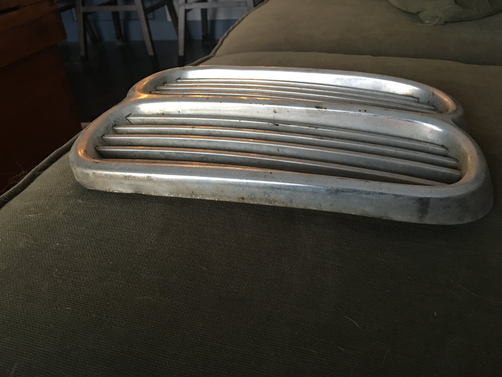

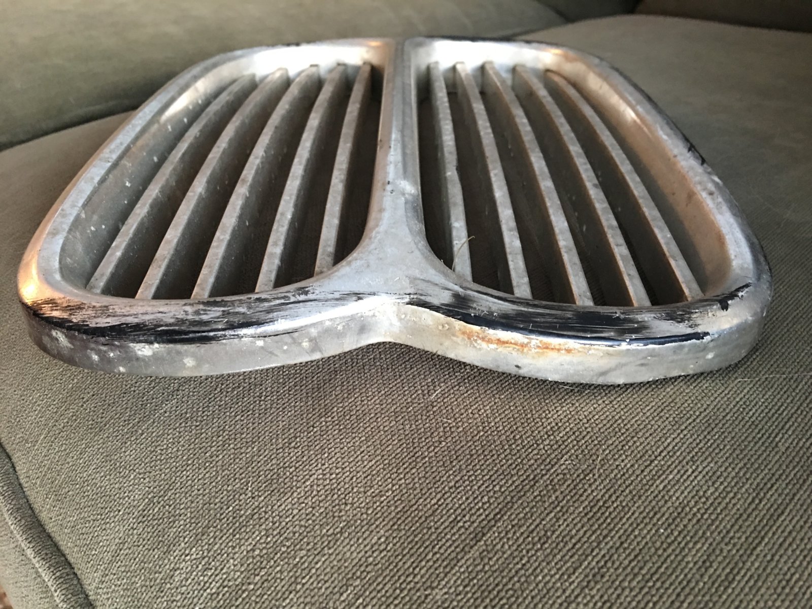

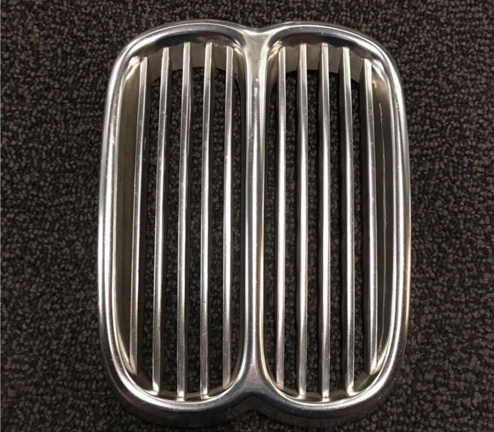

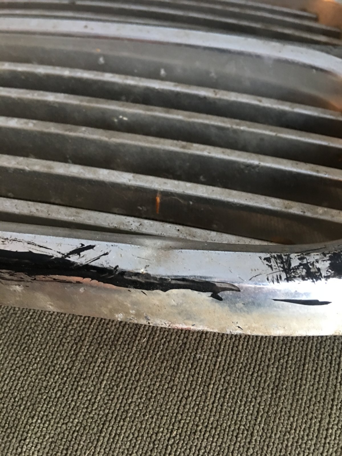

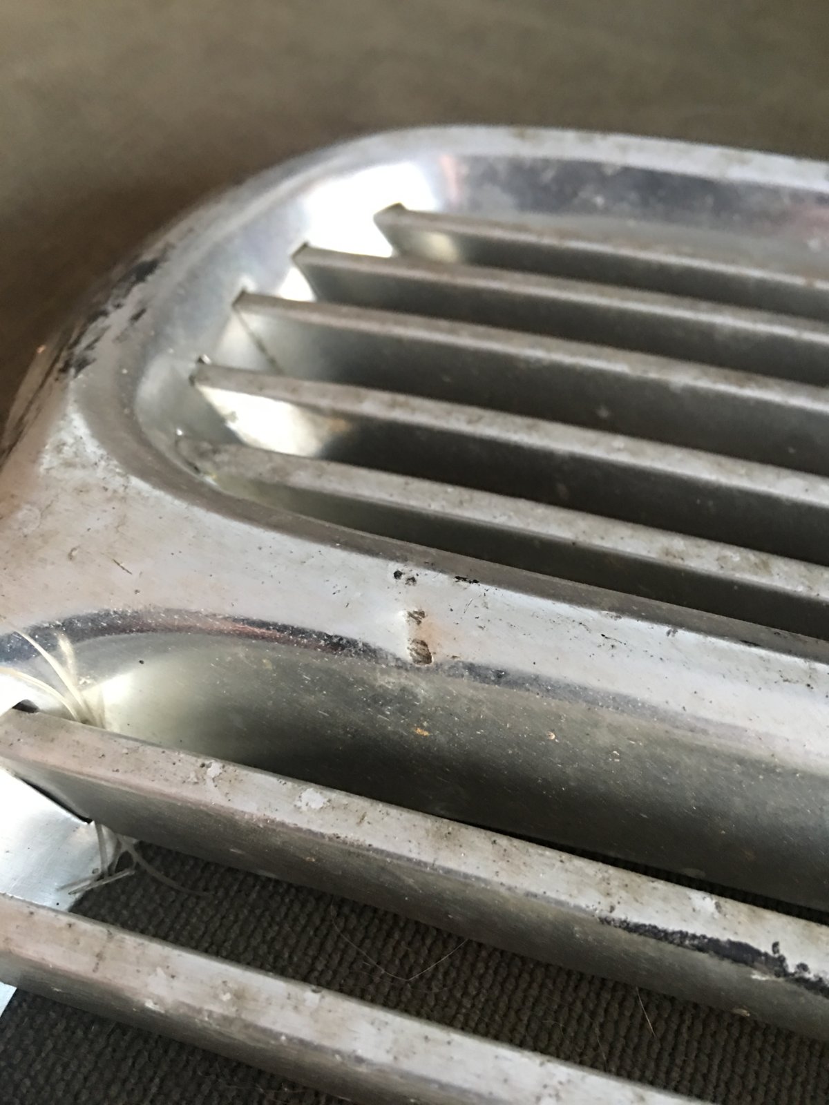

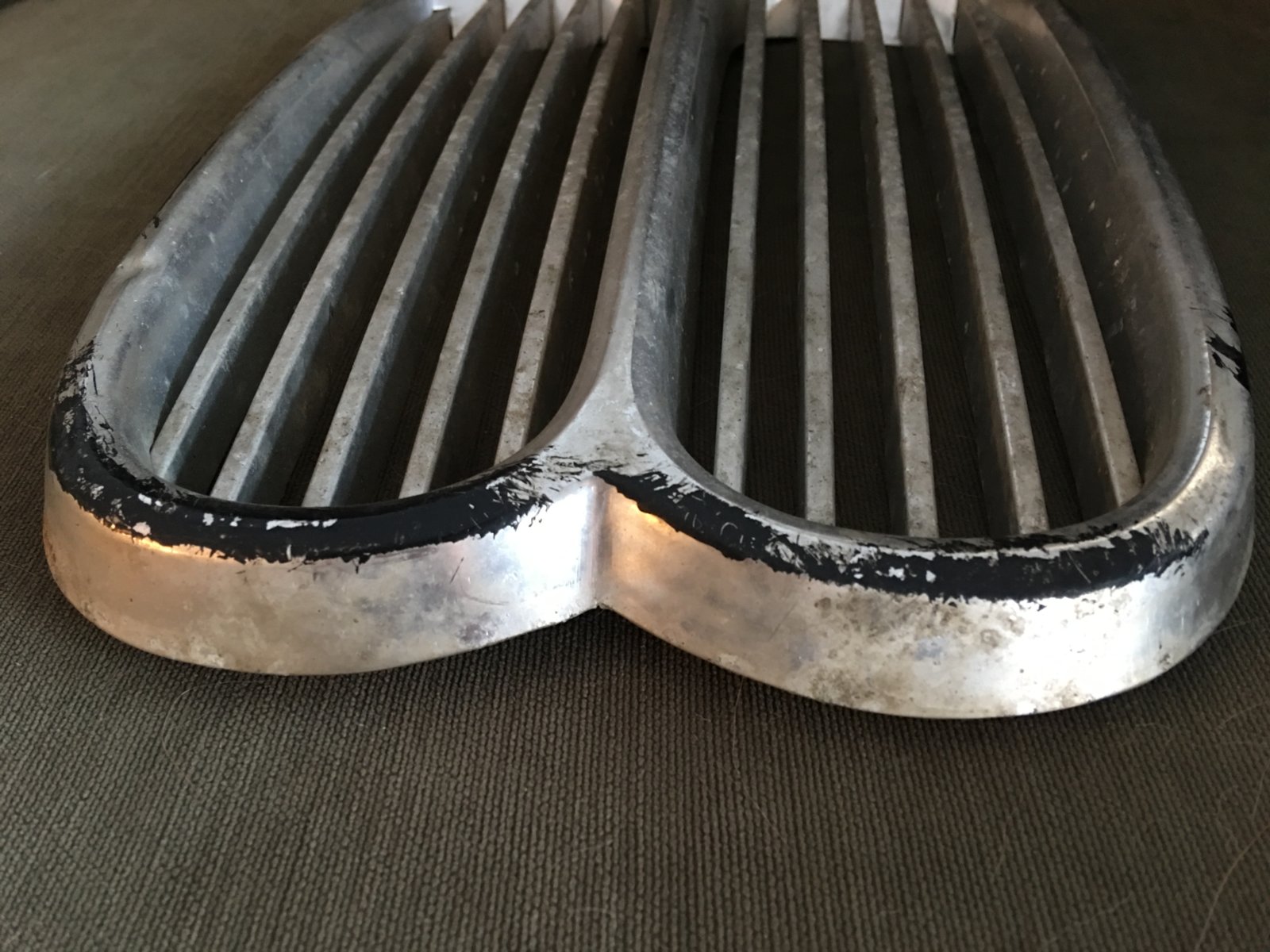

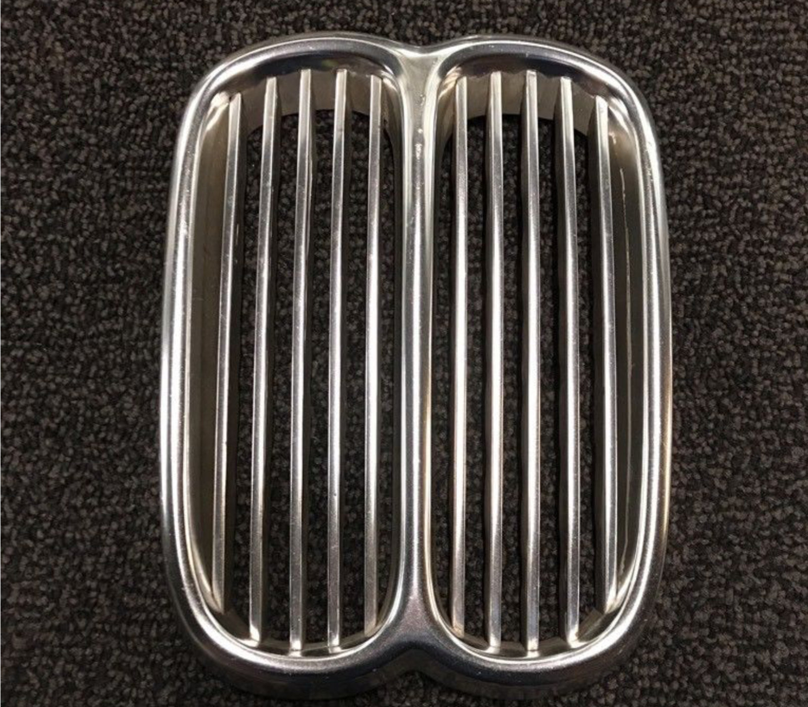

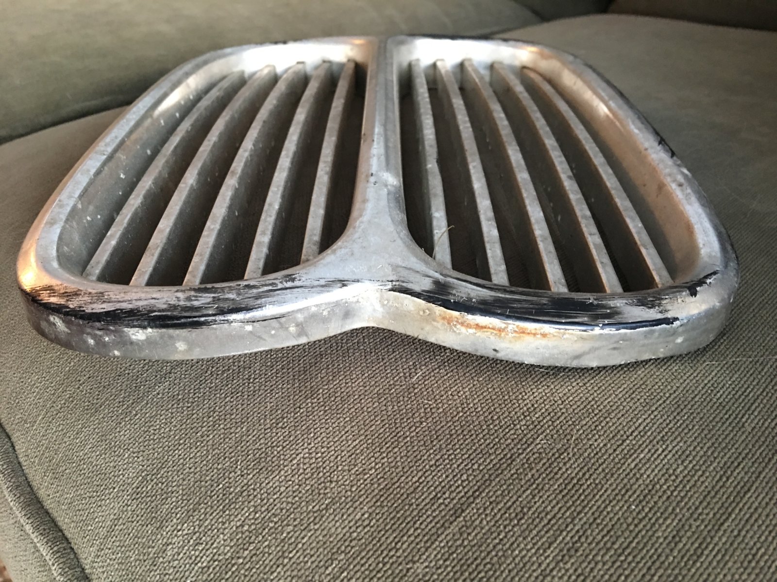

So the black anodized 4 bar grill on my UK 72 is wrong?

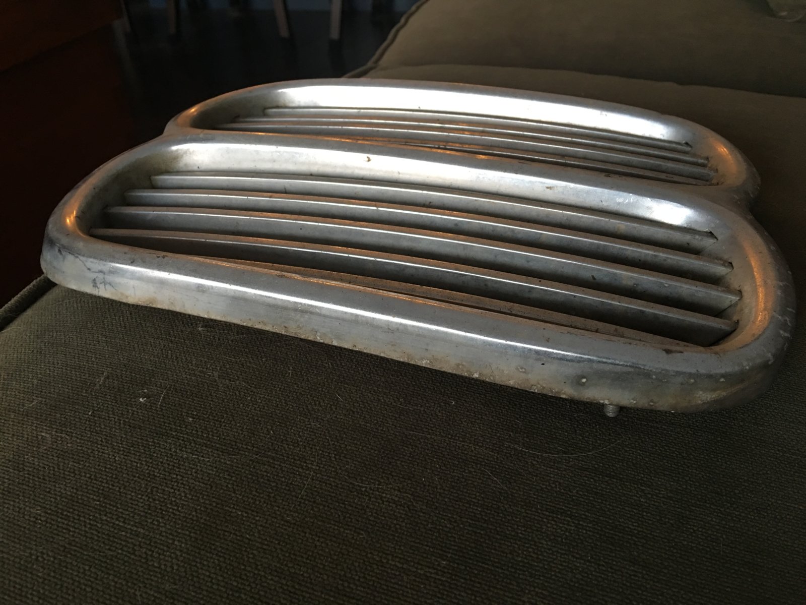

To be precise, yes! Ideally you’d want an all silver one like this.
Should have started hoarding these 5 slat anodized grills back in the early to mid 1990’s. Dealer price back then was about $70. Personally, I’ve bought at least 3 new ones back then (consumable parts). Shucks, lacked the foresight back then to buy a dozen of the grills and save them for a rainy day.
You have the 4 black plastic slat grille? Those are for the Face Lift cars which took place somewhere in 1974.
As I pointed out, you’d want the old style, 5 slat all silver type off which I posted a pic.
Unfortunately these aren’t cheap nor easy to find in good shape.

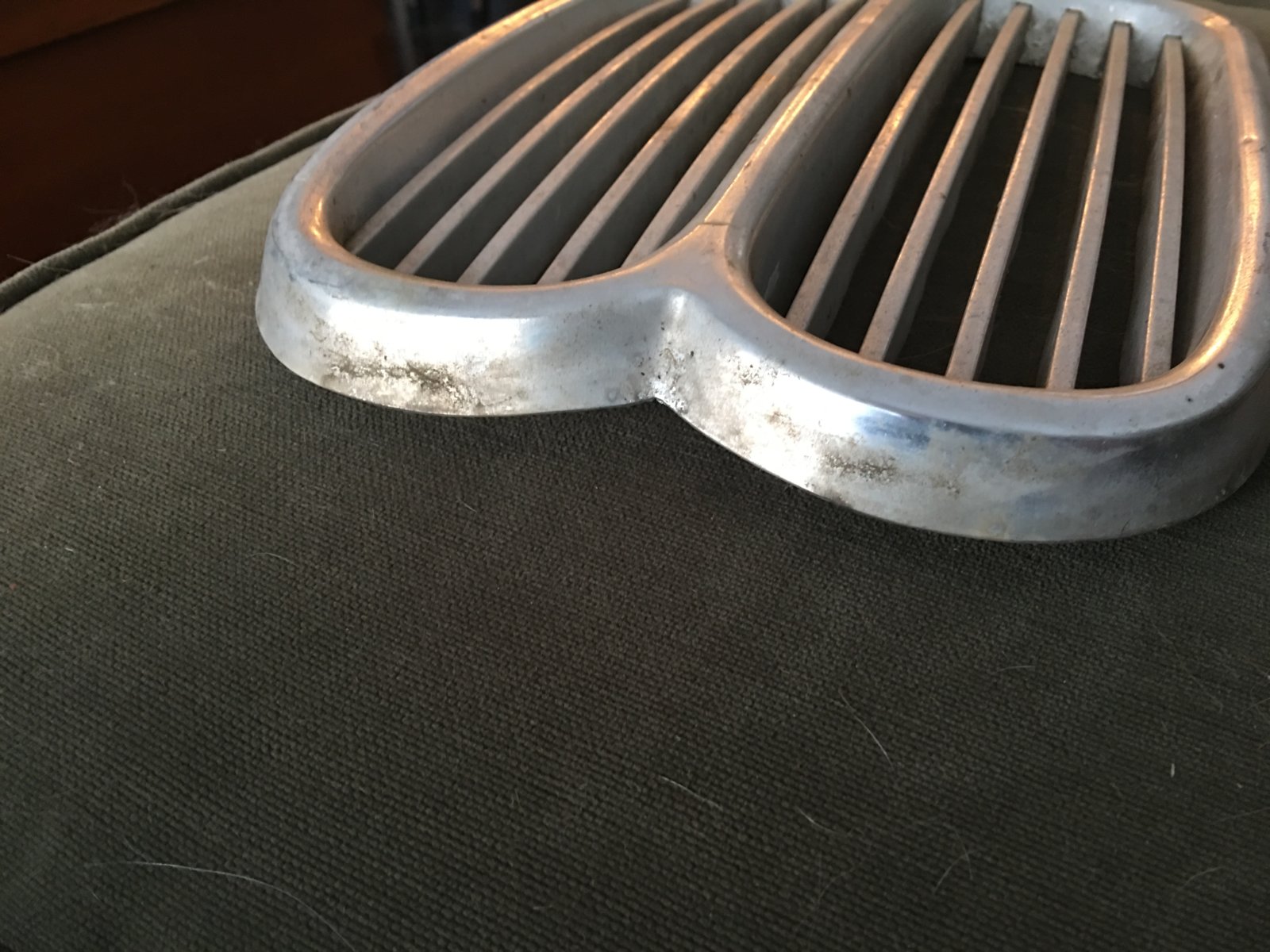

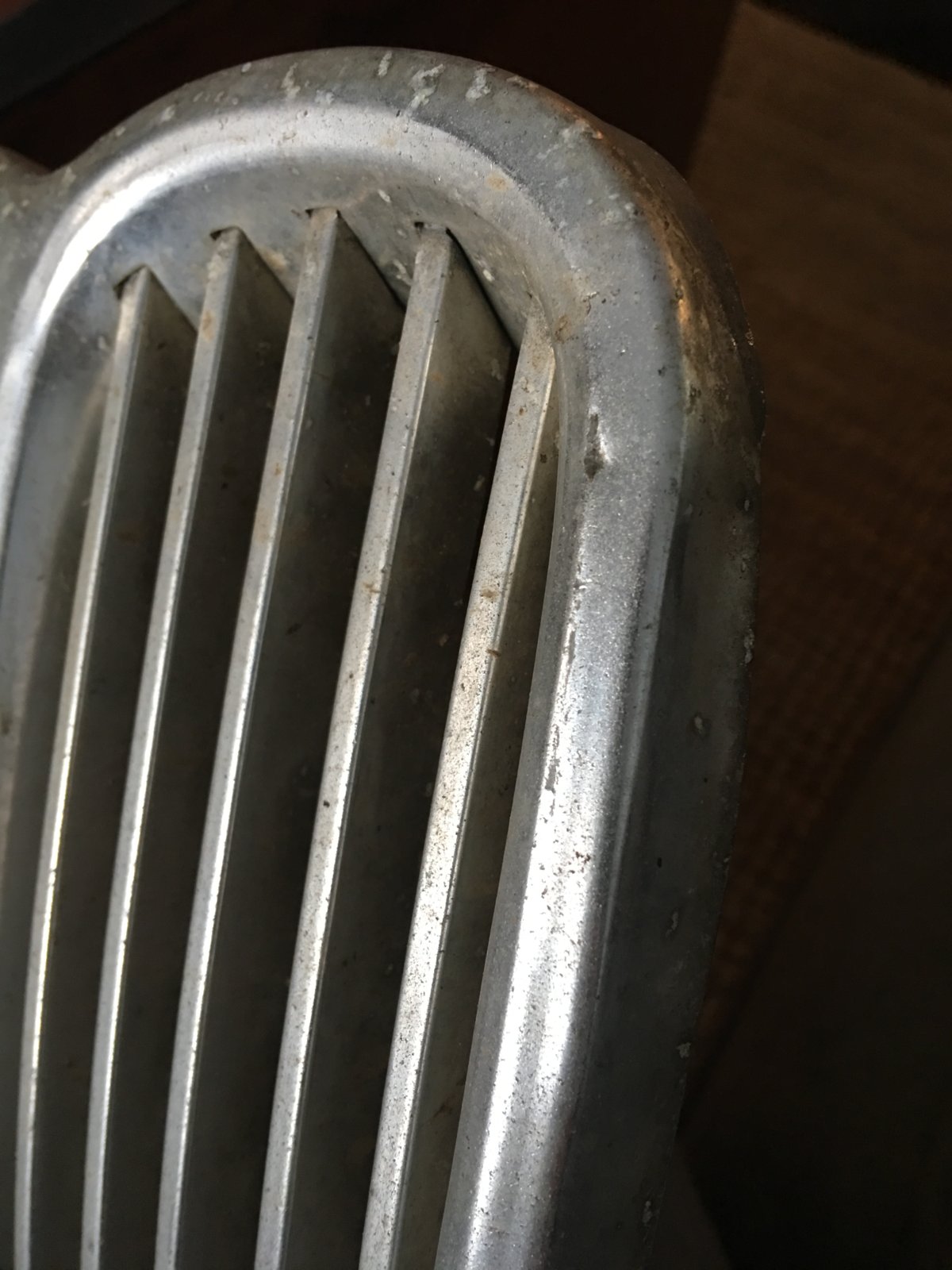

If it is a 4 bar grill it is from 74 or 75 ! 73 and or older have 5 bar on each side (total of 10) !
Also the 4 bar on each side(total of 8) are plastic, not Alluminum ! And the outer trim is thicker (beefier) !
I have seen many 73 or older with 74 grills ! I guess if they had to be replaced the old style may not have been available !

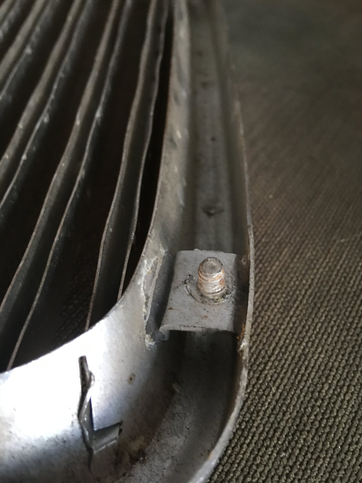

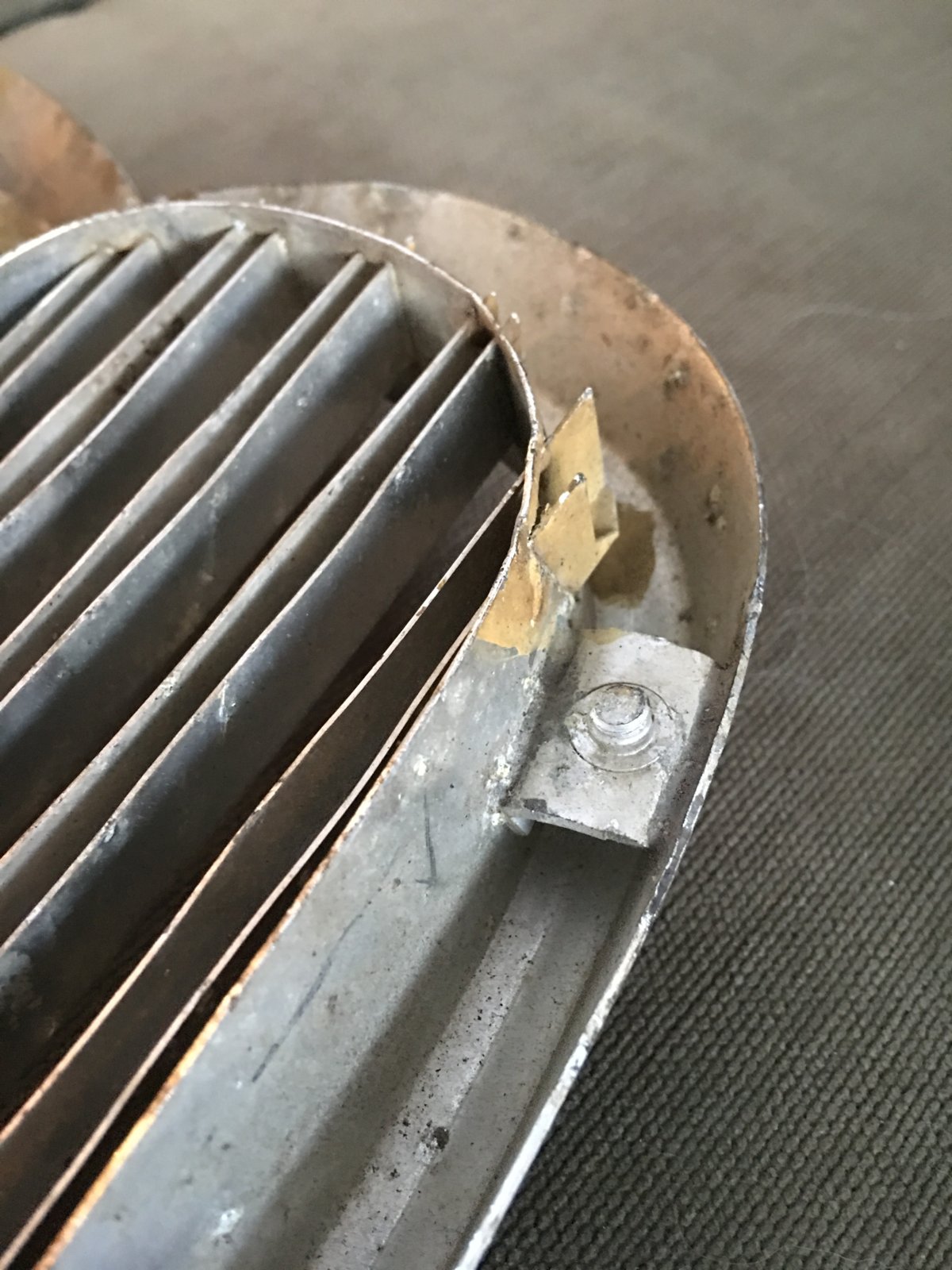

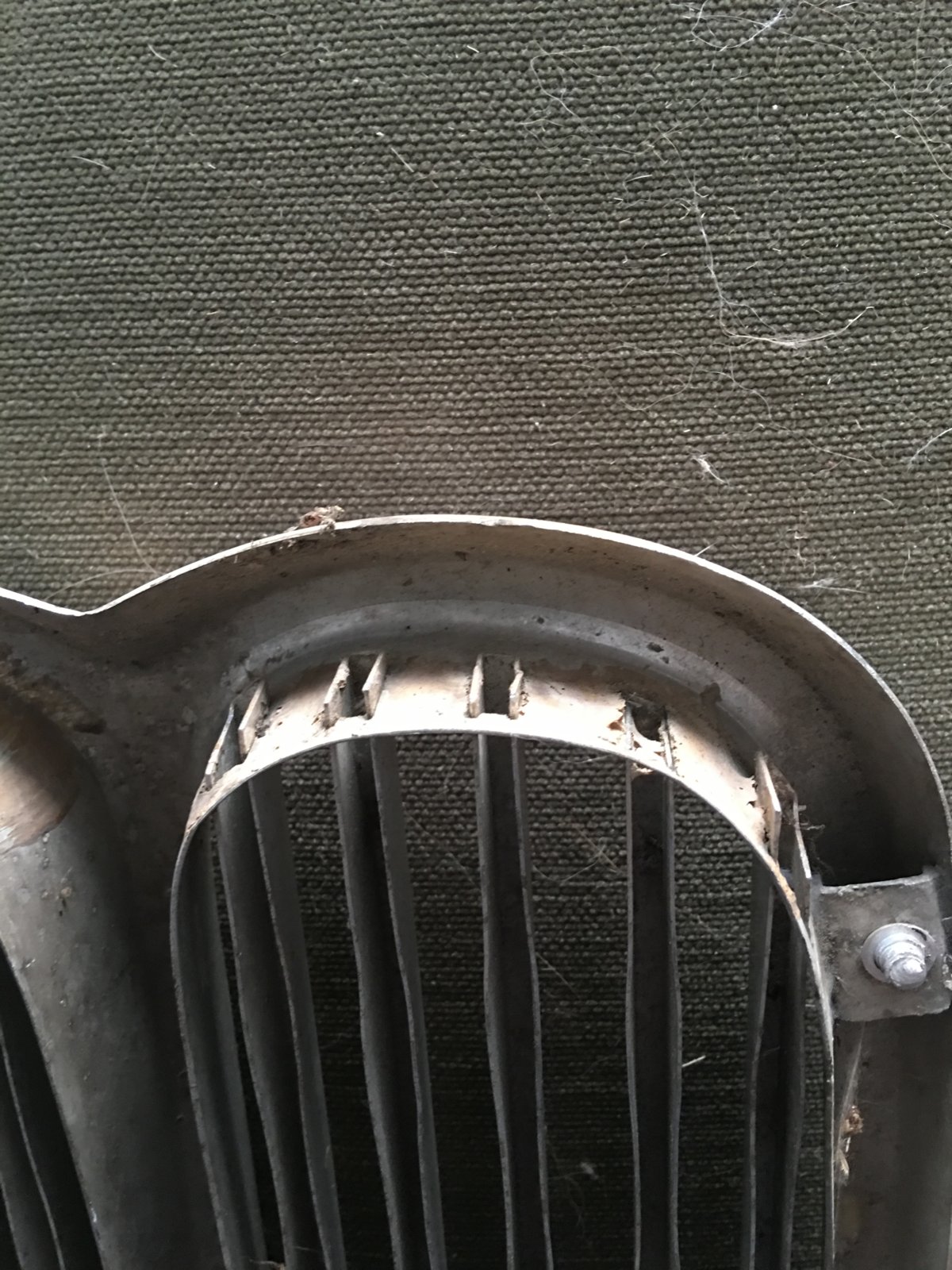

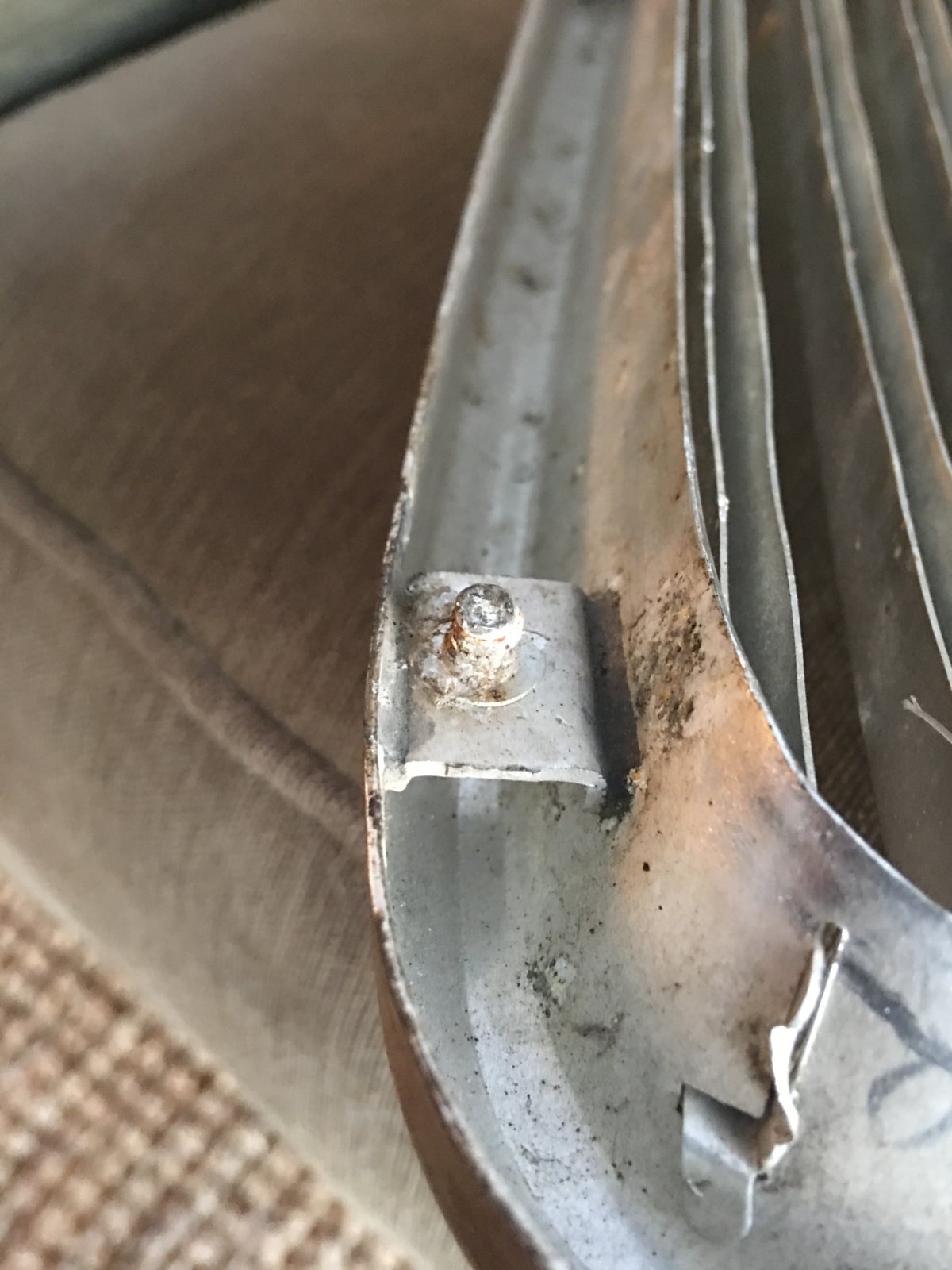

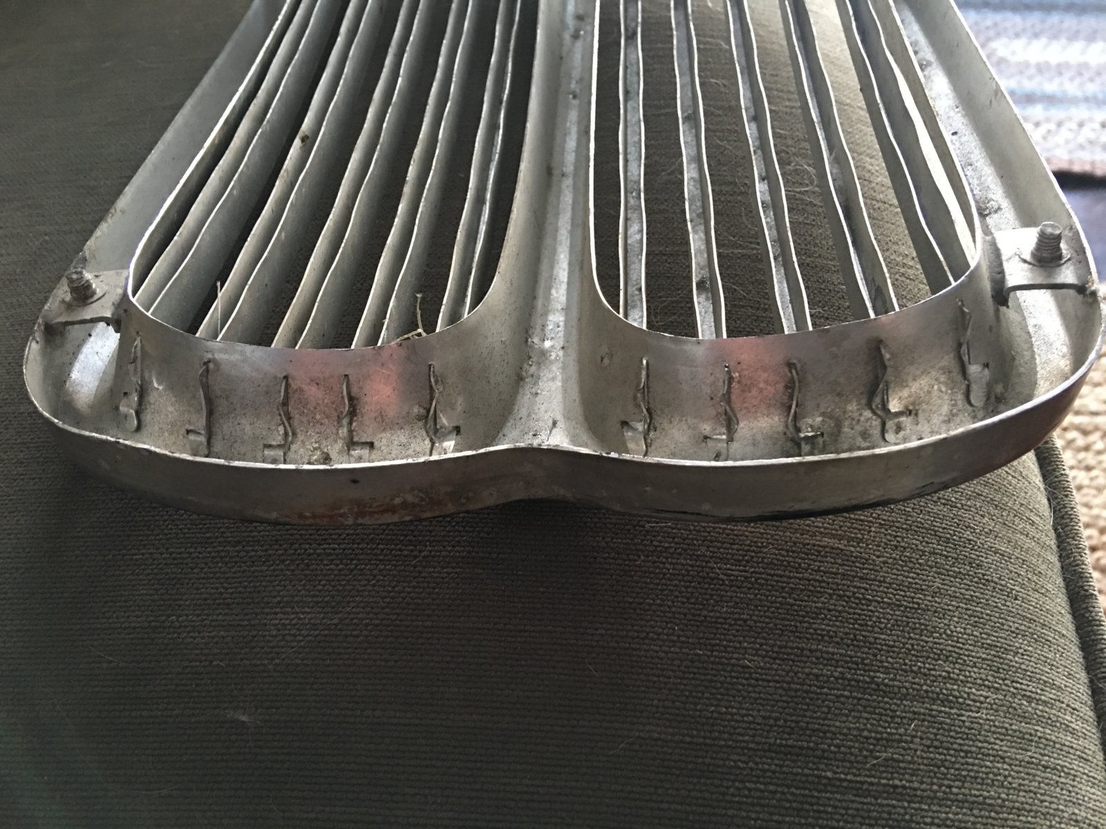

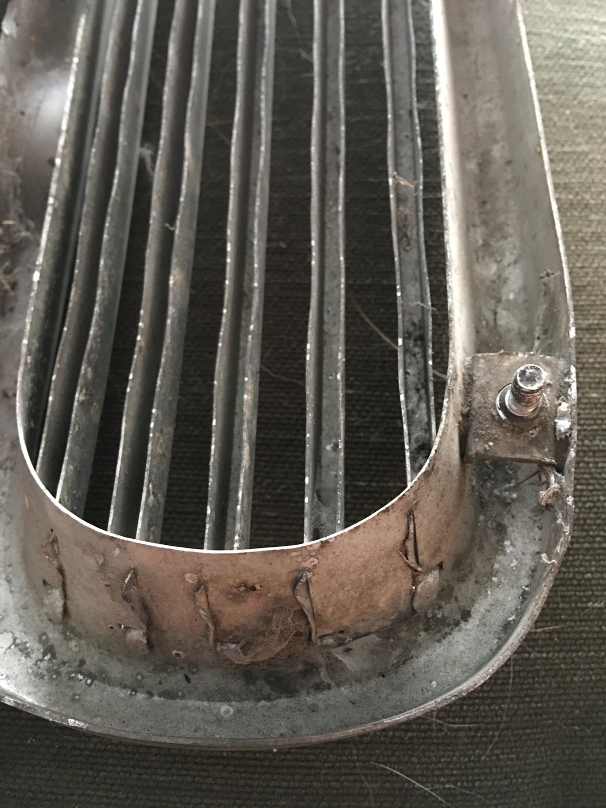

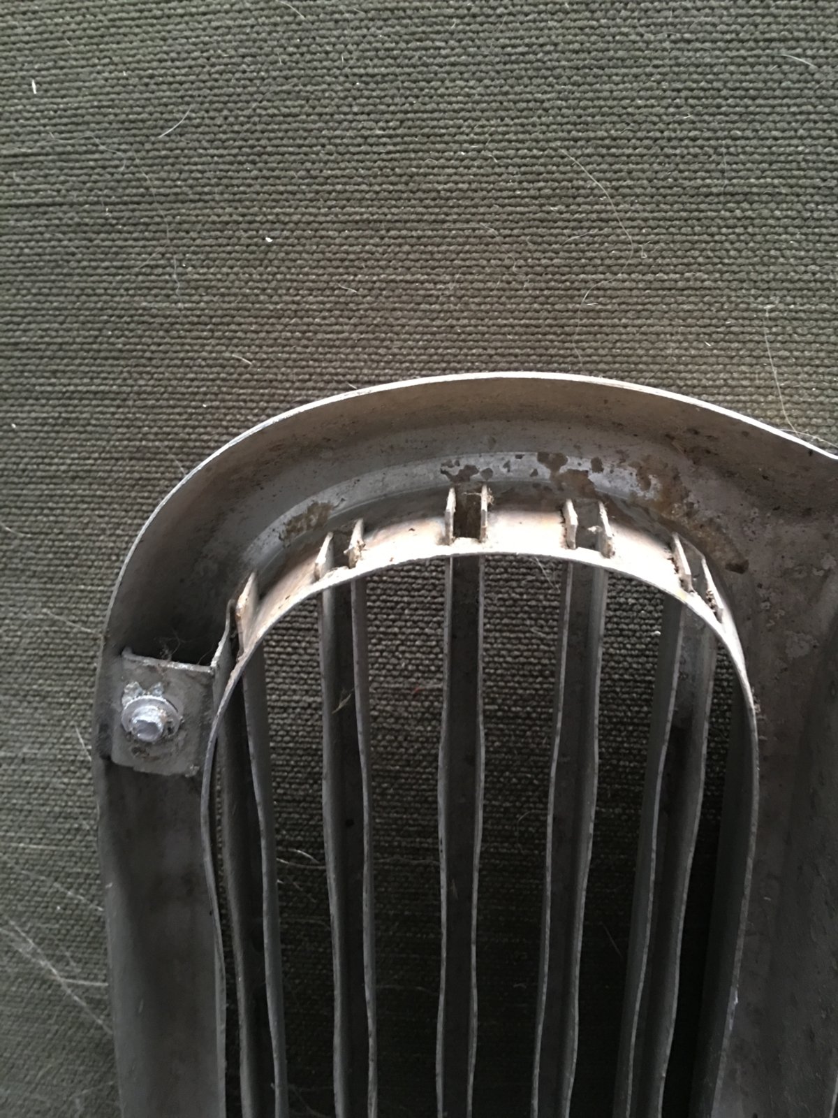

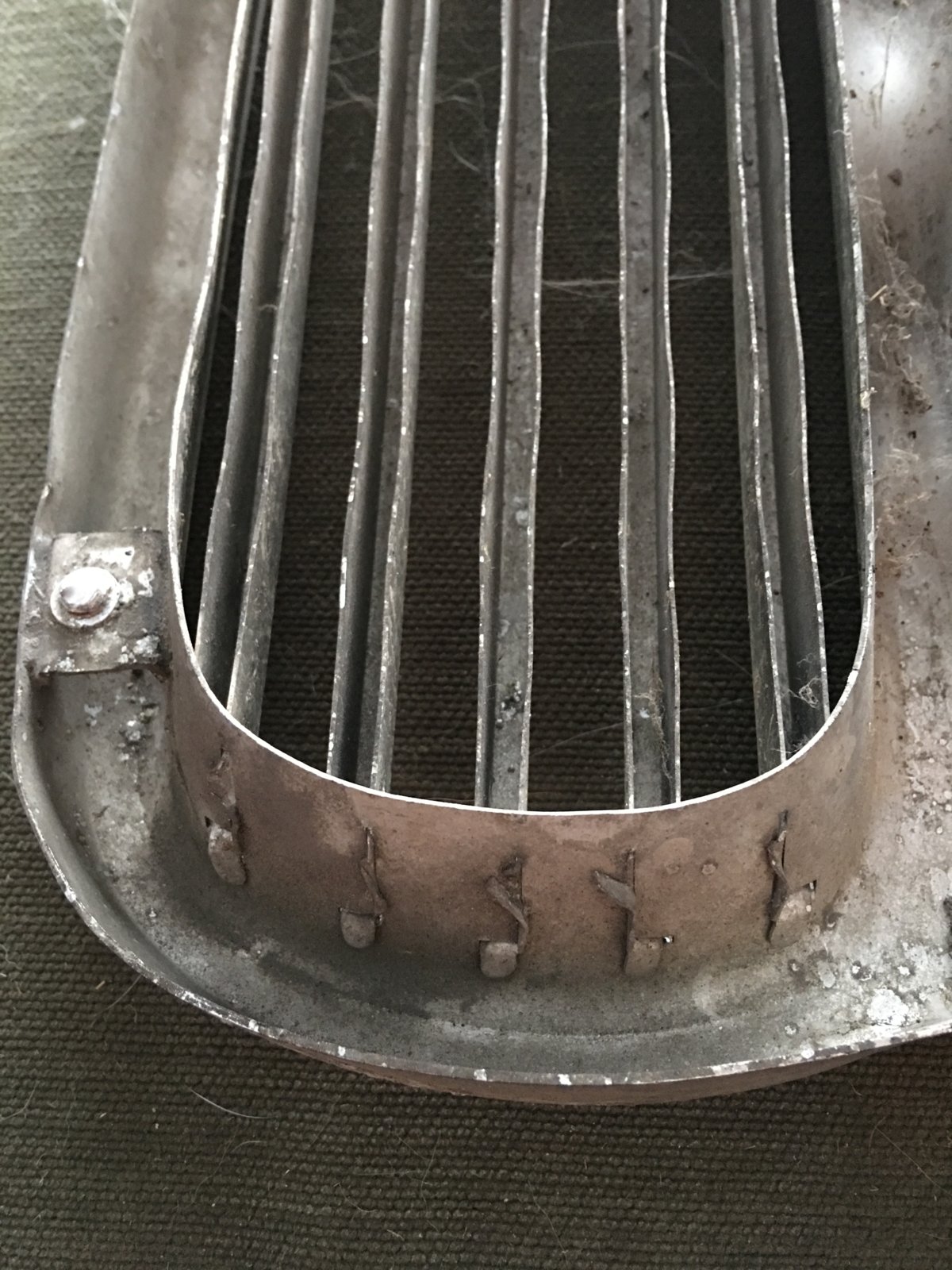

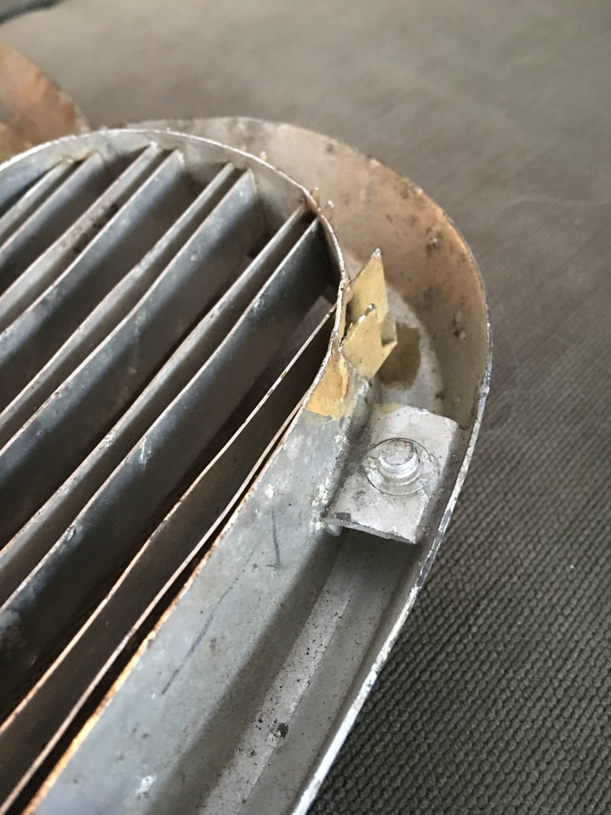

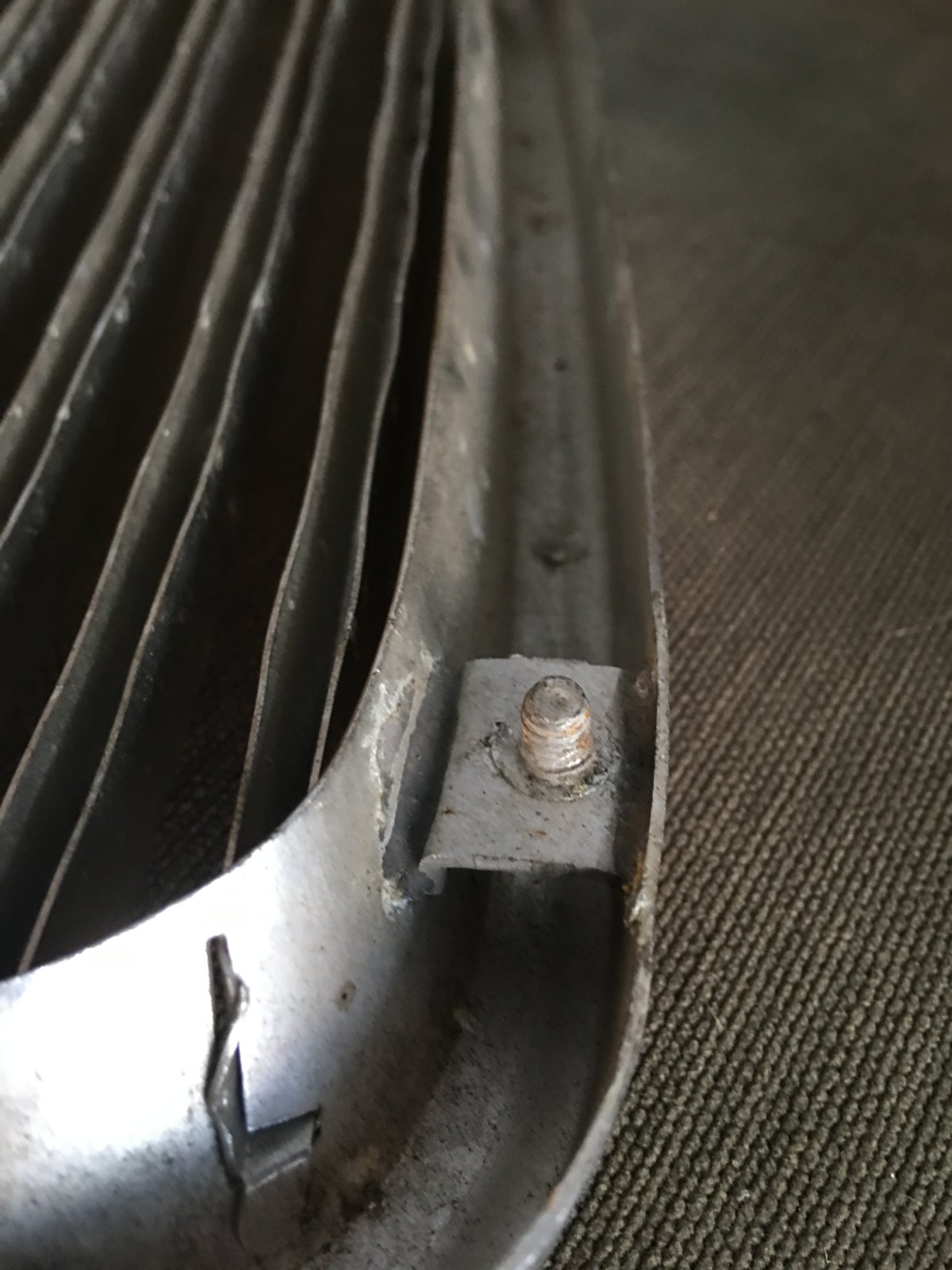

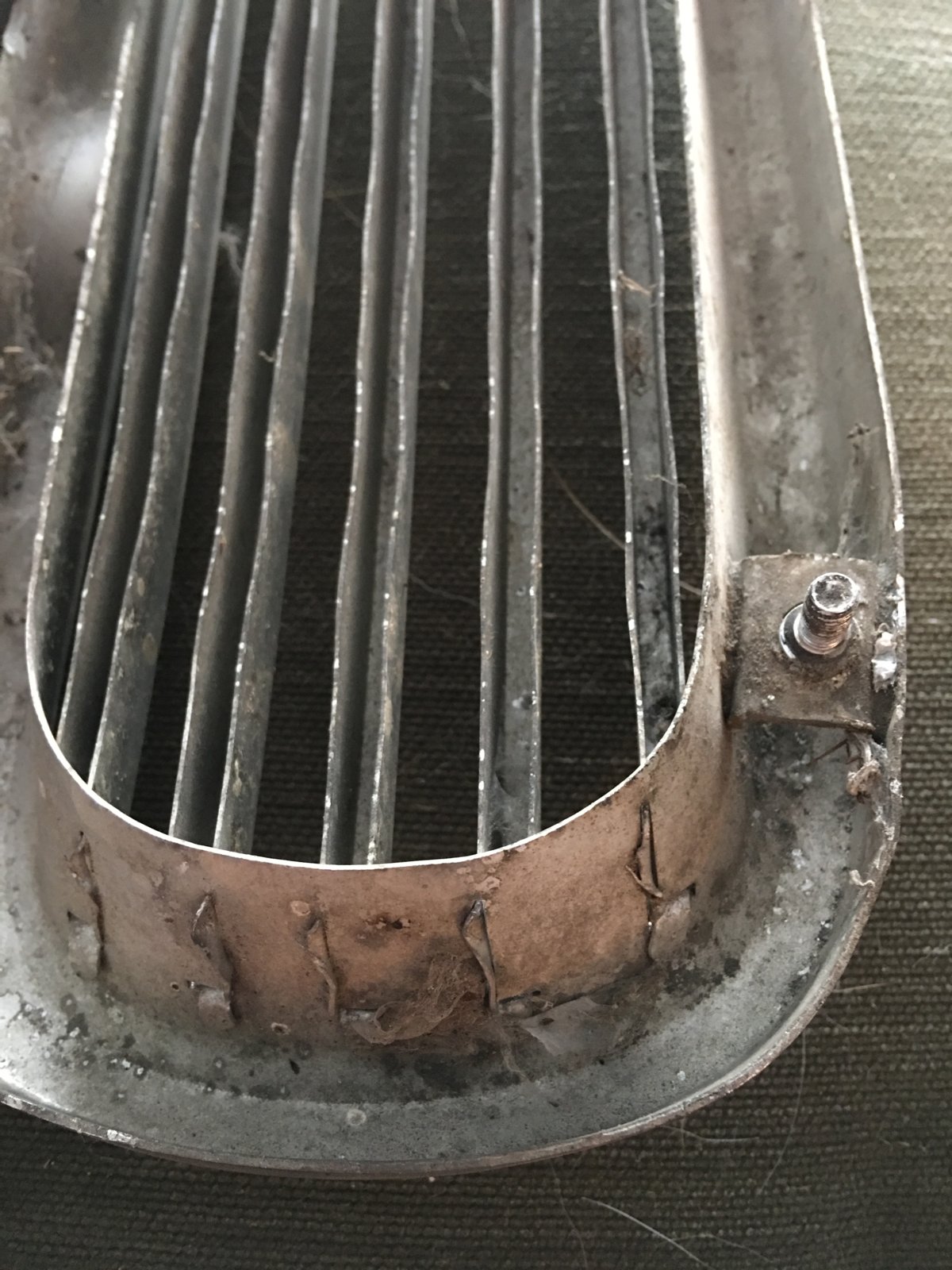

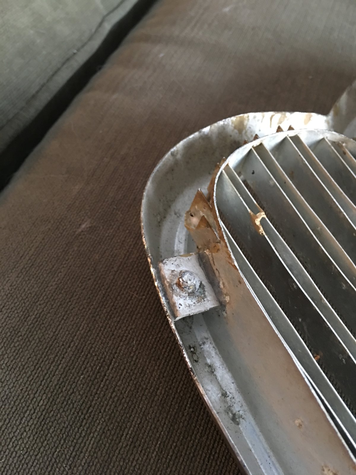

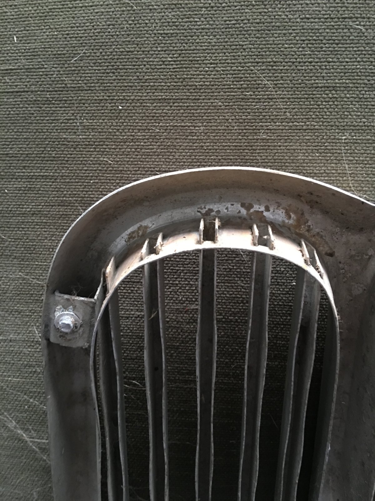

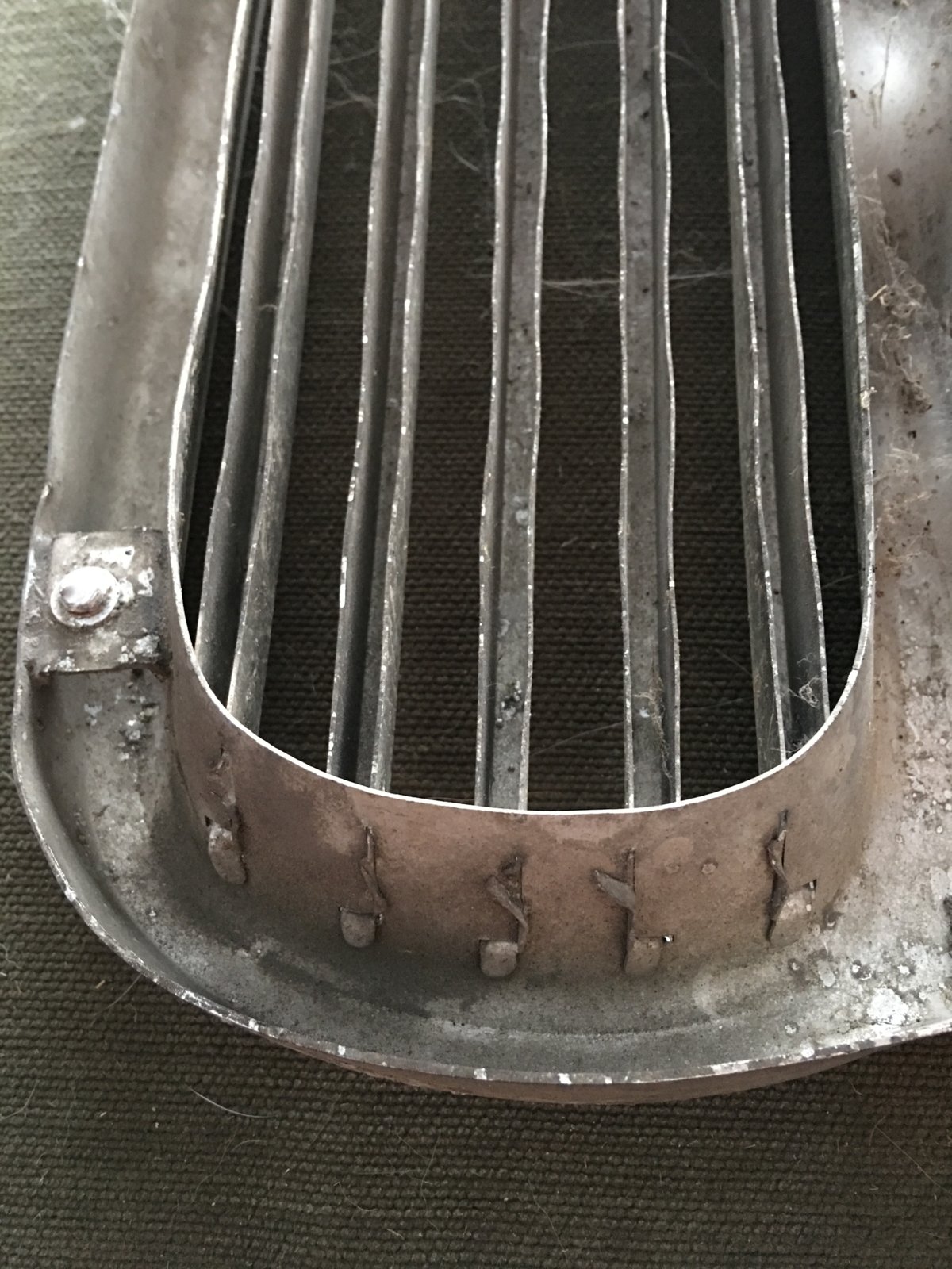

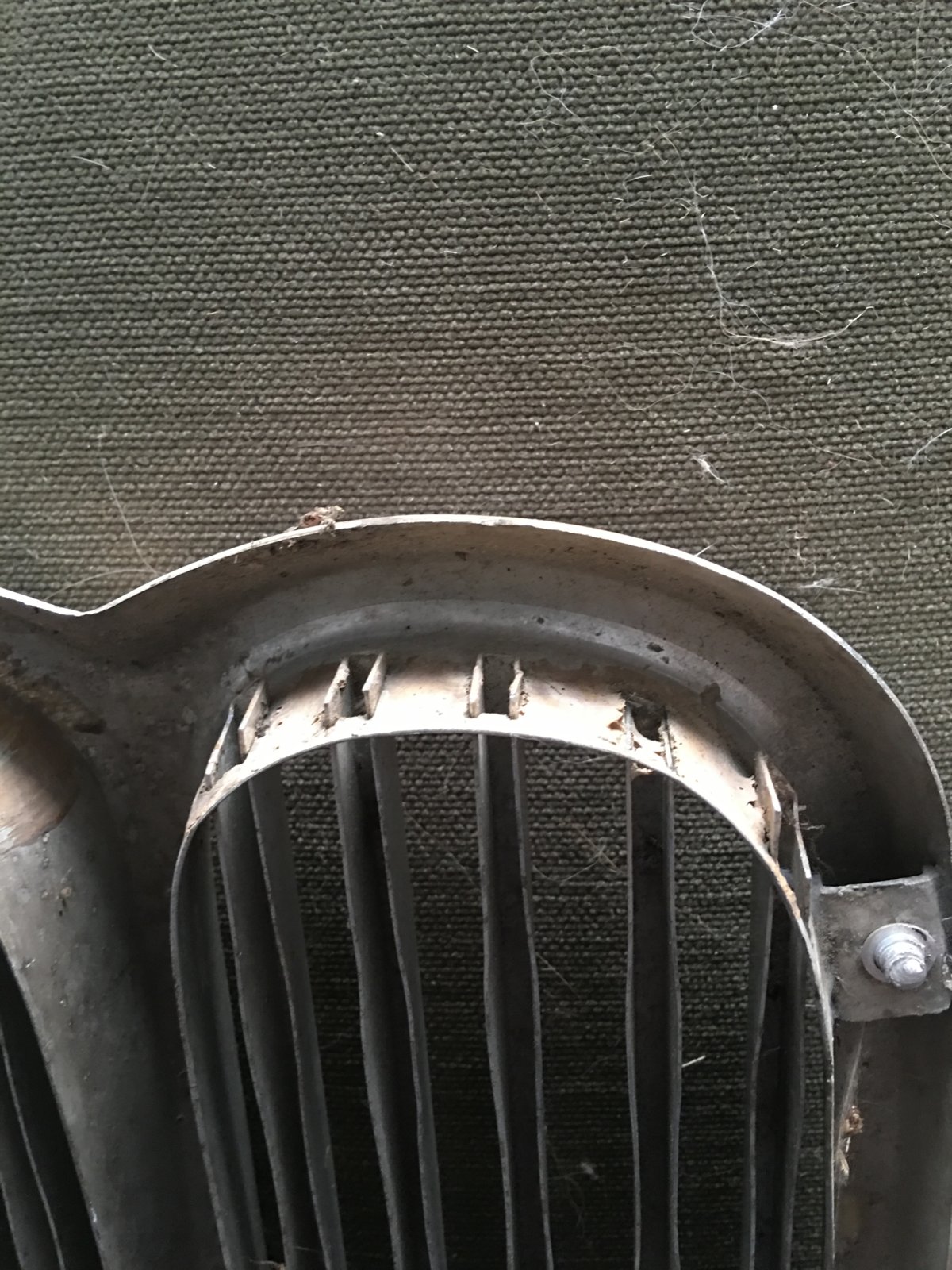

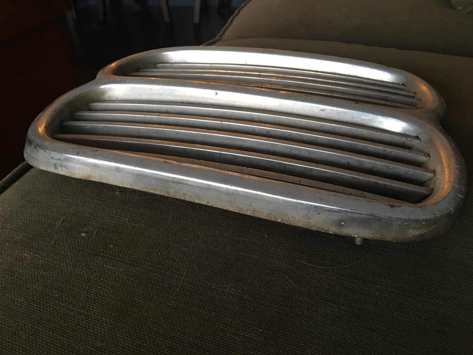

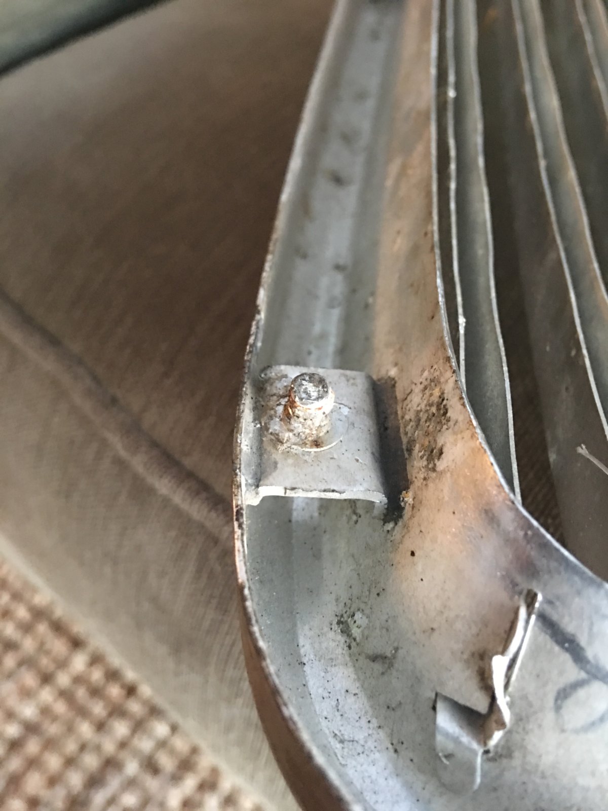

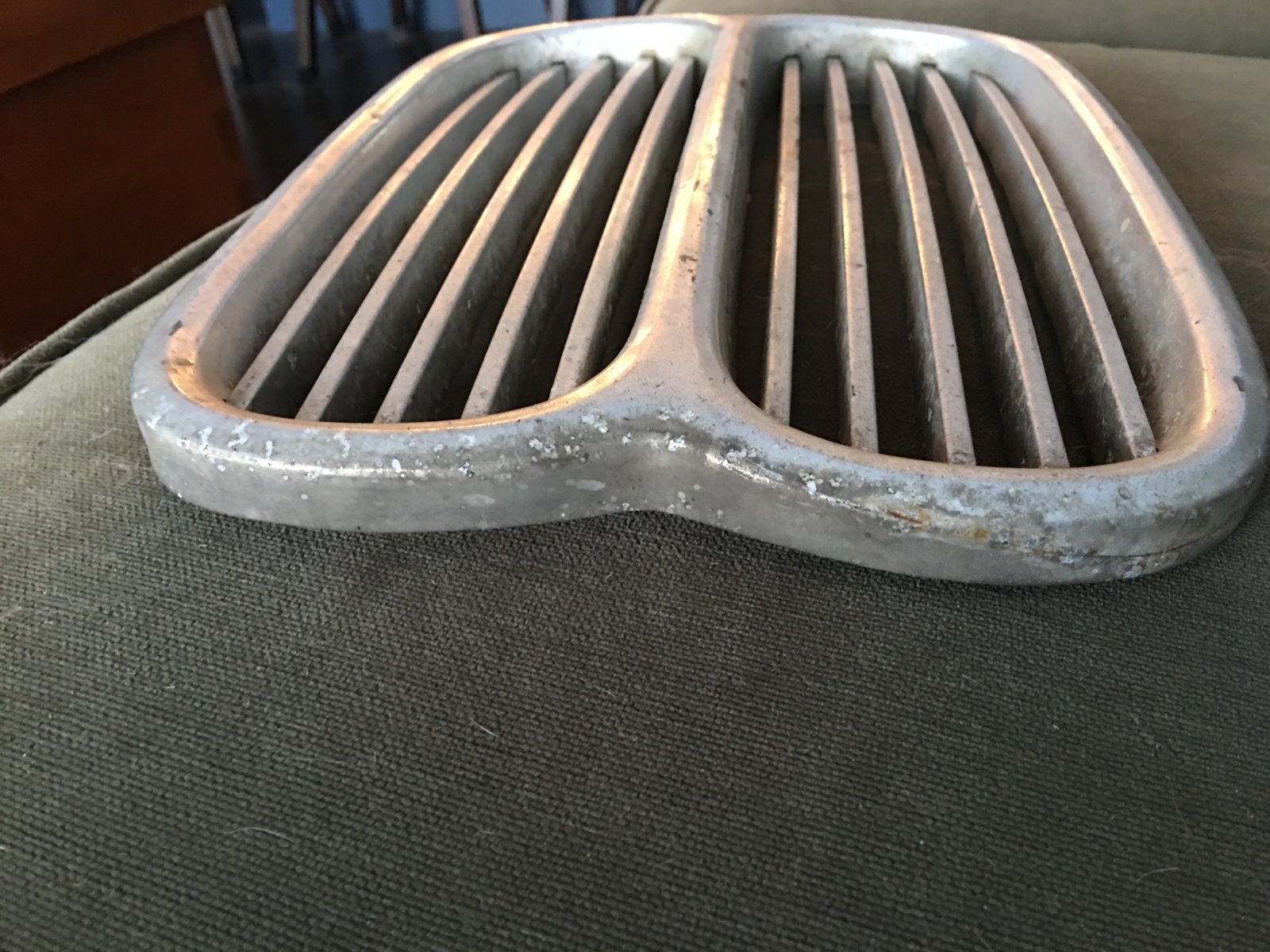

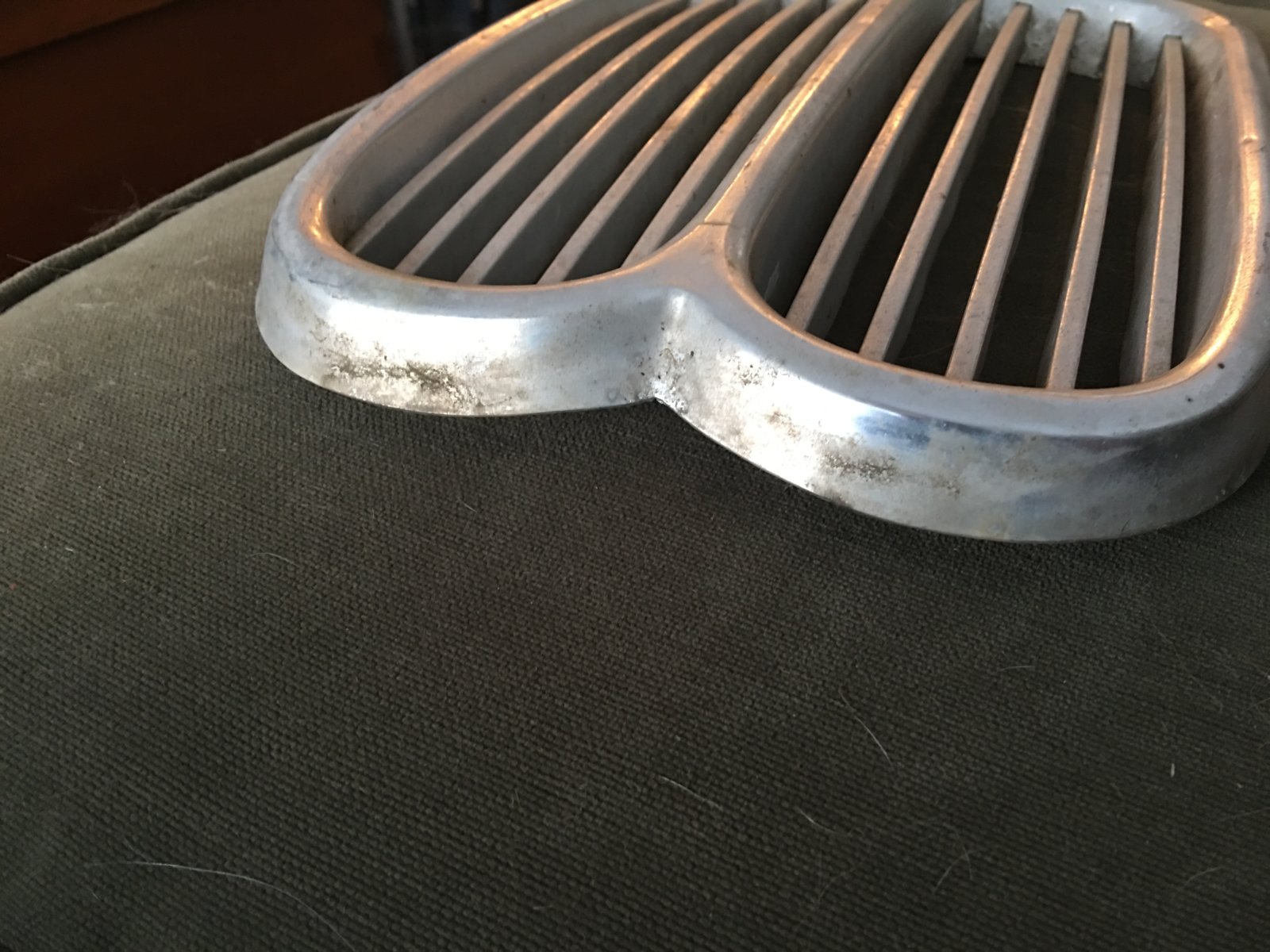

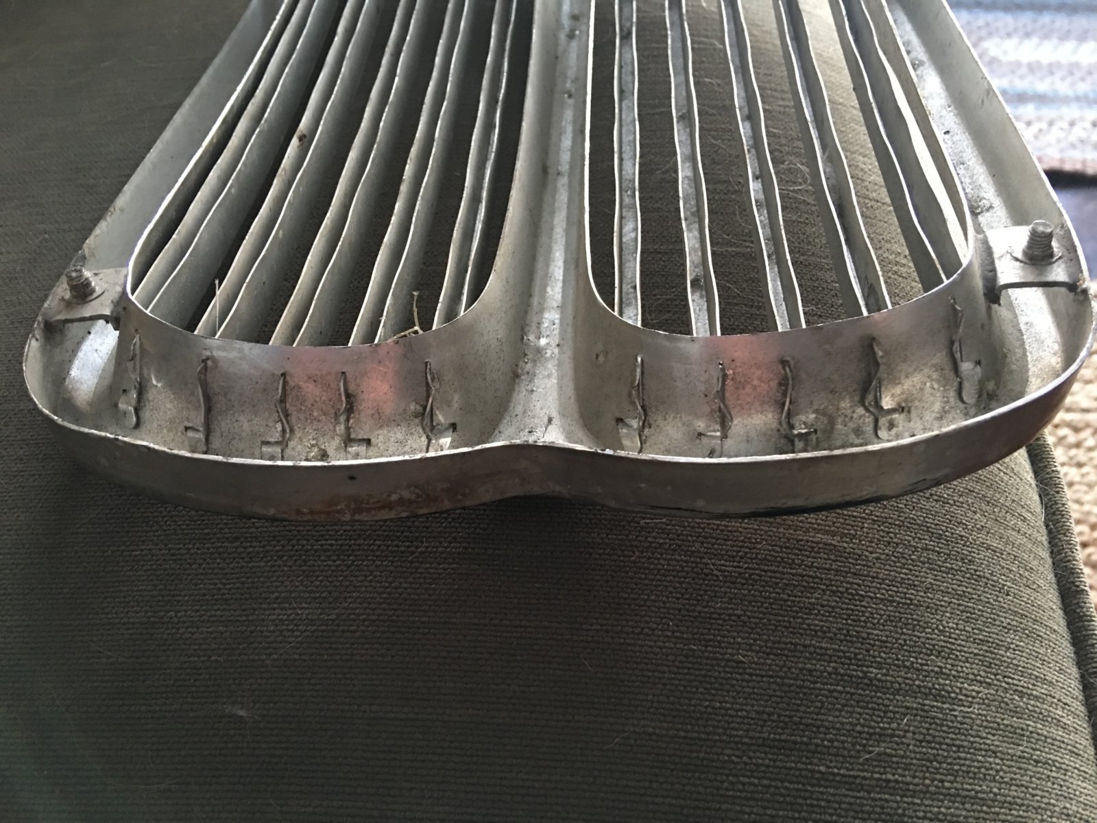

Yes some of the studs are broken. Would you happen to know if they are welded or soldered into place? And do you have a good non-destructive technique to remove and replace them?
It appears that some of the studs on your grill has broken off ! Each grill has 4 studs (m5) 14mm tall .
The studs are needed to secure the grill to the body.[/QUOTE
You can easily use a nut and bolt (or zip ties :D) in lieu of studs. You can’t see them anyway.
The studs and the base is also aluminum! They are NOT soldered! They are heat pressed I was told (not sure) ! You can use a bench drill and a drill bits and drill in the middle of the broken studs and remove them and then put a M5 screw through the hole , jB weld the back and make it as close to original set up as possible , it takes a little time . But not too hard to do if you start with thinny small drill bits and increase the size of the bits as you go. Be careful as the Alluminum grills are very thin.
Best wishes!
I think I will clean them up and let the next owner take the plunge on replacing the studs. Unless I suddenly find myself with an extra ounce of motivation and several hours of free time...
