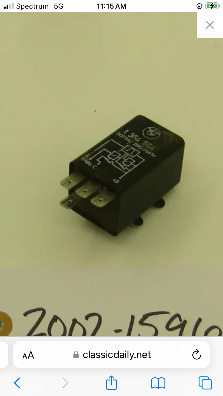

Hi All,
I’m relatively new to the forum. I’ve seen some great threads and advice.
I’ve got a 73/4 3.0CS which is running well except for turn signals failed. We traced to the relay (reference # above) and pic attached. Any ideas on where I cud obtain one? Napa didn’t seem to carry a FFF unit.
Thank you,
Chris Mc

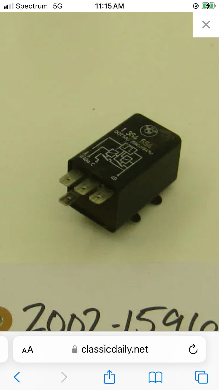

Hi All,
Thank you,
Chris Mc
Your original relay may be serviceable by careful disassembly and cleaning contacts, including moveable points. Your vehicle's hazard "flasher" switch may or may not have some bearing on turn signal operation. It still is a good idea to check all related grounds/connections, then peruse the linked posts. ;)

Tochi,
