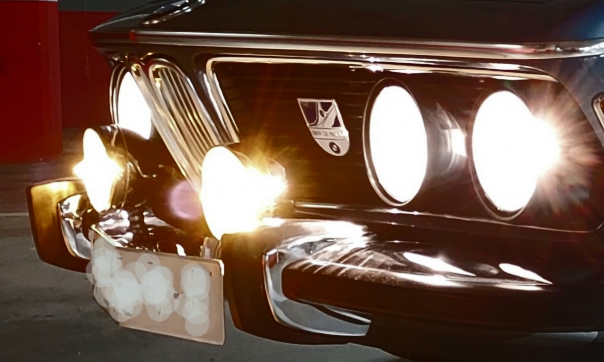

I really love the look of the lights above the bumper, but haven't wanted to drill holes in an otherwise perfect bumper. There are already holes underneath, hence the cibie purchase.

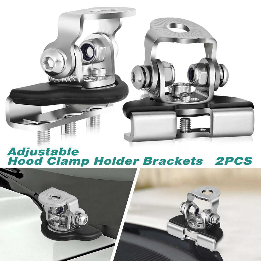

here is one type (haven't tried it) - but it would tighten up onto the bottom of the bumper ... if you over-tighten it might damage the bumper. the adjustable controls looks good and seems robust ... and its 30 bucks. mine is similar to this design, just doesn't sit up as high

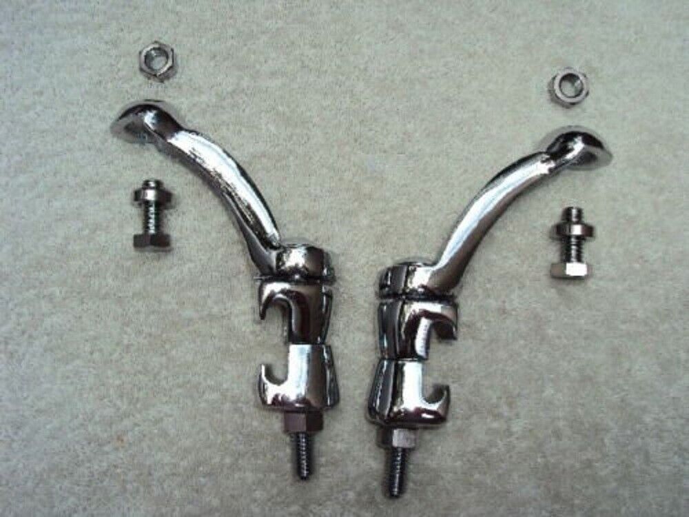

then there is the type that mounts onto the bumper bracket - i have not tested or measured to see if it would actually fit between the bumper and the apron. always been concerned that the light on the mount wouldn't clear the overrider ... but i always liked the idea. i have wondered if you could use this approach and fabricate a stainless bar that you could mount the lights to it and avoid the bumper and overrider

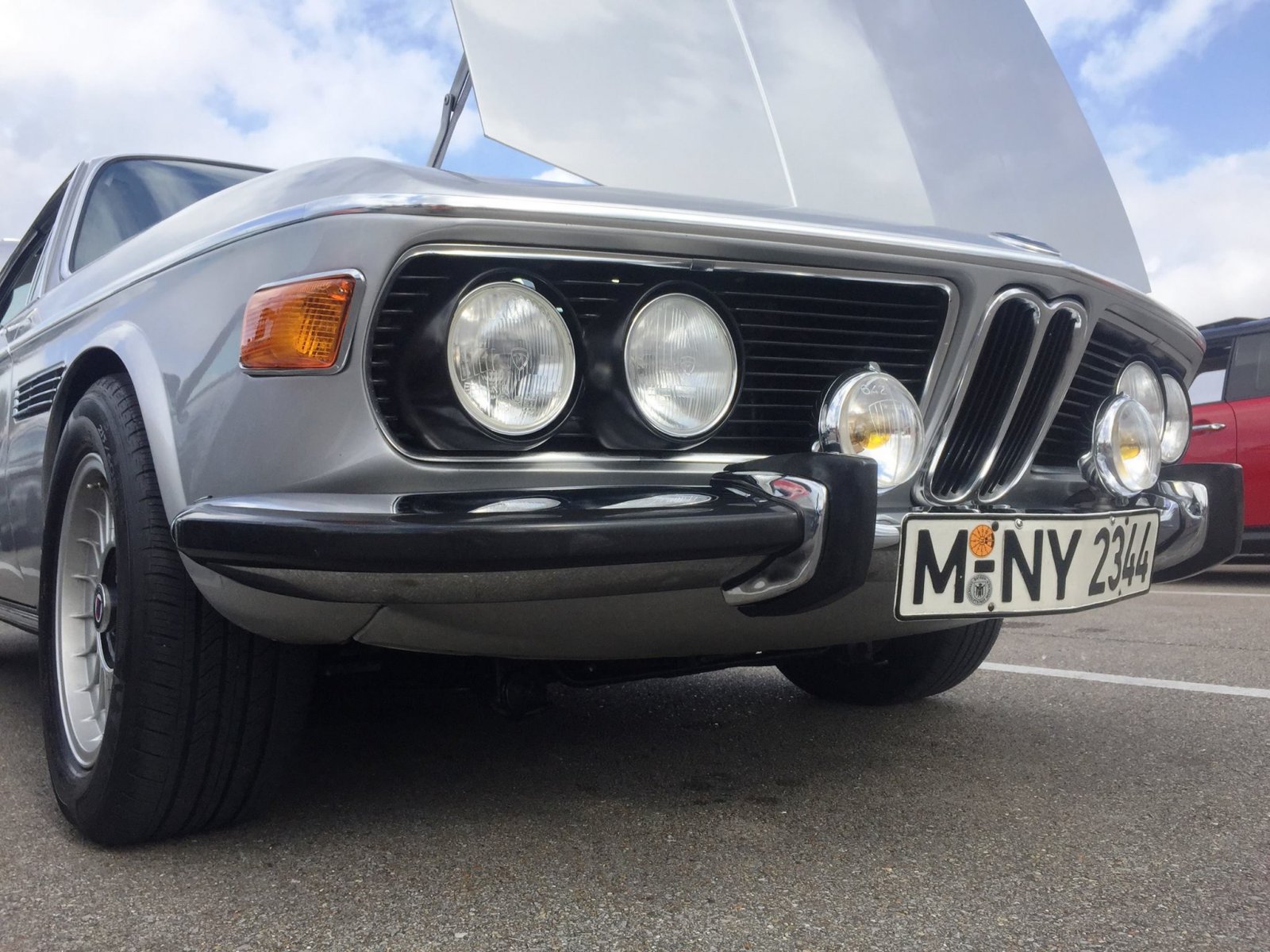

The problem is they allow the lights to bounce while driving - very annoying. I bought a spare center bumper section if I ever want to remove mine. Doubtful though.

I have a set of the clamp-on style, but recall @Stevehose telling us that the lights bounced. I have seen the clamps used on 2002's, but I cant imagine that the coupe's have sufficient space between the bumper and the body work. Also, I think the frame rails are too far outboard. The best look (in my mind) is on the outside of the lower / center section as Steve shows in his picture.

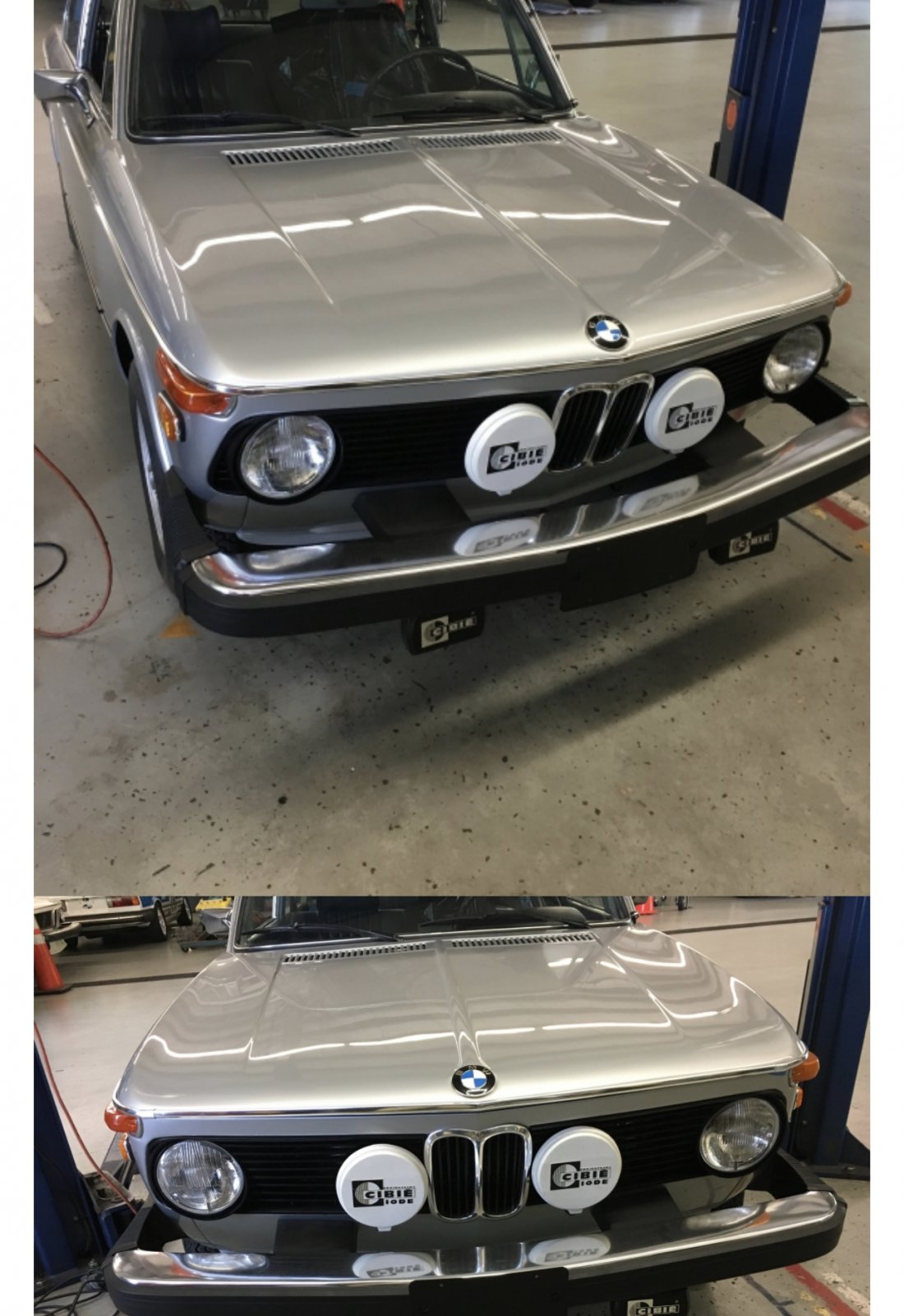

I bought some clamps that work through the grill for my tii. I didn’t want damage my original bumper. Can’t remember where I got them. But I think off the 2092faq site. The passenger side has a slight vibration at idle. Not driver side. They look nice though. I’ll send a pic when I can.
