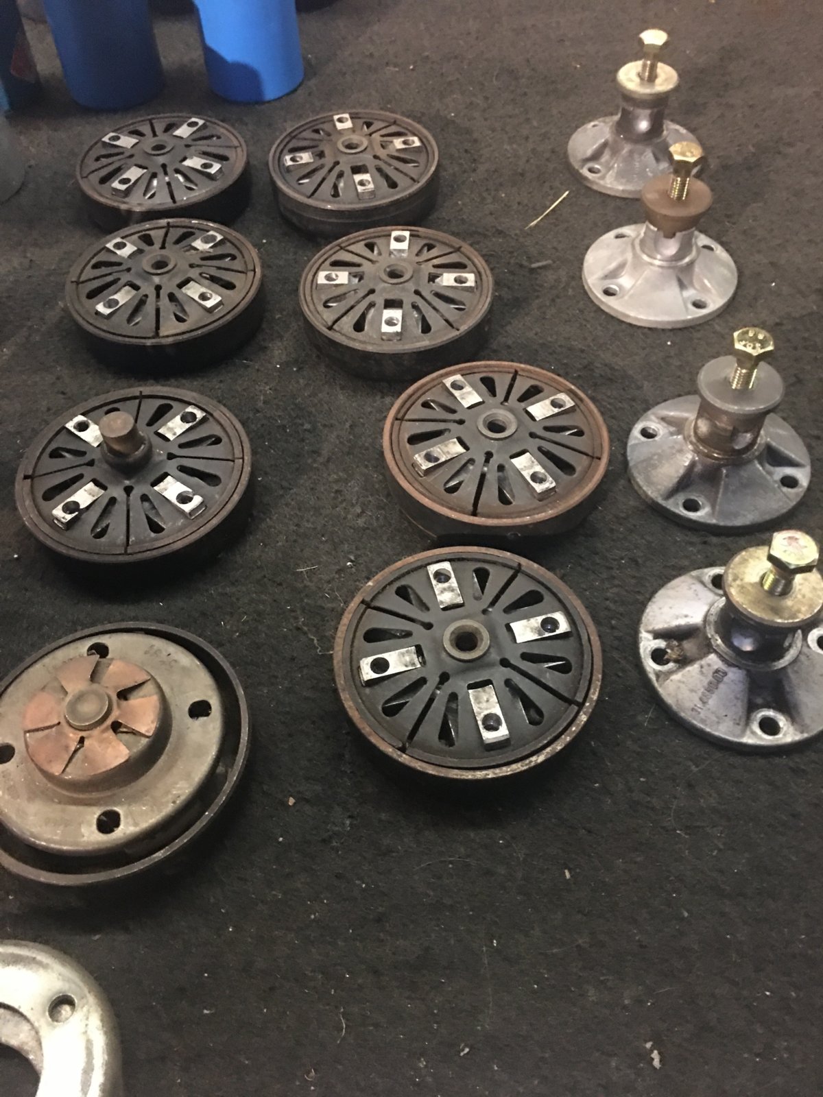

Friction fan coupling parts FS
sfdon
10,048
6,879
sfbay area
5 available as CORES
1 to a customer
You pay shipping as a donation to the board
You figure out how to make them function
What you see is what you get
