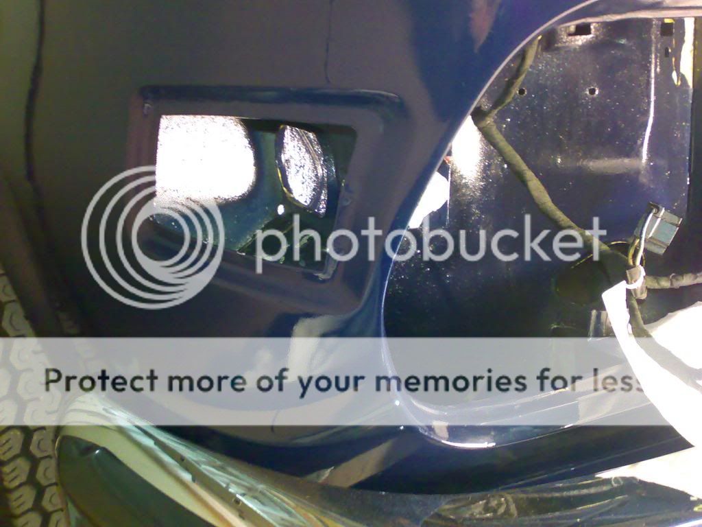

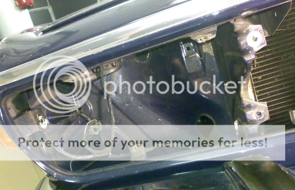

front area needs some care,
using FLUID FILM:

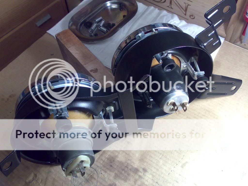

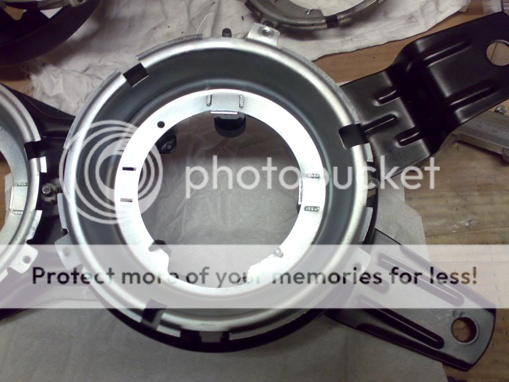

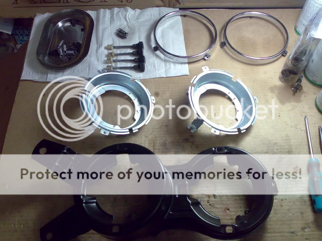

headlamp supports
dirty and a little rust
some months ago i bought a second hand ones from a scrapyard:
and i started preparing them for renewal, sand blasting
and these are the renewed ones, first galvanised and then epoxi painted in black
galvanised cupoles

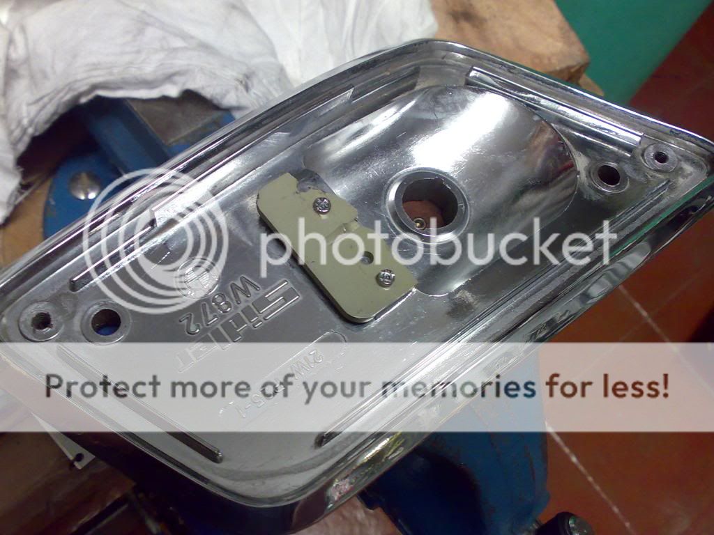

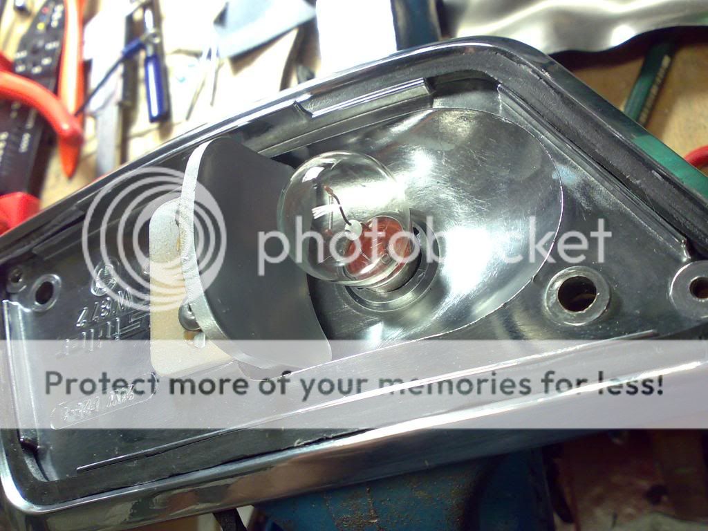

connectors and rubber cleaned
chromed rings too
springs and little rubbers

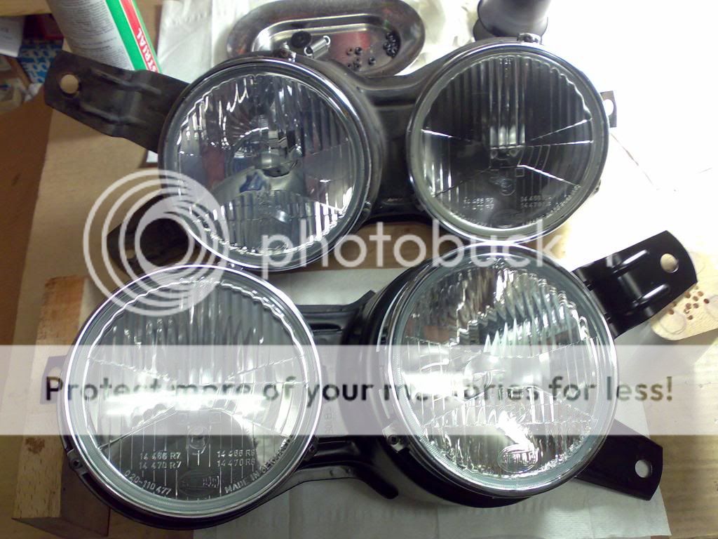

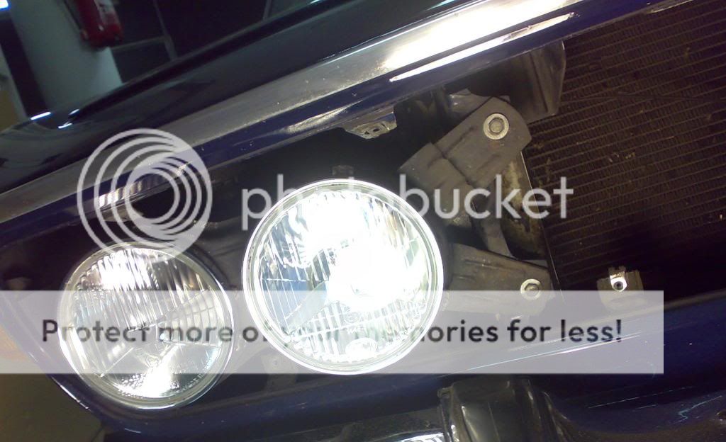

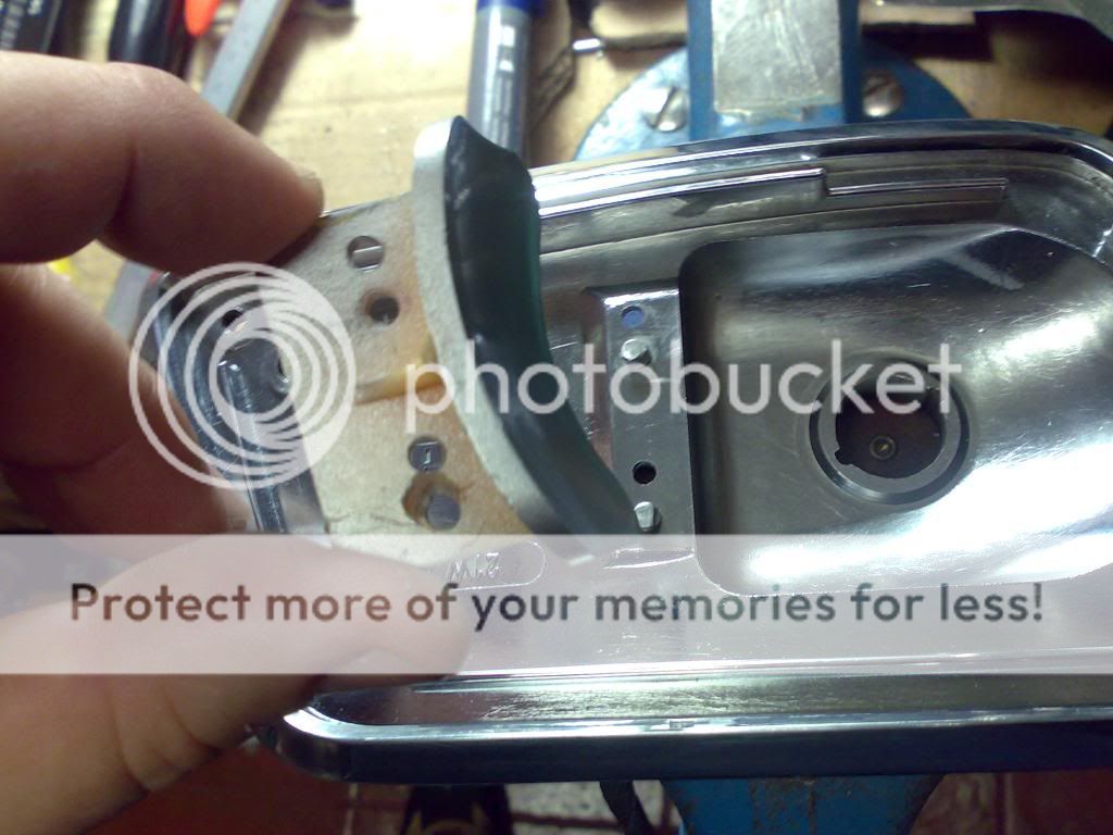

first dissasemble of actual headlamps

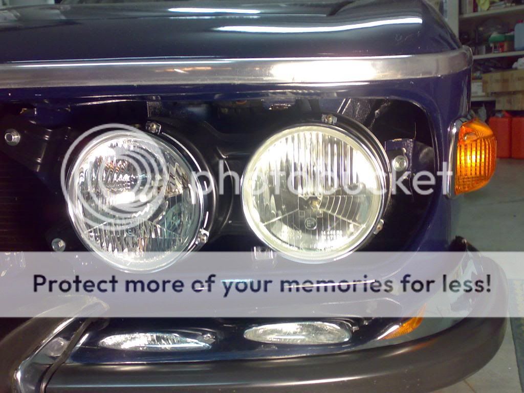

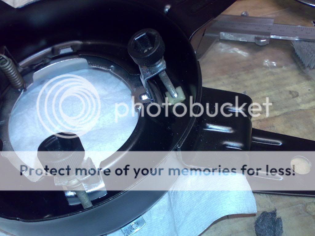

start assembly ;

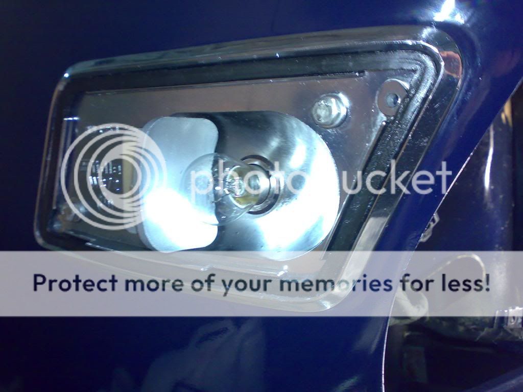

compare:

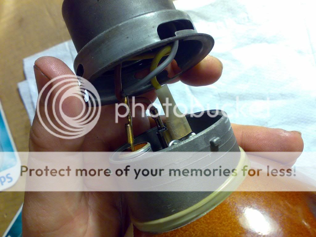

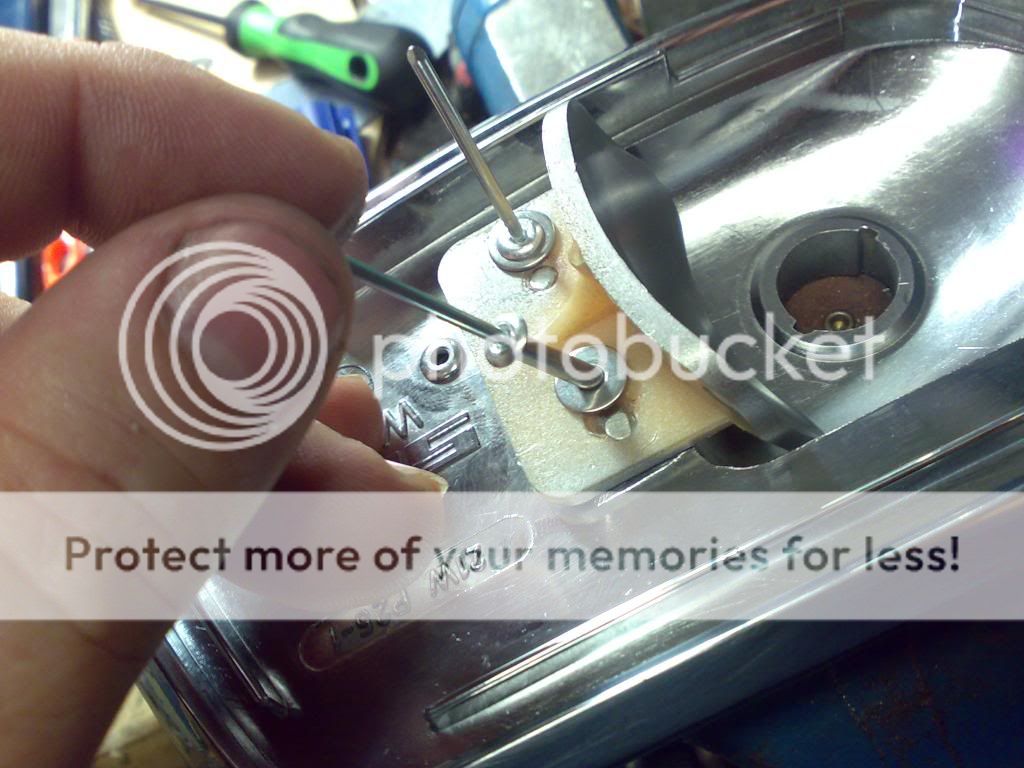

special procedure to clean the interior of the lamp glass, using special powders, dry cleaning and no residuals, see that the glass is blurred
Hold on! Wait a minute! did i miss a chapter? What are those magical special powders?
they are glass fiber powders, used in sand blsting equipment
