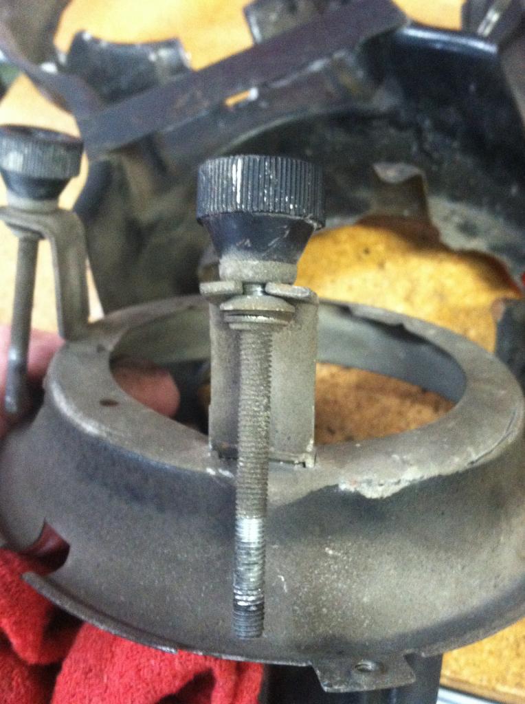

Hi Dequincey. Thank you for all your post and the pictures are very helpful when your doing the same projects. I just have one question. Is there a easy way to dismantle the two knobs from the headlamp support frame? So i can start sand blasting and painting. It sims like the screws are not made to unscrew. Any tips will be helpful. Thank you again.
well, it is not simple but doable
you need to press it inwards while compressing the two lateral tabs
remove the screws first, but you can not unscrew them all the way, you must take them out from their holder
when the pressure done by the screw is not too much you can pop it out from its holder, then you can unscrew it completely, and the you will be able to dismantle the knobs
regards
I'm afraid I am going to break these. Tell me again how to remove these screws without damaging anything ?
