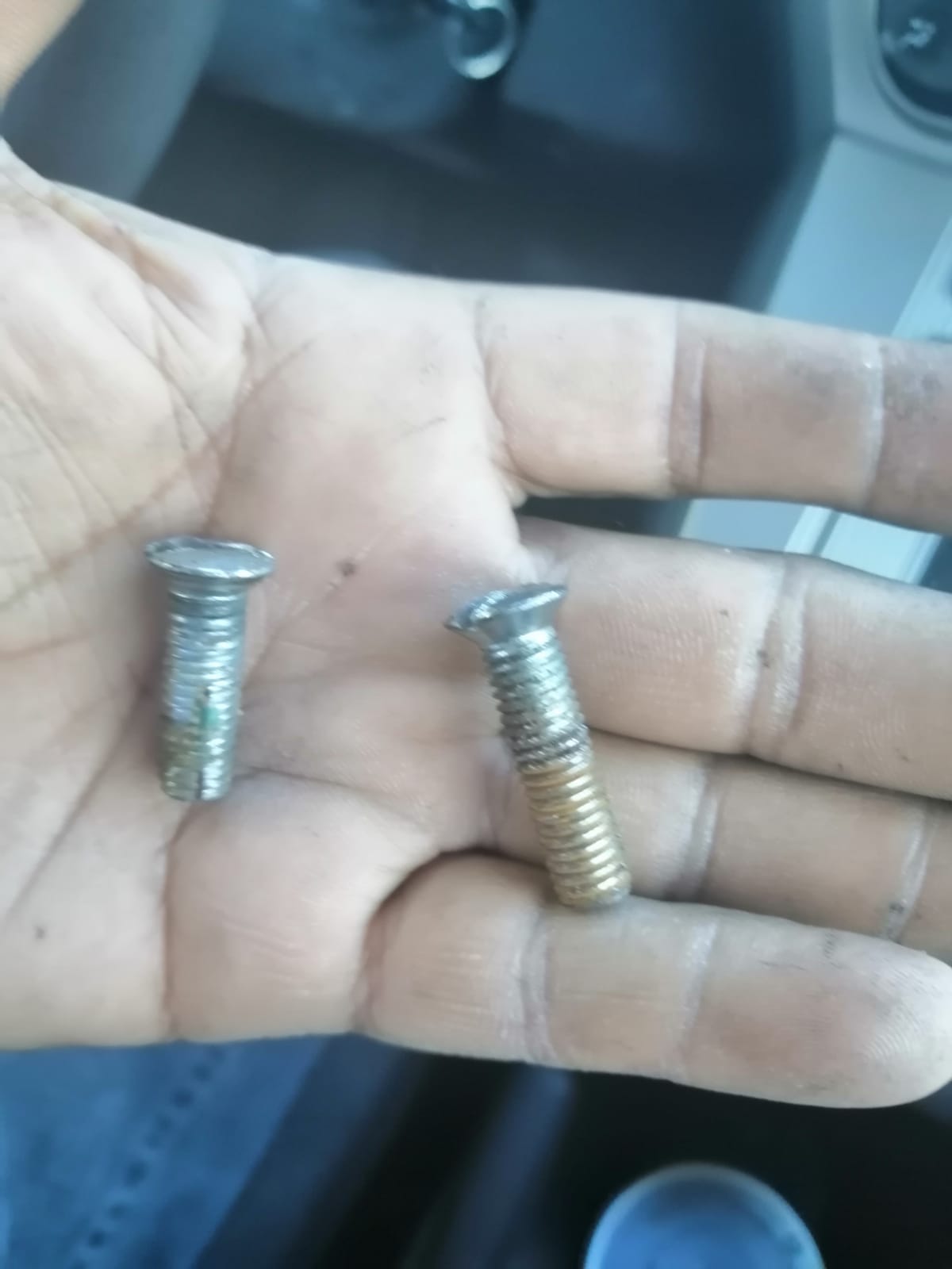

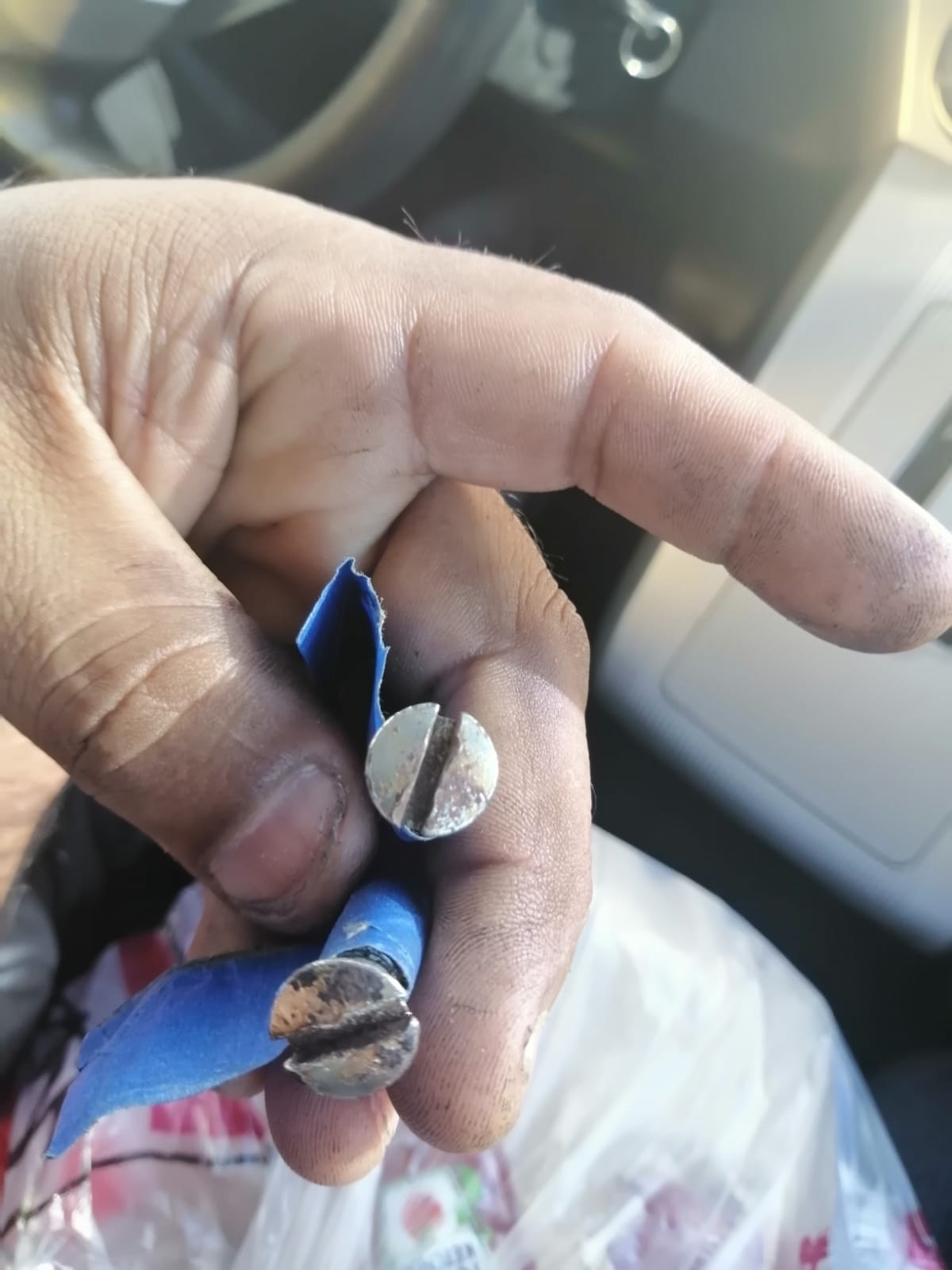

For rebuilding the front seats, does anyone have a source for these bolts? Anyone know if they are available new, or are they NLA and have to be refinished?
These are called 'lens head screws'.
I've read on here that Generic metric stainless steel ones and polisch them up, will be very, very close to the original plain steel chromed ones.
