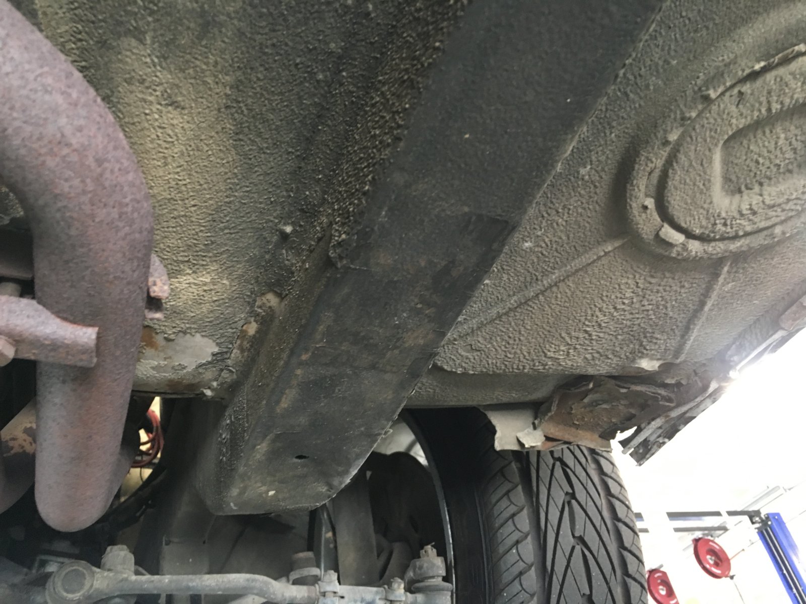

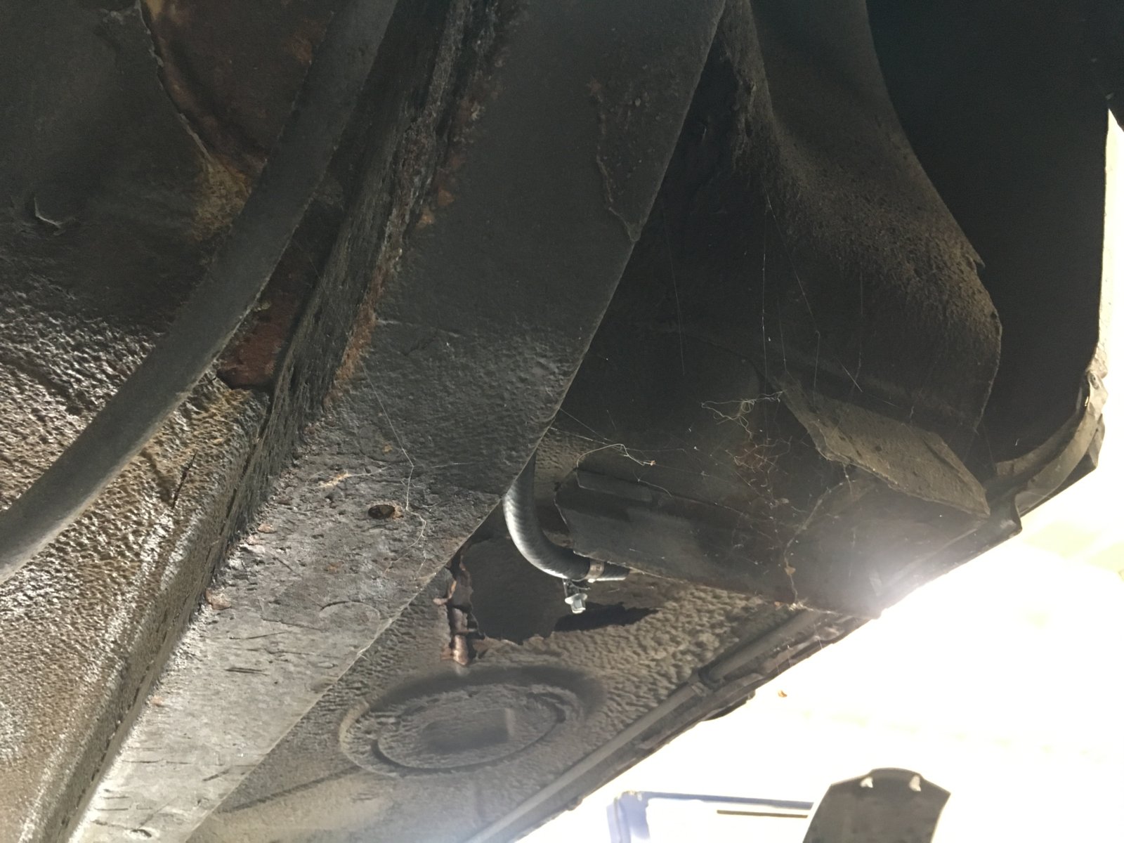

With these pictures I'll change my mind. Not sure what it's worth but 30 seems high.
Belgiumbarry
1,618
1,117
Belgium
if it is "only" this ( floor panels ) and the car is complete and running fine .... it's acceptable for that price in Europ "terms" . If shock towers / rockers are also rusted ... that's another story...
My floor panels were even more rusted.... but if you need to weld in new ones , it doesn't matter how bad they are rusted.:D
Big advantage on replacing floor panels is that there is no expensive painting to be done... just simple coatings in & out .

Can someone explain to me why/how floor pans rust? Water coming in through the windshield seal? Door seal?
Rockers, near the front, I imagine having water running down and collecting down there.
Belgiumbarry
1,618
1,117
Belgium
from were the water comes is another question , but it finds his way between the steel bottom plate and the glued anti vibration plates. There it stays wet and do his job :mad: you cannot reach it , nor see it.... and the floors are the lowest part ofcourse .... once the plate go's up ( example the tunnel ) there's no real rust anymore ....
HB Chris
19,418
8,759
Huntington Beach, CA
Water comes in from door seals, windshield seal (rotting the dash wood too) and A/C when the drain gets plugged in the console.
Markos
13,369
7,503
Seattle, WA
My car is a working example of all of the above (except no AC). If I spray the car with water you can see it run into the interior.
