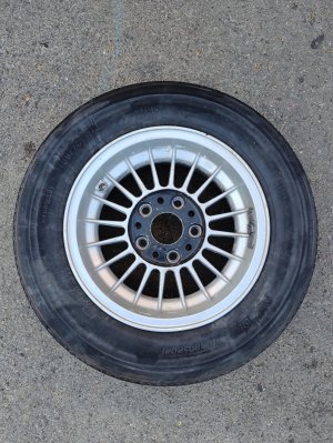

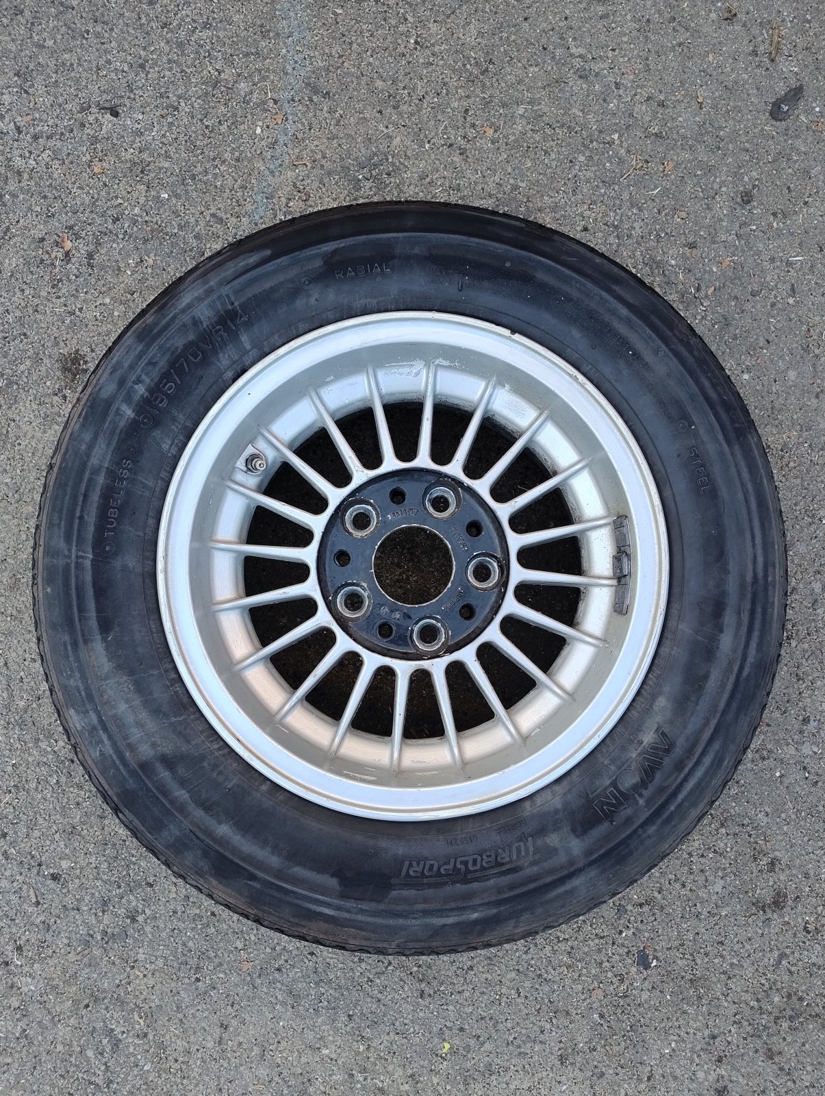

sorry to raise an old thread but I’m still having trouble deciphering what wheels I have. @Simufly obviously you will know best as you would have bought and installed them, but for clarification purposes:
1. I believe this is the BBS made wheel available as new from W & N. Is that correct?
2. But what about this one. Which of the above list does this belong to?
Thanks Simon. That makes sense of the pictures. Therefore picture 1 is gen 6, picture 2 is gen 2.
I need to get another for the spare...looks like the Gen 6 is probably the most cost effective one to go for.
Correct. Yes You might find it difficult to find a angle used gen 2 wheel so the W&N solution would be the way to go.

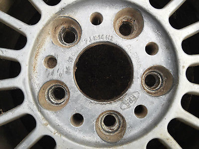

Apologies for resurrecting this thread again but I'm also scratching my head over this wheel. The "Alpina" lettering is different to others I've seen. Is this a "gen 2"? I also can't make sense of the second number in the date stamp. What was the time period for the rims that had Ronal stamped on them? Cheers
this is the last of the vintage version - the first 3 were '5' hole. the '10' hole started in 75 (i believe). you can still buy 14" alpina (10 hole) wheels new. W+N generally has them. there is more information on the variations in the FAQ - tires + wheels
this is a 5 hole
