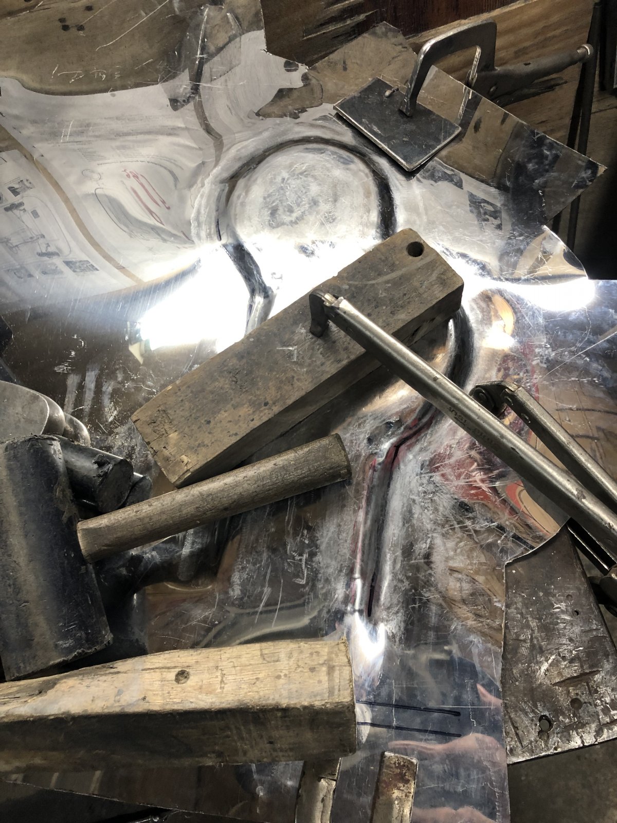

FS E9 Stainless Steel Fuel Tank

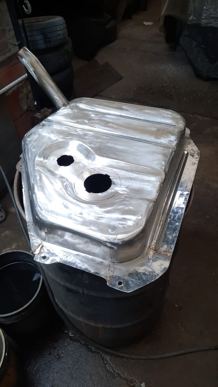

A little progress...

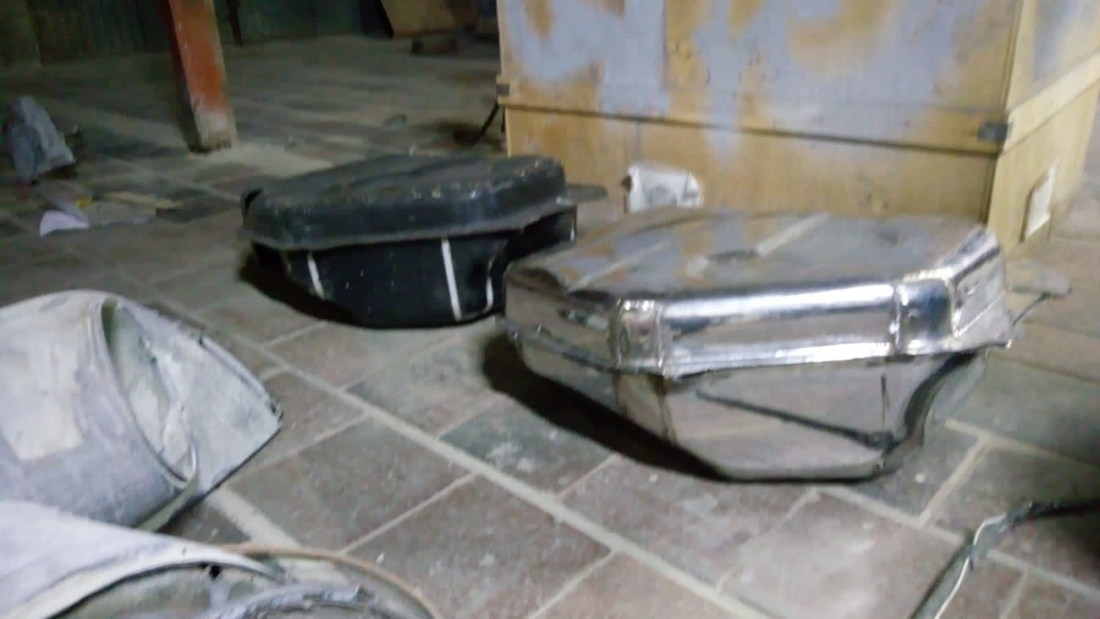

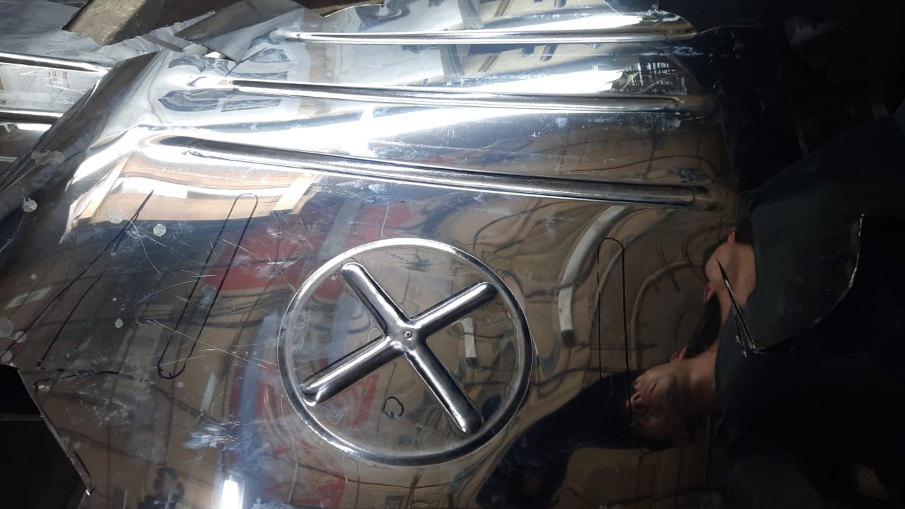

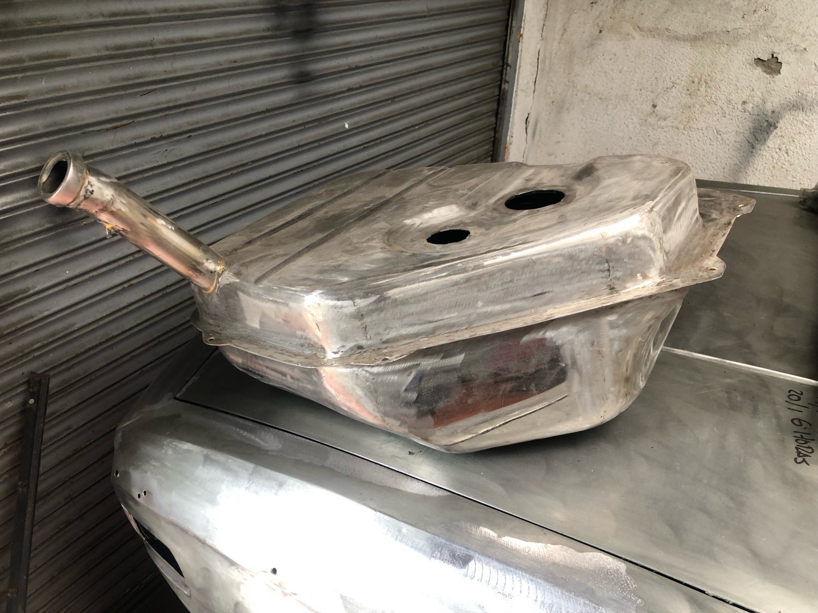

More progress

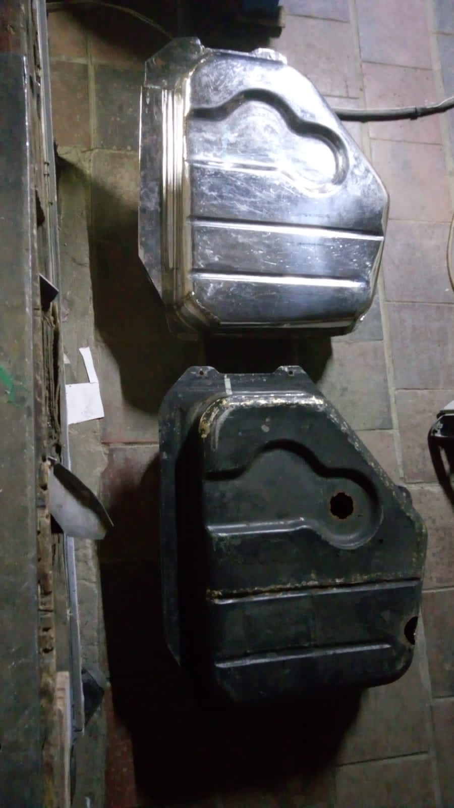

Looking great. I have an early and late tank, I think the only difference is the hole for the suction device. I can check when I'm in my garage next, I could probably send you a template if you like. All I ask in return is a free tank.
Hi Chris - I'm in the UK, so none of those US market specific mods here. Unless it's the later larger capacity tank I'm guessing that both are almost the same. I'll compare depth of suction devices next time I'm in the garage.
I'm joking about expecting a free tank by the way.
Euro or US got the same tanks, the euro 74/75 just didn’t have the large reinforcement on each side of trunk and these are mounted from the bottom.

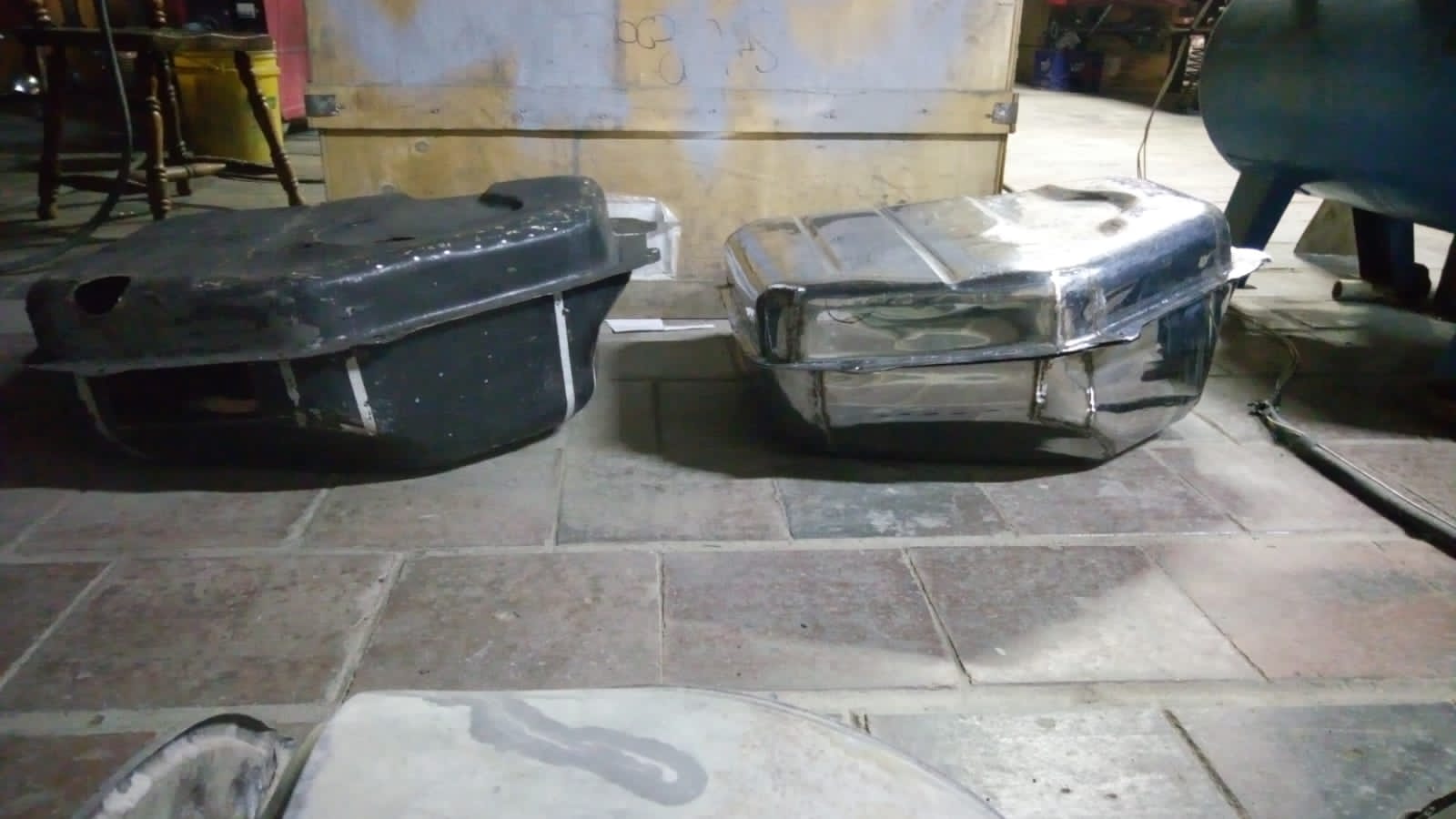

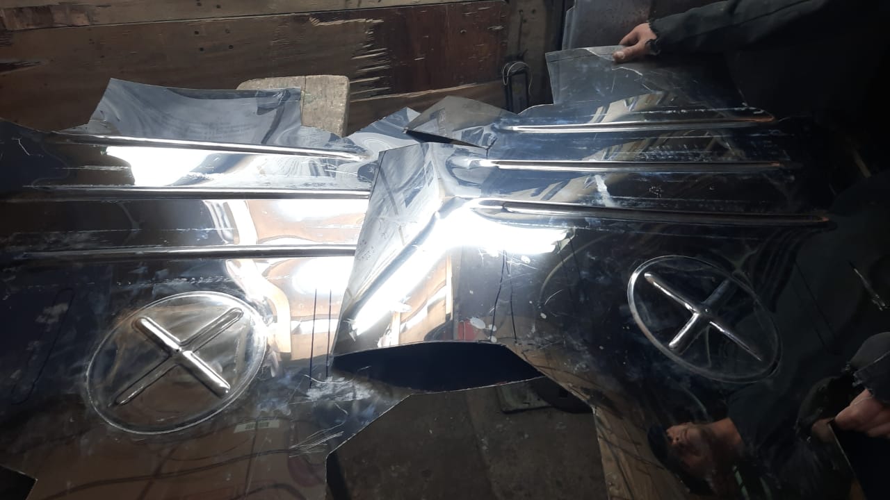

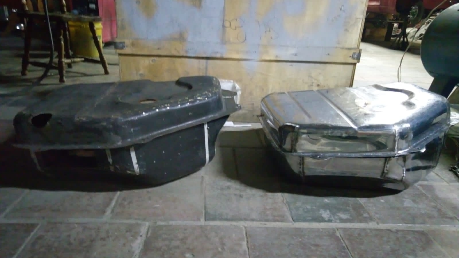

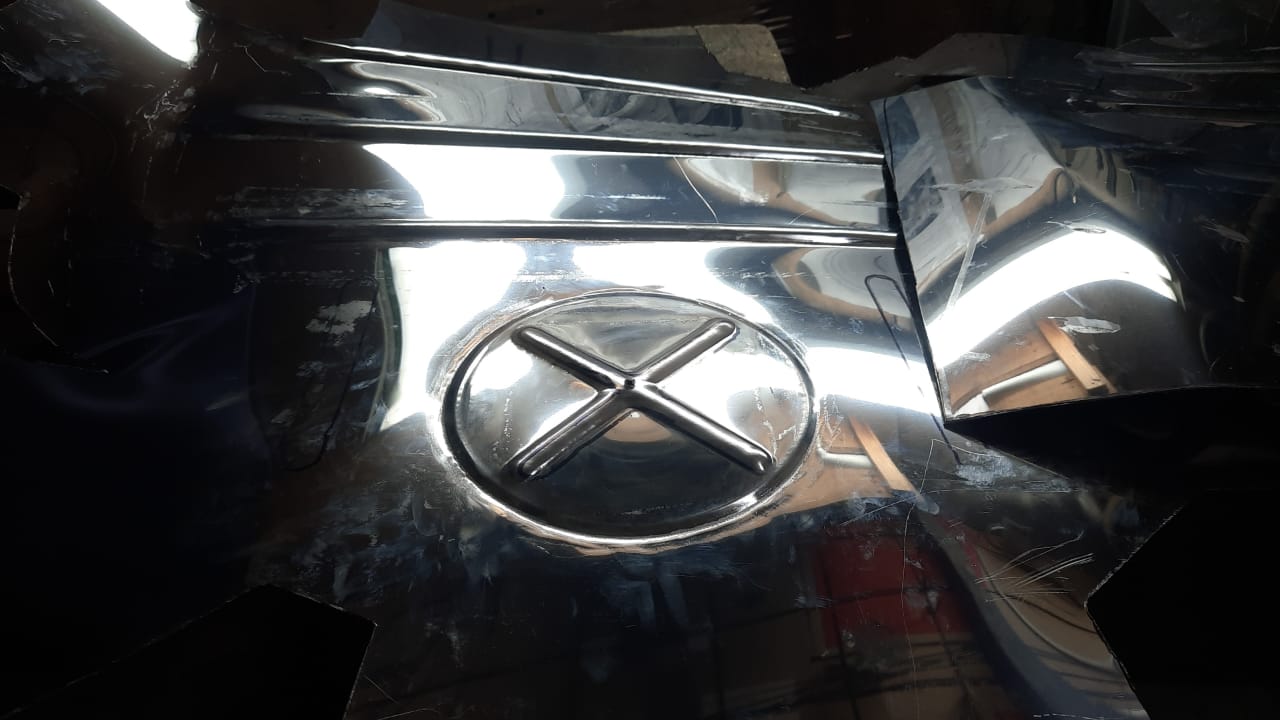

Step 2

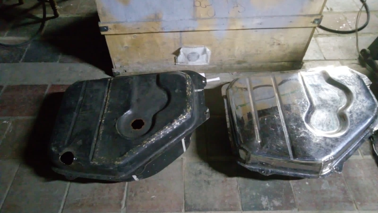

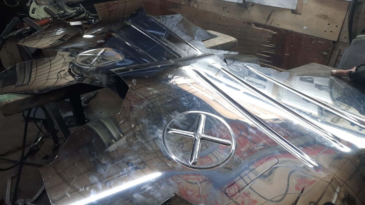

Step 4 (the worker had an accident and we had to stop for a few months…)
