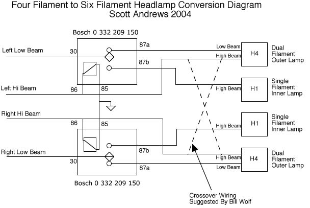

I rewired my 635 headlamps using a pair of relays in order to use dual filament outer lamps. What this six filament system did was to feed current to the low beam outer filaments in the low beam mode, and then to energize the high intensity outer filaments and the inner low beams in the high beam mode. SO the inner lamps came on to fill in the front region in the high beam mode, but at any given time only one of the outer filaments was energized. Worked great, and it relied on the relay controlled power for the headlamps (standard inthe 635).
Here is the circuit I developed.
That said, I'd definitely be interested in a professionally made improved E9 headlamp harness.

The issue has to do with using four filaments vs six. The four filament setup has the high beams on the outside of the four lamp set, and the low beams on the inside. I believe the idea is that when the high beams are on the inner low beams are also on, but when the high beams are off, the only low beam lamps are in the inner spaces, which not only looks weird, it doesn't do a very good job of lighting the edges of the road.
The six filament setup has a low beam filament in each lamp, and the high beam filament in the outer lamps (so the outer lamp has two filaments, high and low). This gives you three lighting options:
1) High Beam: Outer high beam filaments on, inner low beam filaments on; Low Beam: Outer low beam filaments on, out high beam filaments off, inner low beam filaments off. This is the setup my relay circuit provides.
2) High Beam: High and Low beam outer filaments on (heats up the outer lamps a LOT), inner low beam filaments off. Low Beam, all four low beam filaments on.
3) High Beam: Outer High Beam filaments on, All Low beam filaments off. Low Beam: High beam filaments off, all four low beam filaments on. (not as complete lighting in high beam, and excessive lighting in low beam).
So the circuit I posted sets up the six filaments in configuration 1 above.

Yeah, this is basically what I ended up with on the 635. The relays are right next to the battery on the left front of the engine bay. Mine was hand made, but a nice well structured controller (thinking something with relay sockets to avoid a bunch of spade connectors to the relays), and crisp new wiring would be a huge improvement. Even on a 1980 car the wires were pretty crusty!
The key question is what is the filament configuration (see my post #29 above)...
