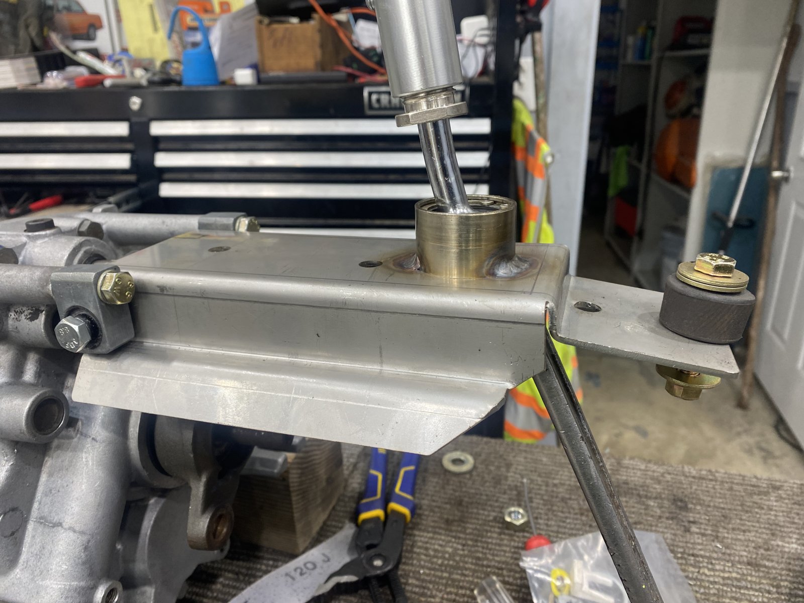

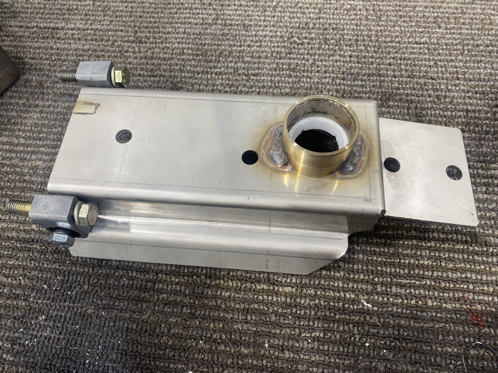

i’m using the one @halboyles makes for my 265…

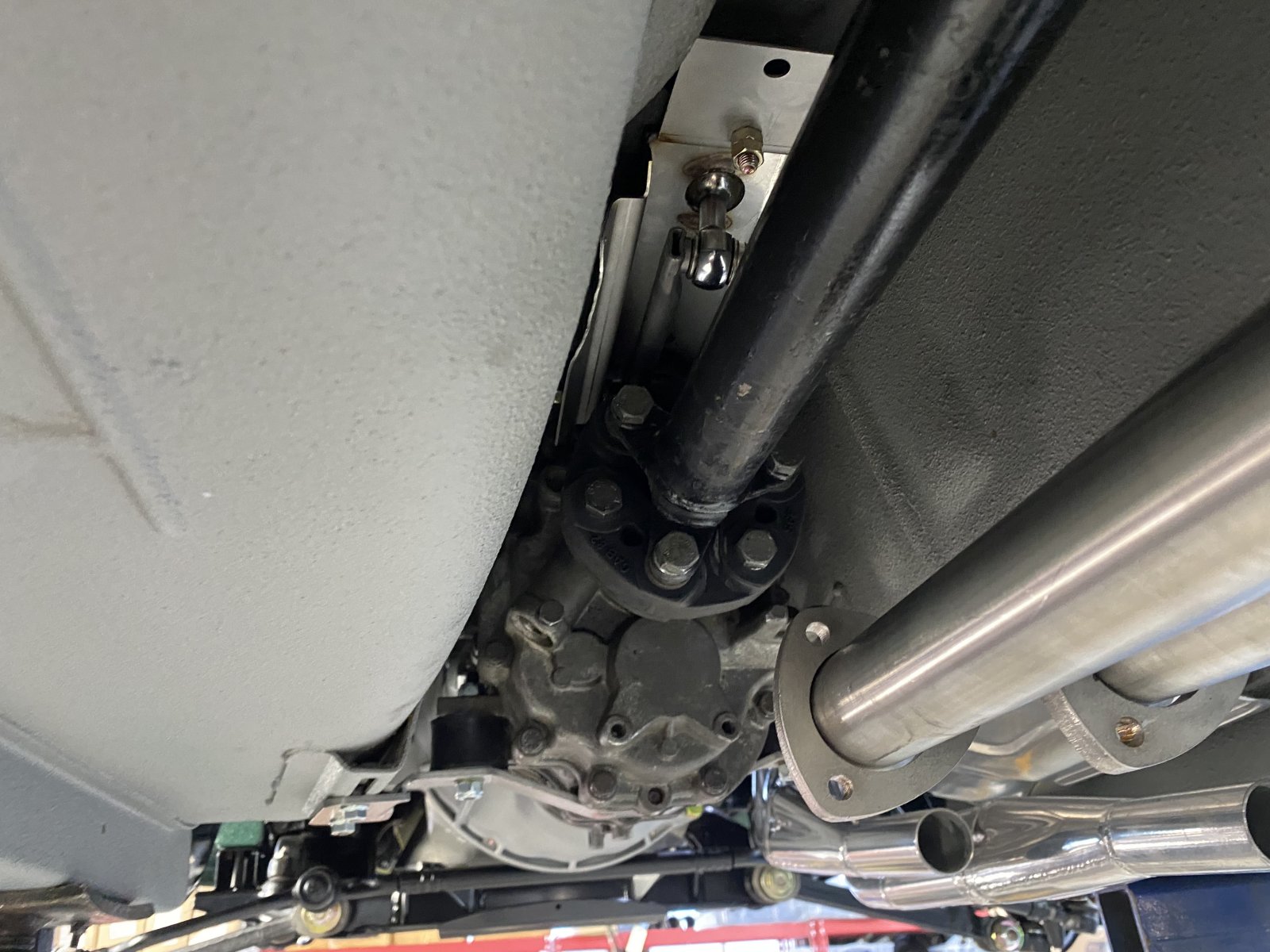

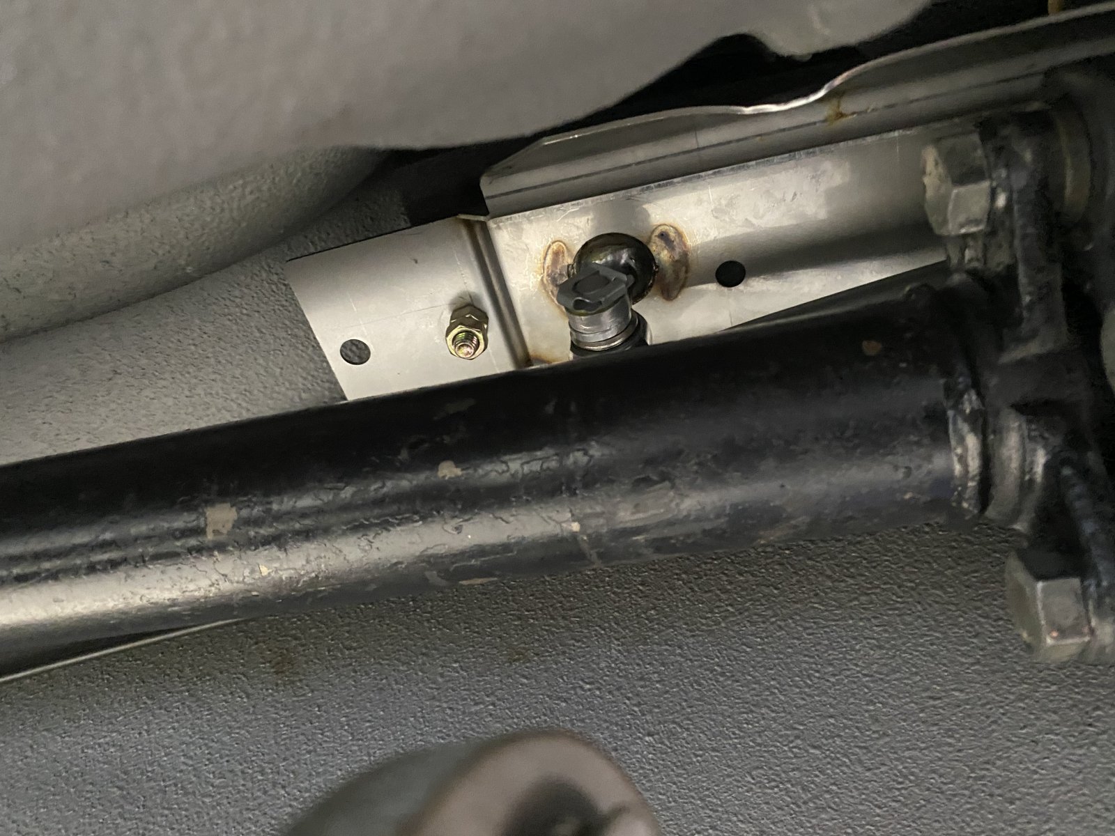

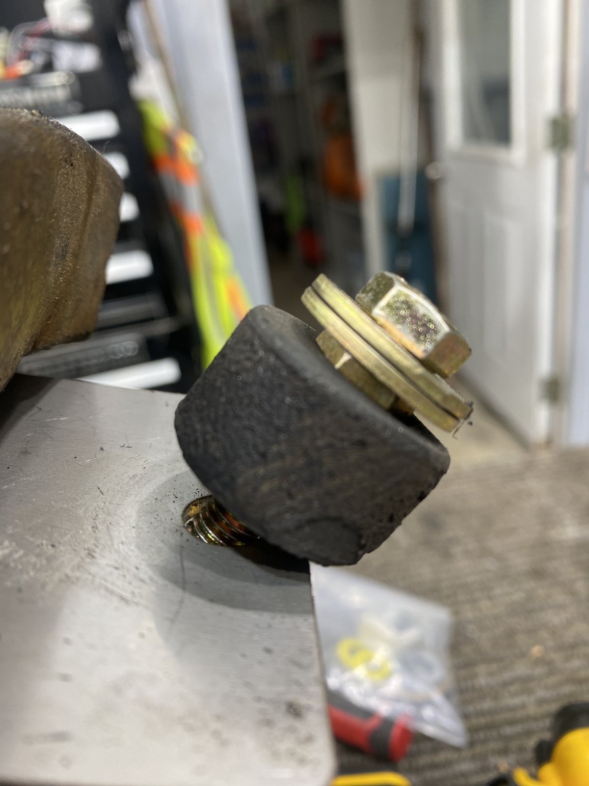

I set mine up like this…with a sway bar bushing used as spacer for tie up at rear with #6 double nutted bolt Thur the body…
Exact same setup I have on mine. Well, after the initial setup let loose in Pittsburgh, and I had to pull up on the shifter for every shift on the trip back to Washington DC.

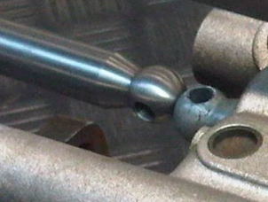

You need a horizontal shift rod and the lower shift lever for a 265, 4 speed is totally different.

Contact @halboyles as he is making shift platforms.

The 4-speed lever is bent more aggressively than the 5-speed, so the knob will sit further back. It's driveable, but not correct.
I like Hal's design using the nylon cup from the aluminum shifter consoles. Much more robust design. Will be easier for all you people that like your short shifters. I put a 265 in my old E12 530i years ago and someone had modified the console to use that. Was pretty slick.
