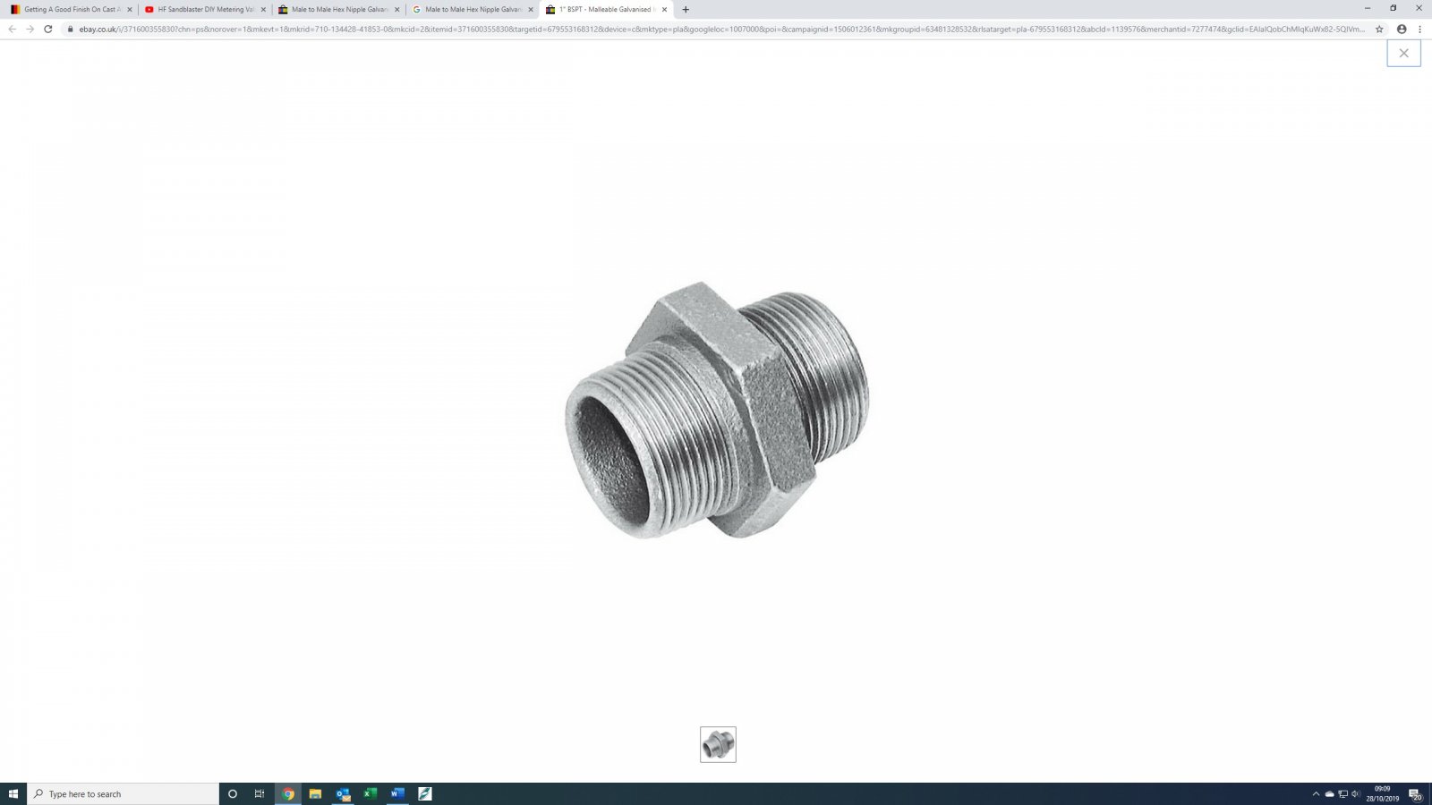

  • Metering valve…
These can be purchased for $100 or more – however my blast cabinet cost $100 so wanted a cheep way out… so found this
please note – the threaded tube in the middle about 6 inch I did not use but put in this section below.

If you will replaced the 6 inch tube with this small connector, where did you insert the half-inch measuring tube that controls the amount of air going in?
Hi - i drilled through the hex bit of the connector to form the outlet for the pipe - the thread size was 10mm , it just fits on the flat of the hex- and for the outer vent i used a m10 bolt , drilled down the center with a 6.5mm drill to - and used a m6 bolt to used as the regulator...
