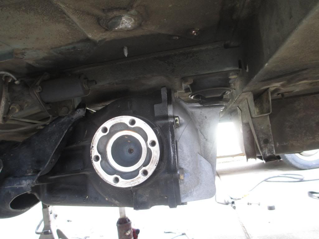

It dried up enough to go out and take things apart and test fit the E28 rear axle. Surprisingly, it lined up on all three stock mounting positions.

Things that don't fit right away:
The sway bar needs to be mounted. If you choose to use the E28 bar, you need to weld some attaching points to the frame. If you keep the E3 bar, you have to weld some tabs on the trailing arms and carrier. I'm keeping the E3 bar.
The e-brake cables are slightly different, so you need to extend the cable tubes about 10".
I have E28 differentials with differing covers, you need the one that has the mount centered on the diff.
You need to rework the brake lines and weld a bracket to the trailing arm to line up with the existing flex lines.
You can use any E30 differential and change the flanges and cover to fit the E28 mount. I have a 3.25 LSD and a 3.73 LSD, so I'll be experimenting there. E30 LSD's are fairly easy to acquire, about $90 at P-n-P.
Got the rear axle all back together yesterday and it works very well. I actually gained a bit of tire clearance, probably because my Bav rear axle was really thrashed. I guess it's I'll be putting some 255's on the rear in a while. I'm liking the longer legs of the 3.25 gears, first gear is actually worth something now. Now on to the headers and front struts.
Outside of the brackets for brake lines and sway bar, does everything bolt in? No issues with the diff itself? I have a 3.25 diff sitting in my garage that would be a nice addition to the car.
As you know, it's never quite as easy as it first appears.
You can actually use the stock E28 hard brake lines if you get some longer flex lines that go all the way out to the original bracket.
The e-brake tubes have to be moved up into the tunnel because the E28 cables come over the top of the carrier, and the tubes have to be extended 7". I used some 12mm tubing from a tranny cooler line to get the job done.
The differential yoke protrudes a little bit farther than stock, but I have enough room in the driveshaft slip joint to accommodate this.
The diff itself is a bit larger than stock, so if your exhaust pipe is presently real close to it you may have to massage it a little. Since my exhaust system is on its last legs and I've got a set of Stahl headers going in I'm not too worried about this.
I've got the Bilsteins with the 6 grooves in the body and the moveable snap ring, so height adjustment is a piece of cake. E28's use a different diameter spring, so I just transferred the stock lower spring perch and rubber to the E28 shock.
I had to clearance the floor around the outer trailing arm attaching point as it sits a little close. I found some old Chevy rod caps that fit into the gap, so I jammed them in then jacked the car up with all the weight on that point. Worked like a trained pig.
The diff cover that I used is the centered one that comes off the earlier E28's and bolts right into the stock Bav mount. My other option was an E34 cover.
