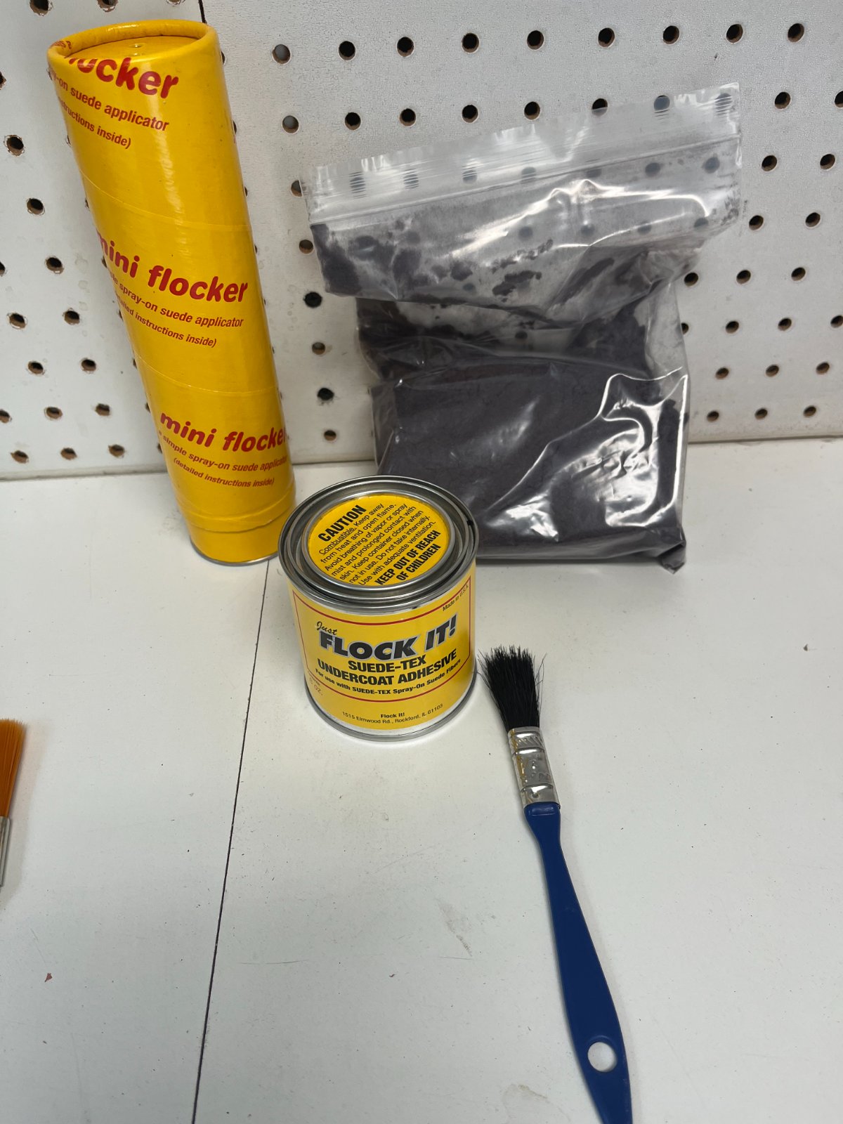

For the benefit of anyone restoring their dash, I followed this thread to re-flock my dash parts and I'm happy with the outcome. I brushed the glue on instead of spraying it. I'd emphasis what was previously stated that it is important to liberally apply the glue so the fibers stick well everywhere. The glove box is the trickiest part because you don't have much time between applying the glue and applying the flock material. I first did the fuse box door because its a small part and was a good warm up run. My very first warm up run was the end of a tin can. Overall the flocking process is forgiving, but I recommend doing a warm up on something like a tin can.

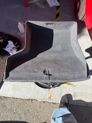

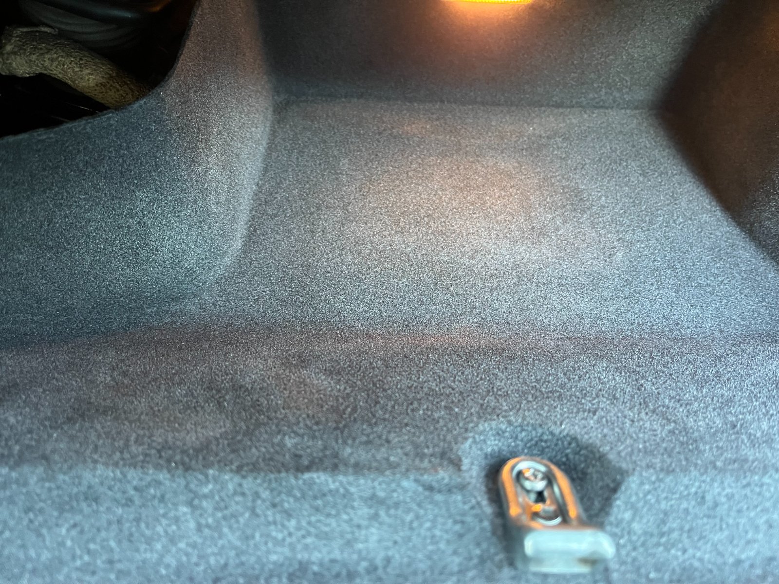

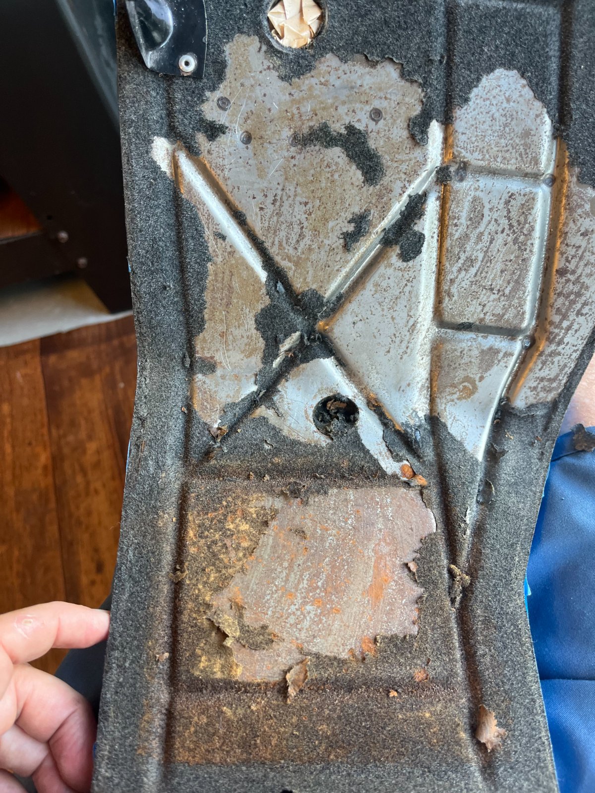

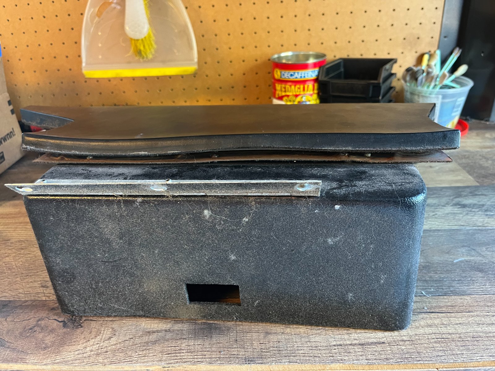

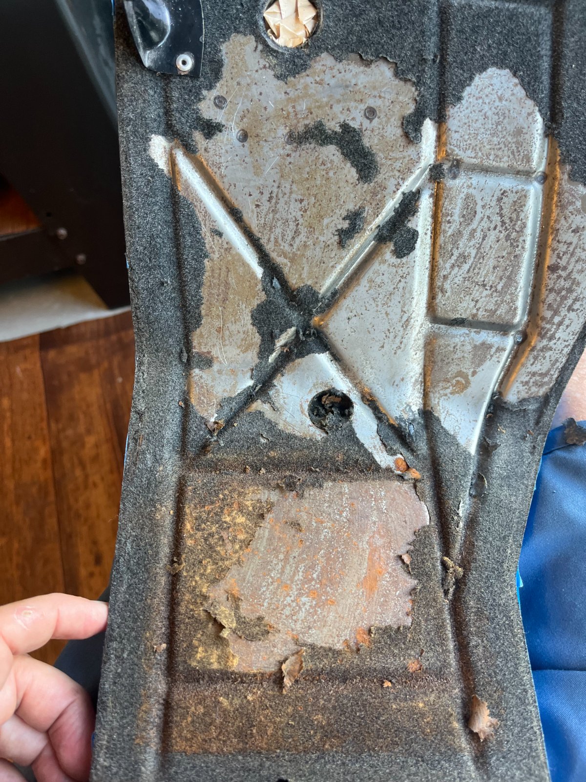

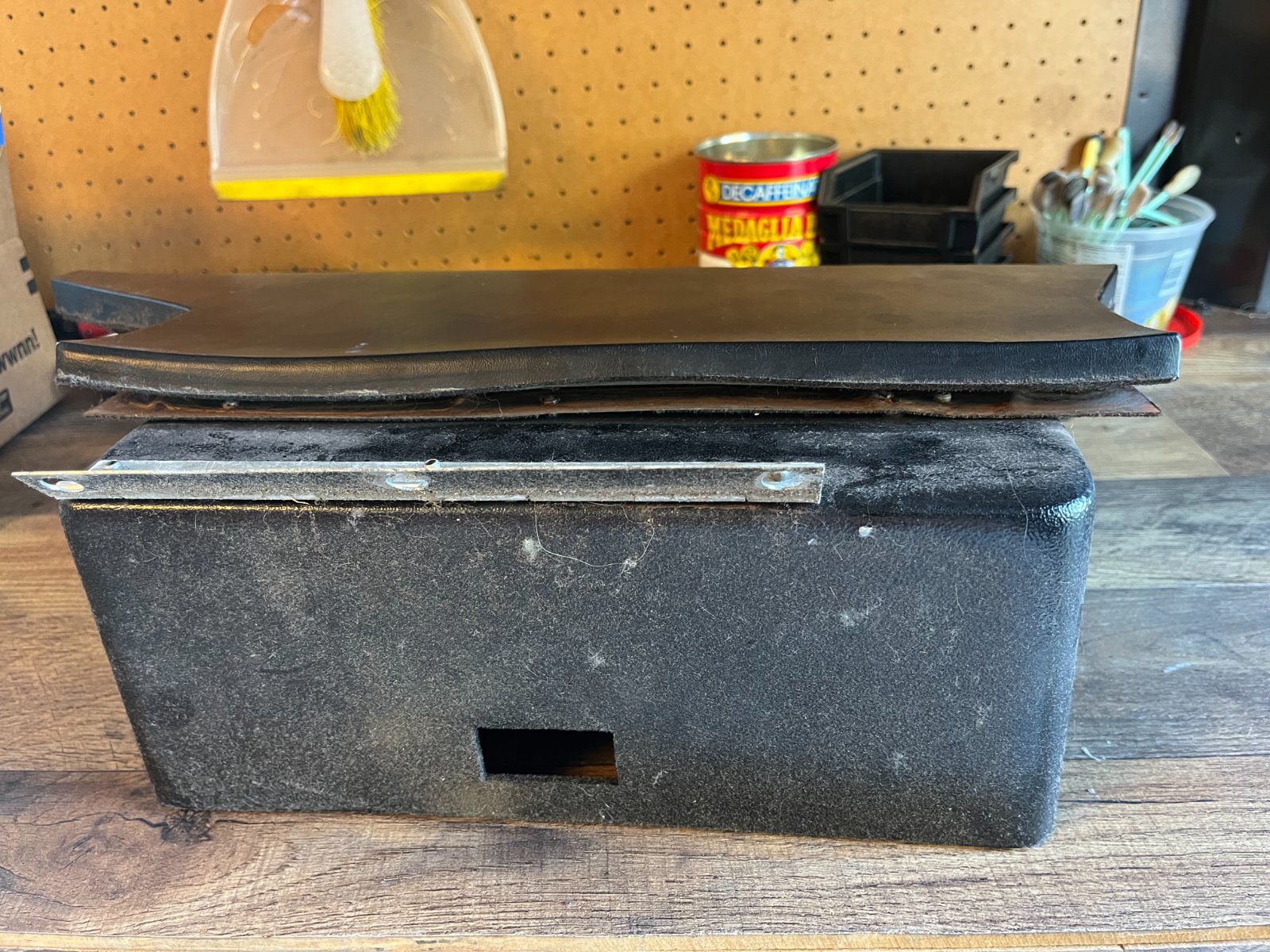

Here are some pictures:

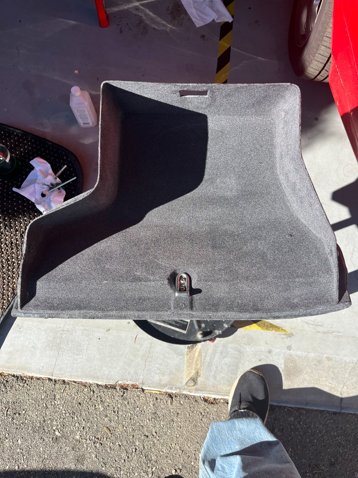

Condition of flock prior to restoration

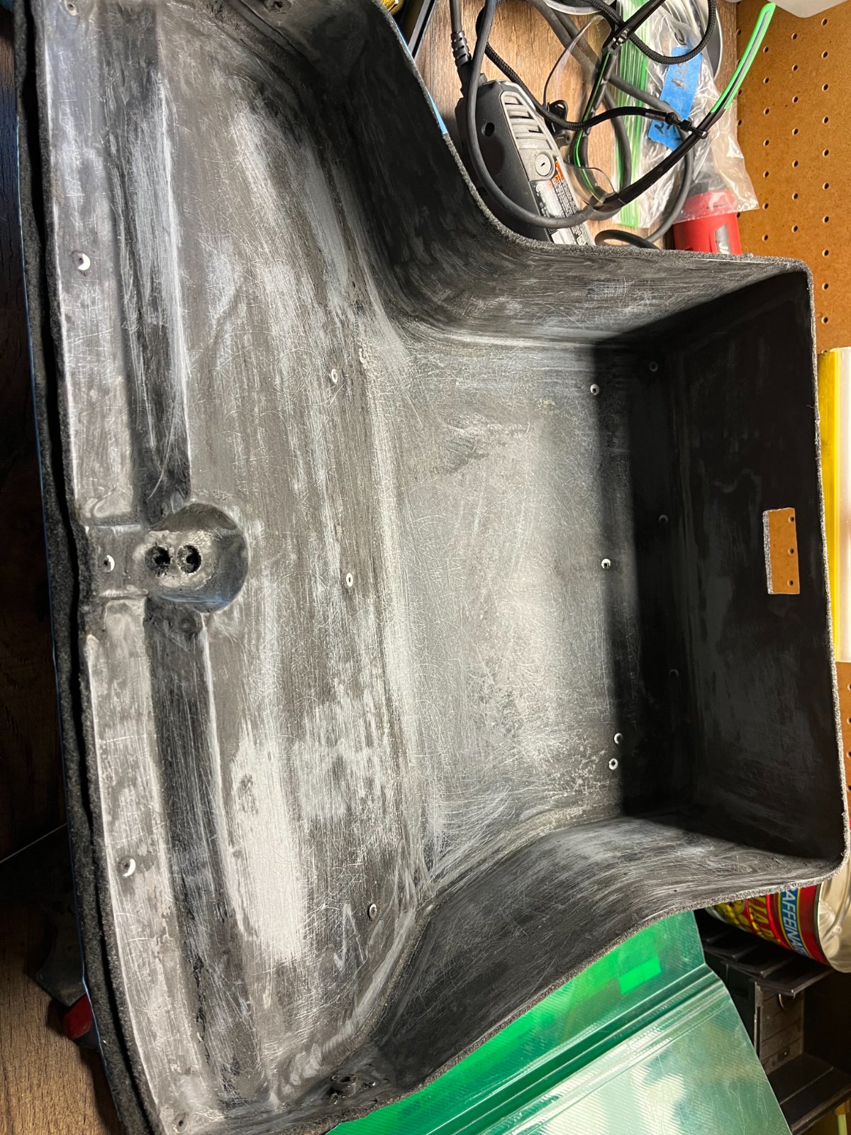

Removing the old flock - its a grind
Primed and ready to send to Just Dashes

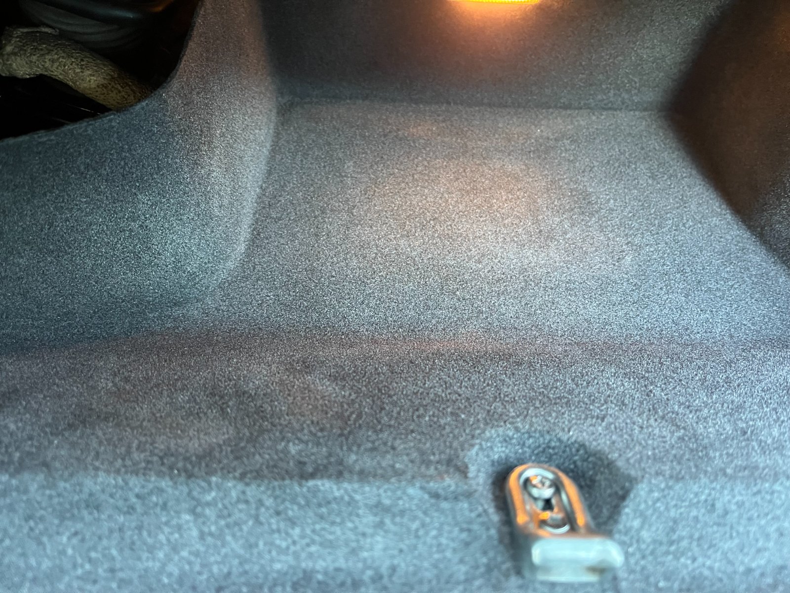

Final result

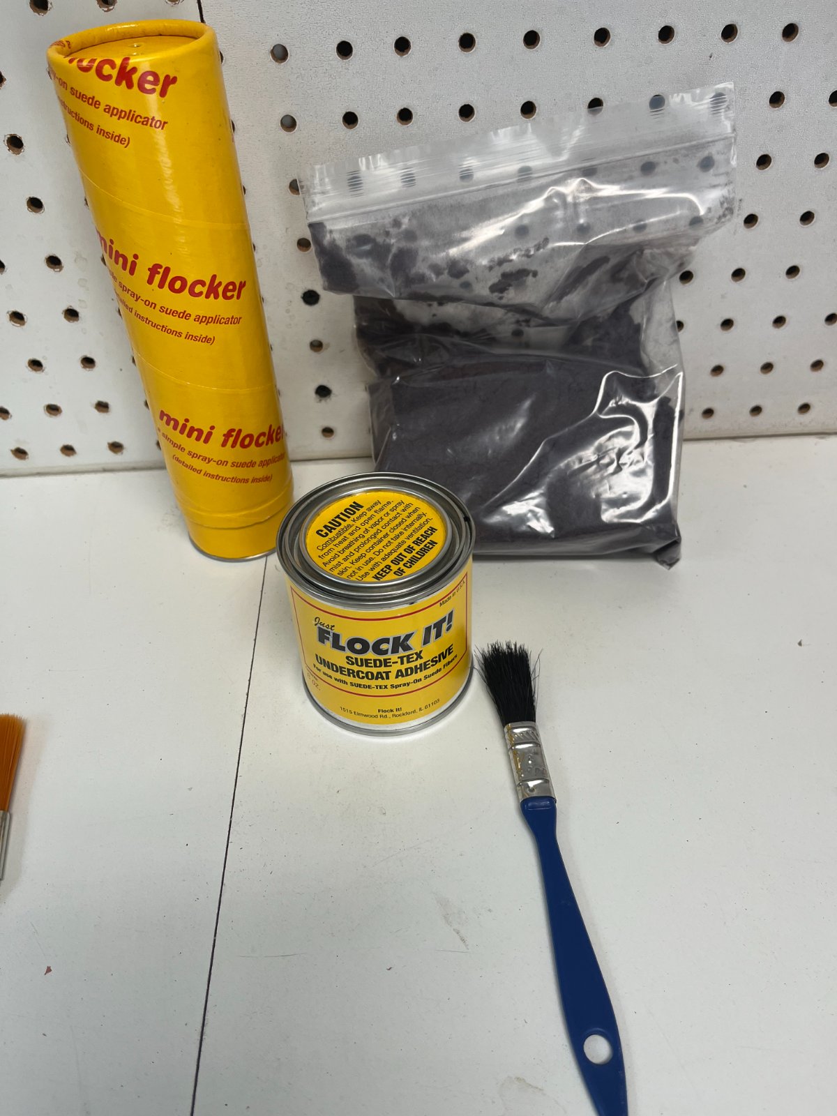

The original link to Donjer no longer works — I found out the company is now called Flock It. Based on that, I ordered their Suede-Tex Rayon Charcoal Grey kit with Black Glue, since a dark grey glue wasn’t available:
Flock It Suede-Tex Rayon Mini Flocker Kit

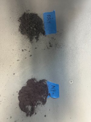

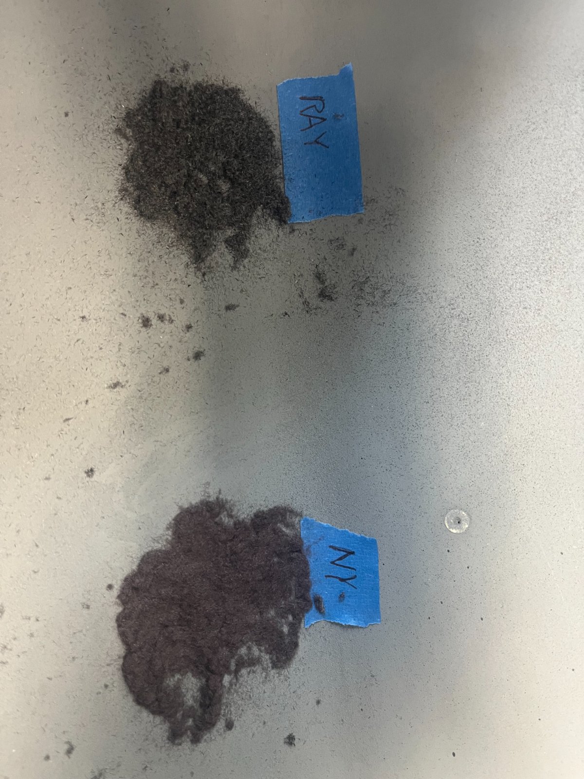

After receiving the kit, I was worried one bag might not be enough, so I ordered an extra bag of flocking fiber from Amazon (planning to return it if I didn’t need it). Once it arrived, I actually preferred the Amazon flock over the Flock It product. I’ve attached a comparison photo — the one labeled “NY” is from Flock It, and “RAY” is the Amazon version. At first, I even thought Flock It might have sent nylon instead of rayon.

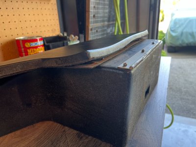

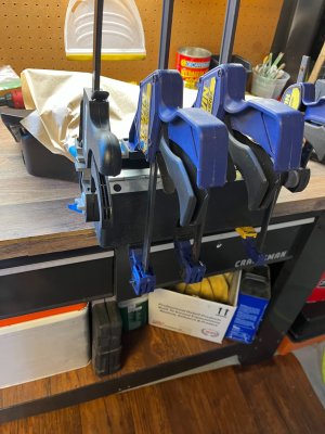

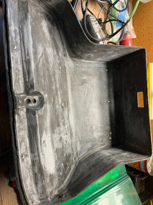

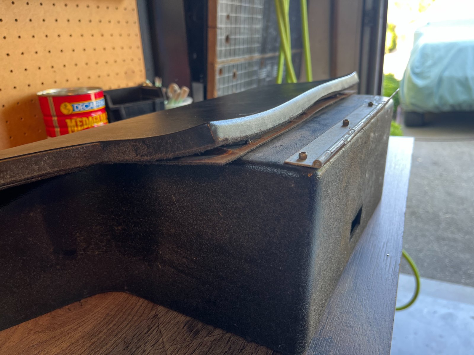

First, I repaired the warping box (see photos). Then I sanded it using a Dremel with an abrasive wheel — this one worked well:
Abrasive Wheel on Amazon
That said, I later discovered that spraying the surface with acetone made it much easier to peel off both the old flock and glue using a putty knife. After stripping it clean, I did a fine sanding, applied primer, and then used the flocking glue.
⚠️ Tip: Work quickly — the glue sets up very fast on the glove box. I applied the inside first, then did the outside the following day.
