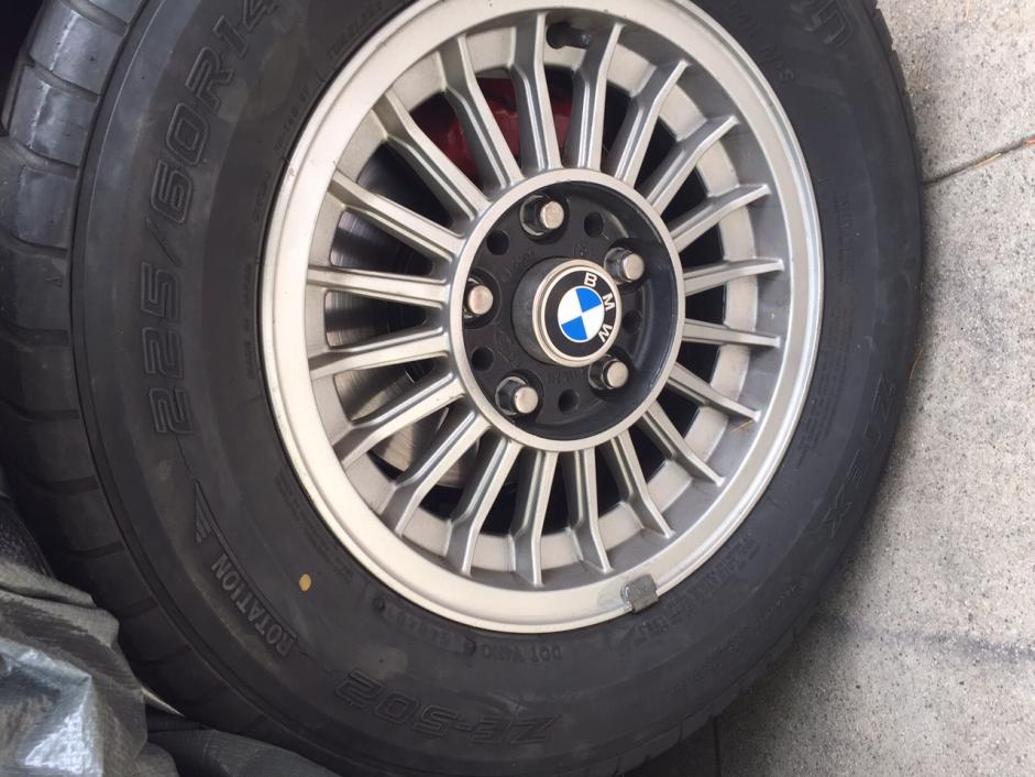

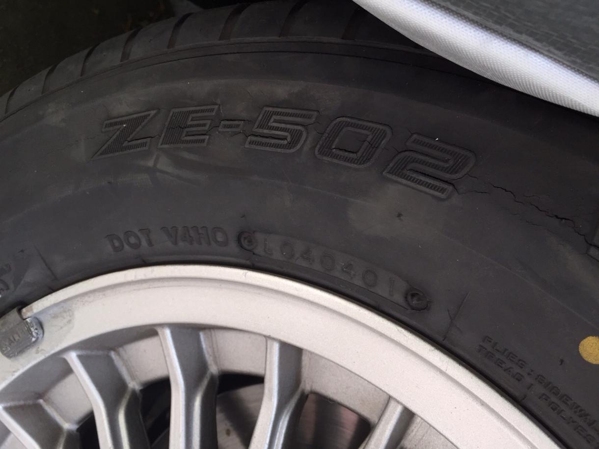

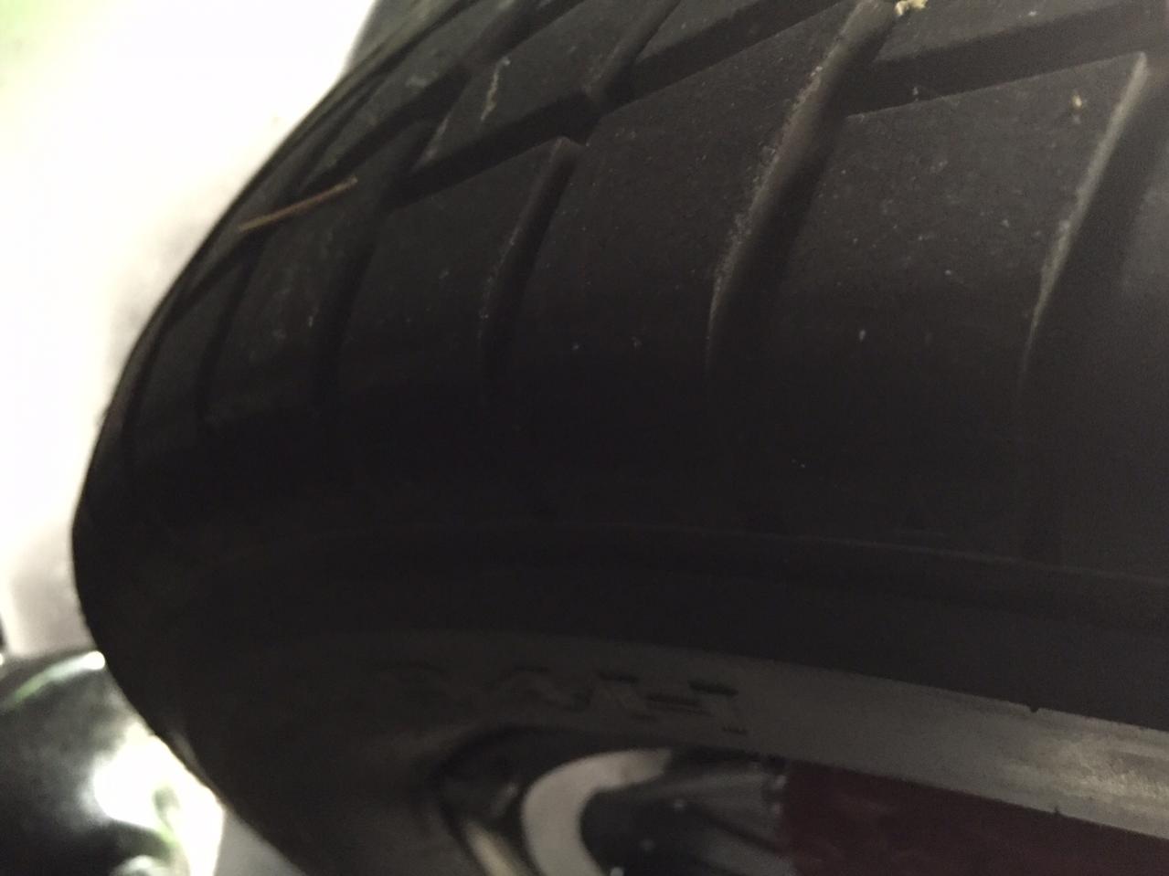

Stan, I will post my opinion regarding the new V Sprint tires but like I said in my previous post my current tires are actually a scary 14 years old (date coded L040401) that still have a lot tread left (8/32") on them.
The current ones are Falken ZE-502's in the 225/60/R14 size that are totally dried out and hard with visible cracking on the sidewalls. These old tires may have been a good tire back in its day and have provided a ton of meaty rubber on the pavement but they have me worrying about which day they will blowout.
So I am sure the new ones will be light years better in direct comparison. The delivery of the new ones is scheduled for next Friday.
If you look closely you can see the cracking lines in the rubber. Would anyone drive at speed on these?

Stan, my new set of 205/70-14 V Sprint tires arrived yesterday and today I got them mounted. I am happy to report that they not only have that period correct look to them but I like the overall ride as well.
After tweaking with the tire pressure (35lb front and 33lb back) I have to say the ride and handling are very very good compared to my previous 14 year old tires.
Now I won't be driving in fear when attending any of the NorCal road rallies!
