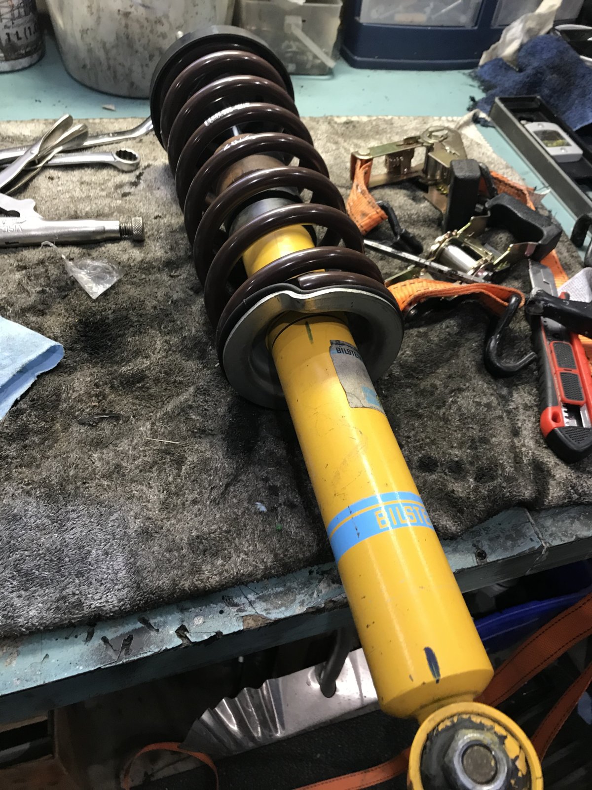

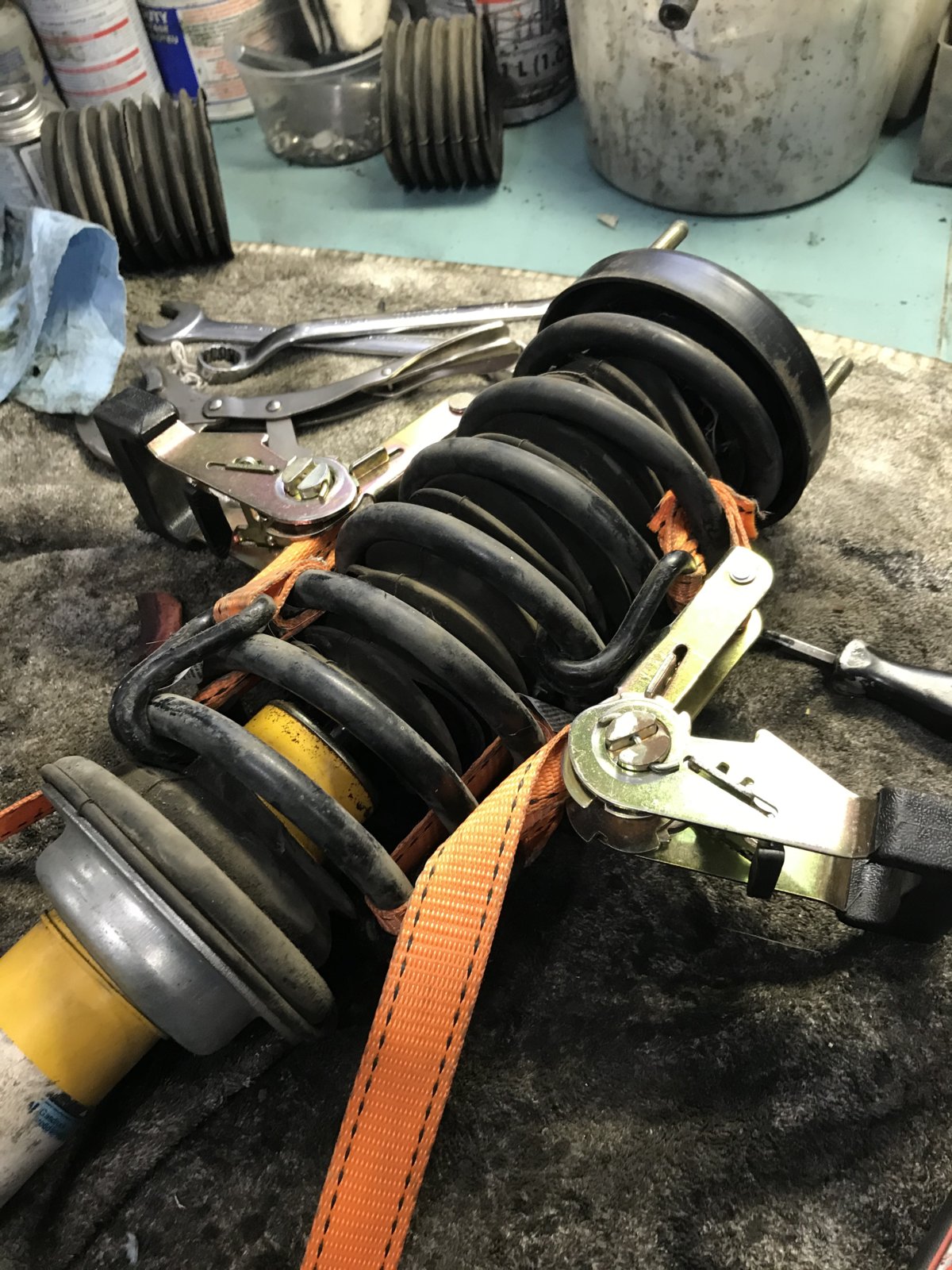

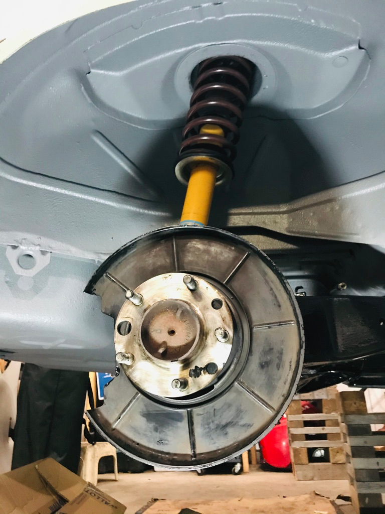

I have disassembled, cleaned and reassembled with the HR Sport springs. I used a ratchet strap to compress the factory spring. The HR Sports assembled without any substantial compression, maybe 1/2-3/4" of compression by the nut and lock nut at the top of the assembly. Glad to see the spring does not shift when the suspension is hanging. I learned the spring collar was installed upside down :rolleyes:. The reinstall was straight forward but those distant pesky 3rd lock nuts inside the trunk are a bother!
(I feel like I should've painted the inside of the backing plate...oh well...its clean and the rotor will cover it when when finished ;) )

Thanks for the method! Do you use the band clamp to compress the springs too?
Regards,
Bill
Sorry for the typo. I’d meant specifically for use w suspension springs. I use a set smaller set than yours, without built in end hooks as some of my springs don’t have space for those hooks.
You already got it
