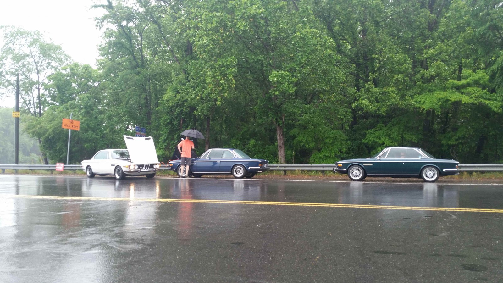

Wayne - Let's return, shall we, to the 2017 Vintage. I recall driving in the pouring rain when Tom signaled me that he needed to pull over. His drivers' side wiper blade had departed his vehicle at speed and he was left without a wiper in the pouring rain. We pulled over, switched the passenger side wiper to the drivers' side, and safety wired it on so he could make it home.
Now, if I remember the sequence correctly, during the stop to repair Tom's car, you had a hard time restarting your car. I remember giving you a jump, which for some reason got you going again.
You then had trouble restarting later at the pump when we stopped for gas.
After we got home, Tom determined the problem was electrical, and, I think he did a wiring repair in your trunk. Not sure if this was fuel pump related; memory is a little hazy here. Anyway, I toss this out there following up on Arde's comment.
Thanks, Chris, as I recall that was traced to a short in the wiring to the fuel pump relay. The wiring was mounted close to a seat rail and contact there to an exposed portion of the wiring was causing the failure to start.

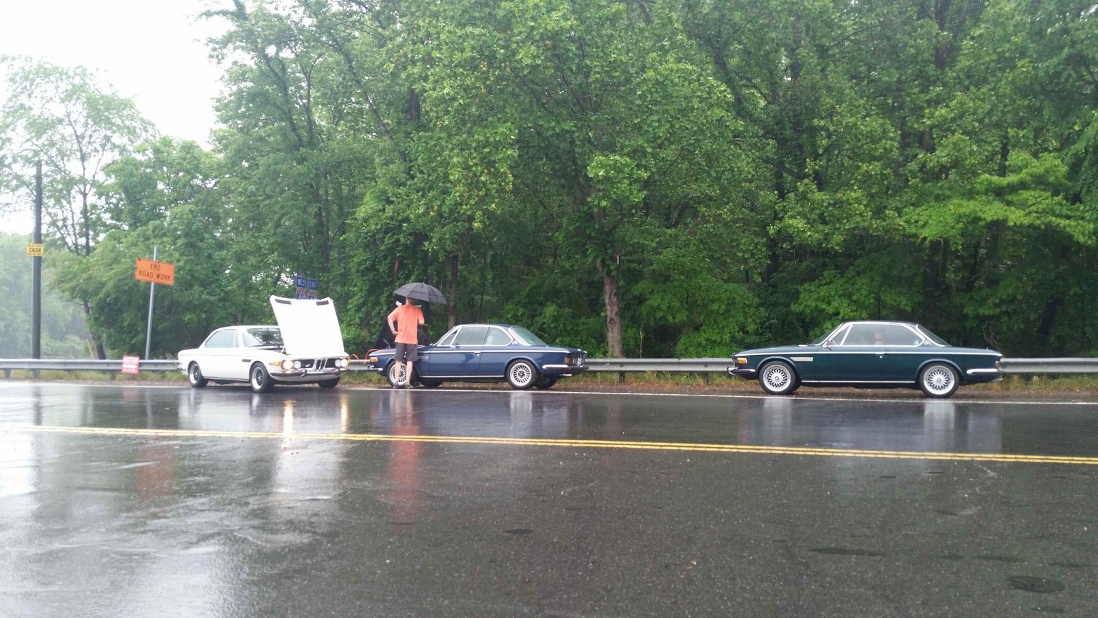

and to Chris Ohmes, I thought I replied to your post but I gess not - that problem then was caused by a wire to the fuel pump shorting out against a seat rail. Once Tom Baruch found that out and reinsulated the wire my problem went away.
