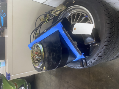

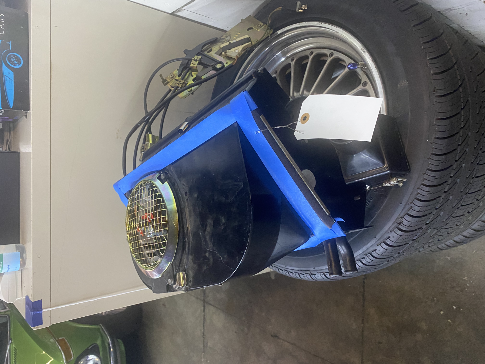

On my bucket list for quite some time was my lack of heat and AC. Chris then removed my old non-functional heater core, AC evaporator and expansion valves to replace with brand new rebuilt units Don had shipped out. (All other AC things had been replaced before except the evap and expansion valve.) It's amazing how quickly Chris removed everything and installed the new pieces. And along the way he connected the rear defroster (explains why it never worked after my last restoration), fixed some wiring under the dash to help my temp indicator from shorting out on occasion (bouncing needle when cold) and my hazard relay from firing the dash lamp. The heater will be operational by Spring when Chris comes back for Jahan's engine replacement at which point he'll install new heater hoses under dash which he didn't have on this trip (they were sealed off by mechanic last year after discovering coolant was leaking into my cabin). At that time, he will also install a new ignition switch to avoid future problems I'm hearing that other CS owners are experiencing now. Then we will fill up with R134 and have a fully functioning heating and AC system. Both systems should work really well as Chris tells me he also installed a higher performance expansion valve as well as a larger capacity blower fan too provide a lot more air throughput with the fan on.

p.s. just attached photo of rebuilt heater core and the attachments - isn't she pretty?
