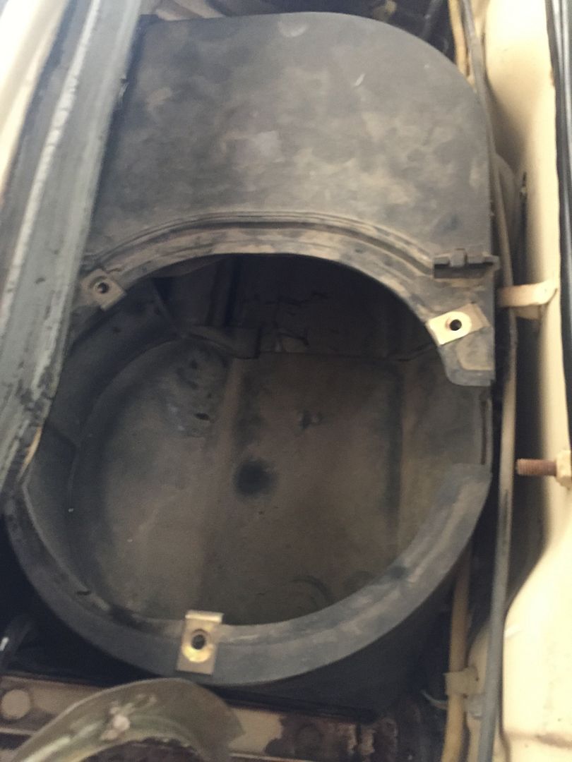

When I did my blower motor I cleaned the hell out of this. So nasty looking in there.
