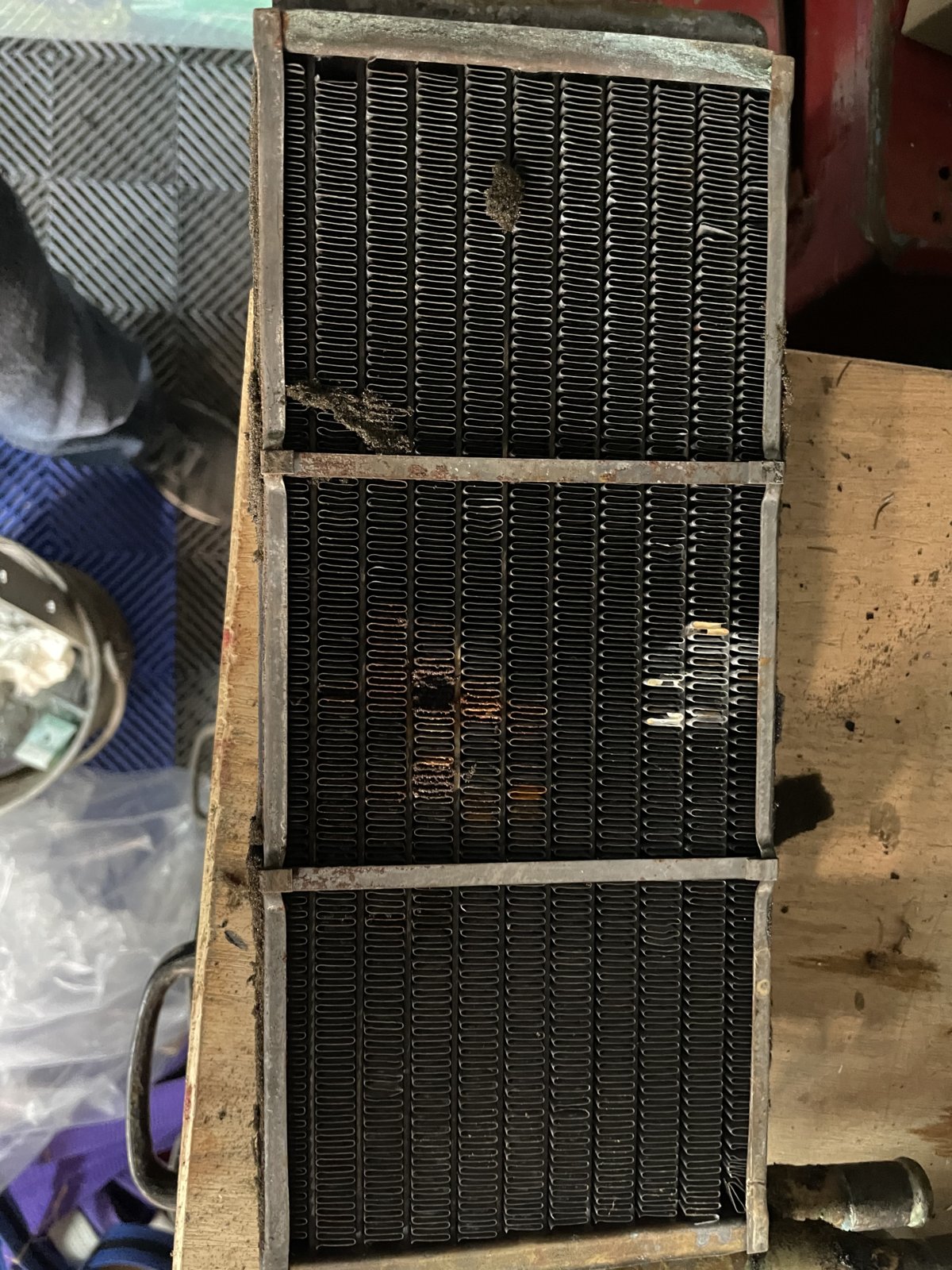

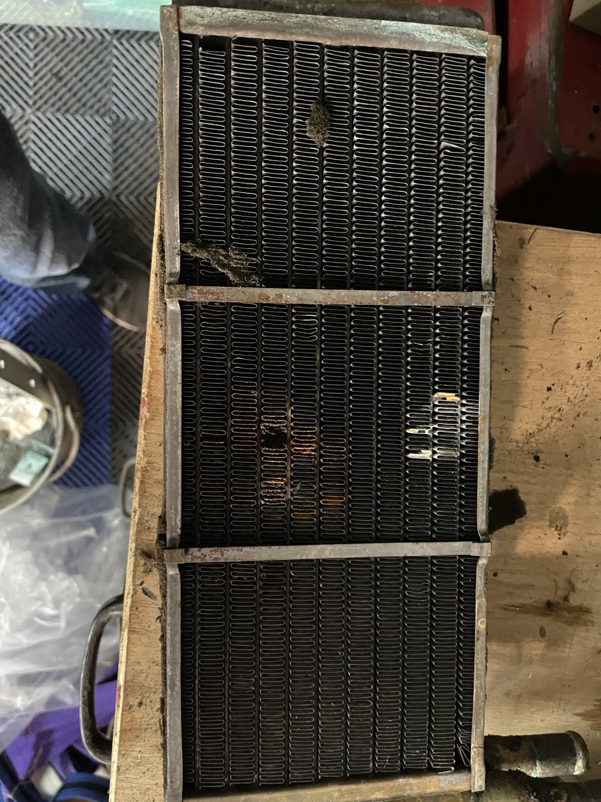

Also, this is what I found when I opened up my heater core box. I am glad that I did, and of course all the foam (looks to be about 3-4mm is perished, just turns to powder when touched.

Your core seems to have a bit of corrosion. Are you going to get it flushed and tested!?
