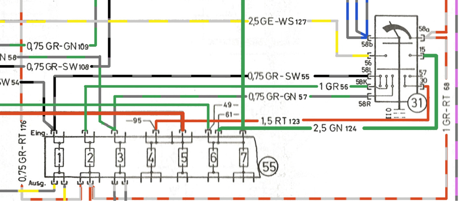

I have a 72 diagram and it is exactly as you describe now that I can decipher it and understand it is fed from the unprotected side of the fuse box. With that in mind, shouldn't I then fuse the red wire between fuse box #4 and the light switch in order to protect both the light and dip switches if one of them shorts? The load of the headlights will have been relocated to the new relay by the battery so the only load is from the relays or am i still missing something here. Why they didn't protect the low beam circuit is beyond me. Thanks.

would it not be easier to just change the red wire that sits in the fuse 4 entry port and goes to pin 30 on the switch - and plug it from the entry to the exit of fuse #4, so that it is now a fused connection, but uses the original fuse box (instead of introducing an additional fuse outside the box).
Probably, I was likely avoiding having to deal with working up under the dash at the fuse box and leaving that as is.

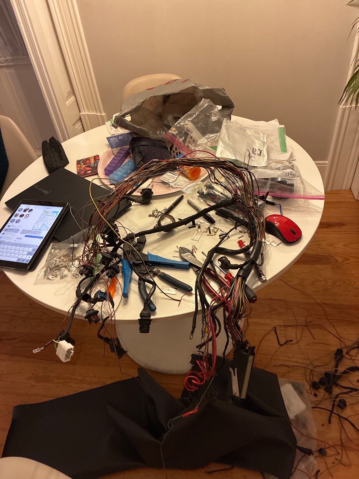

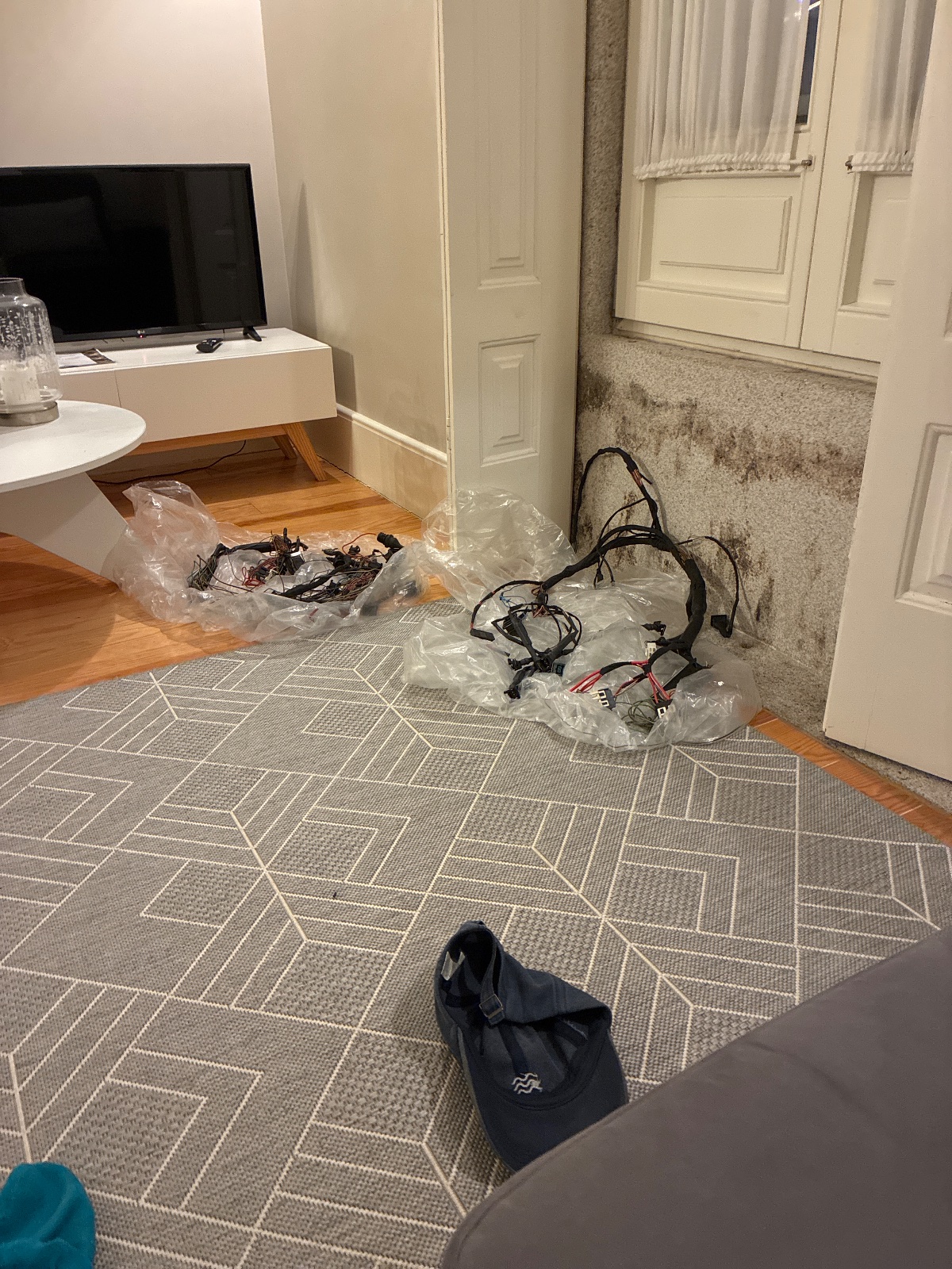

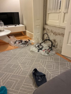

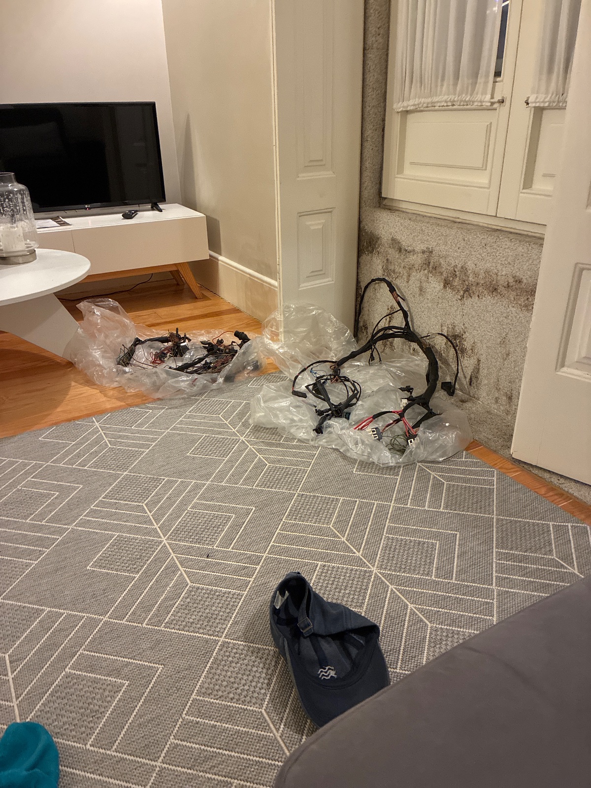

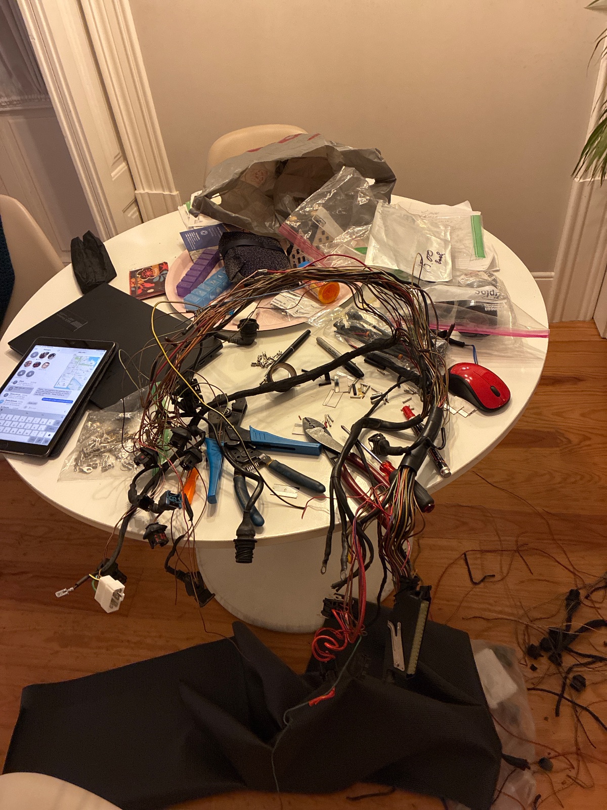

Meanwhile- I’m in Porto making wiring harnesses on rainy days…

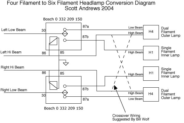

i am guessing Don is talking about the euro lights - the h1 low beam, the h1 high beam and the city lights .... or the 4 - h1 headlights and the fog / driving lights ... but Chris is correct, both filaments in the h4 bulbs never come on at the same time
Yes, that's how it is supposed to work.
Low beams: Outer H4 low beam filaments on
High beams Inner H1 low beam filaments on, and outer H4 high beam filaments on.
Some guys rewire these so all six filaments are on that the same time. Recipe for short bulb life...
Here is the circuit I used for this on my euro 635, which came with 4-filament wiring.
