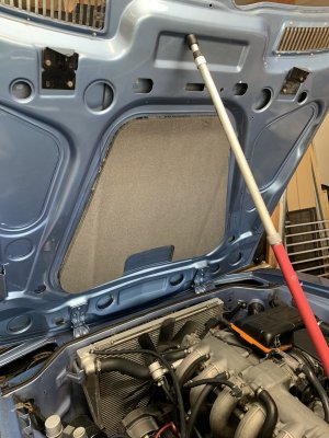

Here is my classic9 installation and some other ideas....

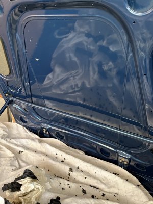

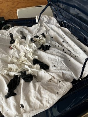

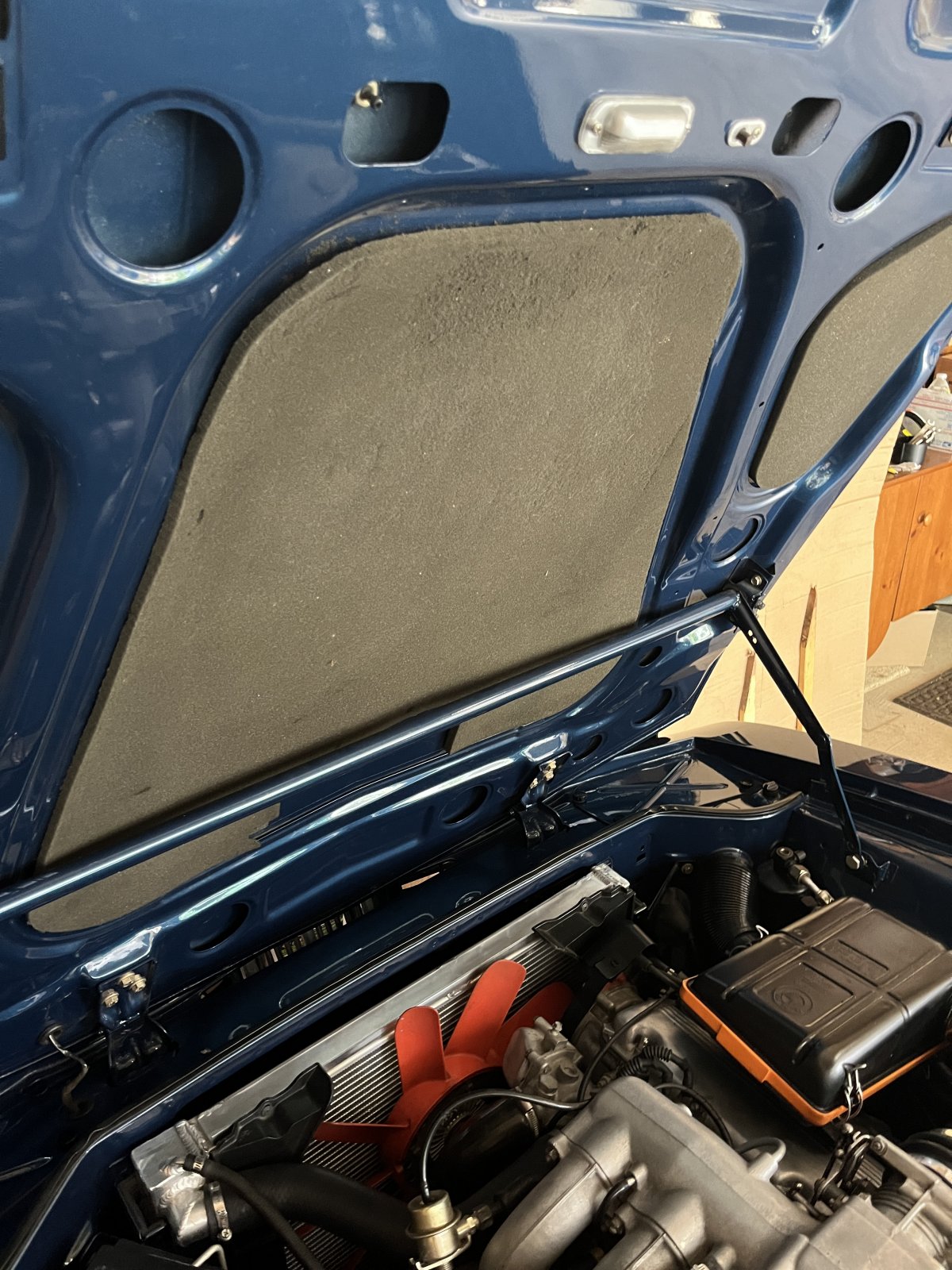

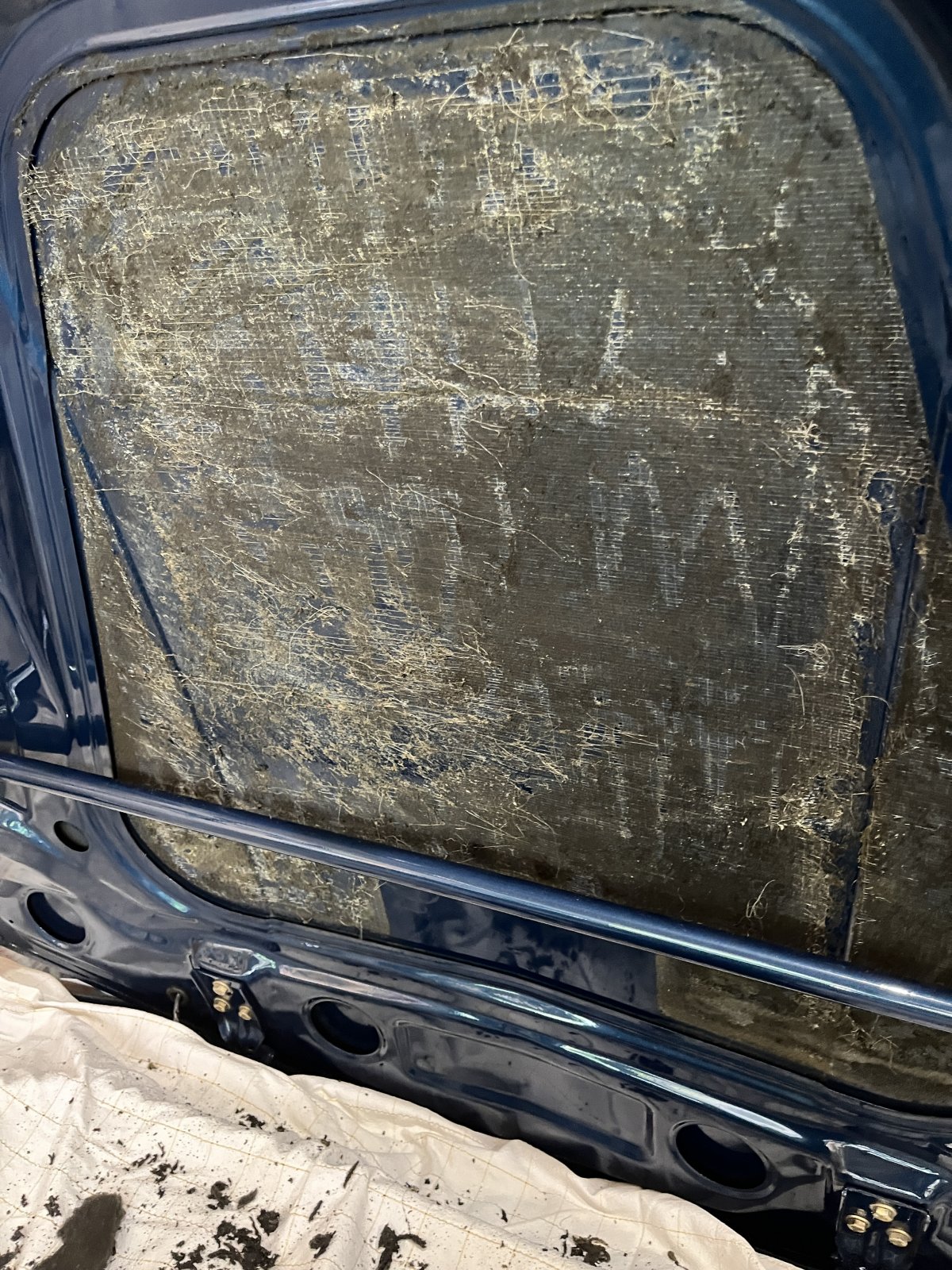

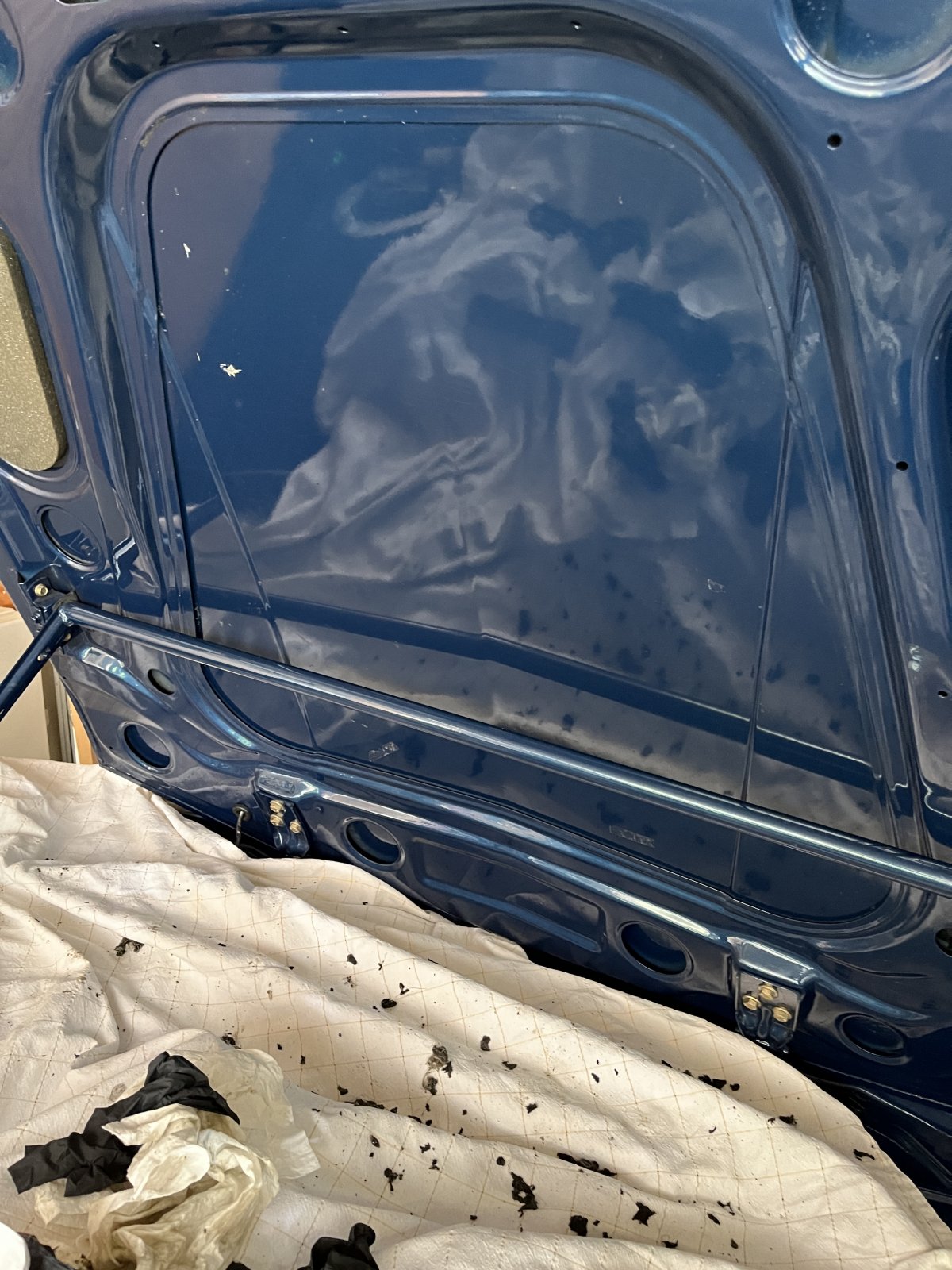

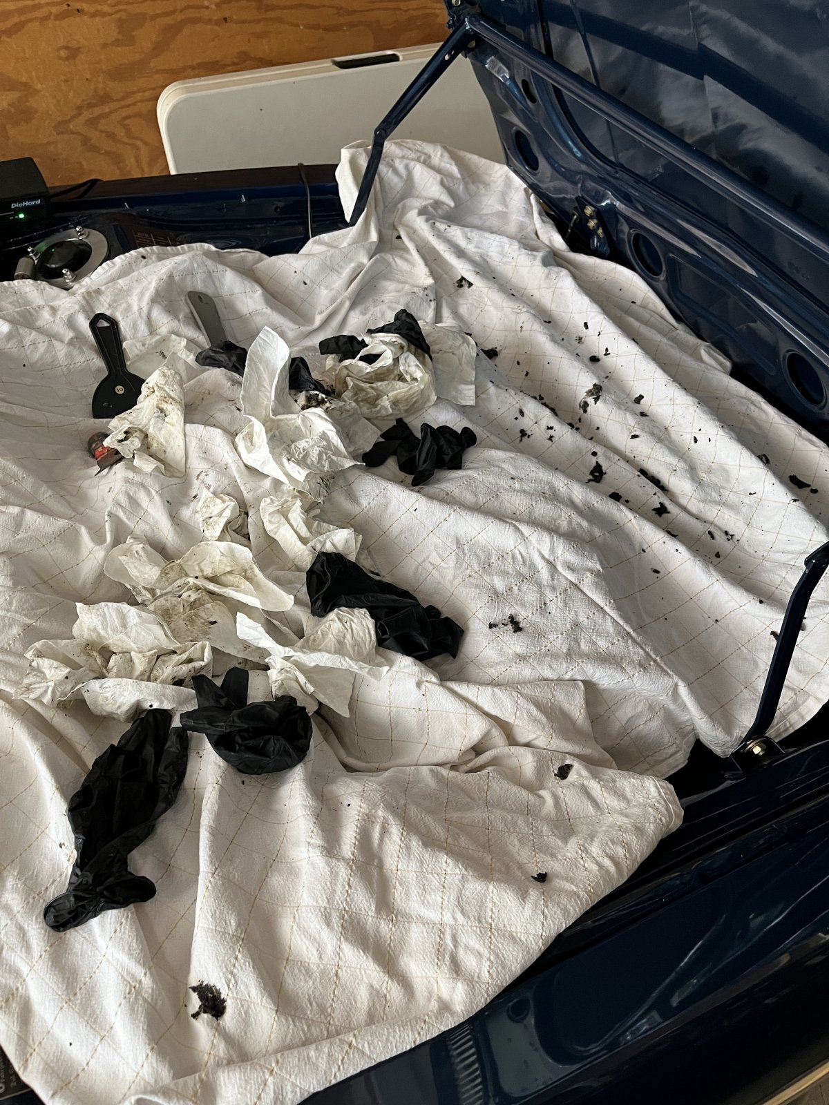

Well, clearly the most unpleasant and tedious task ever undertaken by my hands on this Coupe. There were at least two different layers of adhesive and stringy type stuff underneath. I almost like it better this way but there are scratches underneath the hood from previous times (I only used plastic scraping tools). Now to open my new pads and I'm certain the center big pad will be a different color than my existing side pads which means another unpleasant weekend! I hope Bluebelle appreciates this! By the way, the 3M Adhesive Remover is impressive stuff!

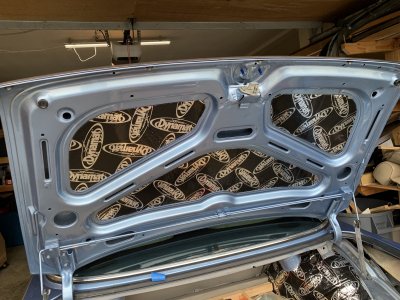

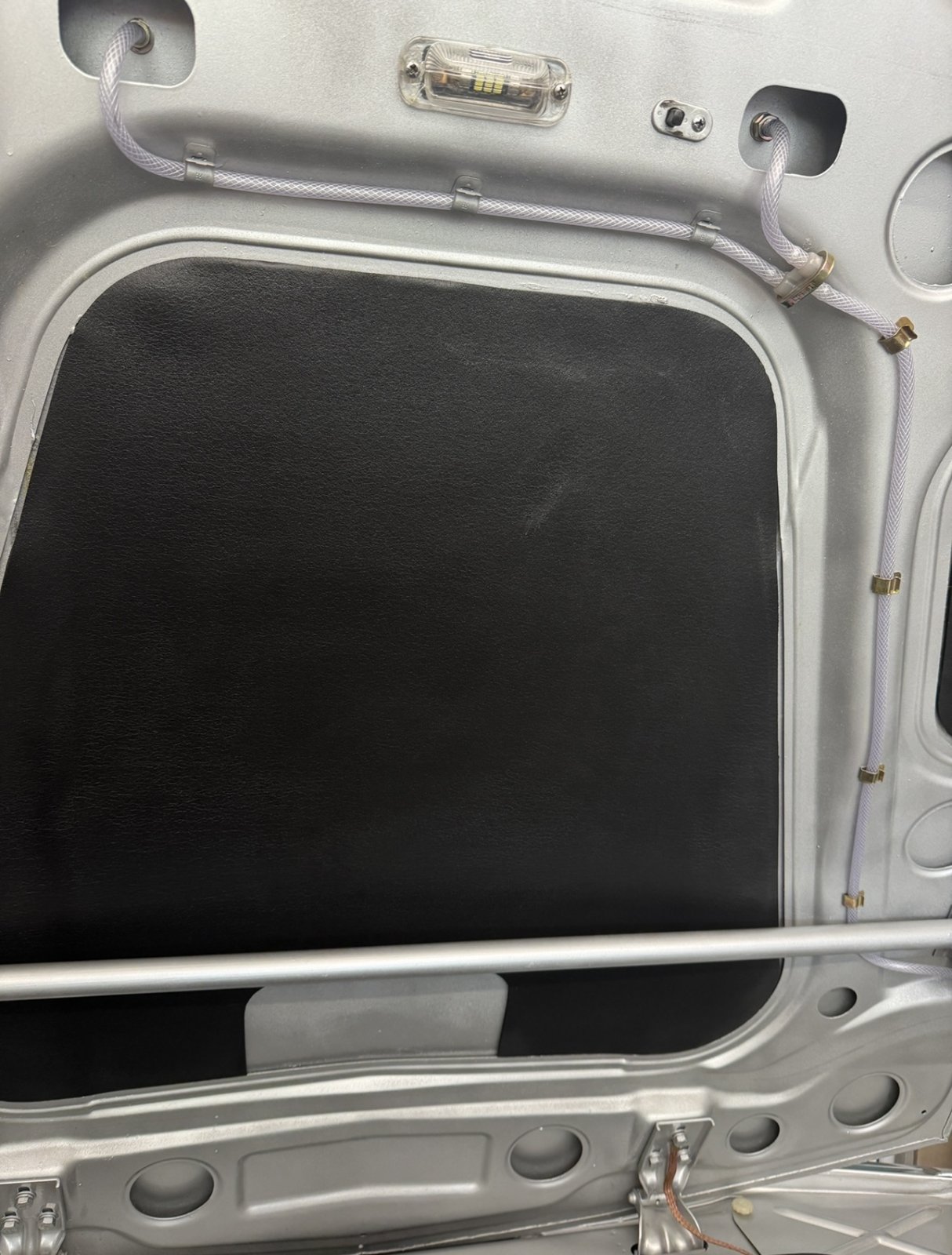

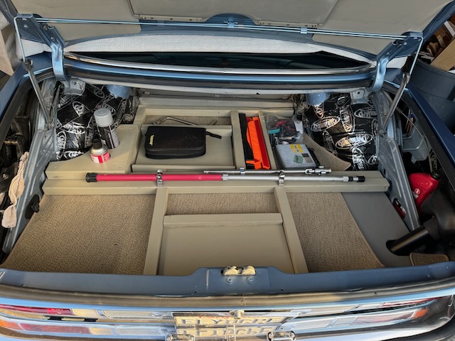

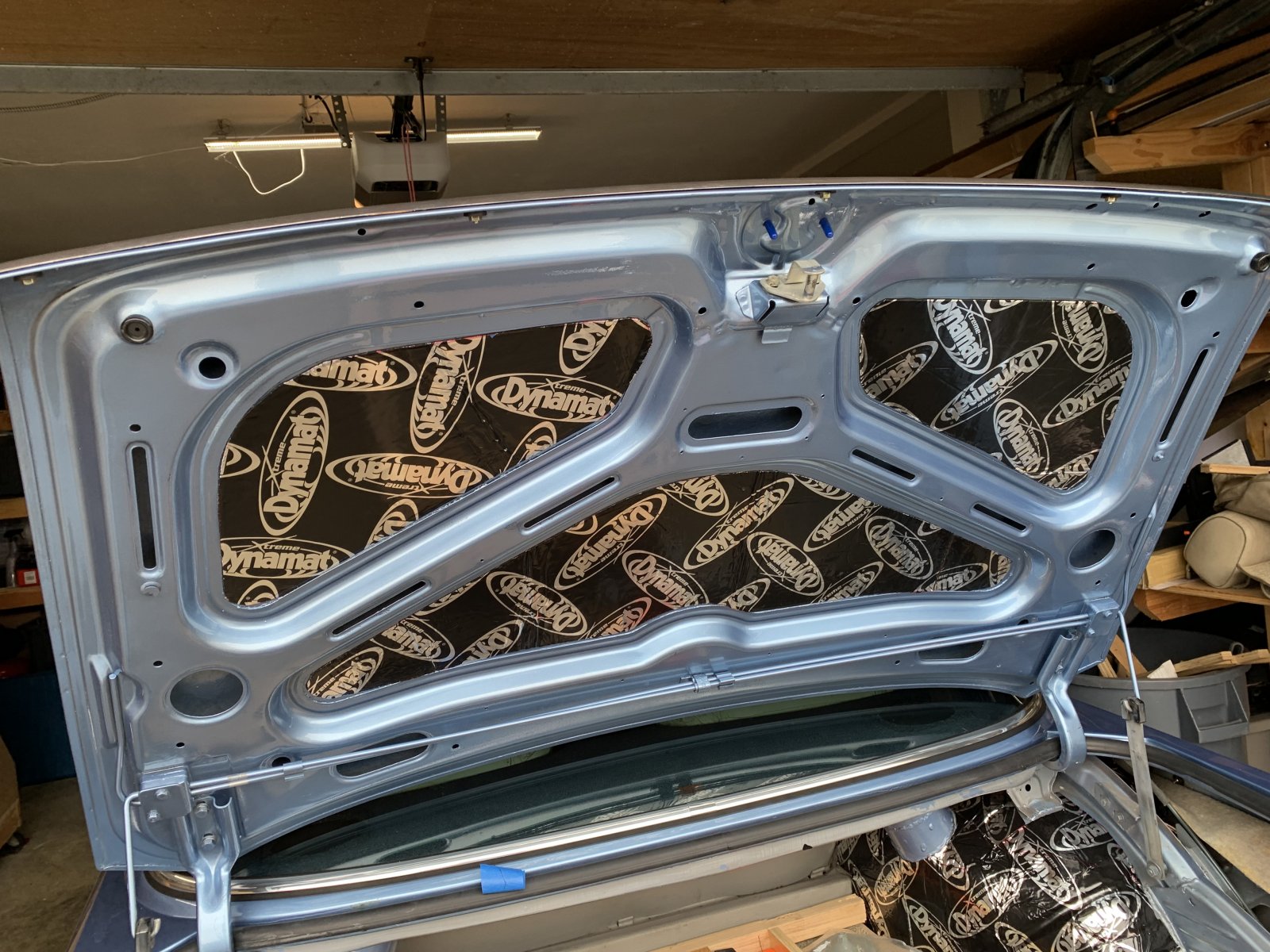

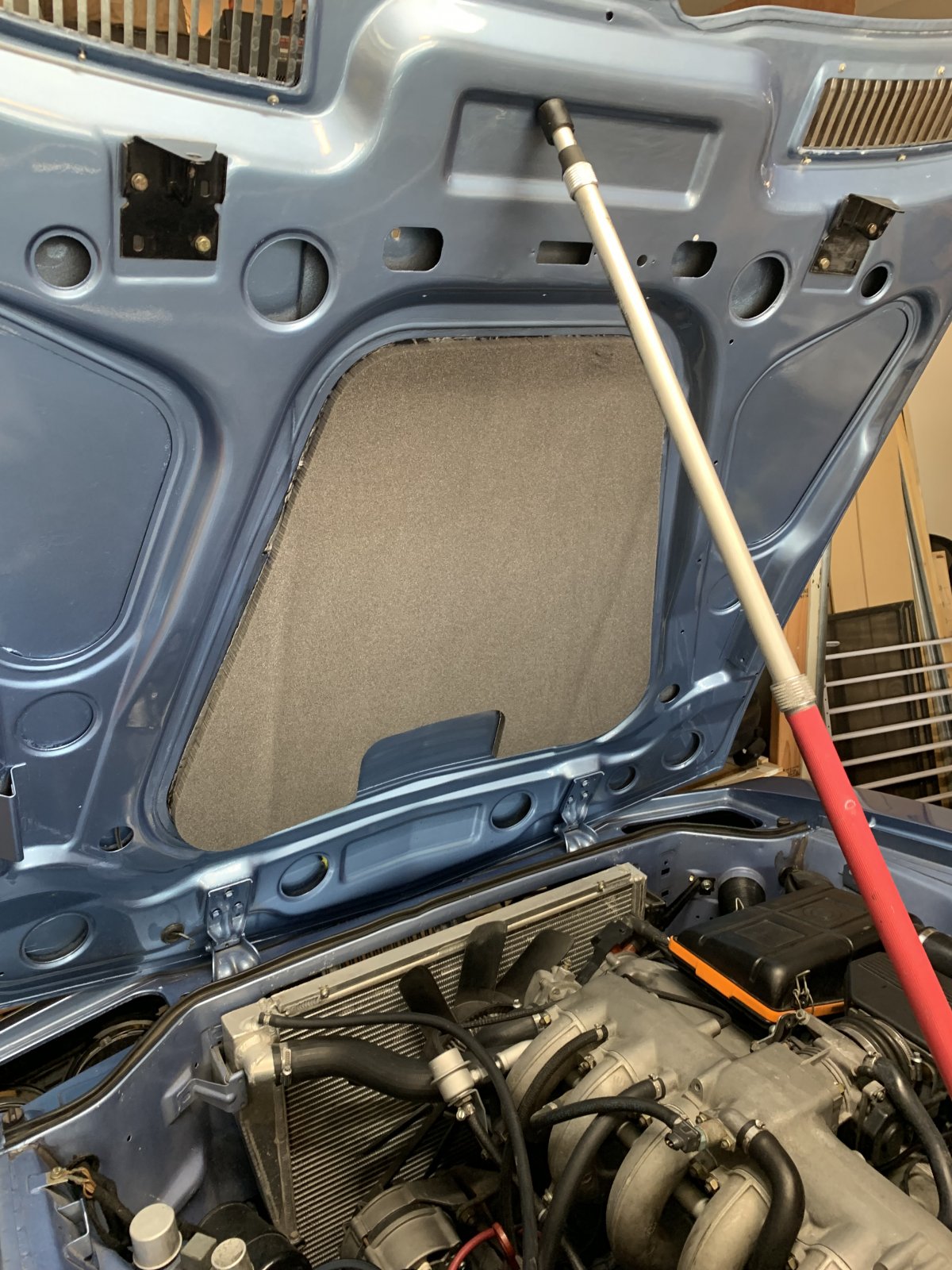

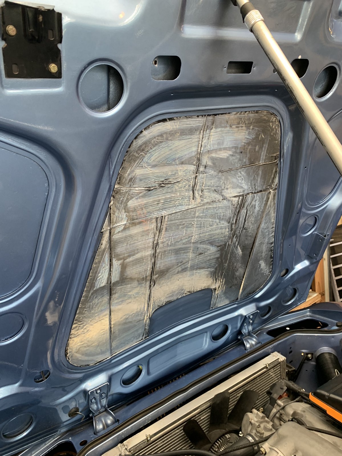

If you are interested in reducing the noise from the engine bay, you can apply a layer of Dynamat first before putting the new foam pad. Makes a big difference on such a large nearly flat expanse of sheet metal. Just wipe the graphics off with acetone before applying the foam pad. Ends up looking completely stock but with much better sound insulation
(First pic is the trunk bc I couldn't find a pic of the hood Dynamat before wiping off the graphics )

out of curiosity how well do the torsion bars hold the hood / trunk up with the weight of the Dynamat? especially if there is some wind around ... or is that why you have a prop rod instead of hood torsion bars
Bmachine
3,558
1,803
Northern California coast
I was a bit concerned about that. But they hold up just fine. When the hood is up it is almost vertical so the added weight doesn't make much difference. I haven't tested them in gale force wind yet.
At the time of these photos I had not reinstalled the hood hinge mechanism yet. I have done that since and it works just fine.
You can feel it a lot more on the trunk lid torsion bars however. The hinges still hold up fine but you can tell they have to work harder. I'm sure they would need some help in windy conditions
