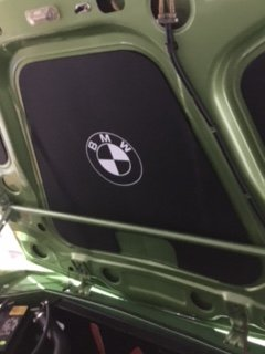

i bought the Classic 9 piece. i had trouble with older BMW products disintegrating over time, so i wanted to try something that looked quite similar. looks pretty close to original, as long as you do NOT get the BMW logo on it.
Classic 9 for the E3 and E9. You can make more or less out of installation. Looks new after 12 years in the Bav. I actually like the BMW logo, white, unassuming. I think they are about 100 bucks.
I have the Classic 9 and it will outlast the original style which gets oily and dirty over time then falls apart. This one you can wipe down.

Thanks for everyone's thoughts. As others pointed out, there's no photo on the Classic 9 site. I found one on from a previous post on the forum, but it has the BMW logo on it - which I would not want. @rsporsche, do you have a photo of your Classic 9 hood liner? And do you mind if I ask how long you've had it and if it has held up well?

The Classic 9 does not come with the logo, you have to ask for it and apply it after you install the liner so the logo is not an issue.

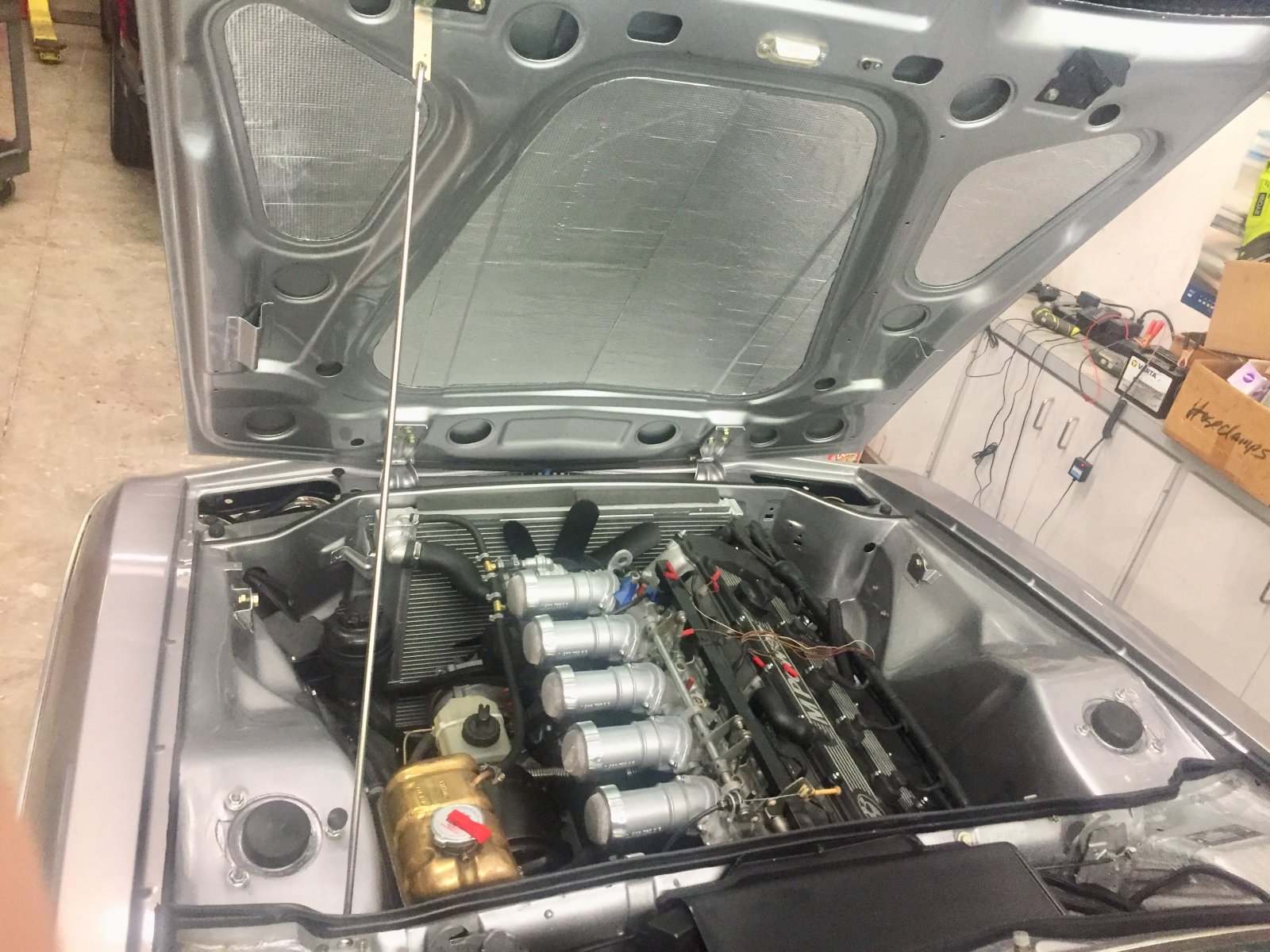

Another option to consider is heat resistant sound deadening material, like a Dynamat. Obviously, you would be straying pretty far from the factory look, but you would get better heat and sound insulation, and oil wipes right off.
I would think you want something in between, ie not to retain all the heat in the engine bay to make its way to the firewall etc. Some heat transfer through the hood is probably needed. Perhaps that is why the insulation is in 3 parts and not complete.
I have a hard time imagining that the stock foam will do much for sound. It may break some of the high frequency bouncing but those are not generally an issue under the hood, apart from maybe squeaky belts. I've been planning on doing this Dynamat idea and then putting the WN foam on top of it. This way you get the stock look with an appreciable reduction in low frequency resonance from the large flat areas of the hood. But this will obviously add some weight so you need to be mindful of that when thinking about hood props or whatever you use to keep it open.
