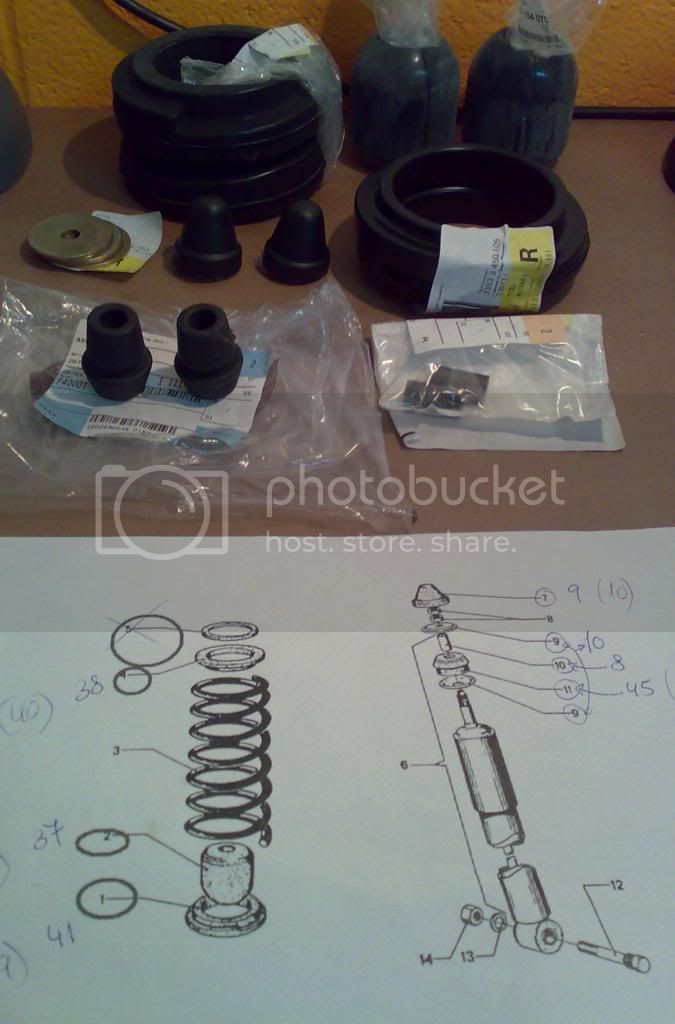

these were bought long time ago at bmw, shape seems different, they fit tight
Dequincey wrote a comment on these tapered rubbers. I recall that he was convinced the drawings in the bluebooks have them drawn upside down.

my assumption was wrong, blue books are ok, my pictures are wrong, I had to change position again,
so top goes the larger wider side

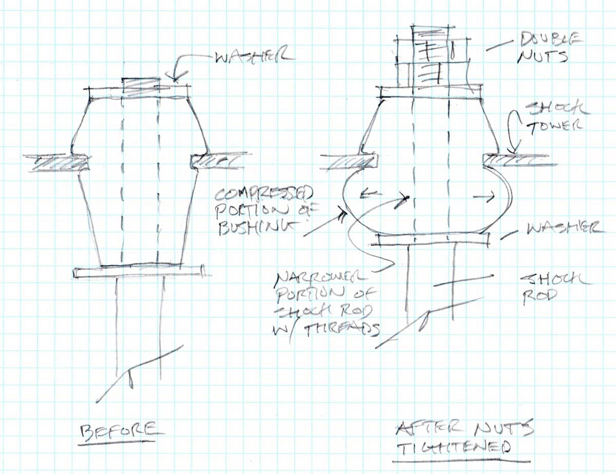

adding to this I will be using a drawing from a forum member,
I do not remember who was the author, but it explains perfectly
again no mid washer, leave things like they are,

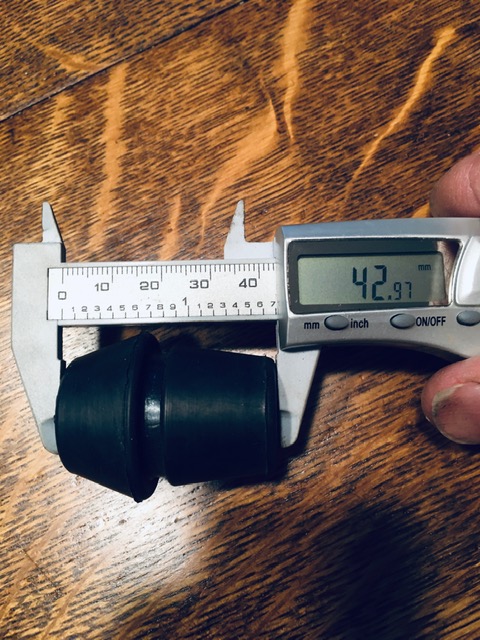

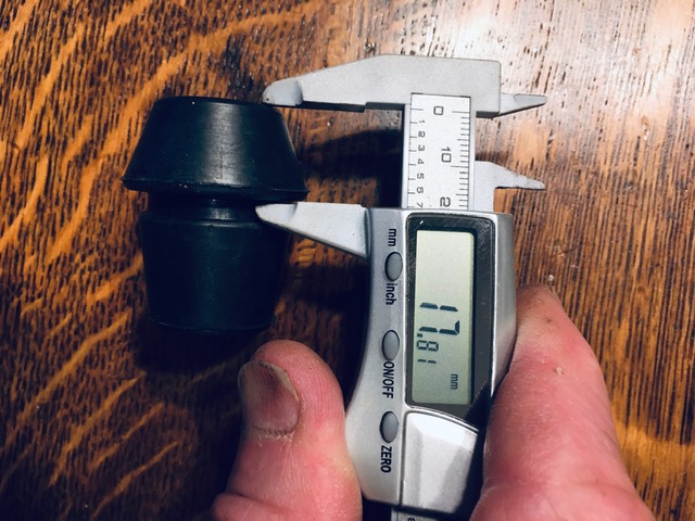

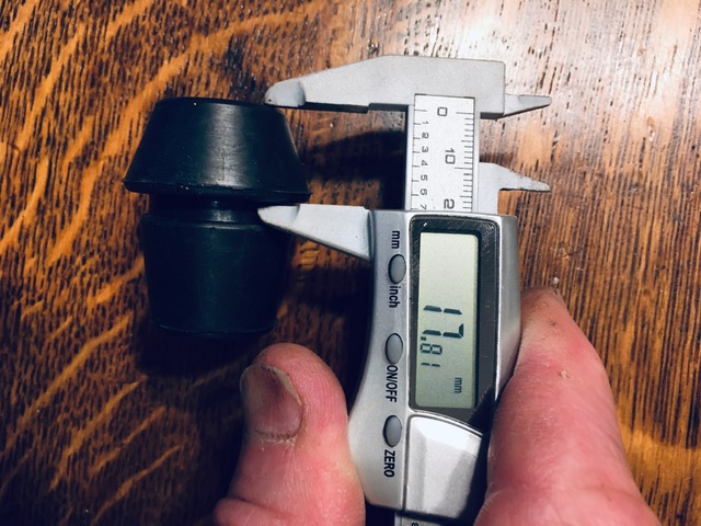

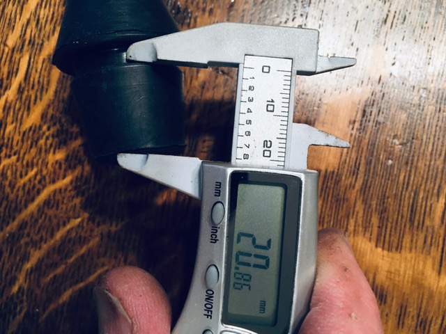

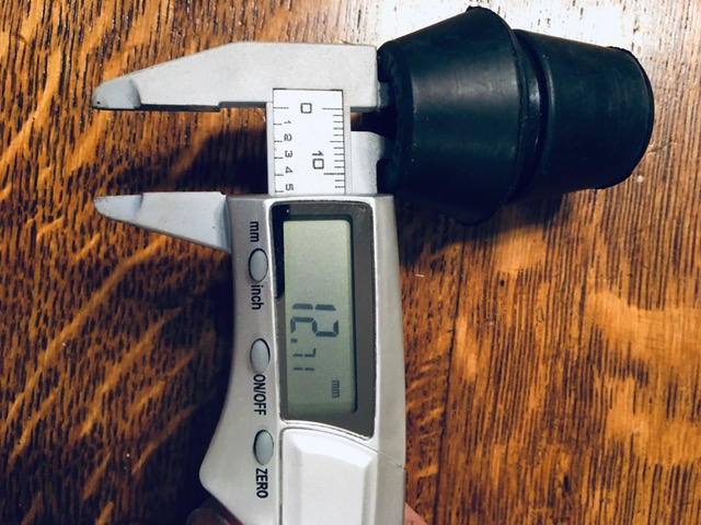

Well as promised, I purchased Bilstein bushings for the rear shocks from Summit Racing. I was told by Bilstein that the bushings from another shock which were available for individual purchase, were identical to the ones we use in the E9. I have enclosed images with measurements since I do not have an OEM bushing to directly compare to and I will bet, somebody here does. These were $1.99 each>>>>>>>>>>>>>
NB: I Used the HB Chris background for effect.....................Quarter sawed Oak. I thought Mahogany but naaa, why ruin a good thing.
The number is stated earlier in this post. I would wait for confirmation that they are the correct size (although Bilstein sent me these free 5 years ago and I used them without issue).

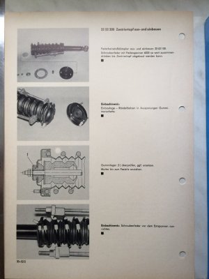

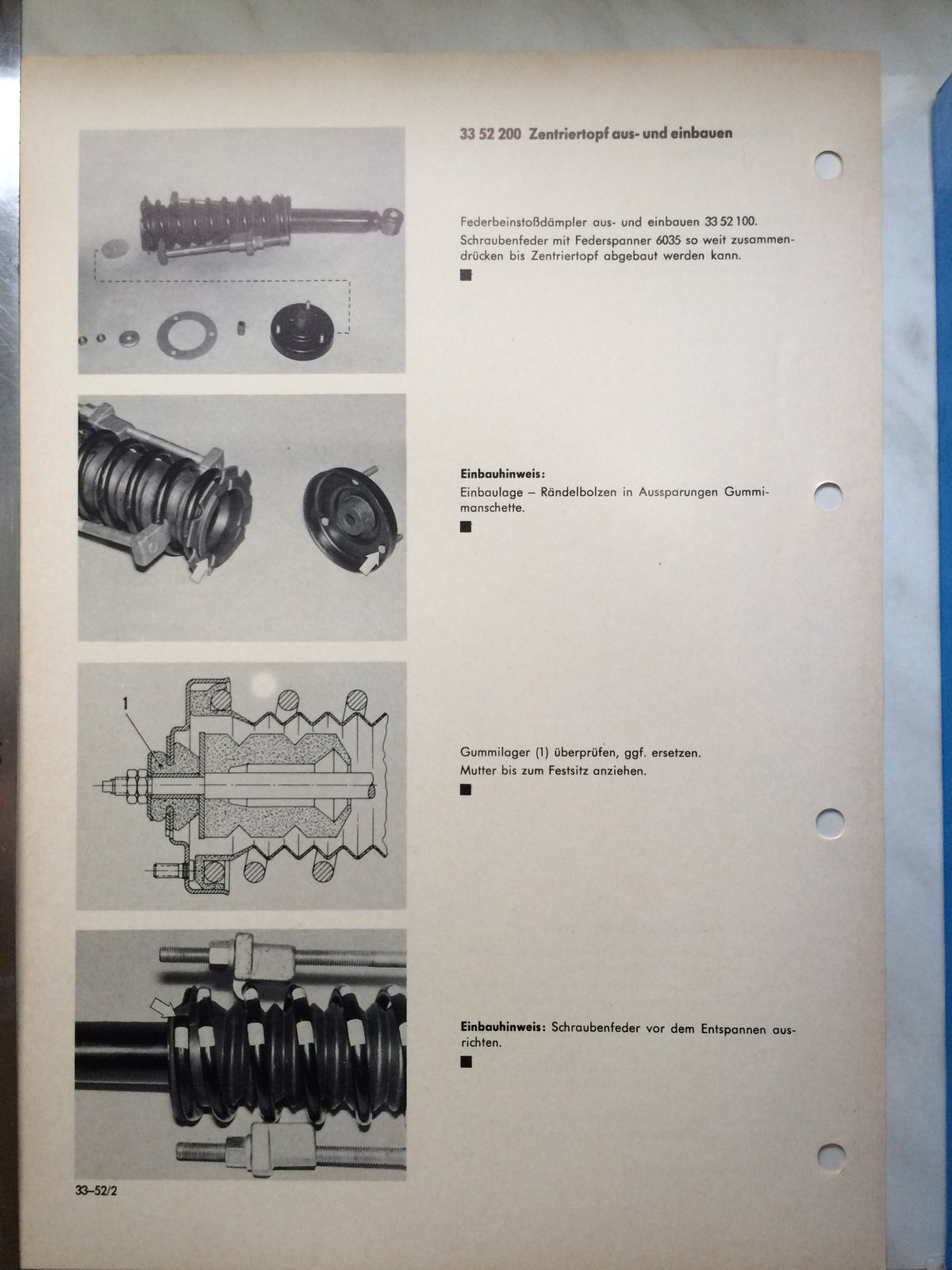

Hi all. I re-read the entire thread and I see that there is a confusion about how to install that rubber-metal hinge and which direction. I hope my photos from the blue book of BMW E12 520 and 1973 will be useful to someone.
