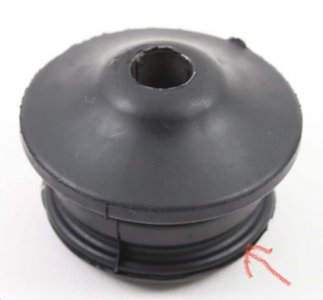

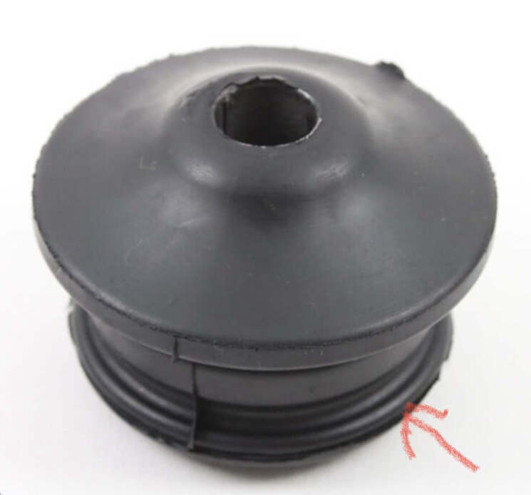

I am wondering if anyone has come up with an easy method of fitting theses bushes.
I tried today with a few large washers and some threaded bar
The plan was to tighten the nuts on the threaded bar so that the bush would be forced into the subframe
My problem is that it just kept on mushrooming and I couldn’t get the first lip to go into the subframe.

If these are the Walloth and Nesch bushings you're using, just throw them away they're junk.
1/2" threaded rod, some washers (grease the rod, and the washers) and use pieces from this kit:
This is a current coupon as of this post so use it as it is good deal. I have the older US General set that is anodized in various colors. I believe this set is i...dentical to others sold on the Amazons.
One of them fits pretty well on the inside of the subframe. Larger one goes over the front of the bushing. It will likely not go straight in, lots of grease and it will just pop in. The W&N bushings I think are the old Uro ones which are complete crap. Factory bushing set popped right in. Removal can be done easily using the tension strut from the front. Work it around and it will pop out.
The ones I have are from W&N
So I might have to take another look at it .

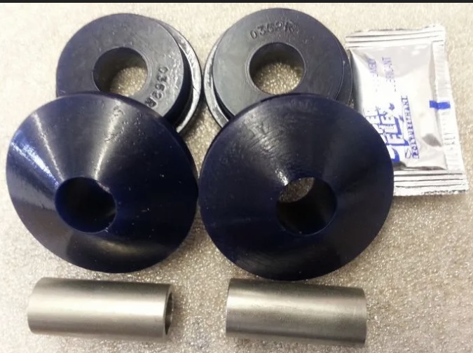

I saw some nice split ones online this morning made from polyurethane.
But I am not sure if I want to go there.
I’ll try a bit more lube maybe and see how that goes.
Okay
So I just purchased a set of the split polyurethane ones from Jaymic
I won’t spend any more time wrestling with the W&N ones.
Hopefully the Jaymic ones should be a dream in comparison.

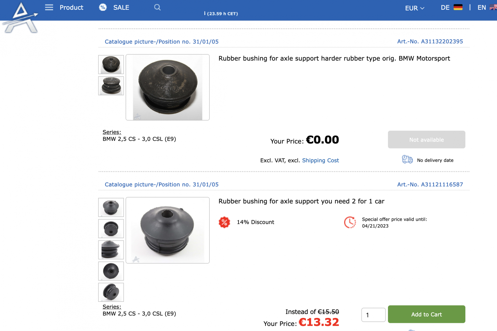

I purchased from W&N, but have not tried to install yet, is there a good, non W&N source? Common online sources (Pelican, AutohausAZ, FCP) dont seem to offer and Ireland is out of stock for their solution.
This job is a PIA and I trashed the ones from W&N and used those from the dealer. That said, had I known there was a set from Powerflex, I would have gone that route. I used Powerflex for my subframe bushings in my E24 and very happy with them. Some copper grease and no squeak, easy to install and remove if ever. Noticed no additional harshness.
Believe I used washers and a threaded bar but added a 35mm socket on top of the washer
W&N sells 2 types - a hard version and another. Are they both a no go? I'm trying to fill my shopping cart with stuff to lower the shipping cost and these are something I can use eventually.
The BMW Motorsport one is the E12 M535i bushing. They’re now NLA. You can’t add to the cart. The other is not genuine BMW, but an aftermarket part. I know Uro made these as well but haven’t seen their bushing to compare to the junk I got from Walloth. They’re super hard, have almost no give while the genuine bushing is quite flexible at least on the surface. I’ve installed both types of factory bushings in both my E12 M535i, my old 530i and now the coupe without issue. The W&N attempts were unsuccessful.
Ok, scratch those from the cart! Thanks.
It was the “standard “ W&N ones I had trouble with.

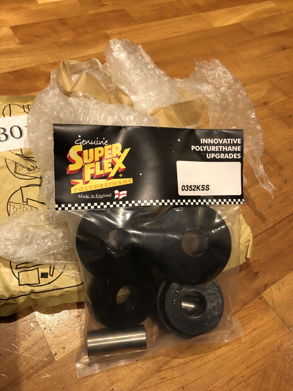

I failed to fit them , no matter how hard I tried.
I eventually ordered these - 2 part ones from Jaymic instead.
