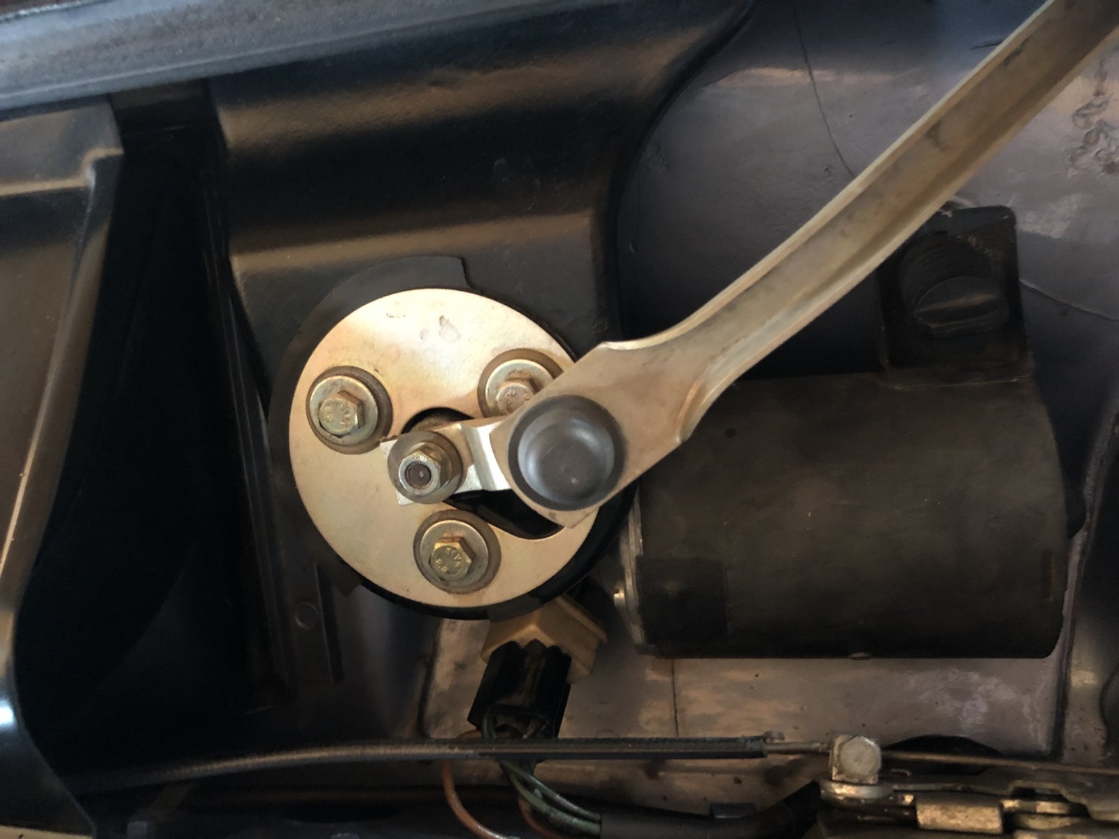

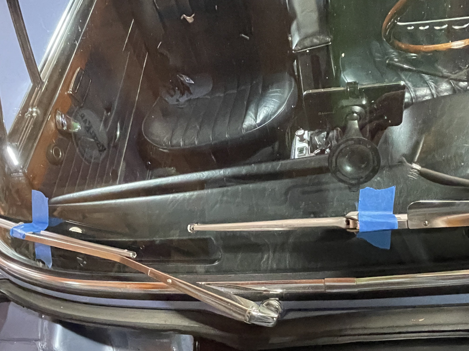

Before removing the E9 wiper motor. Tape the windshield wipers & arms to the windshield, this will ensure the linkage is in the correct place when reinstalling the E24 wiper motor.
Remove the wiper motor by removing the linkage nut first, may need to pry the arm off of the splined shaft with a flat screwdriver. Then remove the 3 10mm bolts. With a little wiggling the motor should be fairly easy to remove & unplug.

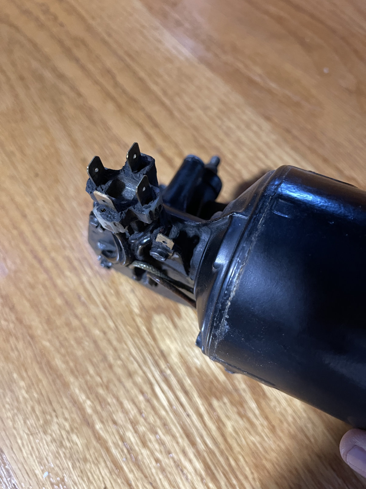

The E9 wiper motor has a separate ground wire spade on the body of the motor.

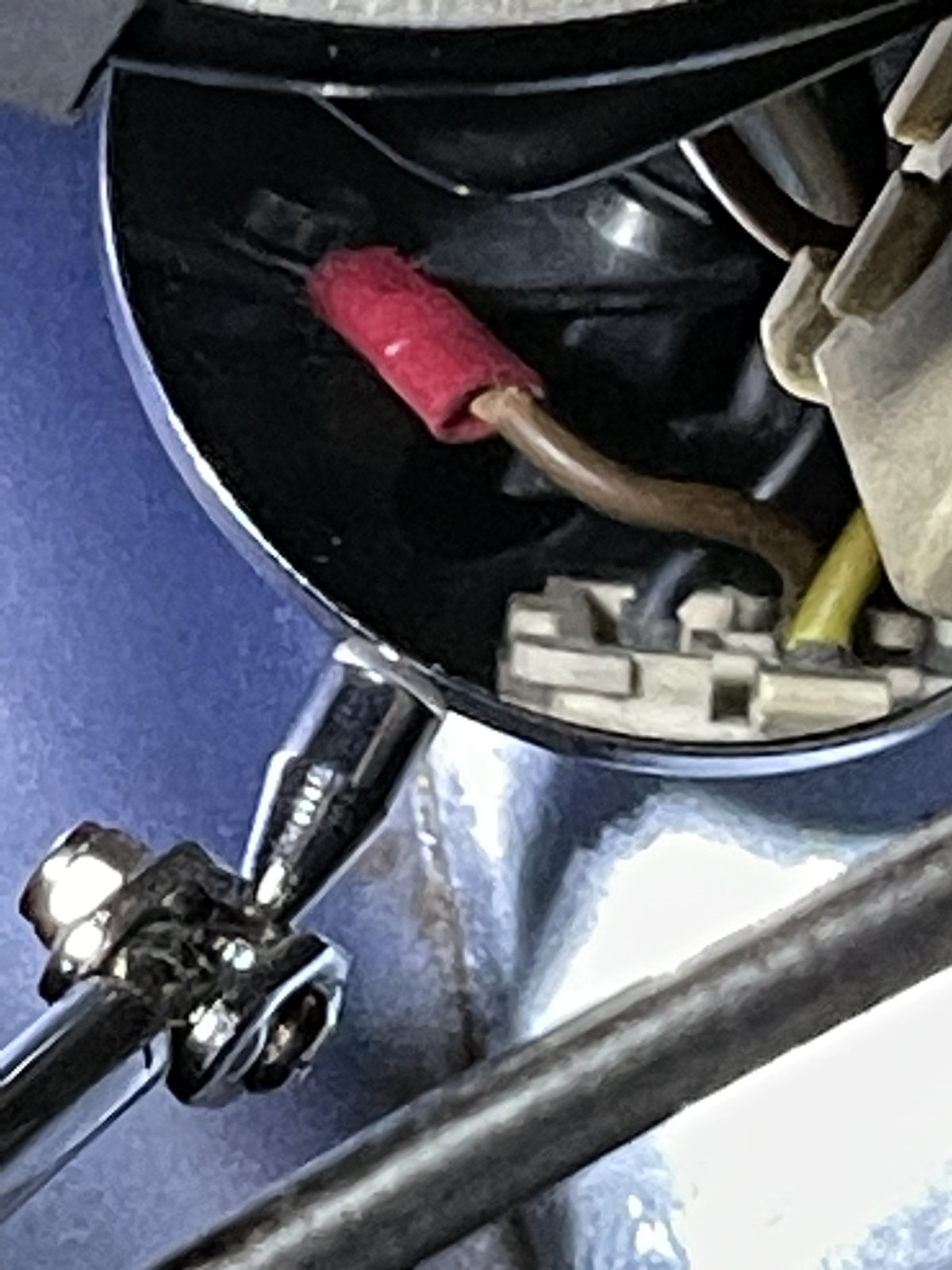

The E24 will fit perfectly. Just need to modify the ground wire with a crimp loop to bolt to the motor as shown.
Reassembly is straight forward after the small modification. I did this at The Vintage in Asheville with Rob Siegel & Billy Revis in under 30 minutes.
Don’t use the e24 plug at all, just take the brown ground wire as Andrew says from your current set-up and add a ring spade to attach to the e24 motor.

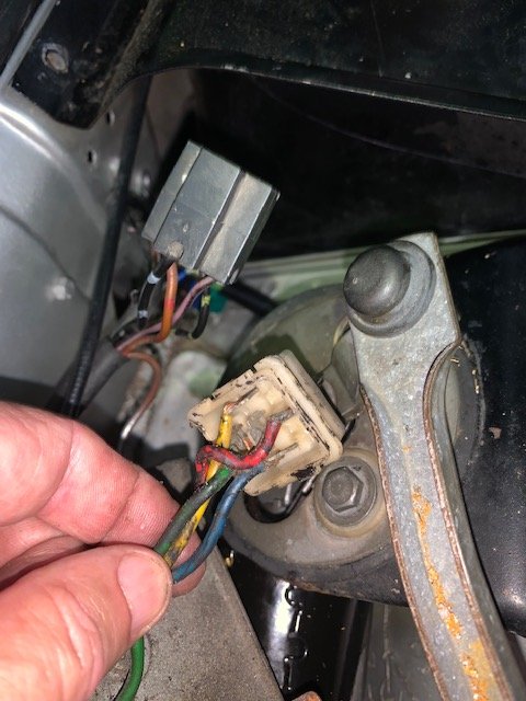

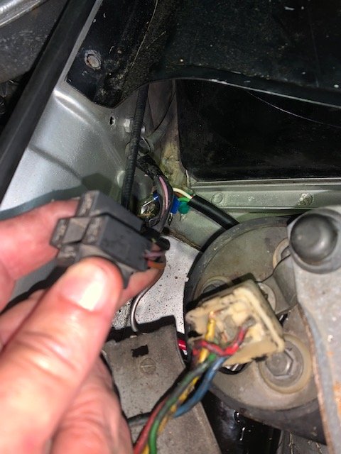

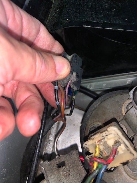

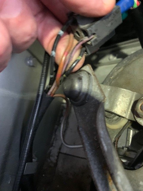

I'm having the same problem (numerous blown fuses) and am down to my last red fuse, so I thought I'd reach out. I'm attaching pictures of my wiring harnesses to see if someone can help me figure out which of the wires coming from the new E24 wiper motor go into which of the female receptacles in the car. On the female/car side, I have what look like the following colors:
brown/with a red stripe
black/with a green stripe
black/with a blue stripe
purple/with a black line
On the new wiper motor side, I have:
white
green
red
brown
I have the ground wire attached to the motor with a U shaped connector that slides underneath one of the screws used to hold the housing in place.
When I put the green wire (new motor) to the black/green stripe (car) and the red wire (new motor) to the purple/black line wire (car), the wiper motor runs for a second and pops the fuse. In that setup, brown is going to brown/red stripe and white is going to black/blue stripe.
Can someone tell me what goes where?
Thanks!

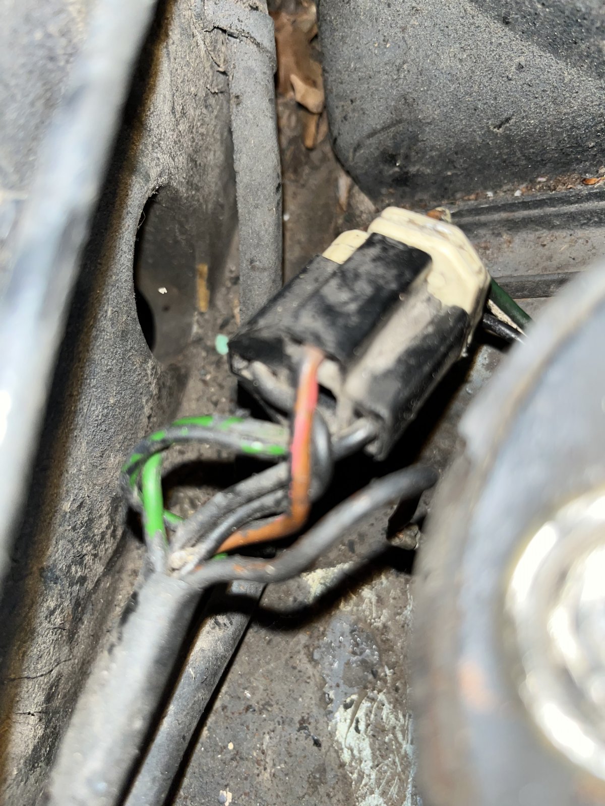

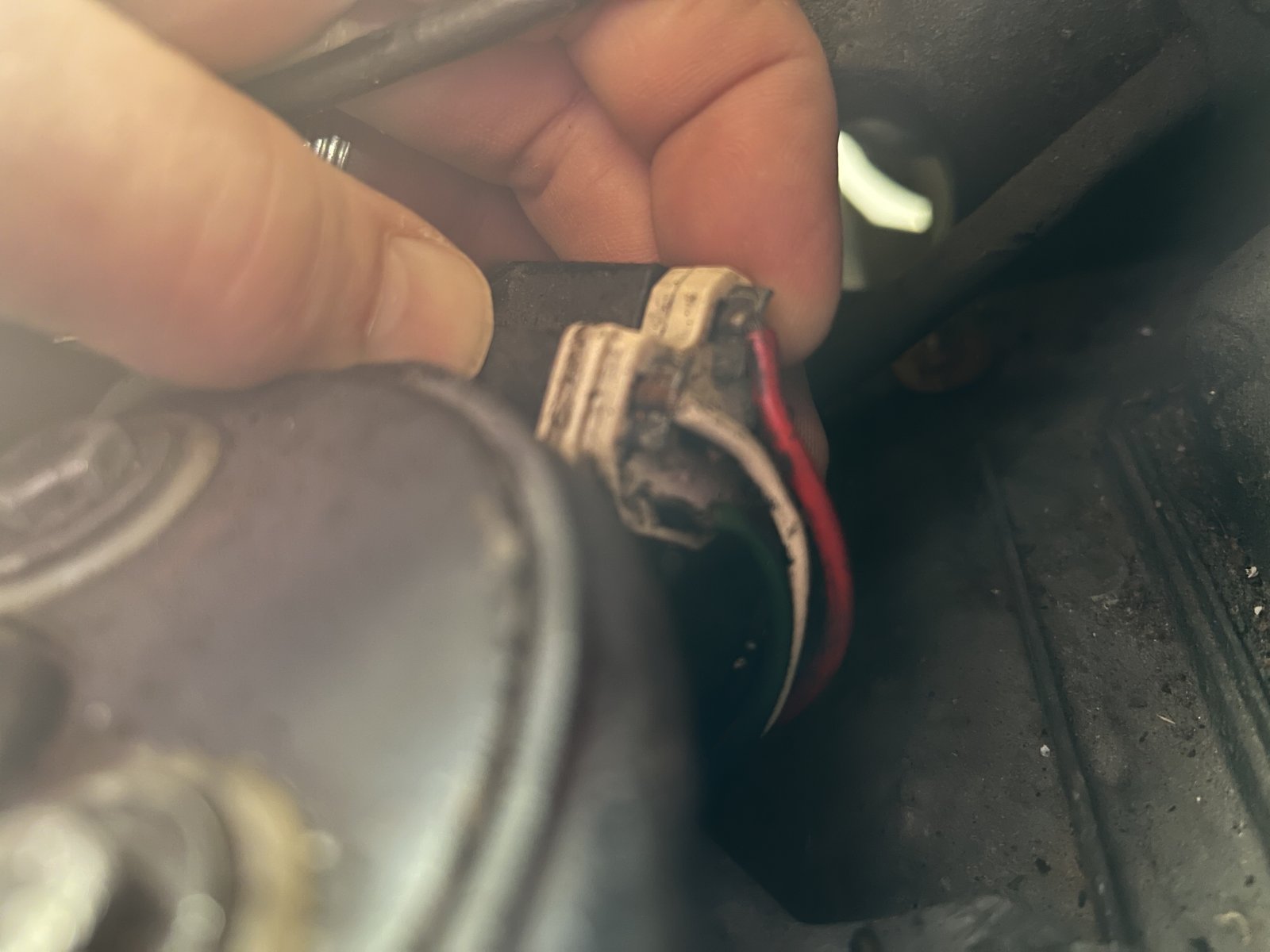

I struggled and eventually bought a refurbished one from Europe. It plugged in directly but my wires are quite filthy. LOL. The white plug is the wiper motor.
I finally figured it out; the problem was that my new motor has a short in the white wire. I pulled the motor out and put it on the bench and it instantly shorted when I connected it to a standalone 12V battery. I even opened the motor but couldn't find where it was shorting, so I connected everything except the white wire which apparently controls the timed wiper feature; everything but that appears to work fine. And it's WAY faster than my original which had gotten ridiculously sluggish, so it was a good choice.
There didn't seem to be much interest in the topic, but for future reference on wiring, the female plug is organized like this:
| Red wire goes in the 12 o'clock position
__ __ Brown wire in the 9 o'clock, White in the 3 o'clock
__ Green wire in the 6 o'clock
Just posted and the posting is left justifying the plug diagram, but you should be able to get the idea.
