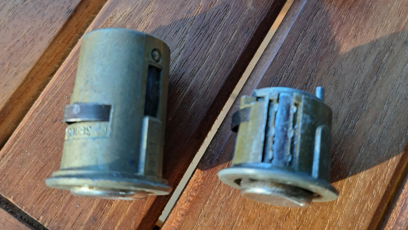

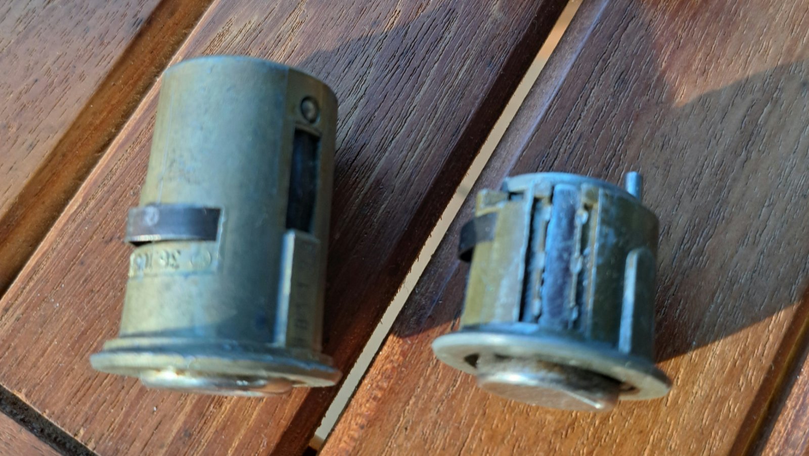

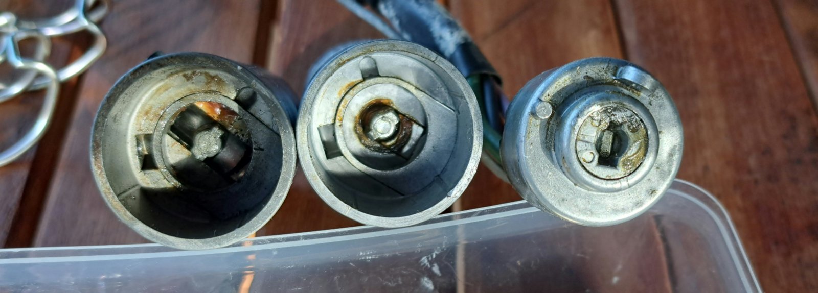

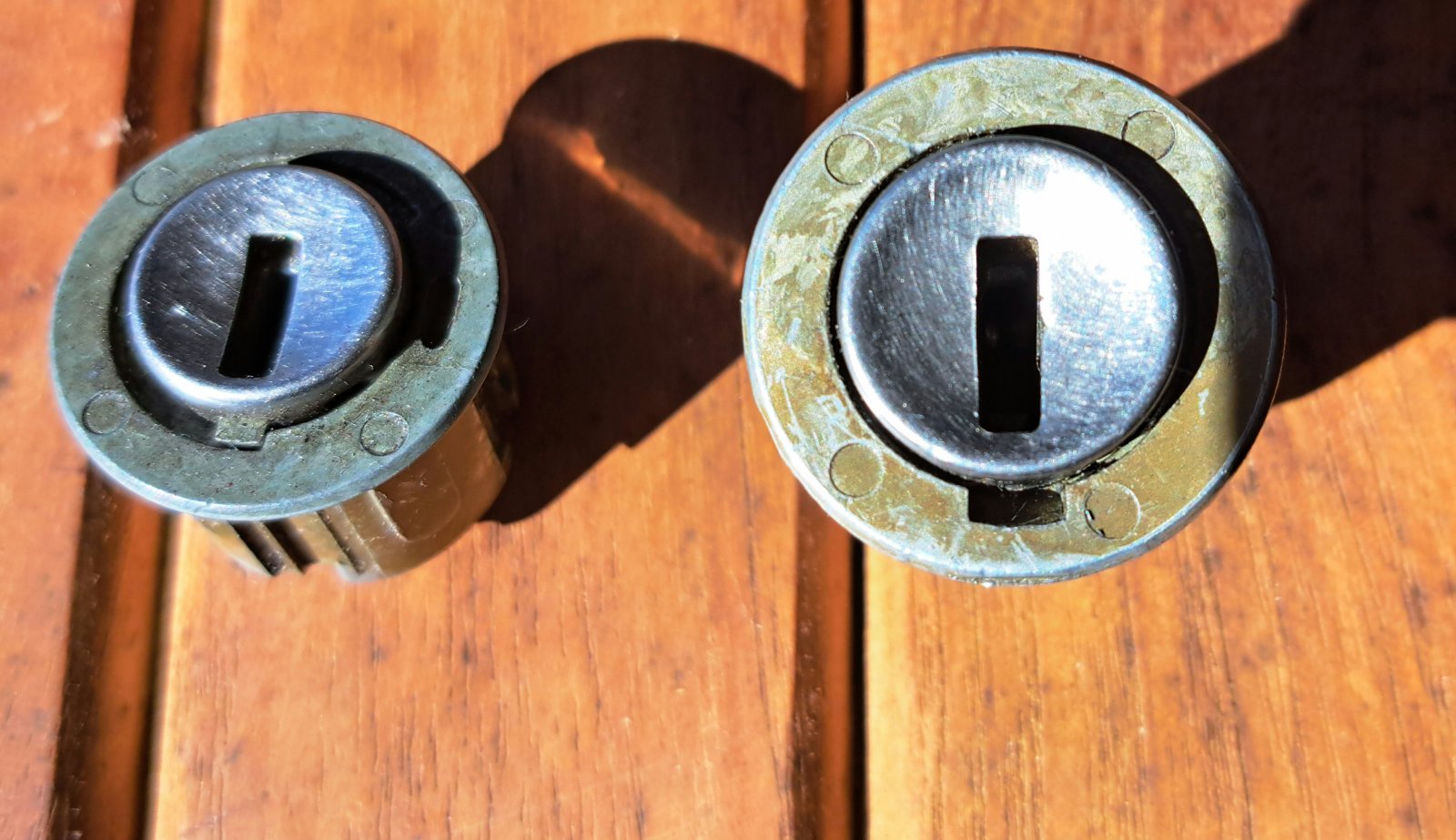

There are two different type of locks with different key switch, barrel and ignition switch.
The early type is the short key switch, the later type is the one with the long key switch.20250329_082736.jpg

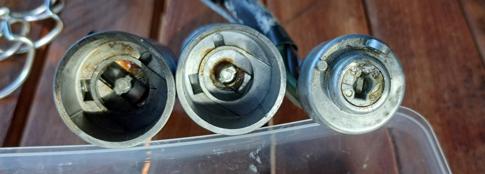

The backside of the barrel for the long one
is shown in the centre along with it's ignition switch on the right20250329_082009.jpg
The mounting position is coded, short and long type are different.
If you have the wrong ignition switch you may cut the small "nose", but not the one which holds the small locking screw.
Also make sure that the key is the right position to allow the ignition switch to slide in.

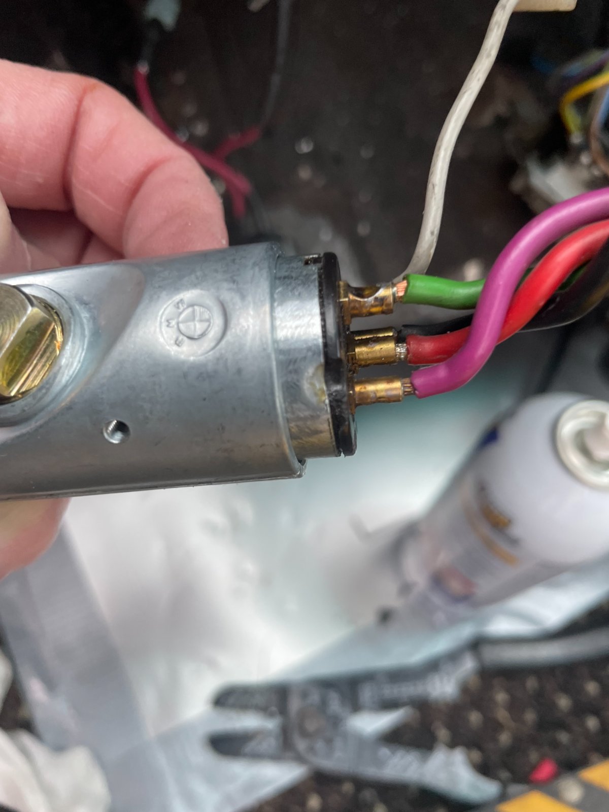

In my case the electrical part (black plastic part) fell apart when I touched it… little copper piece fell out. Have no idea how to deal with this but it’s obvious from your description that I have to get the stuck piece out and it doesn’t sound like it’s going to be easy.
So today seems to be "ignition switch day".
Try to get out the small screw and use a small plier to pull out the switch.

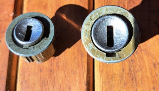

To determine which ignition key switch is installed examine the lock, they look different 20250329_132334.jpg
Short one on the left, long one on the right.

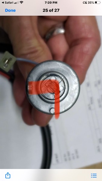

Your pic shows no grub screw,
Your pic shows the protrusion to be 3mm
Most likely your switch does not match with the clausor, pin at 90 or 147deg
No way,
Wrong switch for your clausor
